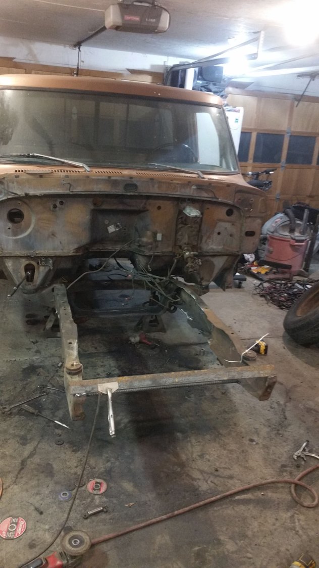

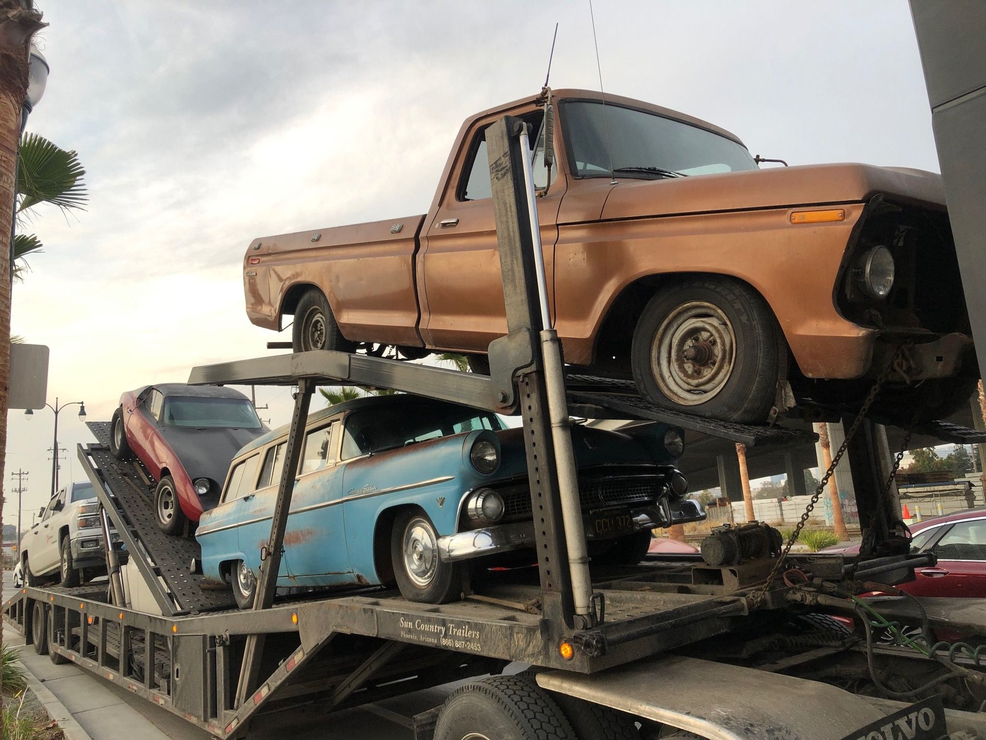

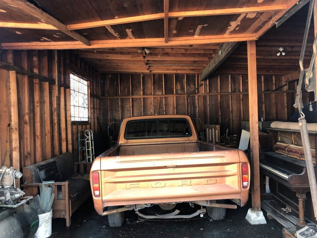

  • I have been on the forums alot over the year started in the ranger, then the idi diesels and superduty, but it's been a few years and I bought a 73 f100 in october. I took a chance and bought it on ebay been sitting for 20 plus years not running and the grill bumpers and many interior parts were missing. I had it shipped to ny and got lucky the body was rock solid no rust. Its a manual steering manual break 3 on the tree 302 truck, The wiring was burnt up and rear half or the driveshaft was also missing so I decided to do a crownvic swap complete with motor trans ac and electrical system from a 08 vic I'll post what pis I have but unfortunately lost most all I had in when my phone was broken
    When she showed up
    Donor 08 crown vic 84000 miles clean 1 owner

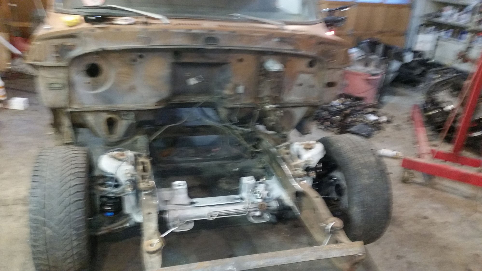

    Out with the old
    In with the newo

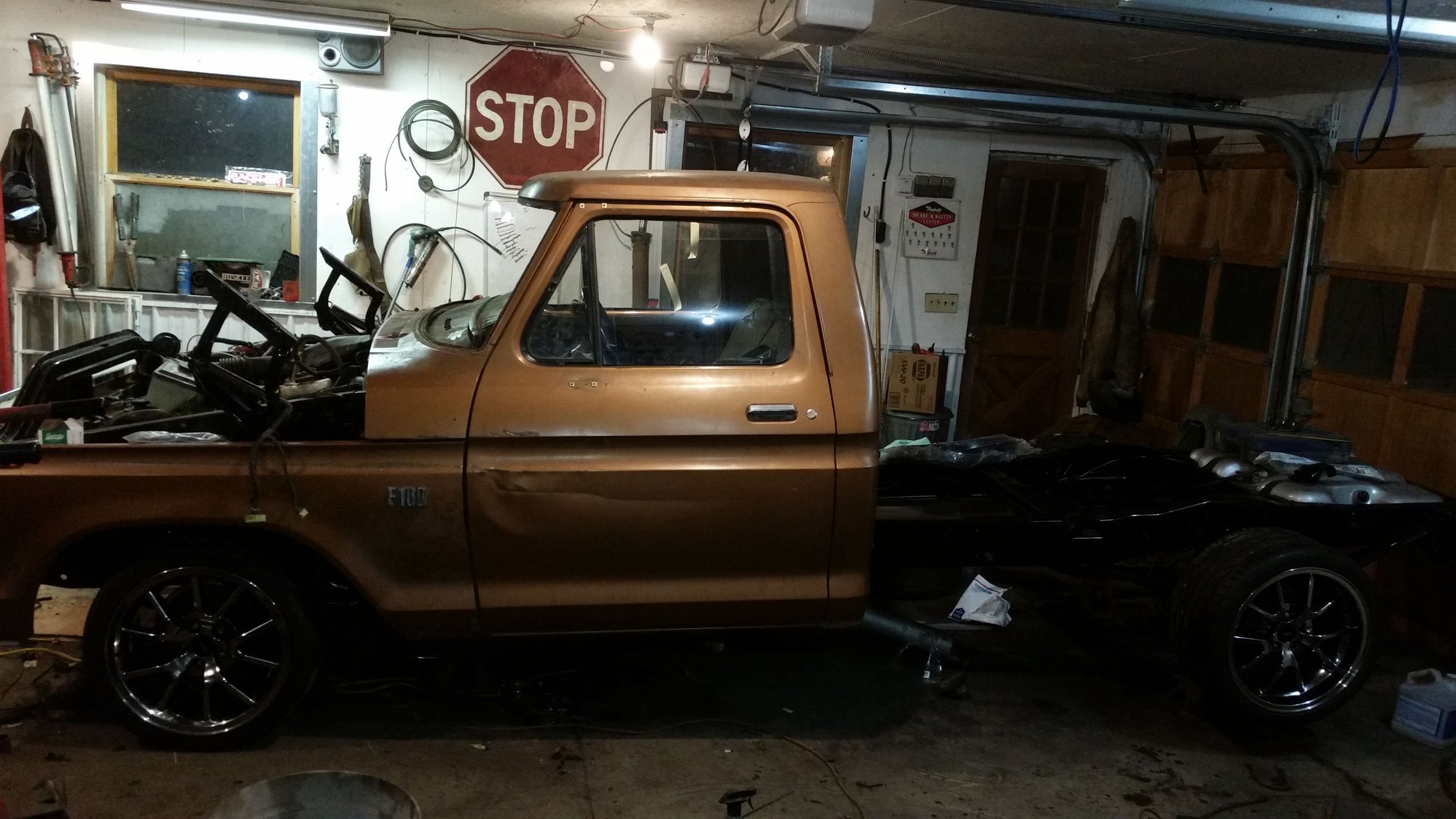

Here is where I am motors in it runs all new body mounts, new glass and door seals lowered rear 4 inches and 8.8 explorer diff. Got some staggared fr500 rims 18x9 in front 18x10 in rear I have but bigger tires on the rims now to make them 27 inches tall so I have some sidewall sorry for the lack of picks and questions just ask and I can take pics and share how I did stuff
Sorry about poor pics hope to get it outside soon and get better ones with new tires

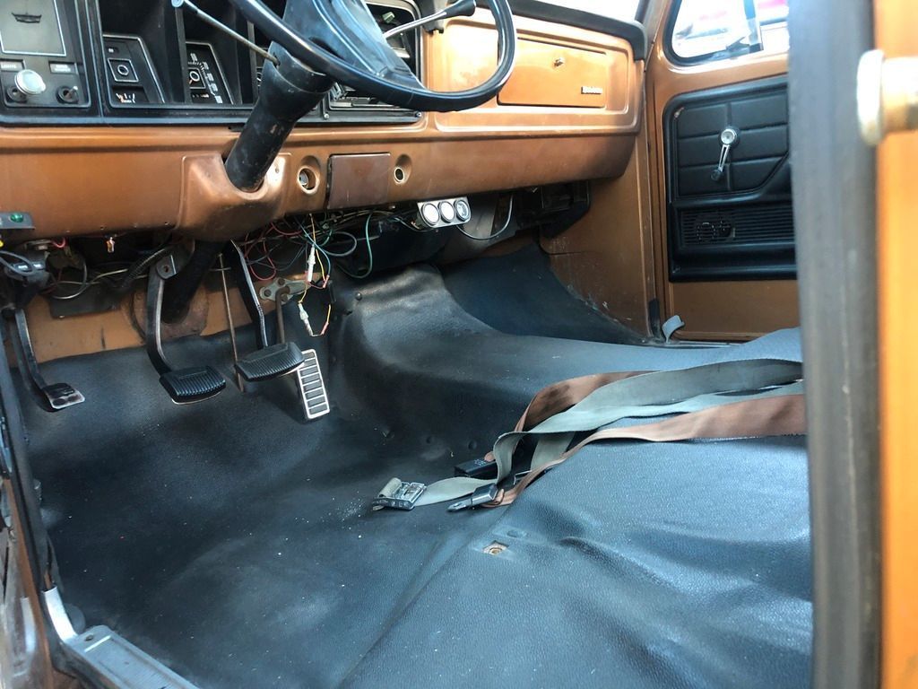

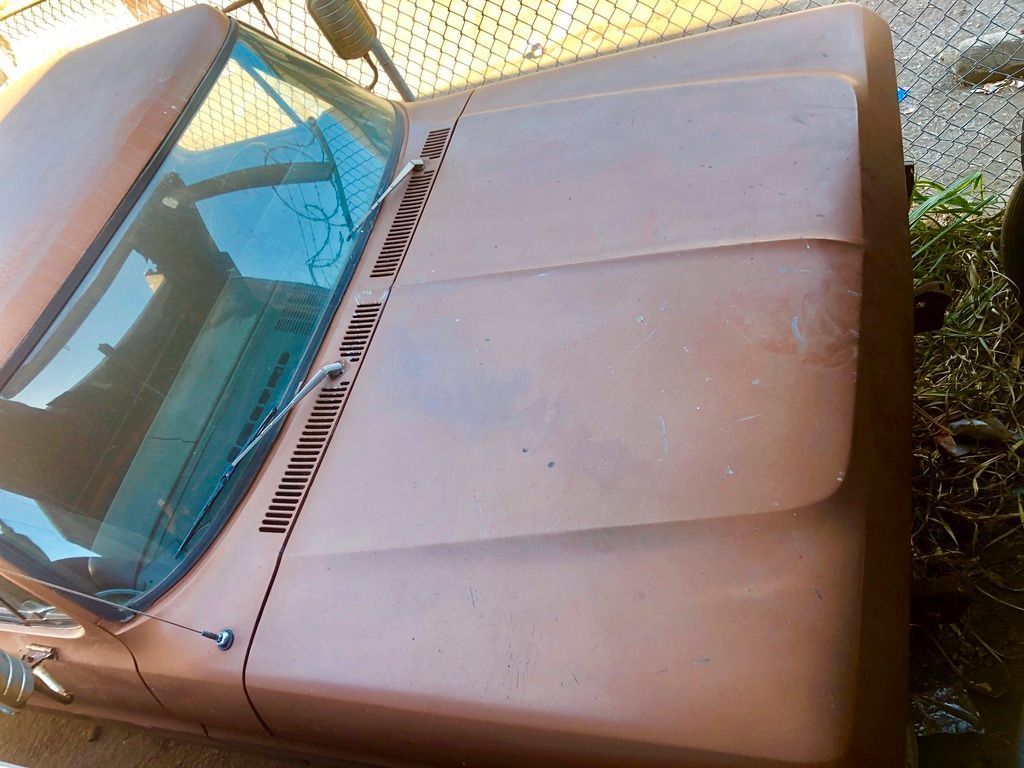

heres a few more i found from the add i bought the truck from

Few questions for you guys is the stock vinyl flooring glued Down in these trucks, mine is but my be po's work. Also is there any market for items like the stock front beams and brakes and steering off this truck was a manual disk in the front everything is in real nice shape just some surface rust but I don't know if there is any demand for stick stuff like that

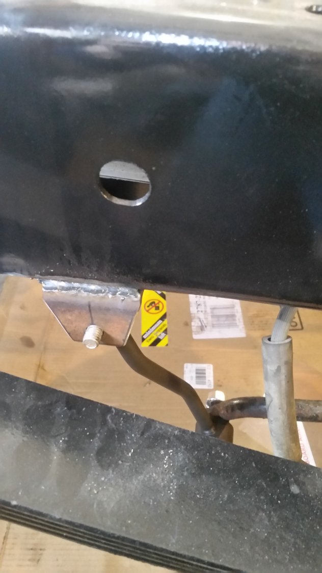

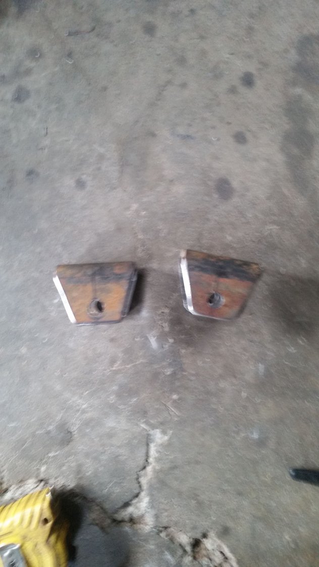

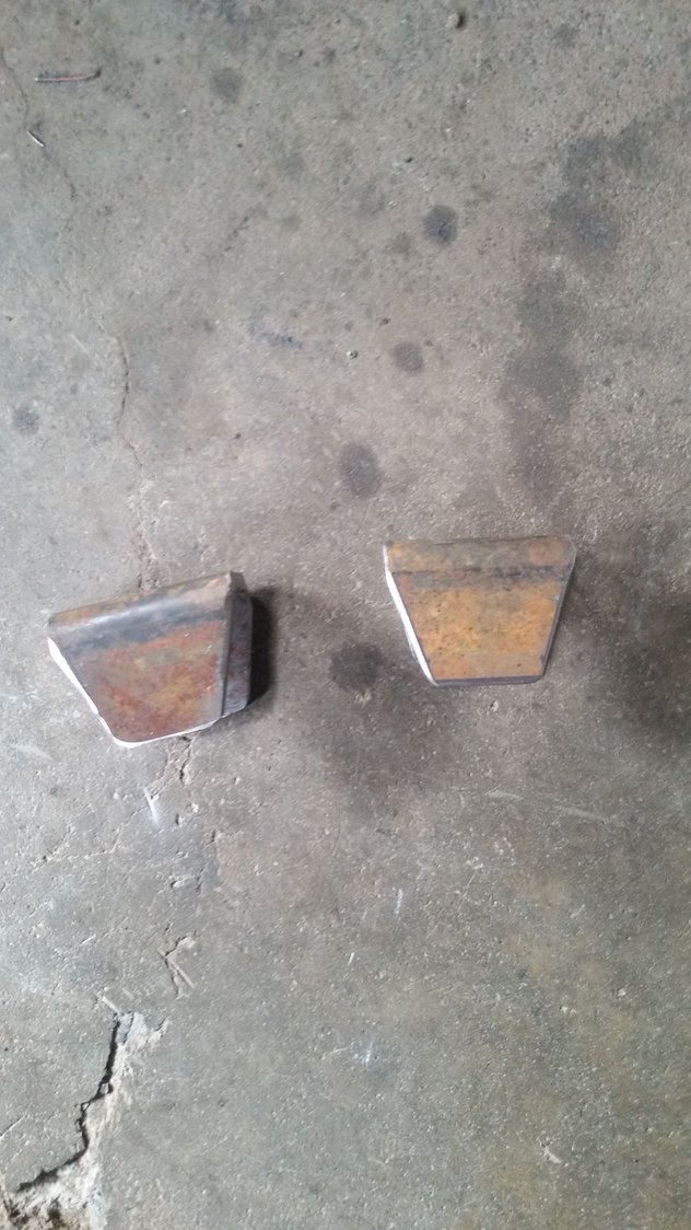

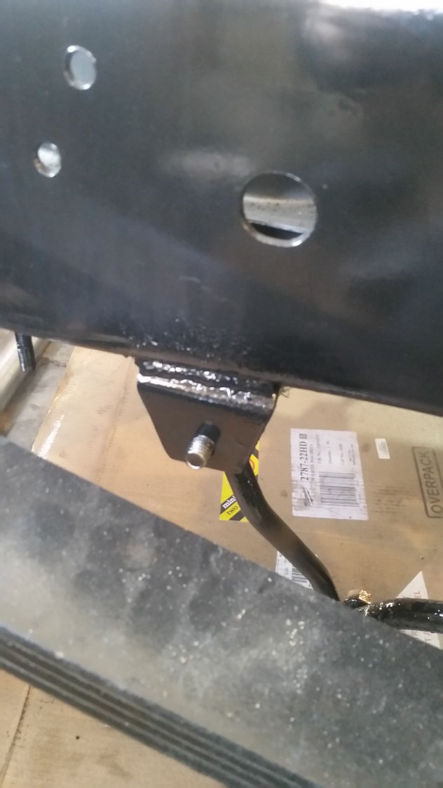

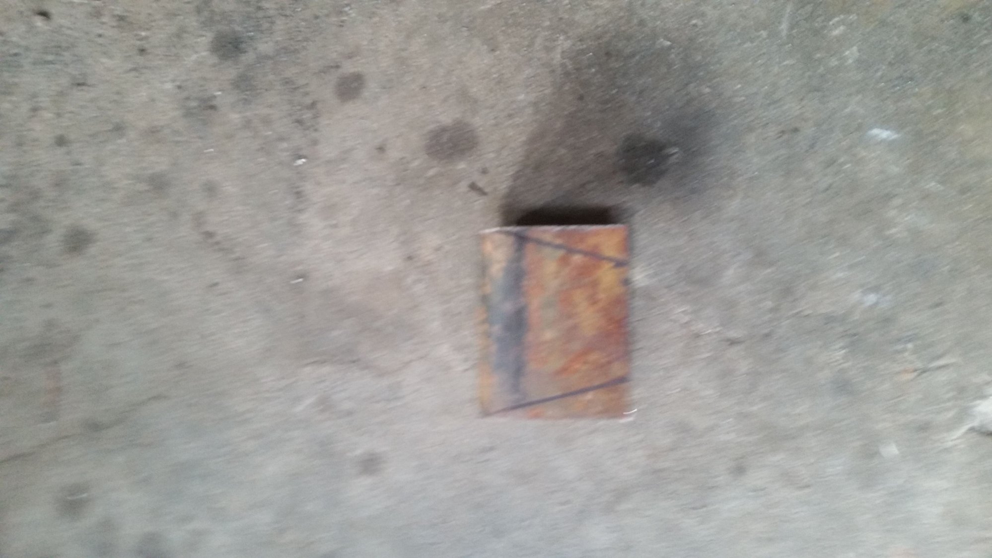

Worked on the truck this morning, keep trying to name it buy no luck do far, anyway I swapped a 99 explorer axle to get rear disk brakes a limited slip and 3.73 gears. it has same bolt pattern as vic and abs, it came with a sway bar so I wanted to see if I could make it work. I had already moved the perches to the top of the axle, set pinion angle, and added shock mounts. I needed some mounting backets to mount the sway bar links to the frame so I made some from a peice of 2x4 1x4 box tube, overkill but it's somthing I had
Box tube
Cut the peice in half
Taper to try and make them look kinda professional
Drill some holes
Attached to frame ready for some paint
Probably not the best way to shack spraypaint but worked great. I love this high solid paint covers great and fast but will settle in can with time
Finished except for correct hardware
