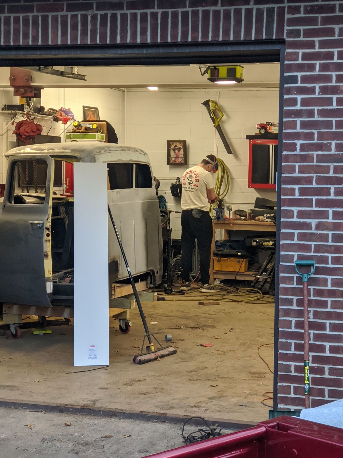

My oldest son is back from college while we wait out the virus. He has been helping out and learning metal fabrication. The silver lining is the time I'm getting to spend with my kids. When he went off to college I figured we would spend limited time together as he moves on with life. This has been nice.

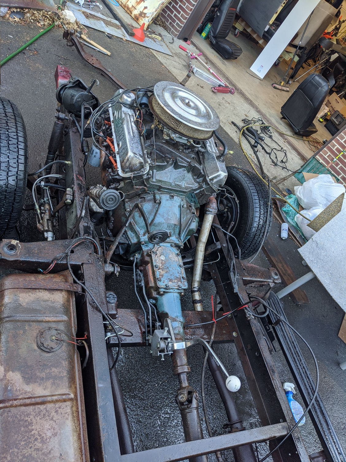

Here is my half truck that I bought from Nick down in Florida. You all have probably been following his thread (hid user name is escaping me). I know the bed is for later ford pickups but I just want a cool opd truck that I can drive around town and haul parts. This will fit the bill with a good running 390 and top loader with power steering. I'm going to do front disc conversion and dual master cylinder and go from there.
The plan is to move the fuel tank under the bed and put my '56 cab on and my front clip. I'm painting the whole thing in a light yellow like my truck originally was. I'll then track down a good 53-56 body to use on my chassis. So I have a few years of projects ahead of me. I'll ether sell one of the trucks or give it to one of my kids.
This is the engine and trans after a couple of rounds of degreaser and pressure washing . I like the Hurst shifter.

You might want to check your driveshaft length. That yoke looks like it's sticking out too far. It could create a vibration or stress on the tailshaft/bushing.
Yeah, I was wondering about that. I have a couple other driveshafts and will see if one will work. Otherwise I'll have one made.

It's getting cleaned up little by little. Transdapt make bolt in cross members for that motor and transmission that use standard motor and transmission mounts. That motor wasn't originally designed to mounted in the front.
Thanks for the heads up! I looked closer and the front mounts are homemade and pretty sketchy. I just went and ordered the transdapt unit from speedway.

I wonder if you'll have to modify or change out that shifter, looks like it sits back a fair bit unless buckets are being used..

I'm using buckets. It definitely sits back but I'm not interested in putting money there on this truck.

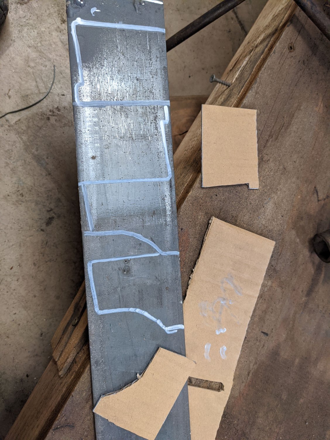

One thing I noticed is that the front shocks were changed to rear style ones. There was just a bolt holding the top to a plate and it isn't adequate for the load. I spent some time fabbing up something stronger.
The shock was flopping around on the mount and had made the hole oblong.
I designed some brackets with cardboard and transferred to metal plate.
All welded up including the original mounting hole.
Drilled new holes on both sides.
Finished with a little black chassis paint. Should work much better. I cut matching metal plates for the driver's side and will finish it this week.
