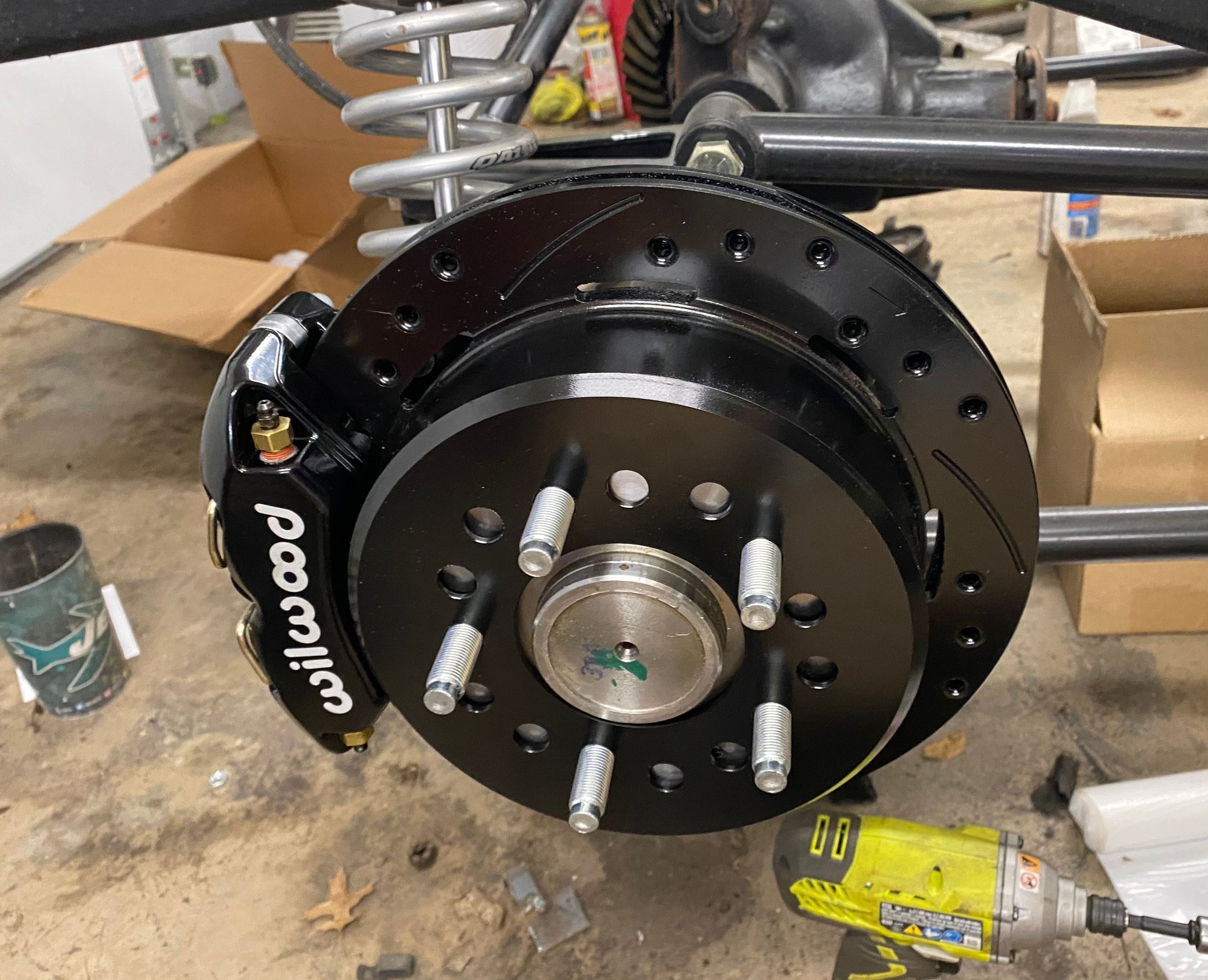

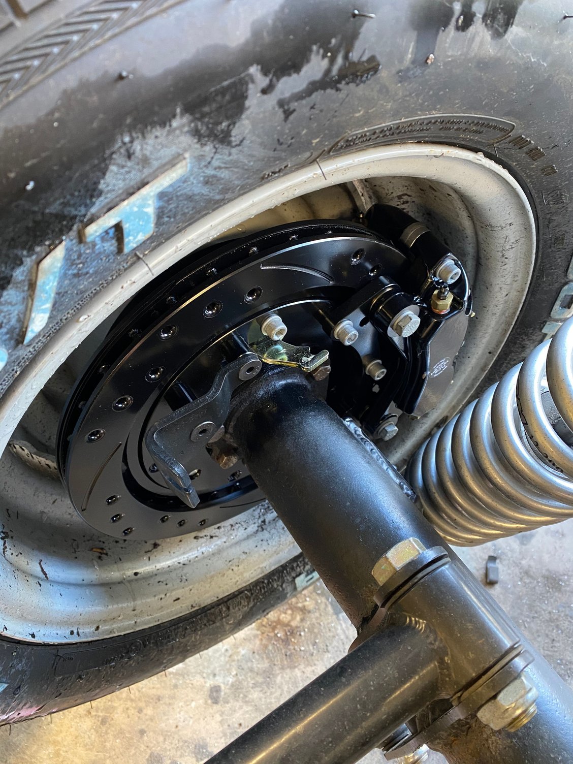

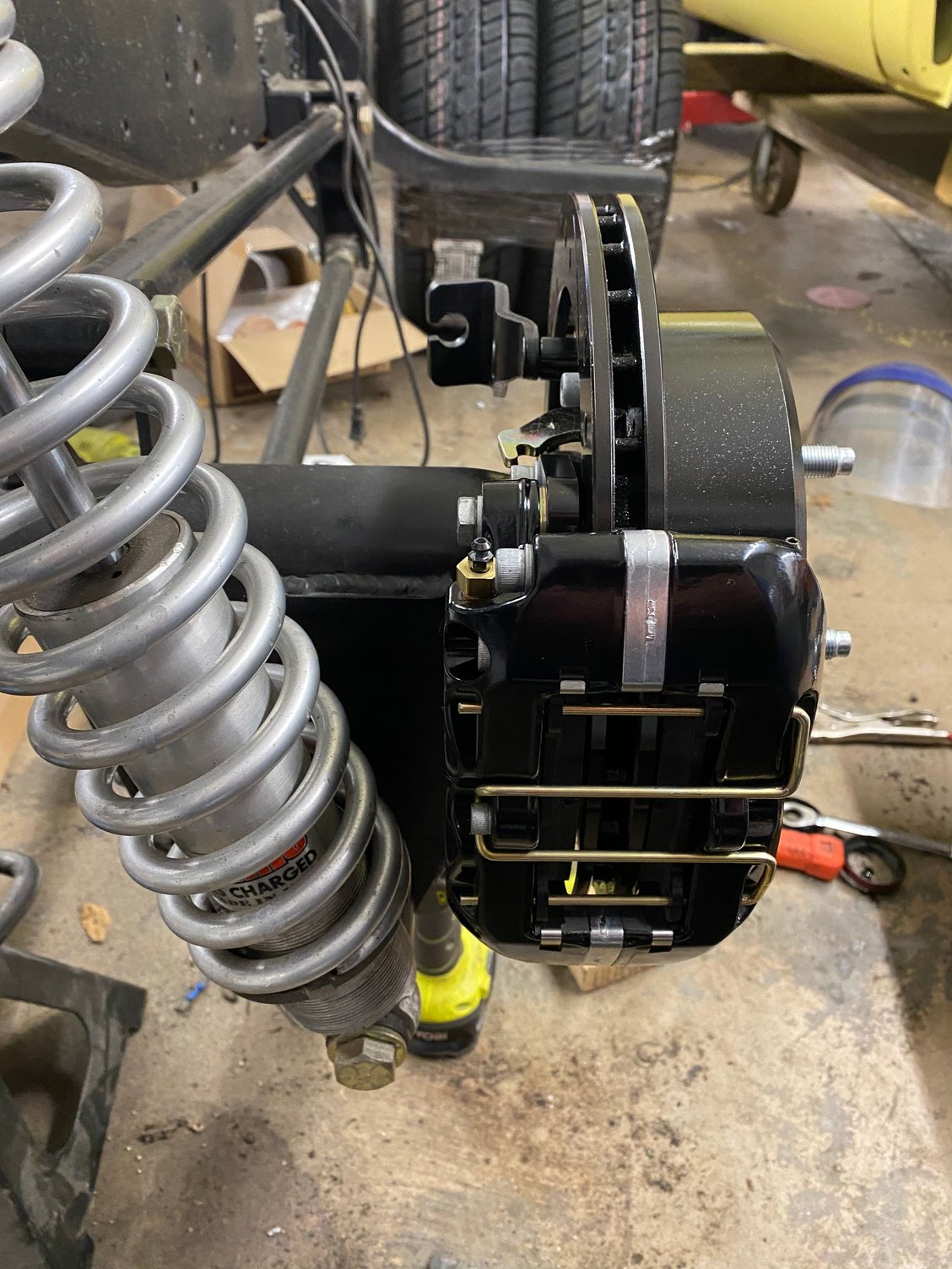

I’ve been working on the rear end lately. Swapped out the axle shafts and installed the low profile wilwood rear disc kit. I like this kit because it fits under 15” wheels and has an integrated drum parking brake.
Had to use shorter axle shafts so the brakes would line up properly. Will need to use a 1” spacer for the wheels.

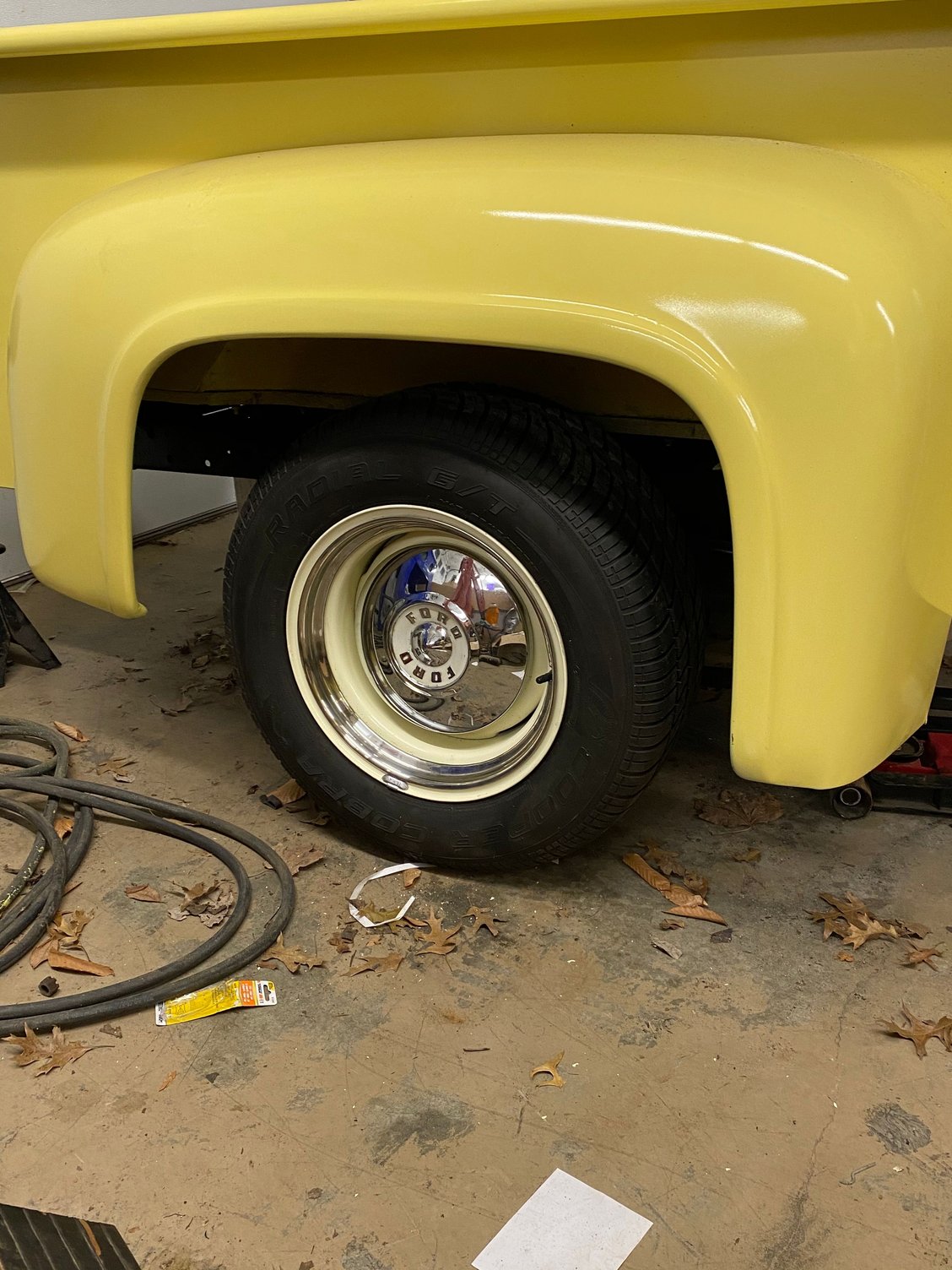

Plenty of clearance for my 15” wheels.

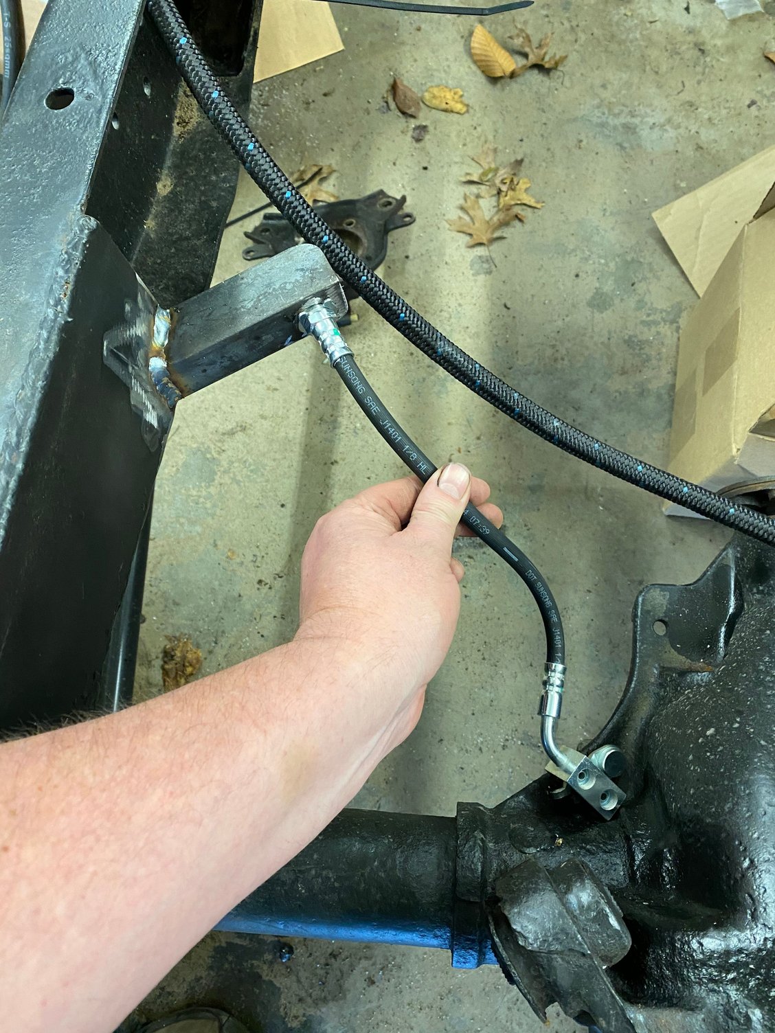

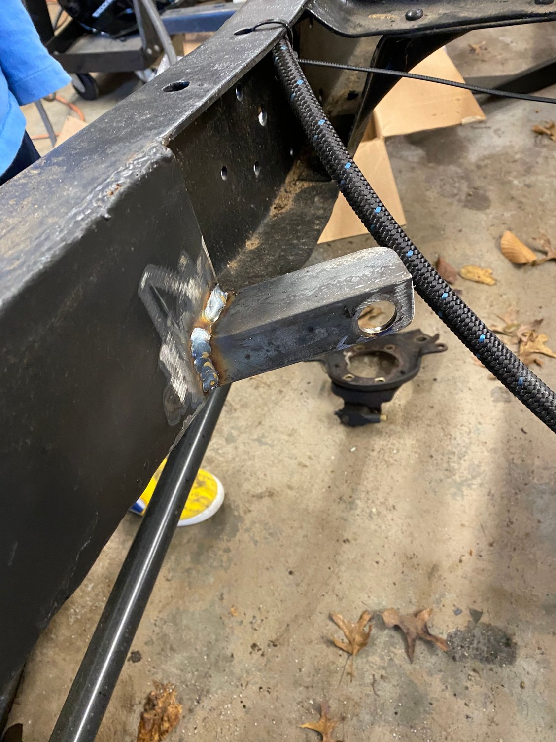

Fabricated a mounting tab for the rear brake hose.
Has room for hose to flex and keeps everything out of the way.

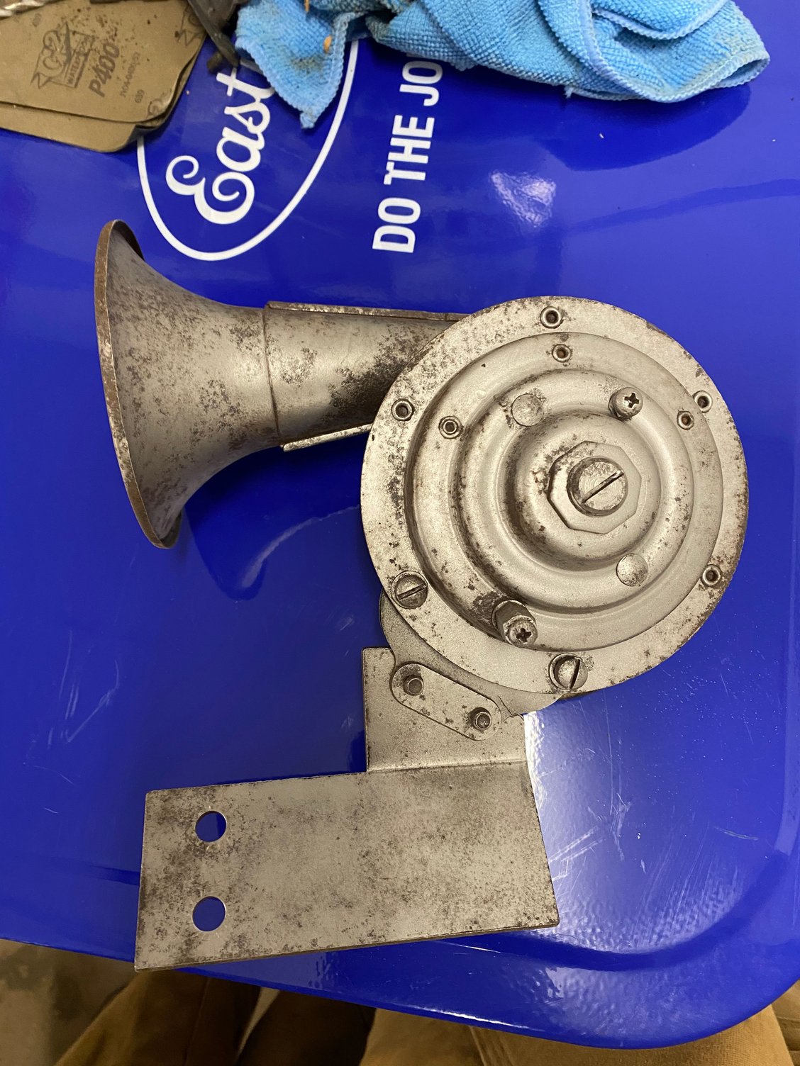

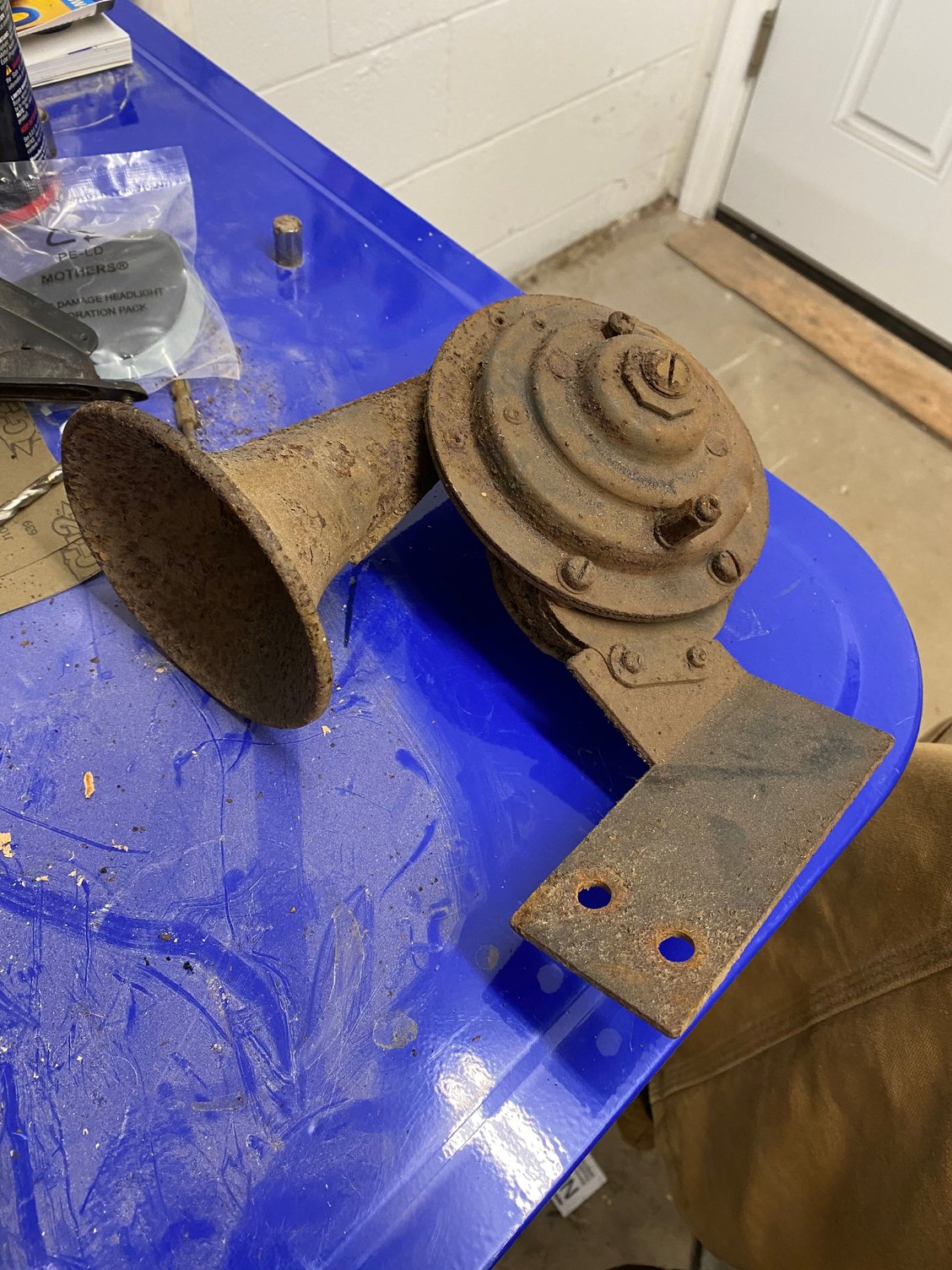

As I wait for big parts I am taking on small projects. Last night was clean-up of the horn. I don’t know where this horn came from and can’t recall if it was mounted on the truck or in a bucket of parts. It was really rusty and had a lot of scaling. I cleaned it up and will test it out to see if it wI’ll work for my project.
This is how it came out of the spare parts bin.
After about 20 mins of work in the media blasting cabinet.
Fresh coat of VHT chassis paint.

If it works it will likely startle you when it blasts even though you expect it to work...lol It's amazing how loud these old horns are..
good call. Ear plugs will be used!

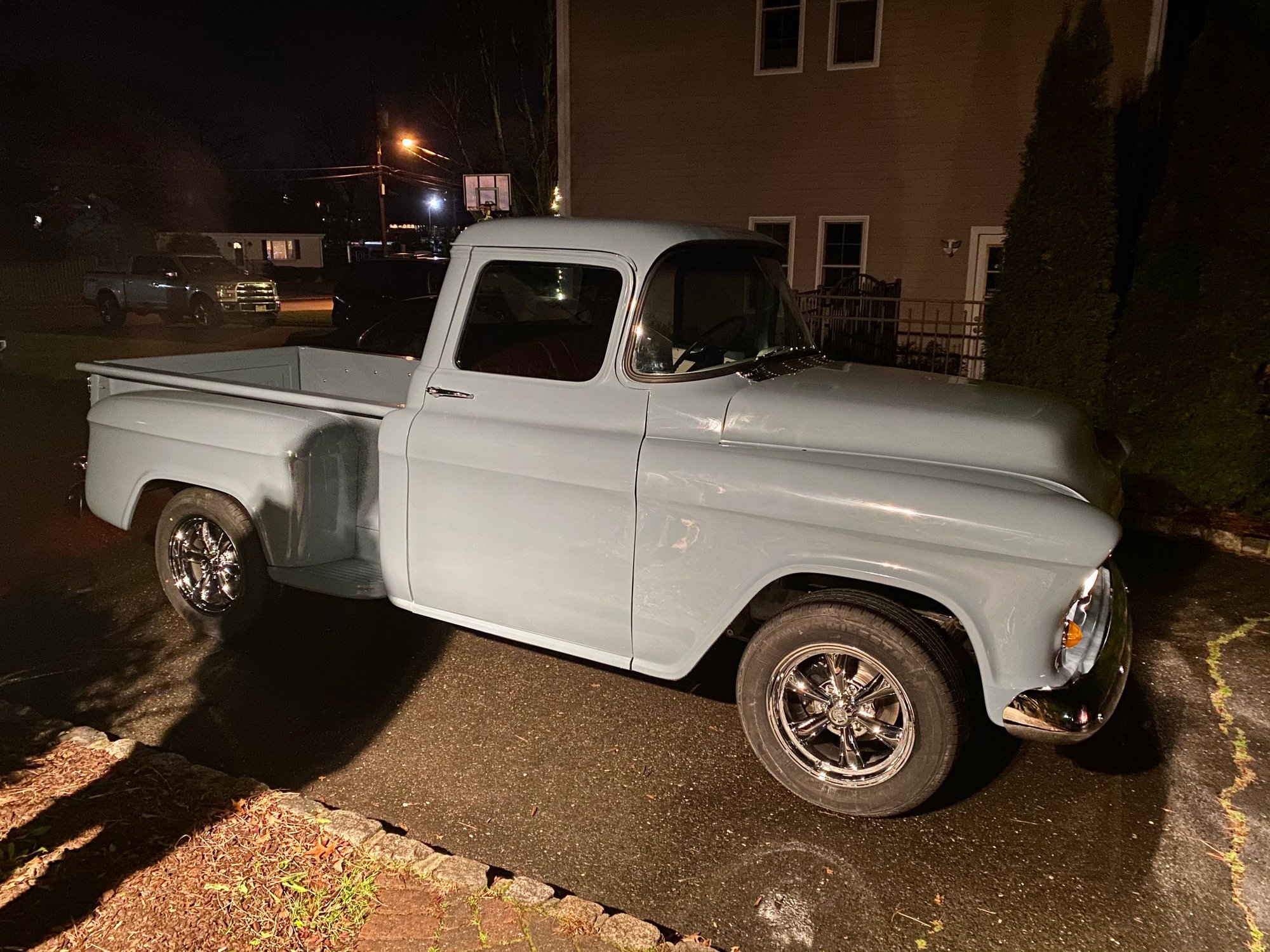

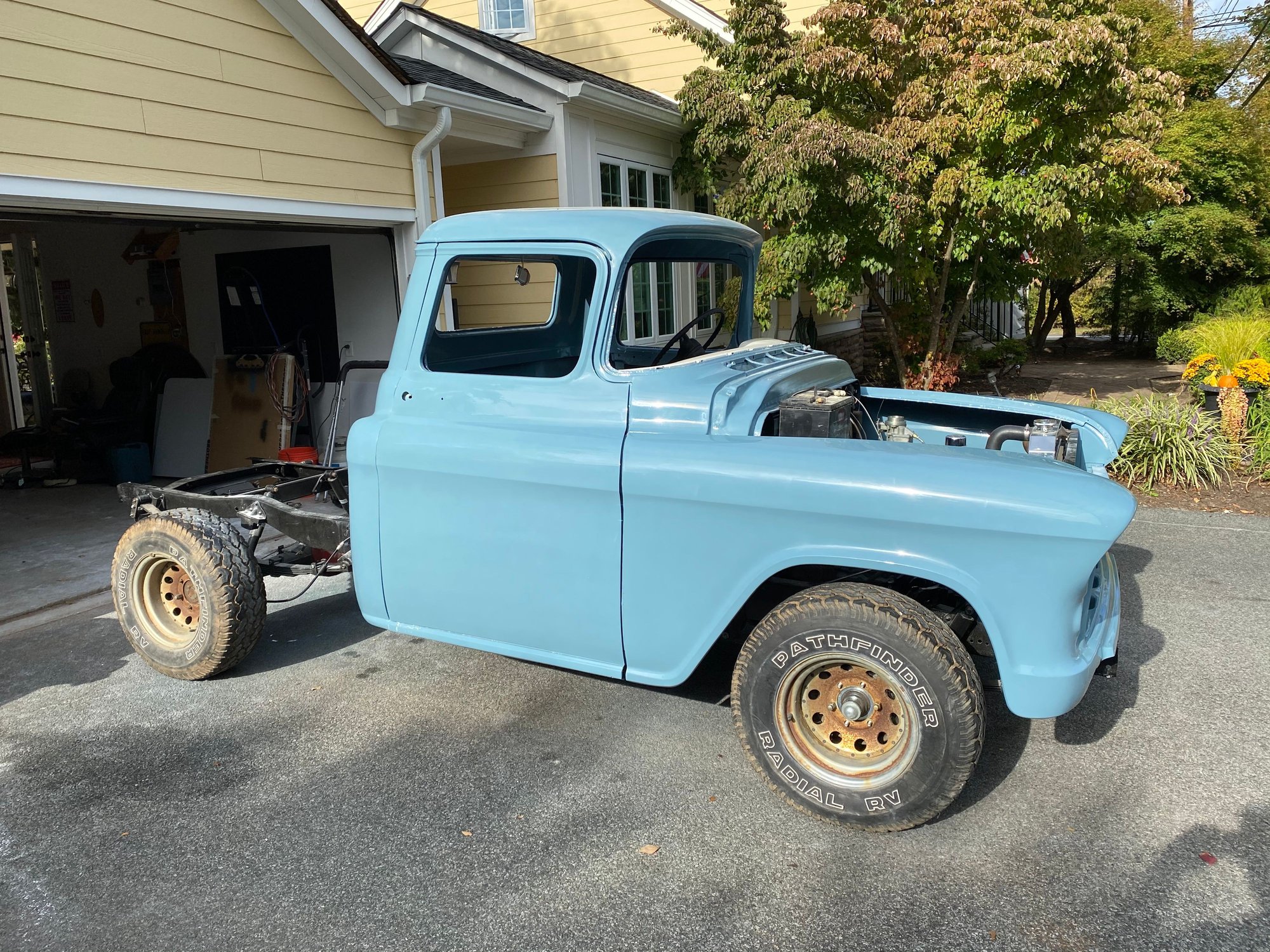

Caution foul language ahead. I was sitting on my couch this evening and I heard an odd horn honk in my driveway. I went out to see what was up and was shocked to see my buddy in his ‘55 Ch**y pickup.
He started his project about 6 months ahead of me and had similar body condition but fully functional running gear. Did all of the body and paint work himself.
First pic is from when I helped him install the grille and front sheet metal about a month ago. You guys can imagine my shock when this thing showed up in my driveway today.
Anyway, it is fun to have someone else in town building at the same time but I was hoping to be the one driving over to his place in my truck first!
This was about a month ago and is a better representation of the color.
Has the 235 and it was purring. Interesting how grey the paint looks at night.

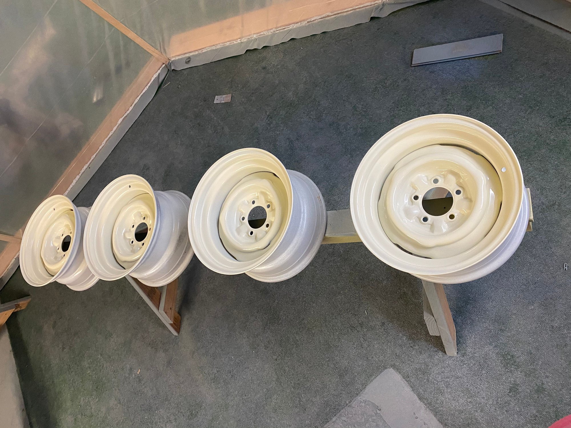

So far I have painted my wheels, started running brake lines, and installed a shift kit in my AOD trans.

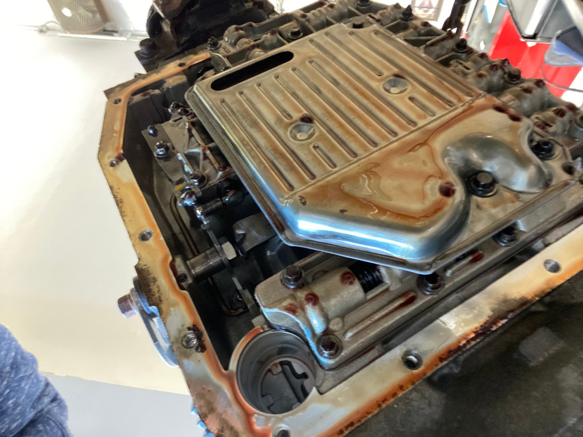

I’m in a holding pattern until my heads show up for my 302. I was going to put the 390 with a c6 I ordered from one of the big trans shops. A few months in and I was tired of the “3 more weeks and it will be done” response, so I cancelled the order. Instead I decided to finish up my rebuilt 302 short block with AFR 165 heads. Once they get here I’ll have the engine shop I work with give the valves the once over and get to work building the top end. The AOD I have has 60k miles on it but it’s been sitting in a garage for many years. I don’t know it’s exact condition but it was operational when pulled and the fluid looked great today. So I’ll give it a shot.
Wheels in the spray booth getting a few coats of Wimbledon white and clear coat.
I added trim rings and hub caps off of a t-bird
Using my chain hoist as a transmission stand worked out pretty good.

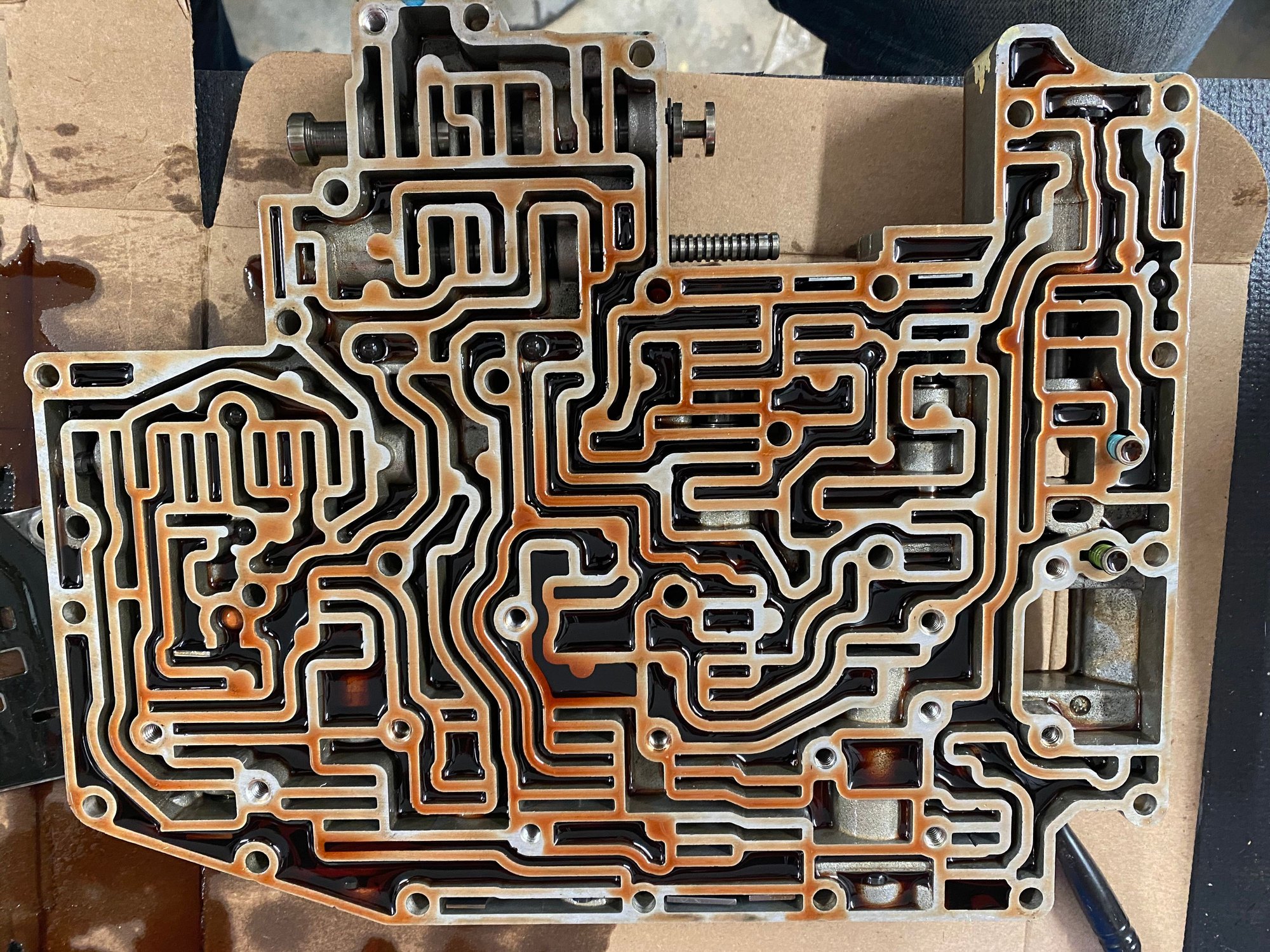

Valve body on the bench getting cleaned up and a b&m shift kit installed.
Everything back in place with new gaskets and seals.
