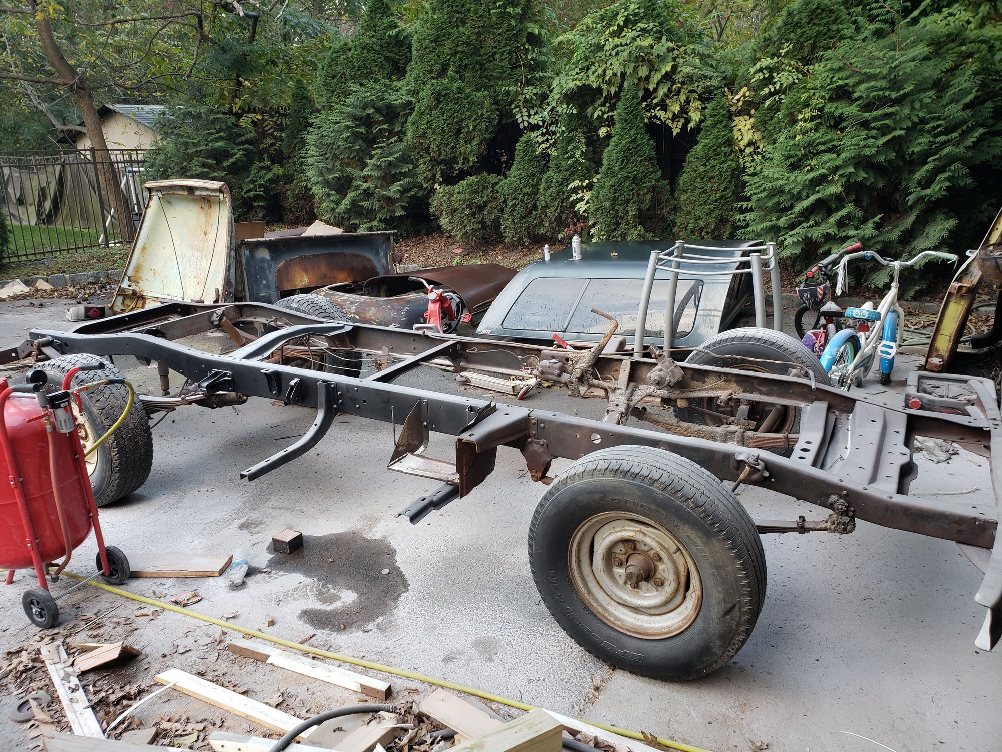

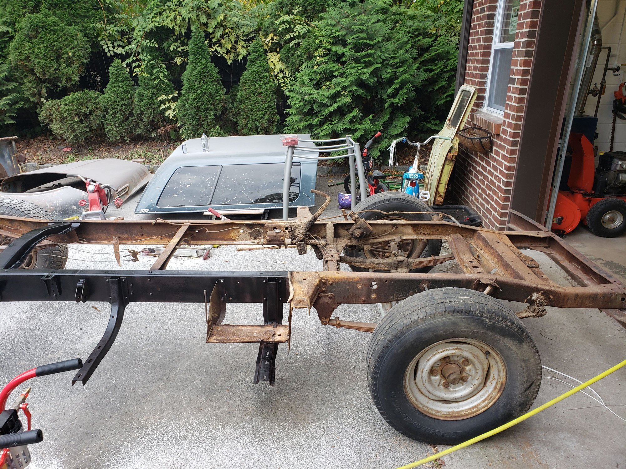

The first thing I tackled was the frame and suspension. Cleaned it with a soda blaster first then chiseled away all of the grease and grime. The front and rear axles came off pretty easy but the pins holding the shackles took some pretty big swings with the sledge to get loose.
This all took the better part of a weekend.
I blasted half of the frame and sprayed some vht to see how it would turn out.
Top fully blasted and half painted
Done with first round of paint
Pulled out the front axle
Lifted the front of chassis as high as I could with the hoist so I could blast and paint the bottom. This didn't lead to good enough results as I ended up doing manual cleanup of the frame later.
And the rear axle was out.

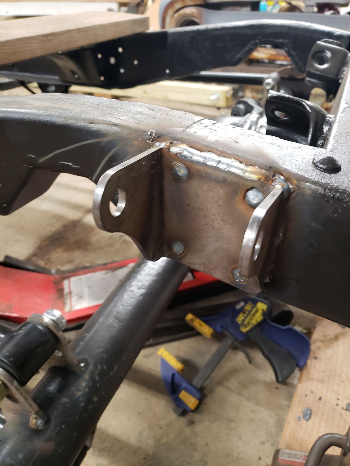

First big project is the the new suspension. Started with cleaning the chassis and boxing the frame front and rear. My first attempt at welding the bottom side while upside down was a disaster. So we flipped the chassis using the chain hoist. Cleaned the bottom with wire wheel and then gave the whole thing a coat of por15. The gloss was too much for me so I followed it with matte finish vht chassis paint.
Welded in the front x-member first, then the 4-link mounts. Basically all of the welding I would need to do on the bottom side.
The mustang ii x-member was a little narrow so I made a couple of shims out of 3/16 plate steel. The front end came together pretty well but the springs were too long so I had to cut a coil out.
X-member gap. Needed shim in addition to boxing plate to fill.
Welded in the x-member while chassis was flipped.
After por15 and vht
Boxing plate
Front spring mount
Front boxing plate and shim
Rear c-notch. Instructions say to leave more than half of frame height
Flipping the chassis with a friend and a hoist
4-link mount
Mocked up without springs

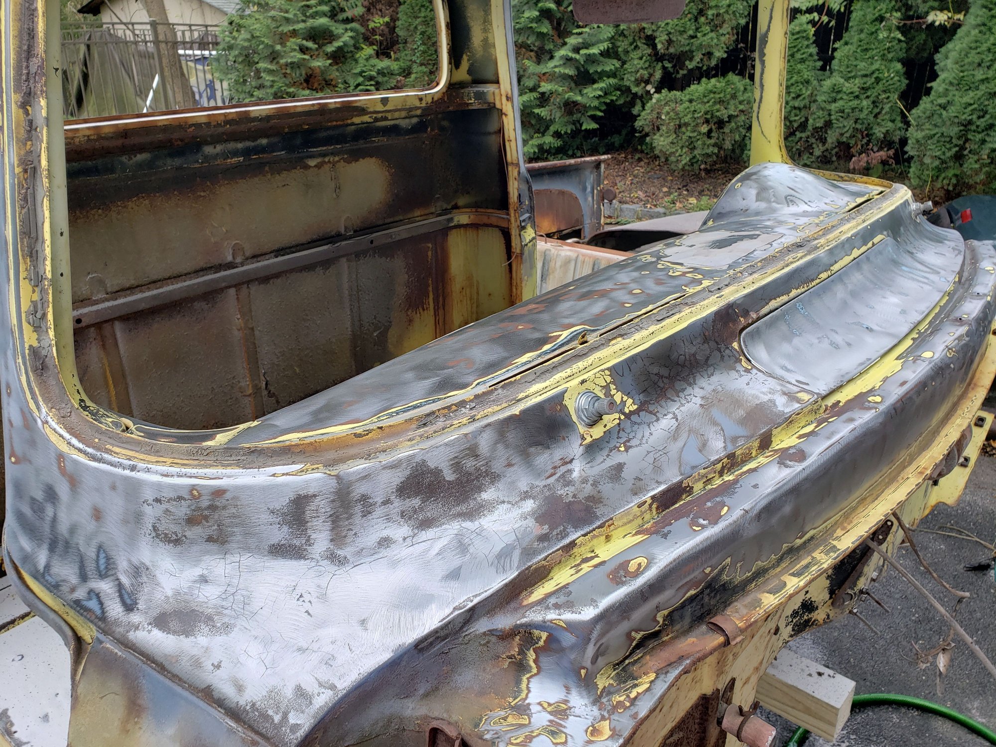

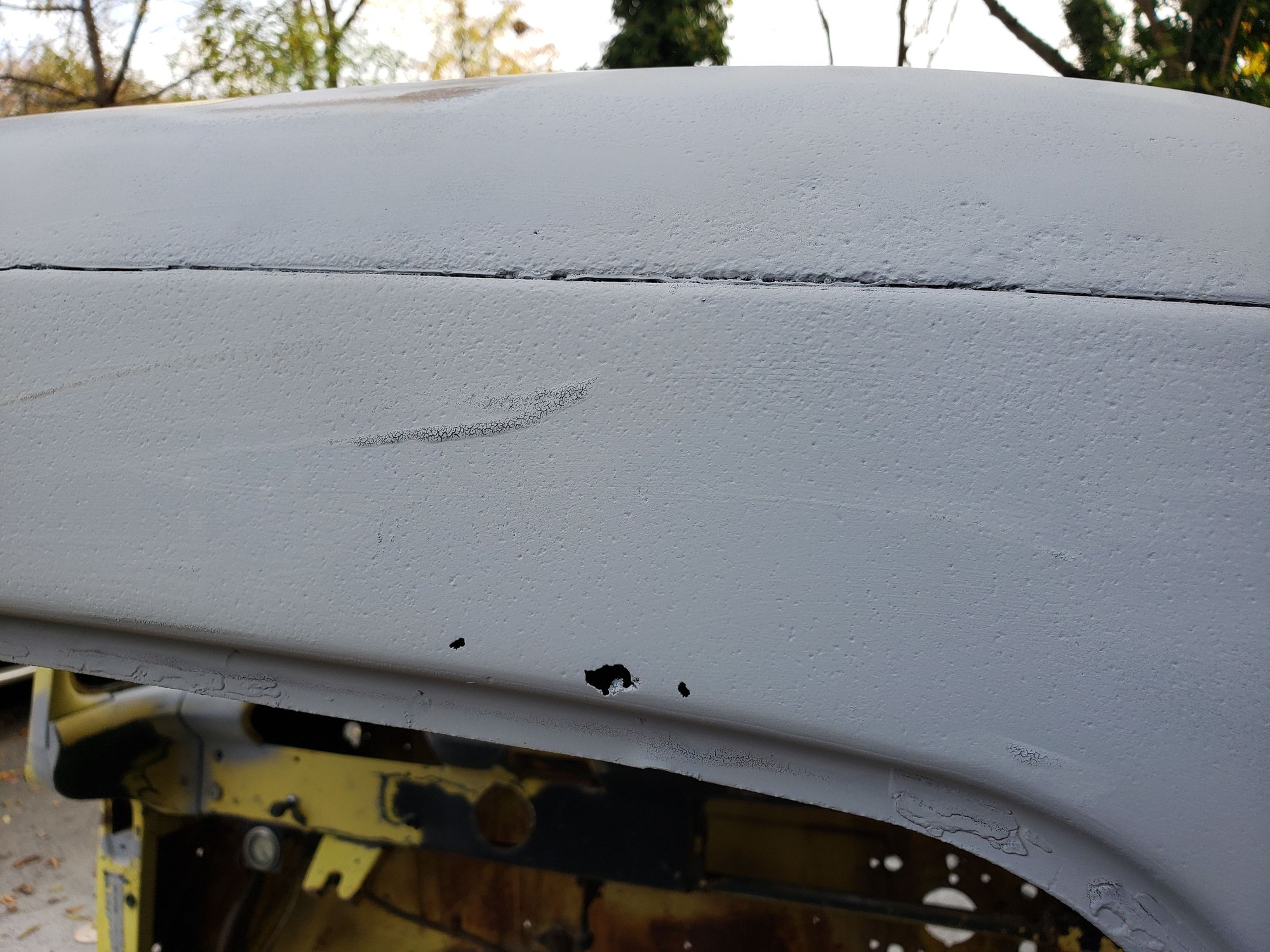

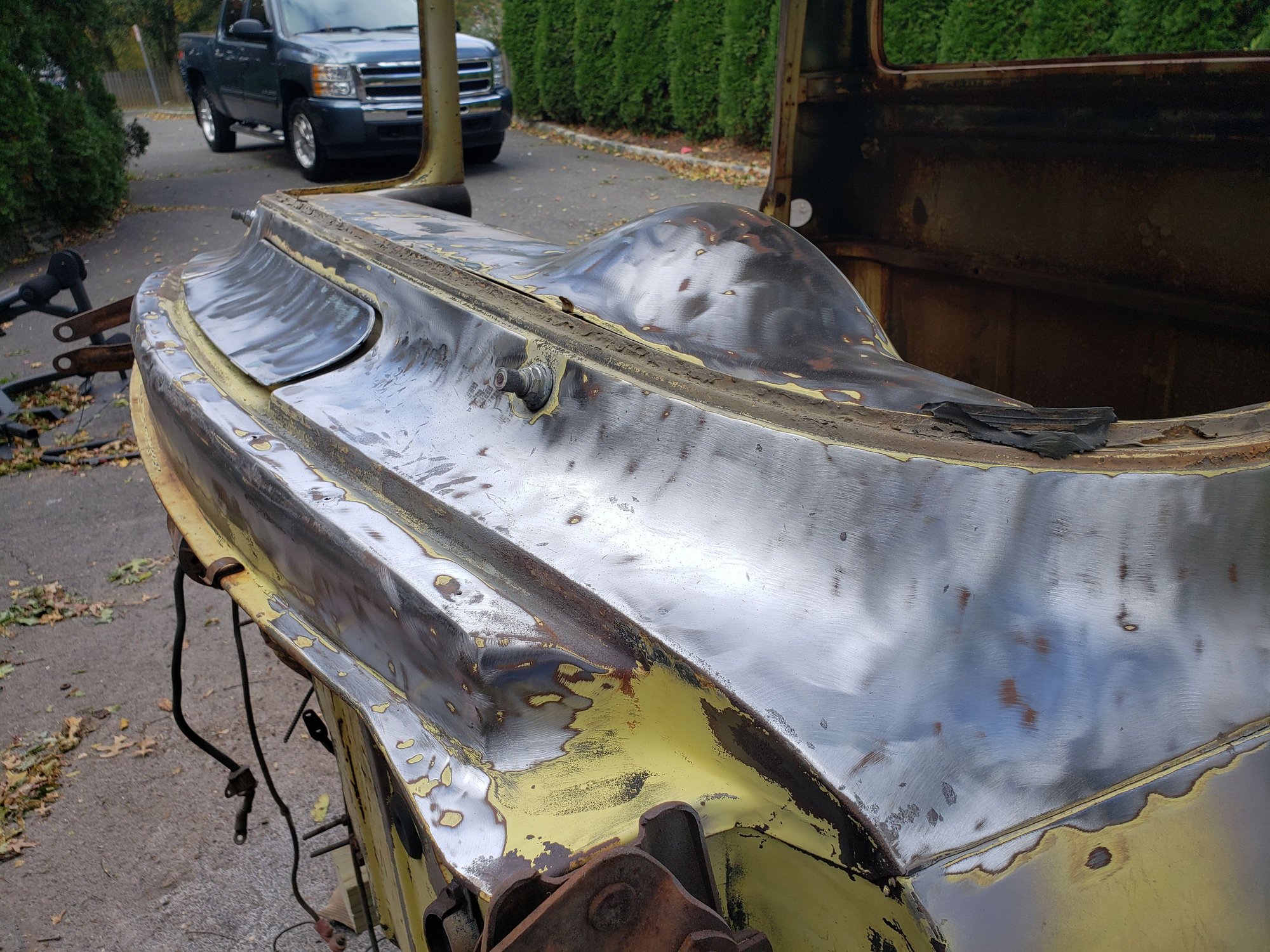

Ive started work on the cab the last few weeks. It has surface rust everywhere mixed with it's original yellow paint. Had a bad accident at some point that did a lot of damage to the right side. Door frame has issues as well as the cab corner and side.
There is pitting on the floor but it doesn't feel weak. I'm deciding on if I need to do the whole floor or just a couple patches. I'm trying to save as much of the original metal as possible.
Cowl is pretty straight. Will need some work where the hood sits
Floors solid but had enough surface rust that I'm concerned about the pitting
Dash is a disaster and I would replace if it was available. It's cut in several places and dented in others. Tons of bondo
A couple of small rust holes above back window
Much of the cab back is solid
Roof seems okay but need to keep working around the edges to see if there's rust through
I cut this out of the top of the dash. I think it was where they mounted a cb or something
Cut and formed a panel for the dash to replace the bad metal.
This is the corner that is really thought. Took a big hit at some point. Will replace most of this.
You can see the damage a little better with primer on it .
