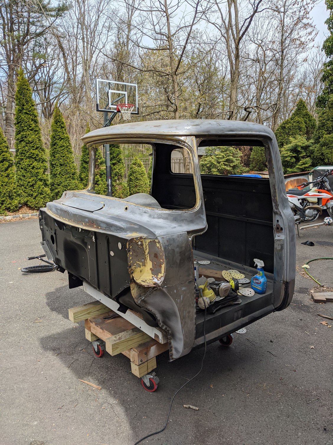

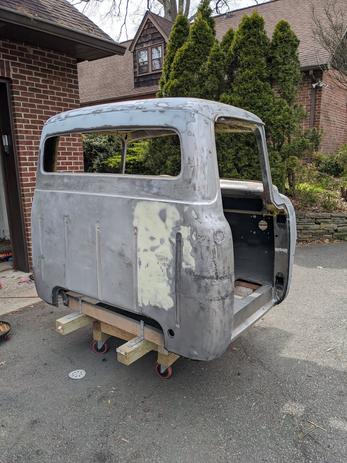

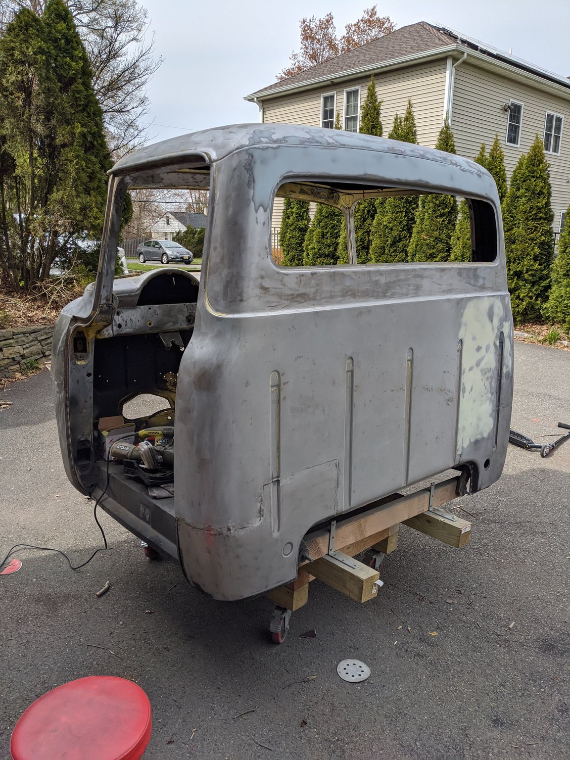

The new find. It came with the necessary patch panels. I'm planning on doing the roof and full back panel. It's a custom cab and I'll use it on the street rod chassis. This will be next winter's project. The bed is in great shape.
Including a few pics of the stripped cab. I've started the mud on the right side. Planning mud and epoxy over the next few weeks. Hoping to paint it in June.

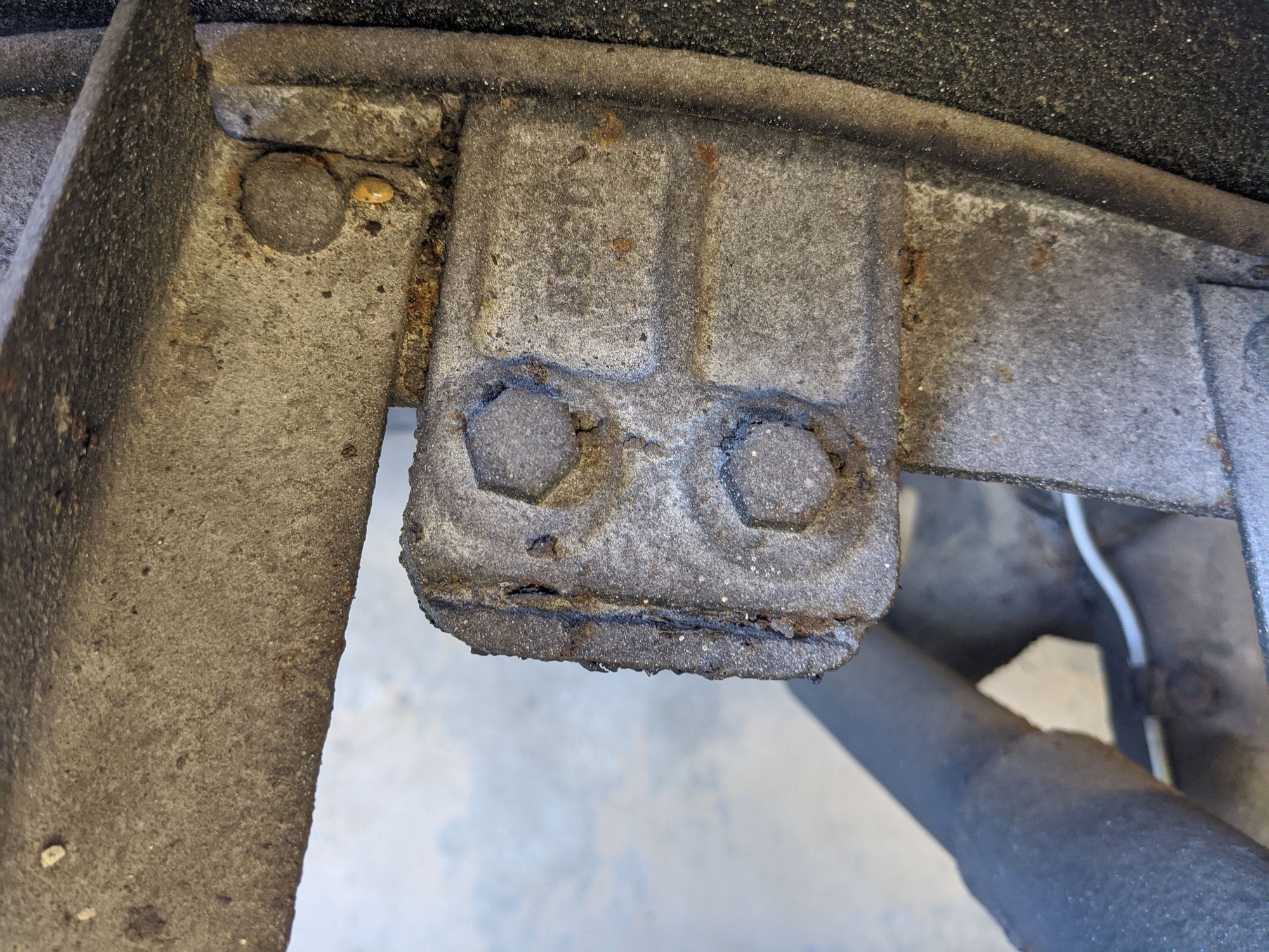

We pulled the bed off the frame yesterday. The rear end has a set of helper springs that look like they are either a dealer installed option or an aftermarket setup.
I'm going to clean up the back half of the chassis, paint it up, and install the fuel tank. Next step will be to set the cab on the chassis so I can fit the doors and finish the body work.
Any info on what these helpers are?
I wonder what kind of load broke that spring? No rust on this chassis so I doubt it was due to corrosion.

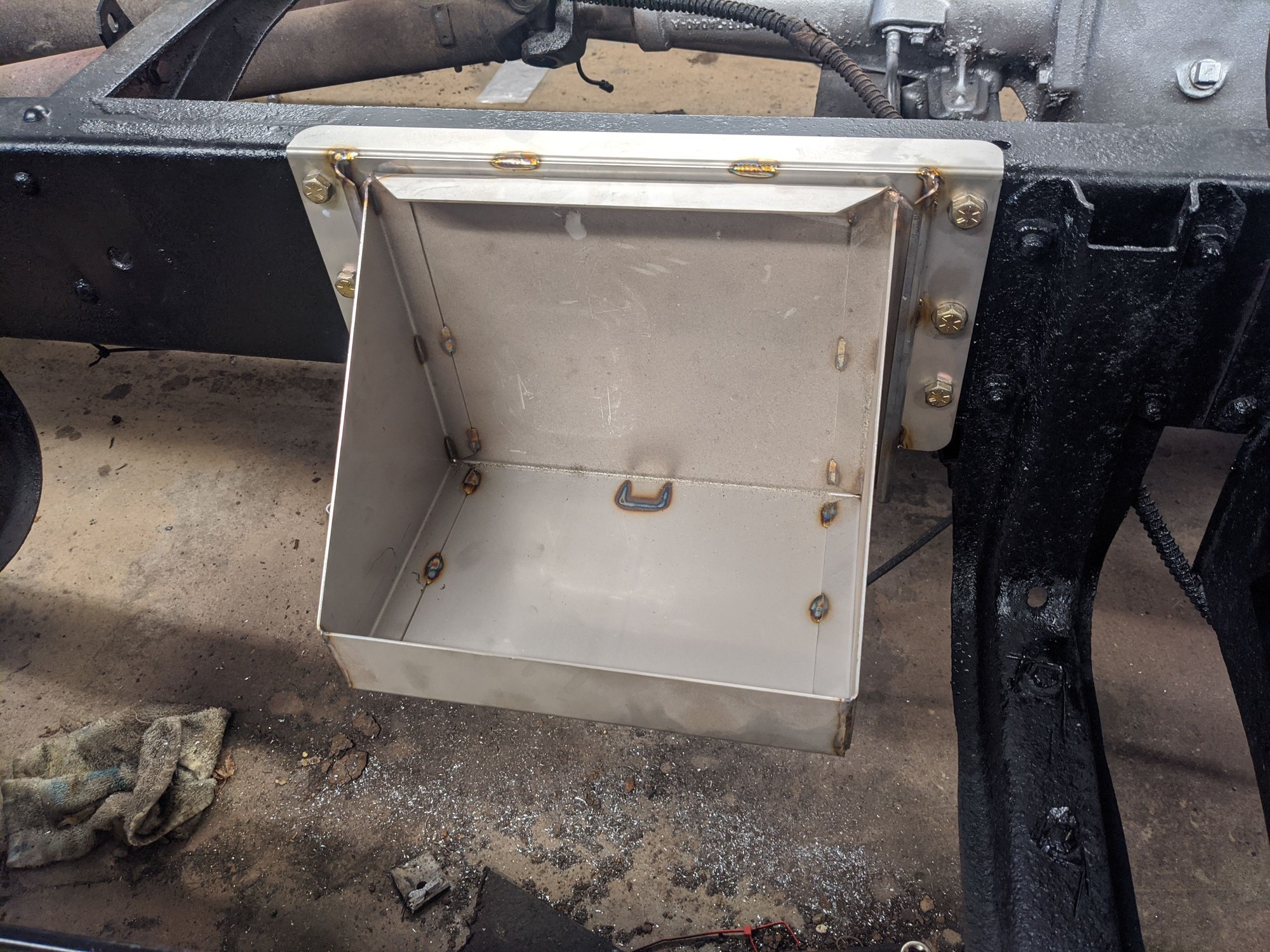

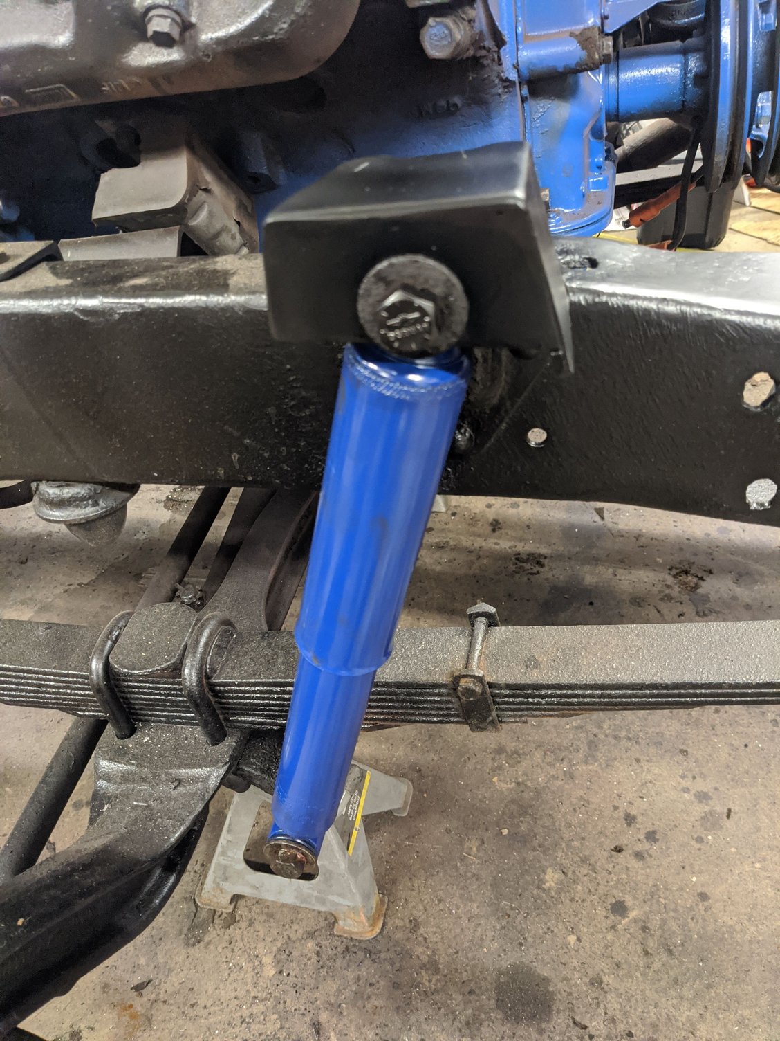

I've reached a tipping point in the project. I typically wouldn't post such a minor update but I hit a major milestone today! I installed two items in their final spot...not mocked up. I believe that means I'm on the right side of it!
Front shock...installed.
Battery box...installed. I put it a few inches behind the original location. It is the drop down style but I am hoping I'll be able to access it through the floor too.

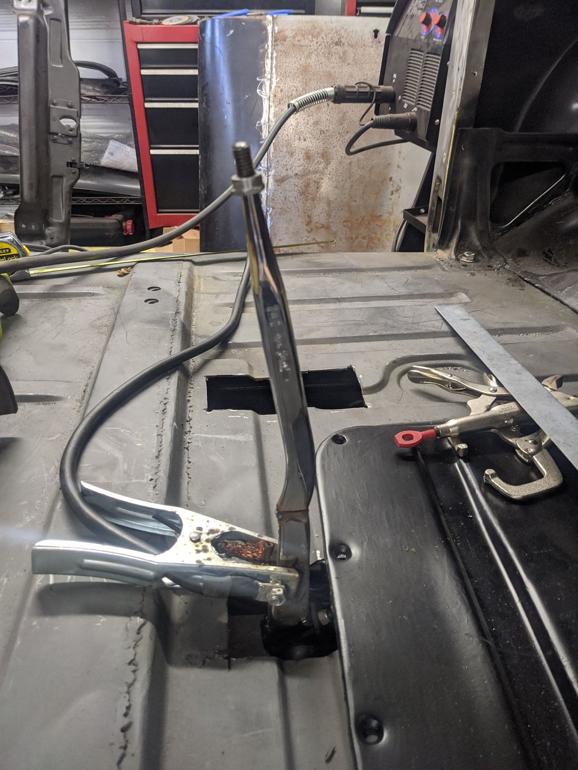

My Hurst shifter that came with the chassis was leaned back so far that it touched the bucket seat.
So I cut it and re-welded into a more comfortable position. I'll end up painting the lower part black and do some sort of transition to the upper chrome. Need to see where the shifter boot sits first.
