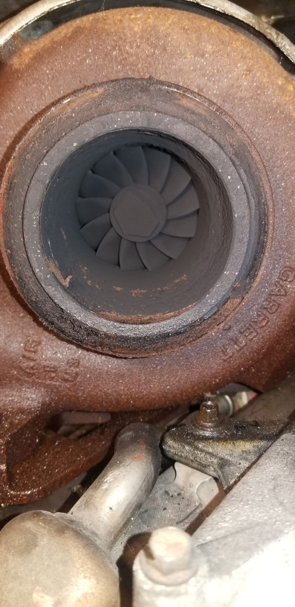

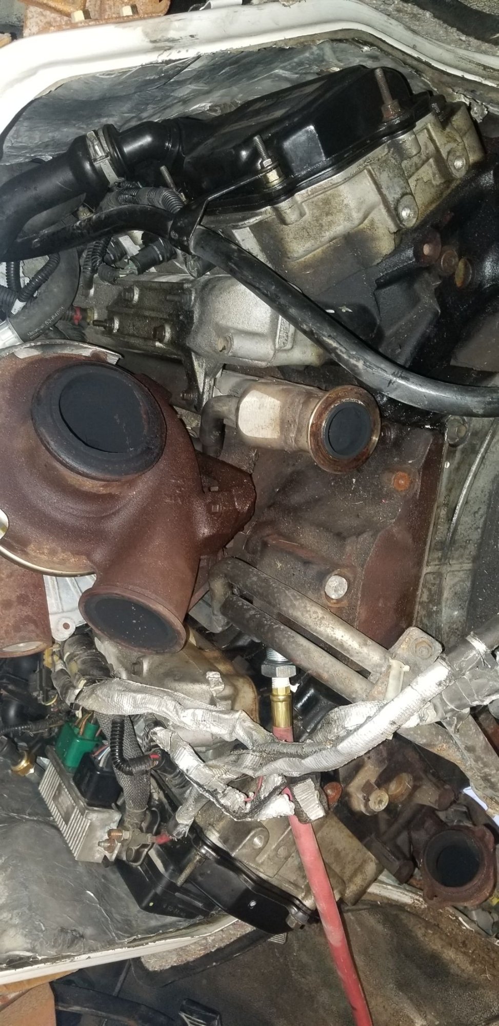

here's my repair view...any suggestions to lessen removals will be awesome. I bought an Ebay egr delete kit but wont use it. But that orange hose looks like crap off the egr cooler and may use the blue hose that came with it. . I'll probably have my buddy weld the cooler up

I dont know why I cant post more than one pic....any suggestions to clean the turbo as well

Now i know why i like my open hood truck. Man that has to be a m_____ f_____to work on.
On the turbow cleaning its not hard. DEISEL Tech Ron has a very good short video on it.
Believe it or not, turbo removal on an E-Series is not all that bad. The hardest part is to remove the turbo air inlet and outlet tubes. But once they're removed, the turbo itself can be finessed out with only a slight effort. Once the turbo is out, access to the HPOP is fairly simple.
