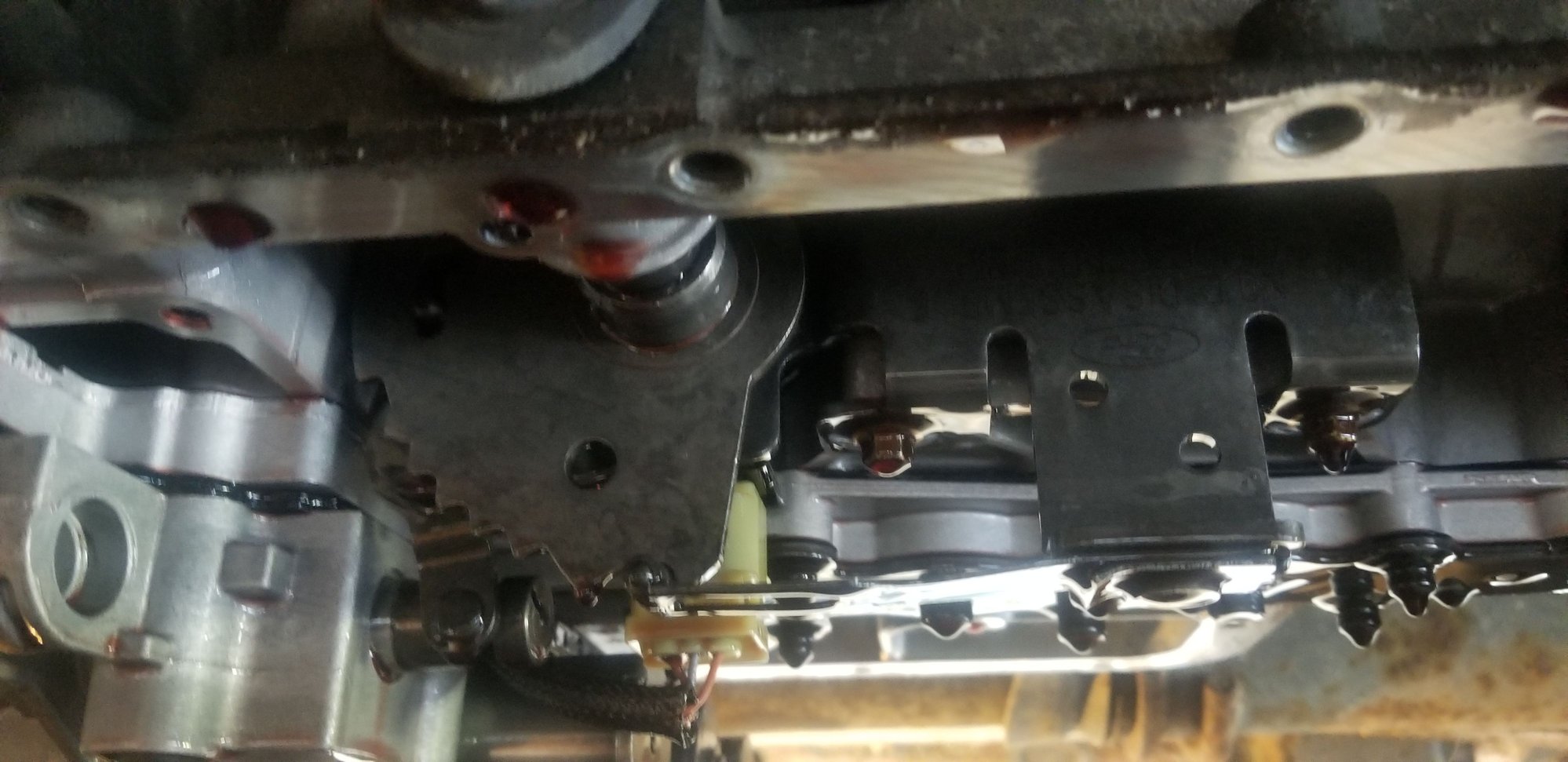

As I play the waiting game I'm looking around about how to remove the nss. Not much luck but I havent really looked at in on the trans that close yet other than to discover i have the wrong part. What I am seeing is how this type of trans and switch rarely have a failure and that code p1705 is probably caused by the fan clutch? and not the nss.

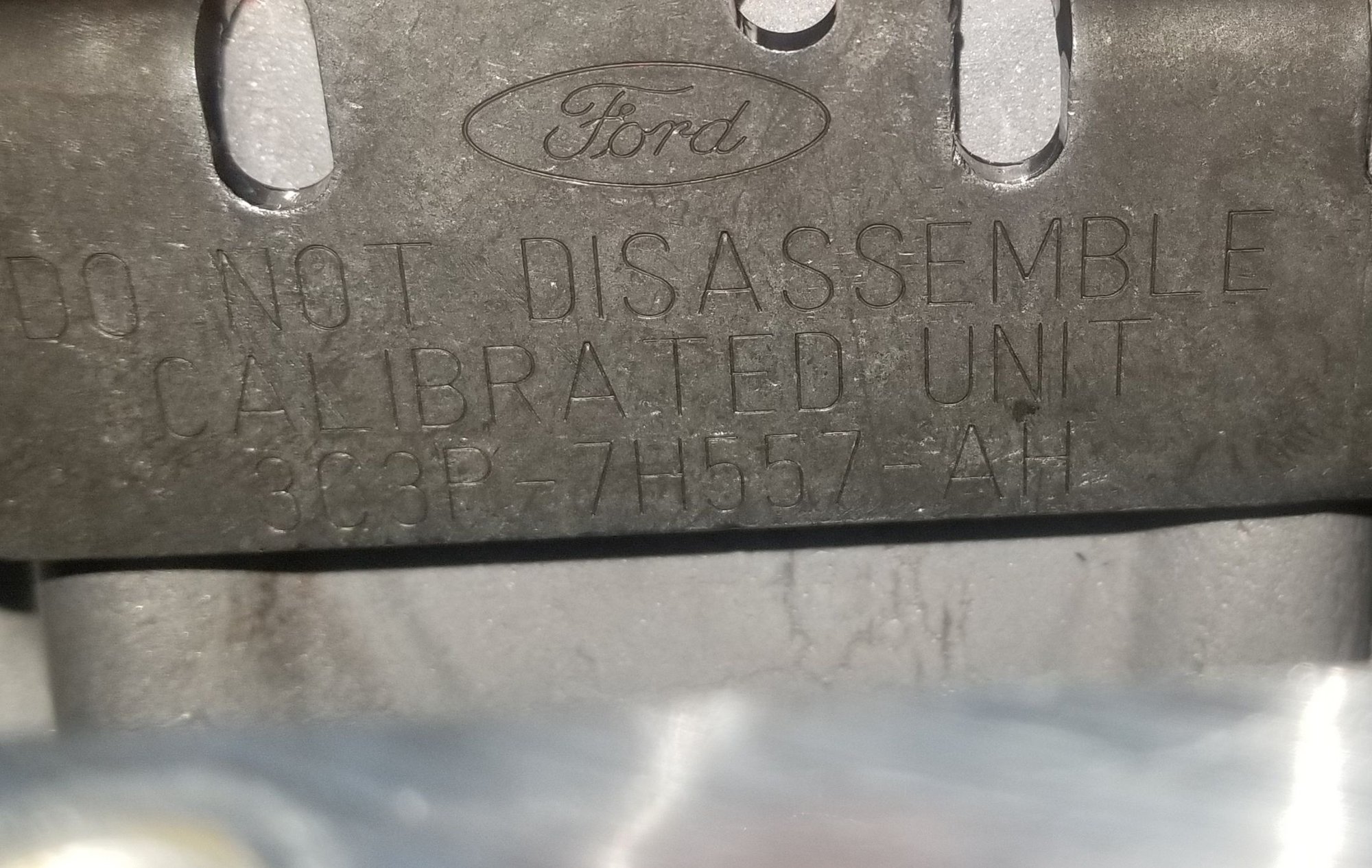

And of course this lovely ford note....

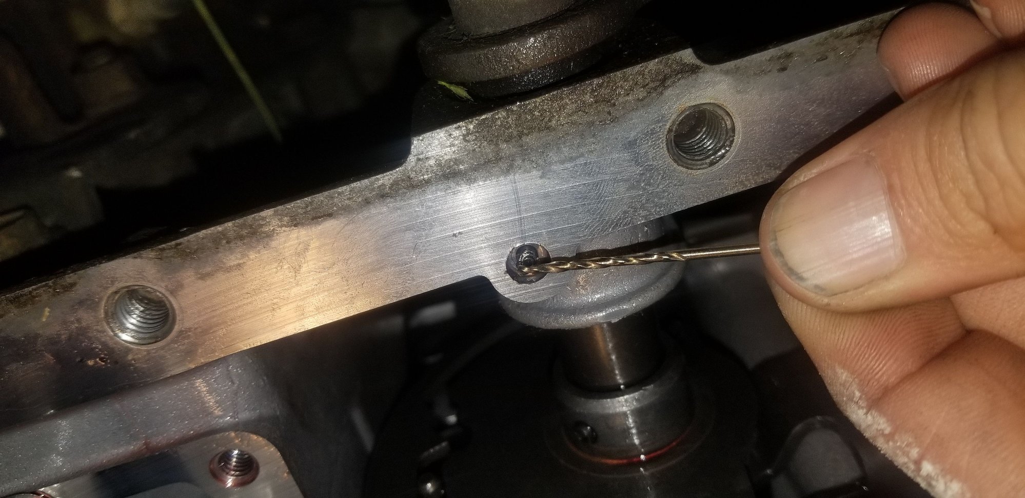

I brought some of my dremel drill bits to try and feed into it.. hopefully I can just grab the one with pliers but nothing has been easy on this

Is that tool tip finer than this easy out?

So i got this one out with needle nose pliers and kung foo mastery...
