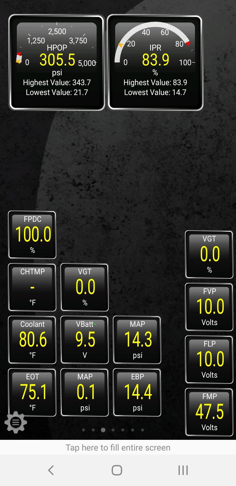

Now how long should it take to fill the oil rails? I've been cranking here and there for a few hours and had it charging and its definitely trying to start. Just not getting it to fully go. No engine codes other than the p0100 or whatever but it needs ran for that. Here are the numbers after cranking

Well ya don't have 500 psi to start with. ???? Didn't you close the book on high preasure leak. Seems to me you have one.

I never did the pump...

Before you add that to the path of repair on this vehicle, I’d recheck those pipes and plugs this thread started with using air pressure to see they didn’t go wonky on install. Also check around the nipple seals.

Well I took the Chinese ipr I used out. Replaced with an oem I removed and updated the screen and orings. The ipr connector would rock so maybe that was the problem.
I never did an air test. I do have the ipr fitting to do it just dont know how to do it. Does forscan activate the icp?
