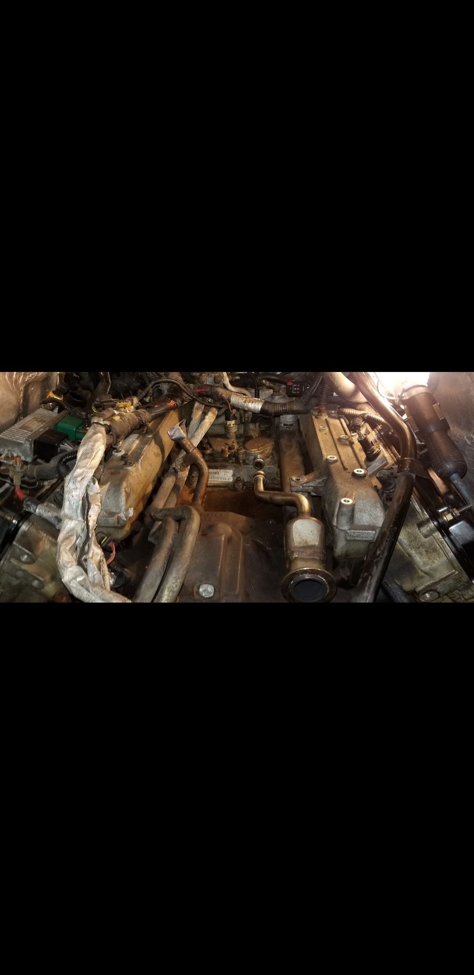

Well I have to take the egr cooler off cant get pedestal off..
No you don't. The pedestal will come out with a bit of finessing. What you may have to do though, is remove the one bolt that secures the oil supply and return lines to the oil filter housing to the back of the adapter plate on top of the oil cooler. This along with the three 10mm bolts that secure the oil filter housing to the upper oil pan will enable you to move the lines back far enough to twist the turbo pedestal out.

I wish I had seen this while i was still out there. I started draining coolant and took off the alternator and started to take the intake off....I'll go your route in the morning.
The tube that comes into the turbo is what I was fighting getting that pedestal out. It's that dang u clamp welded on it. I tried to just spin it until I seen it was attached.
Btw is there a tensioner pulley? I was able to just lift and take the belt off the alt?
Took the egr out and it was replaced not to long before it went down so it wasnt all groady...but the coolant line for it was black water
