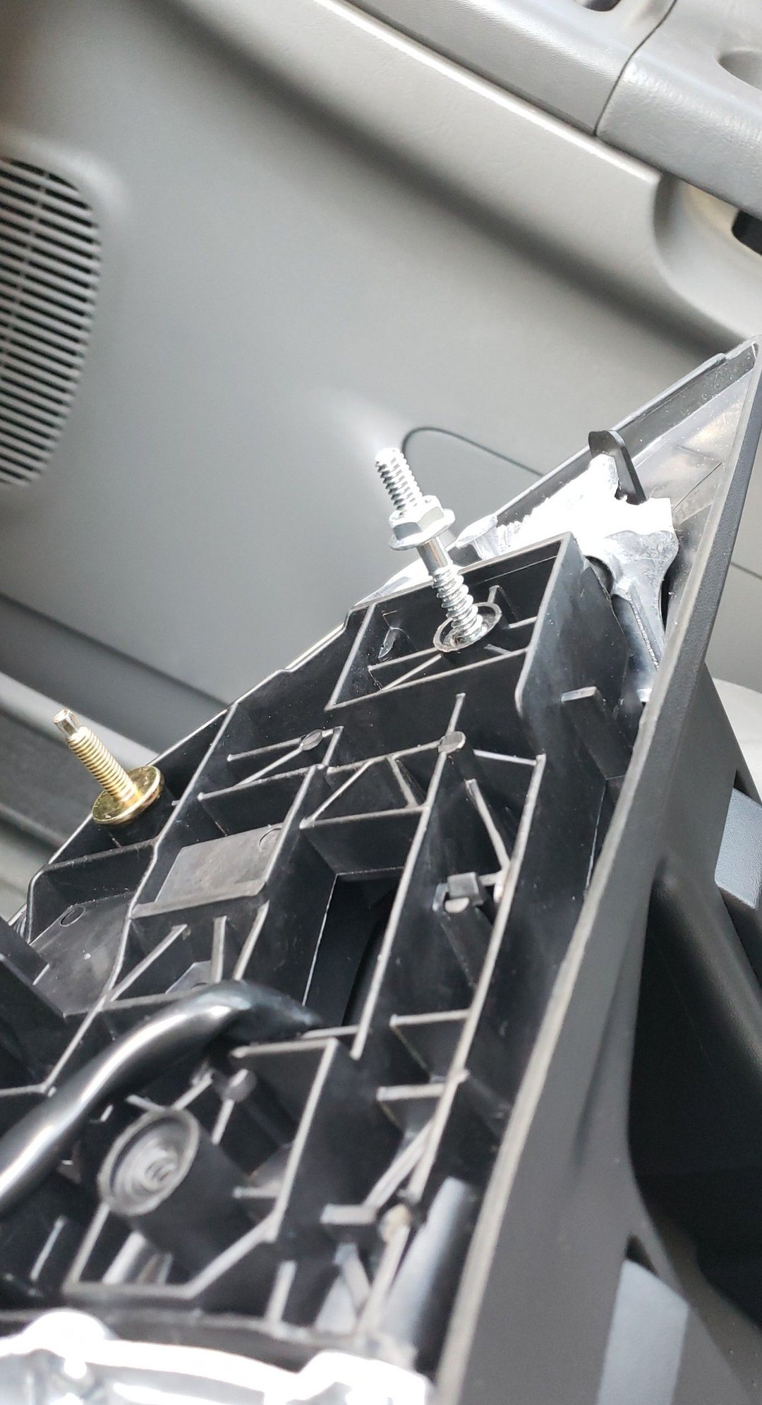

So I was able to find a hanger bolt that was a tad larger than the one they provided. I also grabbed a nut that fit the fine threaded side. Screwed it into the plastic and bolted it all up. Of course I have to sand down some of the bolt posts that weren't allowing the mirror to sit flush. That was pretty easy. It's not 100% flush but you can't tell unless you get up close to it and stare at it. I also added some more foam strip just for extra on both sides. I did route ground and power for the daytime running bulbs, but have yet to wire them into my light switch. Since I don't think I will be hooking up the turn signals I may just join both lights together inside the mirror and run those to both come on for both mirrors.

If it's not too late, I'd like to see some pictures of how you repaired your mounting bolt with the hanger bolt. Like I said above, I may have to do the same thing with one of mine.

It is already bolted up, but I pretty much did what I mentioned above. Went to Lowes. I brought in the whole side mirror. Went through several hanger bolts till I found one that was very close in length and thread. After that I knew the nuts that came with the mirror would not fit the new hanger bolt thread. So I found a matching nut. IIRC it was a 1/4-20 or 20-1/4 size hanger bolt. When I tried screwing the hanger bolt into the plastic it was a bit tough (by hand), but I knew it would go in and be a snug fit which was good. When I got back home I used the nut to screw the hanger bolt in and then removed the nut. This set the hanger bolt nice and deep into the mirror. I also bought a 1/4" washer to replicate the others.
Actually I did have a picture. In this one I did not put the washer on yet.

That picture is helpful. Thanks.
