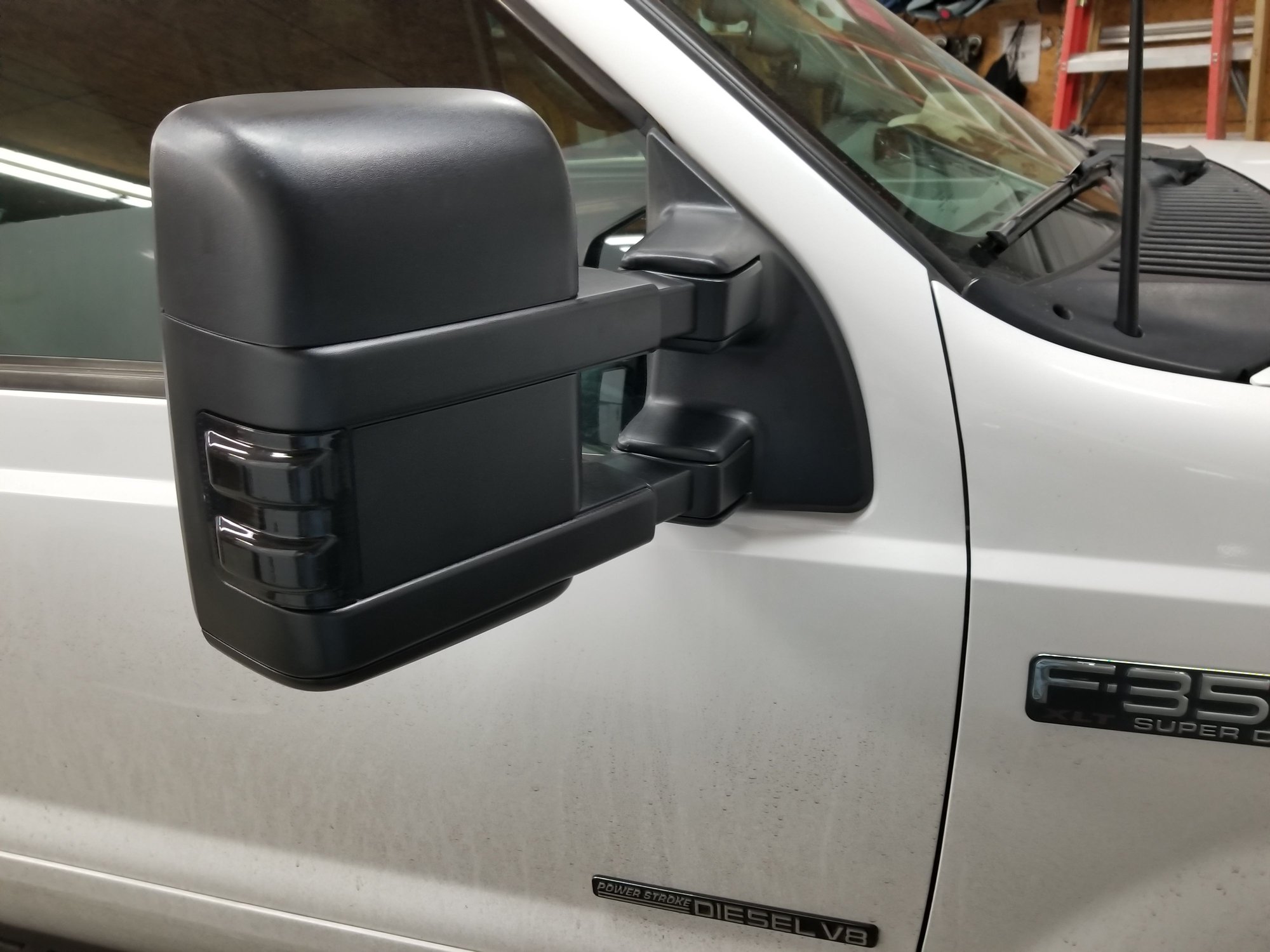

Mine arrived today and I installed them. Mixed feelings. Will they do the job? Yes, no question. Are they a good fit? Not really. I removed the studs and held each one between the socket and another nut driver and ground them down on the bench grinder so they would fit thru the outer door skin holes. (Be careful when you do this as one got away from me and buggared the threads pretty good, but luckily I had a metric die to re-thread it with). I cut off the plastic cross as recommended. When I went to fit them up the top would just not pull in tight. I looked up Sous thread about how he shaved the square protrusion from around the top stud, did that, still wouldn't pull up tight. Next I shaved a tiny bit off the plastic loop at the top that loops onto the die cast metal piece, I removed the top stud and shaved off the ridge where it screws in and I ground down the shoulder on the stud so it would seat all the way into the mirror. The top still would not pull in all the way, just like SRB150 reported in his post. Maybe I am just too picky. I do wish I had ordered the ones from 1A, but I will run these for now. Leaving for Mexico Wed, these should be a big help backing down the very narrow boat ramp down there as I can easily see the back wheels now. I will connect the turn signal later, but I don't need the heated mirrors in Tucson.
unscrew studs with a socket
they look and feel sturdy
Small gap at top, the OEM mirrors hugged tightly here.
how I held the studs for grinding on the bench grinder

So, there is something strange going on here. Either the molds for the mirrors being used are not the same or the door holes and mounting surfaces are not the same. We know afmedic had to modify the metal stud a bit, I did not. We know that I had to remove/cut some of the plastic off the back, not sure if others did. I cannot remember for sure what AllAboutMPG did, if anything to mount his mirrors successfully.
I do know that the mirrors I installed are tight and secured against the door and weather barrier, not like bigb56. I apologize for the troubles you may be having and feel bad for recommending a product that is not holding up to our expectations.
From here on out, I would recommend that anyone considering these mirrors be warned about possible fitment issues, or go with the 1A Auto mirrors as Stewart recommended above.

bigb56, yours fit exactly like mine do. I removed the DR side this weekend to fiddle around with it some more performing the same steps you did but these efforts made no change to the fitment. I gave up and will run them. I do hope they do not leak water and if they do, probably will add some foam gasket on the top edge. Comparing to the OEM take off, there is a big difference in build quality. You get what you pay for as we all know! I think they are worth the $120. Better versions are almost 2x so all in all, not terribly disappointing. Buyers be advised!

Sous , i got mine in today and they do look exactly like yours. They came very well wrapped and seem to be decent quality. i just bolted mine up without any modification, but they don't completely seal on the top edge( although its pretty close, i can still see a little of the insulation on the back of the mirror). what exactly are you guys modifying to make them fit better? i saw bigb56 was milling down the washer on the bolts but i don't see how that would help me as it seemed like there was a big enough hole on the outside doorskin

I had to trim down the same plastic piece on both mirrors in order for them to fit tight against the door. They do fit tight, just as close as the OEM mirrors did. It took me a few moments to figure out where they needed to be trimmed on the first one, but the second one went on within a few seconds. I did NOT have to trim down the lug as afmedic and bigb56 did. The holes in the door frame were more than large enough to fit the lug.
Below is a crude drawing of the only piece I trimmed down. I cut about 1/2" off the plastic piece indicated in red, which I cut with dykes or diagonal cutters.
Once this piece was trimmed, the mirrors fit very well.
