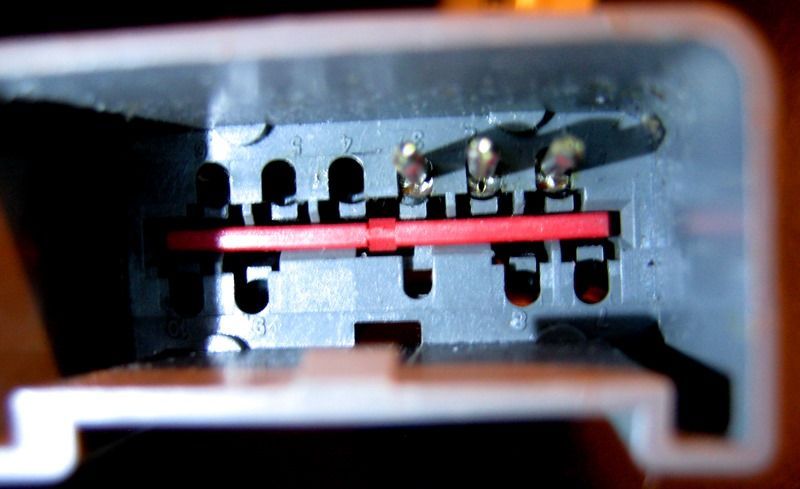

So in order to get heat, turn signals and mirror lamps I have to run new wire? The mirror's lamps don't come on just by plugging them into the factory connector? I already purchased them and haven't had time to look at them. I have an 03 model as well.
On the truck side, yes. Since you're truck does not have heat, turn, and marker lights from the factory there are no wires that run to the doors for those functions.
Some have run wire and spliced them into the mirror harness wires. Others have gotten the connector pins, crimped the new wires onto them, and inserted them into the mirror plug (truck side) for an OEM appearance. It also makes it easy to remove the mirror if you have an issue or want to replace them. I bought these connectors (Ford Wedgelock Pin Type Terminals 20-18 Gauge .060" Pin Diameter) but haven't installed them so don't know if they are the right ones. These are the ones that a couple of other users listed (F250RockStar and ligito) so I went for it.
I also have a timer relay to connect to the heat when I do the job too. The 6.0L trucks had heat but it was tied directly to a "hot in run" circuit so that any time the truck was on the mirror heat was too. I read complaints of spots on the mirrors so I didn't want the heat always on. Some have gotten a defroster switch from a '95 Explorer that has a built in timer. It is a similar appearance to what is already on the dash but is different enough that it doesn't pass my OCD test so I will use a regular switch with a relay wired in...just my preference.
Yes, those are the right ones.
With the round connector to rectangular connector translation harness, no wires on the truck or the mirror need to be cut or spliced, and there are now plenty of unused harness connector ports to add circuits for heat, running lamp, and signal lamp.
