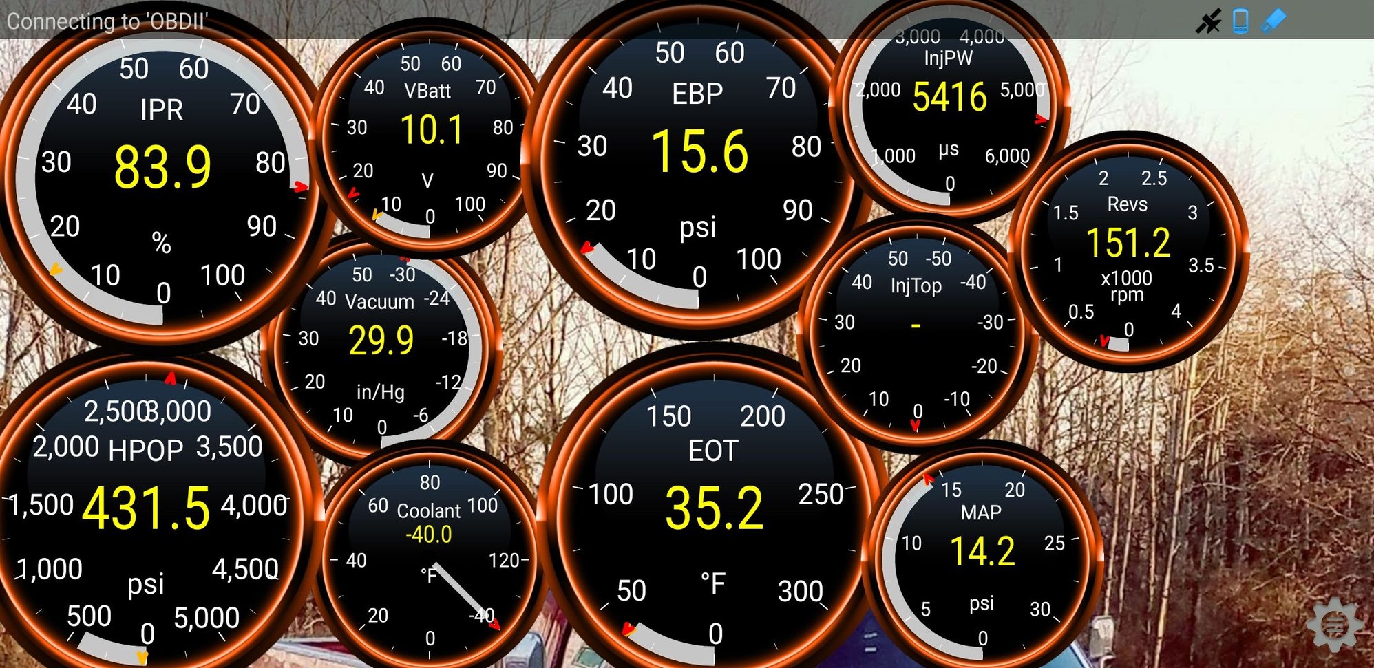

Originally Posted by Matt5214
yes the chip had been hooked back up but the truck fired with the chip? I will remove it this weekend and retry
this is tonight's readings just a quick shot at it not having time but rpms are low.

That injector pulse width makes sense if it's microseconds. It would be . 4 milliseconds, which makes sense.
If there is a chip in the equation, step one should have been to remove it from the PCM. Don't just unplug the switch, remove the chip from the PCM. I didn't realize the truck was chipped or I would have suggested that long ago.
I will do so this weekend I posted new readings above. My question is why would everything start to go up now but rpms are dropping.
Batteries getting weak. Temp dropping (presumably EOT aprx. = outside temp).
