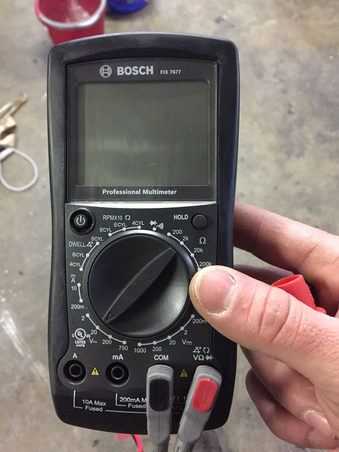

Originally Posted by crucialprospect
Im lost now. I plan to spend all day figuring this out.
Um, no, there's no need to do that. If that high AC voltage measurement is accurate, you've found a MAJOR problem. Confirm the accuracy of the ACV setting as detailed in post #224. If the meter is accurate, stop what you're doing and proceed posthaste to get a new alternator. Get a quality brand unit, not the same as presently installed.

i shut it off, left lights and heater on for 5 minutes, in the meantime I tested a wall socket just as you instructed, and it showed 120volts. Went back to the truck, voltage dropped to 11.4 volts and it still fired up no problem.​​​​​​​​​​​​​​​​​​​​​ Testing right at the alternator stud and battery ground I still showed 27.3​​​​​​​i​​​​​​​​​​​​​​​​​​​​​​​​​​​​​​​​​​​​​​​​​​​​​​​​​​​
Sounds like your meter is accurate on the ACV setting. But just to be triple sure, that 27.3 reading is with the engine running, right?
With the engine off, the ACV reading drops off to zero, or nearly so?
If yes to both questions, my next question is what brand of alternator will you be purchasing?

No to the second part of the question, engine off in both test vehicles, shows 27.3 volts ac

I'm heading to the parts store and either buying an alternator or a new voltmeter.....
Oh crap, I thought we were on to something. Throw away that meter and get a new one.
Good thing we confirmed the meter was inaccurate.
