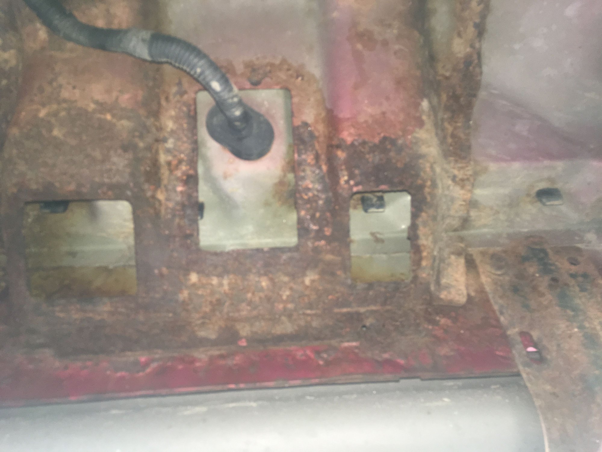

Running boards removed, and some inner rocker rust to deal with. The area where the front mount for the running boards was rusted pretty bad, but the rest is still ok. Anybody have a feeling as to whether it would be sufficient to grind all the rust in those areas and then just cover the hole with new metal?

Rocker Panel Replacement
Well, I was able to get one of my rear rockers replaced this weekend. There are a few lessons that I learned while doing this.
1. Don't wait. This time last year, I noticed they were getting bad so I ordered the rockers and some body panel adhesive. Then I sat on them and didn't do the replacement. Don't! Inside a year, they rusted all the way through and the inners got bad enough that I had to cut some away.
2. The harbor freight spot weld cutter works pretty good, and is pretty cheap. The only real downside to them is that they are a bit long if you're using a regular drill up next to the door hinge. A trip to harbor freight for a "close quarter" drill worked fine since I don't have an angle drill. Clean off the area and maybe grind it down flat with a flapper wheel if the metal is warped. Hit it in the center with a ***** punch to get a dimple. They run through pretty good with medium to high speed and light pressure. If they get caught in the metal, the teeth on the cutter will break. They are double sided, but I found that after I broke one side I couldn't unscrew it to use the other side, so I bought a couple more. Assume they are one sided.
3. Pay attention to where you paint the new rocker if painting before installation. I taped mine off along the edge but then painted them on the ends. Had to scrape the new paint off and then sand the area for the panel adhesive. You want a nice clean surface for that stuff to bond well.
I've never done body work in my life, and this was easy but a bit time consuming. Overall, it took me about 5 hours by the time I was done. But, it's fairly easy to do if you have the right tools and a little patience. On to the pics...
Inner rocker is toast
