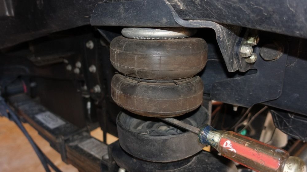

Yep, I really like and am very satisfied with the Daystar concept.
The Deaver full pack has about 15 inches of travel.
In case some are looking at this thread still unfamiliar with the Daystar's here is a pic showing how they can allow for so much travel...
