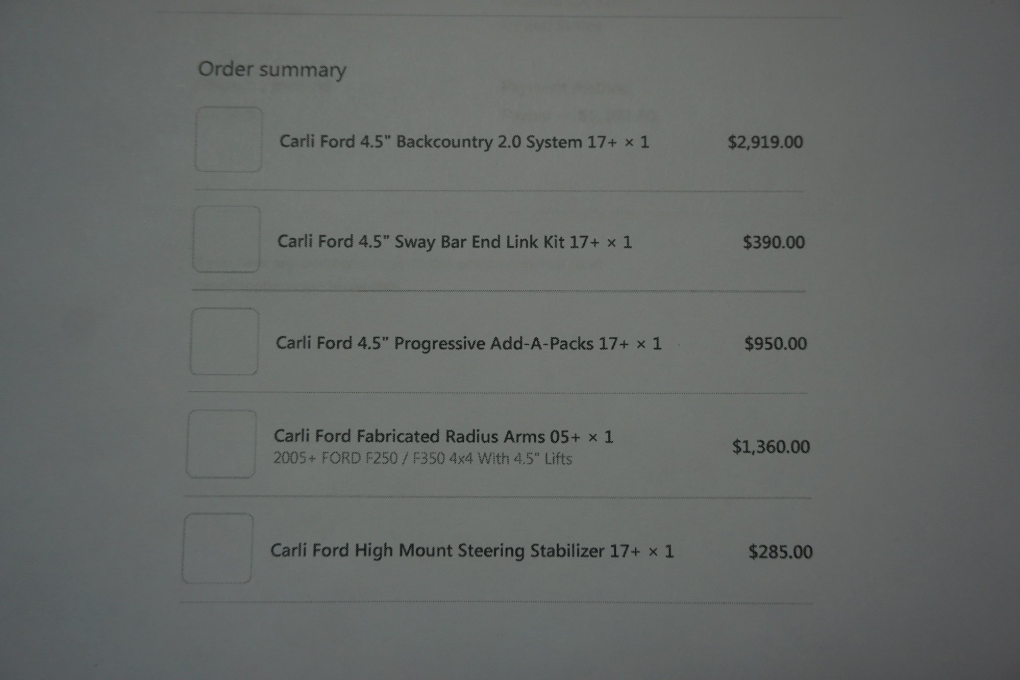

Hello everyone, I have just ordered the parts to start building a Carli equipped F-250. My main question is how much do the Add-A-Packs effect the rake? I prefer a leveled look so my goal is to get rid of the factory rake.
Leave the rear stock. See how you like it first (and save $950 or put it towards 2.5" shocks - Fox or King). You can always move to add-a-leaf later. All that does is remove the factory block with their add-a-leaf. If I remember right, it will also rake the car as I think it raises it .5"
You may want to look at adjustable radius arms from Lewis - similar price (maybe less expensive) but adjustable. Also the fox ATS steering stabilizer is an awesome unit and adjustable (but $100 more than what you got on that order sheet)
EDIT: I was correct, from Carli "Eliminates the Factory block and provides 1/2" of lift over stock"
