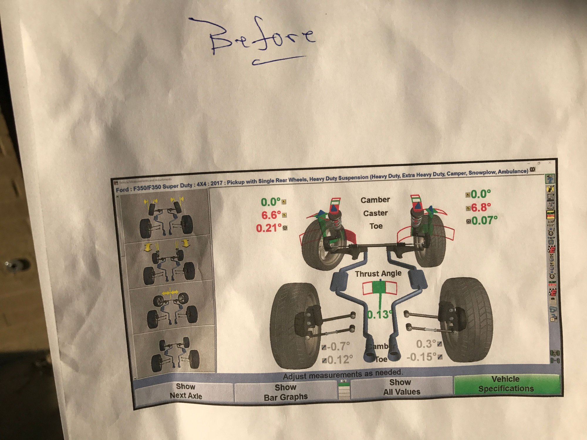

Installed the 4.5" backcountry 2.0 with fabricated radius arms and full leaf replacement this week. Also installed PMF dual stabilizer. I did not install the caster shims (carli instructions said to see how much caster the radius arms added, then add the caster shims if necessary). I think we hurried through the track bar install, and really didn't get it perfect. After the install, the truck had a horrible wander and oversteer. I didn't notice any bumpsteer.
Alignment showed the only measurement really out was caster, at 6.6 and 6.8. The alignment shop corrected it to 5.4 and 5.5,
and said that was the most they could correct it without pushing out the camber. They recommended installing adjustable ball joints to lower caster to their goal of 4. I mentioned to them that Carli recommends 4.5, but seemed to fall on deaf ears.
After alignment, the truck does drive better. No noticeable difference from stock at slow speeds, but still has some wandering and what feels like oversteer at faster speeds (maybe 30mph and up).
Does anyone think replacing the ball joints and further reducing caster will help? Or could this be more related to the track bar not installed properly?

i find it hard to believe the caster went from 2..* range stock, up to 6.7 and 6.8* with the carli kit.
I think the shop is wrong

I am by no means an alignment expert but I have done a lot of reading on the subject before adding Carli's 2.5 Pintop (no arms). My truck drives perfectly with caster at 3.6.
I have not come across caster readings as high as yours in my reading. Perhaps the radius arms make a difference but I too would be suspicious of the readings being incorrect.
In your place I would feel most comfortable getting another machine to read the numbers before modifying the truck further.
How did they correct it? I’m moving from a 2.5 to a 4.5. I don’t have my oem caster shims and they list 4 different possibilities for my vin#. I asked about flipping the 1* shim in the 4.5 kit but they said that will mess up the camber. The radius arms are supposed to correct the caster like you said. The shims are for the 4.5 kit with out the arms..

I haven't taken it back. The u-bolts were loose on one side of the rear. Tightened everything up, and now drives just like stock. I will see how the tires wear for the next few months and get another alignment if needed.
The Carli instructions for the fabricated radius arms recommended keeping OEM shims and only change them if additional caster is needed during alignment. The alignment shop left my OEM castor shims in place.
