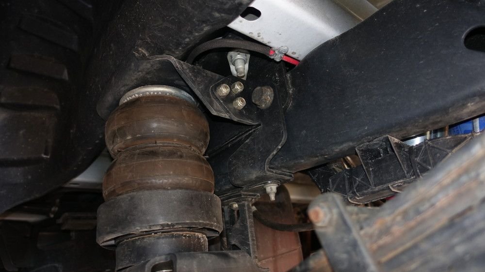

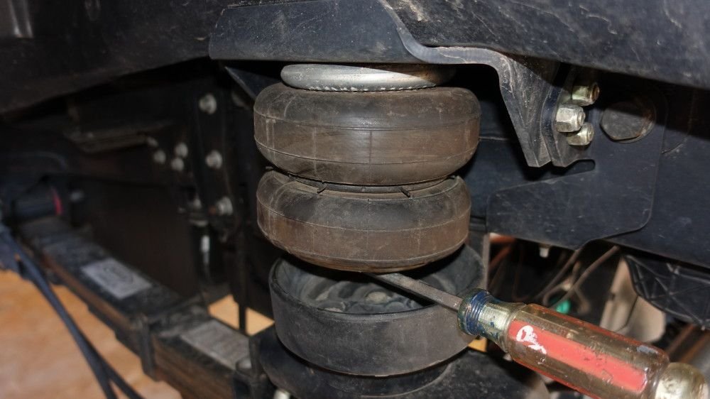

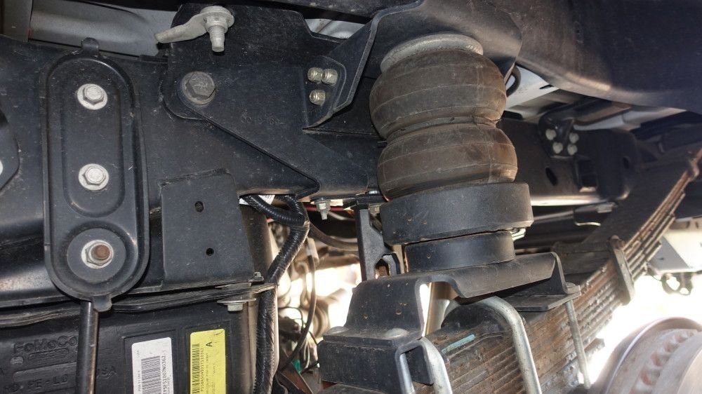

Originally Posted by f350ktm
OK Josh, here you go.
Some pics of the 'over the spring' setup...
Looking from the front angle...
Looking from the rear angle...
From the inside...
From below...
I then deflated the bags so you can see the relationship between the bags and the Daystar cups. I pushed the bags up with the screwdriver so you can see clearly.
When deflated the bags sit fully down in the cups and make 'kissing' contact only, no support...
The Deaver tags...

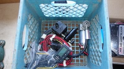

Some of my On Board Air components have been patiently awaiting me on the work bench. I had a bad get-off on my dirt bike last December and am just now getting back to being able to work under the truck looking up. This will be my next project.
Hope the pictures help. Best of luck in setting up your rig.
NEW TO THE FORUM AND VERY GLAD I found this post! I was at my wit's end with a way to add air bags to my Carli 2.5 Pintop until I found this. Just installed the Ride rite's and Air Lift Wireless air with the Daystar cradles yesterday and so far, so good. I'm wondering what pressures you have found allow the air bag to just "kiss" the cradle as you described? For me (2019 F-250 CC 4x4 6.7L) it appears to be about 30-35 psi.

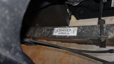

I am running the Dexter springs which will make a difference if you are on stock springs.
On the Dexters I run 5 psi with an empty bed. With 3,000 lbs on the pin with the 5th wheel I run 75 to 85 lbs depending on the terrain.
I have never had an issue with the Daystars at 5 psi on pavement.
Off road with a relatively empty bed I run 25 to 30 psi, again never an issue with the Daystars.
I am 100% happy with my setup both on road empty and towing. Off road it's simply amazing.
My wife no longer wants to ride in her Lexus as the truck is so much more comfortable.
Good luck
Good luck
f350ktm, thanks for chiming in. I've got the exact spring ID sticker in your photo, so likely identical setup. Since yesterday I've run the bags at about 35 psi, but on pavement only tomorrow I'm going to try the 5 psi setting, which has the bottom of the bags a good inch or more above the Daystar cradles. Have you noticed any wear on the lower/outer portion of the air bag bellow chamber due to compression against the outer edge of the Daystars? I'm not too concerned about this because the Daystars do really seem to "cradle" the entire bag, but was curious.
So at 5psi on my truck the bags are down in the cradles but not touching the bottom of the cradles.
My truck does have a spray in bed liner and a small toolbox in the front of the bed but not much weight there.
This may be enough weight however to set my bags a bit lower in the cradles.
I also have a Transfer Flow 60 gallon tank but it is mounted to the frame and sits fairly far forward. I imagine it may also pull my box down somewhat.
Regardless my bags have no sign of rub wear.

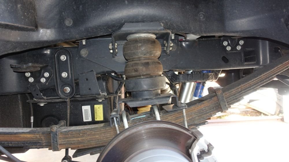

By the way, I assume you saw the spacer under my Daystars
Thanks! I just looked again, I do have the spacer and the bottom of the bag is about 1/2-3/4" from the cradle "seat" at 5psi, not quite as high as I stated earlier. The alignment of the bags is not perfect, but they sit down into the cradle pretty well when inflated.

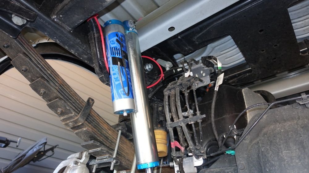

I’m in Montana and have a set of add a packs that have never been used just opened the box. Thought I’d see if anyone on here might want them
Old Jul 14, 2021 | 09:58 AM
  #450
bheath26's Avatar
bheath26
Joined: May 2018
Posts: 114
@f350ktm Is that a special mount you got for your reservoirs on the rear shocks? Mine have the hose, or am I missing something? Hoping to install this weekend
