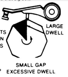

Originally Posted by JEFFFAFA
Those old points were toast. 38 is too high which means the points aren't opening enough. You see, Dwell is the amount of time the points are "closed" and the coil is saturating. Measured in degrees of Dizzy rotation. So a high dwell number means the points are staying closed too long. Ford always listed 30 degrees for a V8. GM always said 28-32. So if you adjust to 29,30, or 31 that would be fine. One trick you might try is with a helper.
Have the helper crank the engine while you are adjusting the points. WATCH OUT FOR THE FAN! Use 2 screwdrivers. One for adjusting and the 2nd to tighten the point's screws once you got them adjusted and are holding them there. As the engine is spinning over the dwell meter's needle will bounce back and forth about 15 degrees or so. The middle of the bounce sweep is where the points are adjusted at that moment. So as the helper is spinning the engine over adjust the points so 30 is in the middle of the bounce. Hold the points there, tighten both of the screws, then check the dwell with the engine idling. It will sound a lot better than your video above. Also double check the timing after you get the points adjusted. Adjusting the points changes the timing.

That's impossible. Maybe your Dwell Meter is defective?
If the points gap changes the dwell HAS to change. If the points are more Open that means they are Closed less time during Dizzy rotation. Notice on the pic below the point's rubbing block is at the very crest of the Dizzy's cam lobe. That is where the rubbing block has to be when you adjust the points. You can bump the starter to get it close then use the big bolt in the middle of the vibration damper to move the crankshaft a tiny bit at a time. The crank moves the timing chain. Which moves the camshaft. Which moves the Dizzy. So you can dial in EXACTLY the rotation of the Dizzy and it's cam lobes via that big bolt.
Now there is one other thing. Maybe after you adjust the points they close back up while you are tightening the screws. Notice in the pic below both the screw holes in the points are slotted. The hole right by the points I'll call the Adjustment end. And the other side the Pivot end. The screw at the pivot end should be kinda tight when you are adjusting points. JUST loose enough where you can adjust them. But tight enough where they won't move as you tighten the screws. Also with your screwdriver, hold the points in adjustment as you tighten the screws with a 2nd screwdriver.
AWWWW MAN!!!! YOU GOTTA BE KIDDING ME!!!
I jacked with those points forever setting them ON THE LOBE peak....
Well, I guess that's the problem huh?
I was using the big nut/bolt on the main pulley to get it right at the top. I'll get that straightened out today. Probably shouldn't run it that way....
So much for impossible. It must be impossible to have the dwell not change when you're on the flat spot, but when you're on the Peak of the Lobe, it is possible because it's completely WRONG!
So, I'll set the points correctly this time and reset the timing too and wee where we're at.
Thank JEFFFAFA......

If the gap is set on the flat, they will never close. Think about it.

When I said "crest" I meant the same thing as the "peak". Same, same. The points are set on the crest/peak of the Dizzy's cam lope.

So, now I feel like a complete moron since it seems I can't even learn FROM PICTURES!!
Ok. so the points must be moving after I set them.....on the crest....not on the flat....
I'll reset them again and see what happens.
