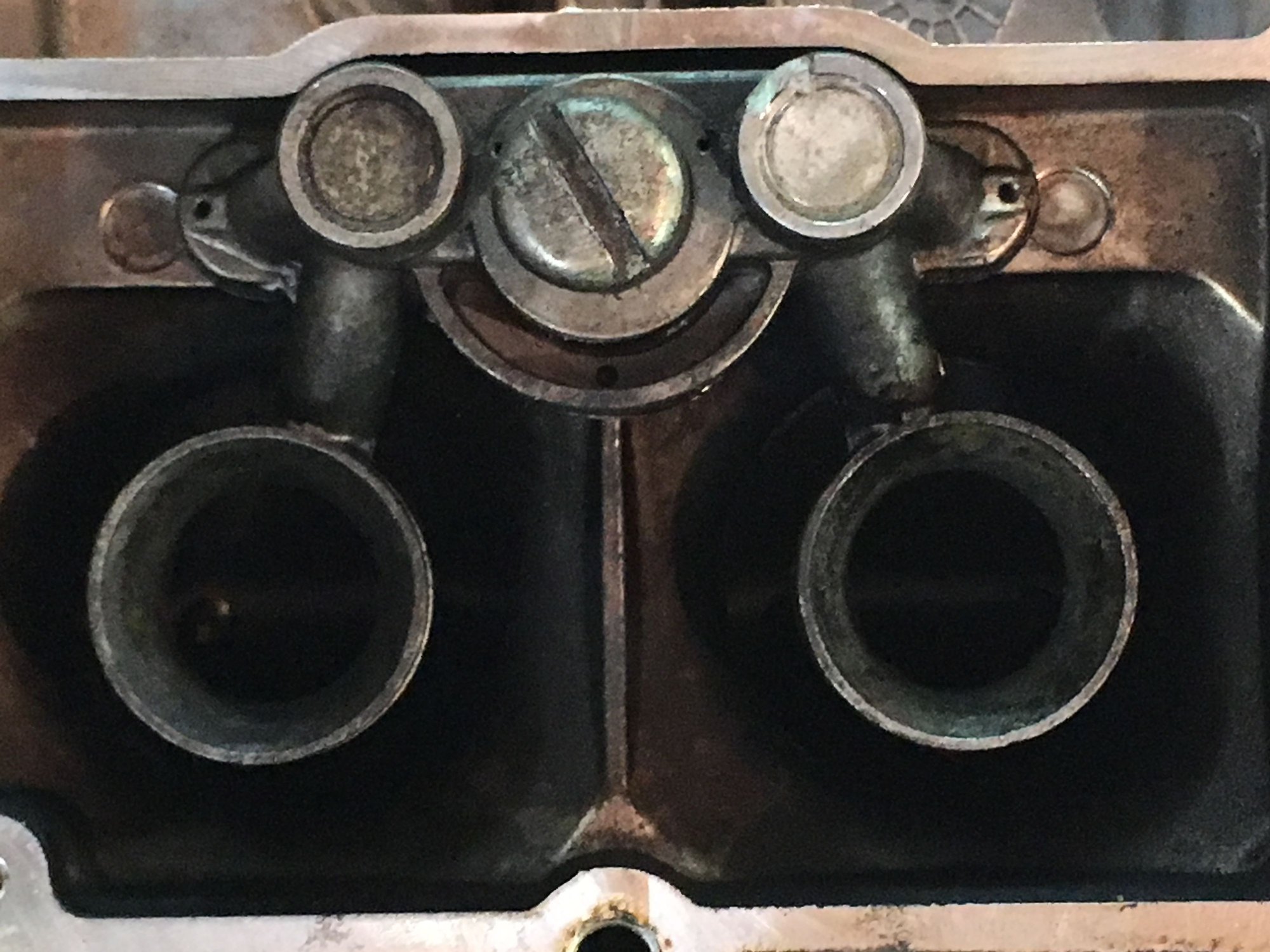

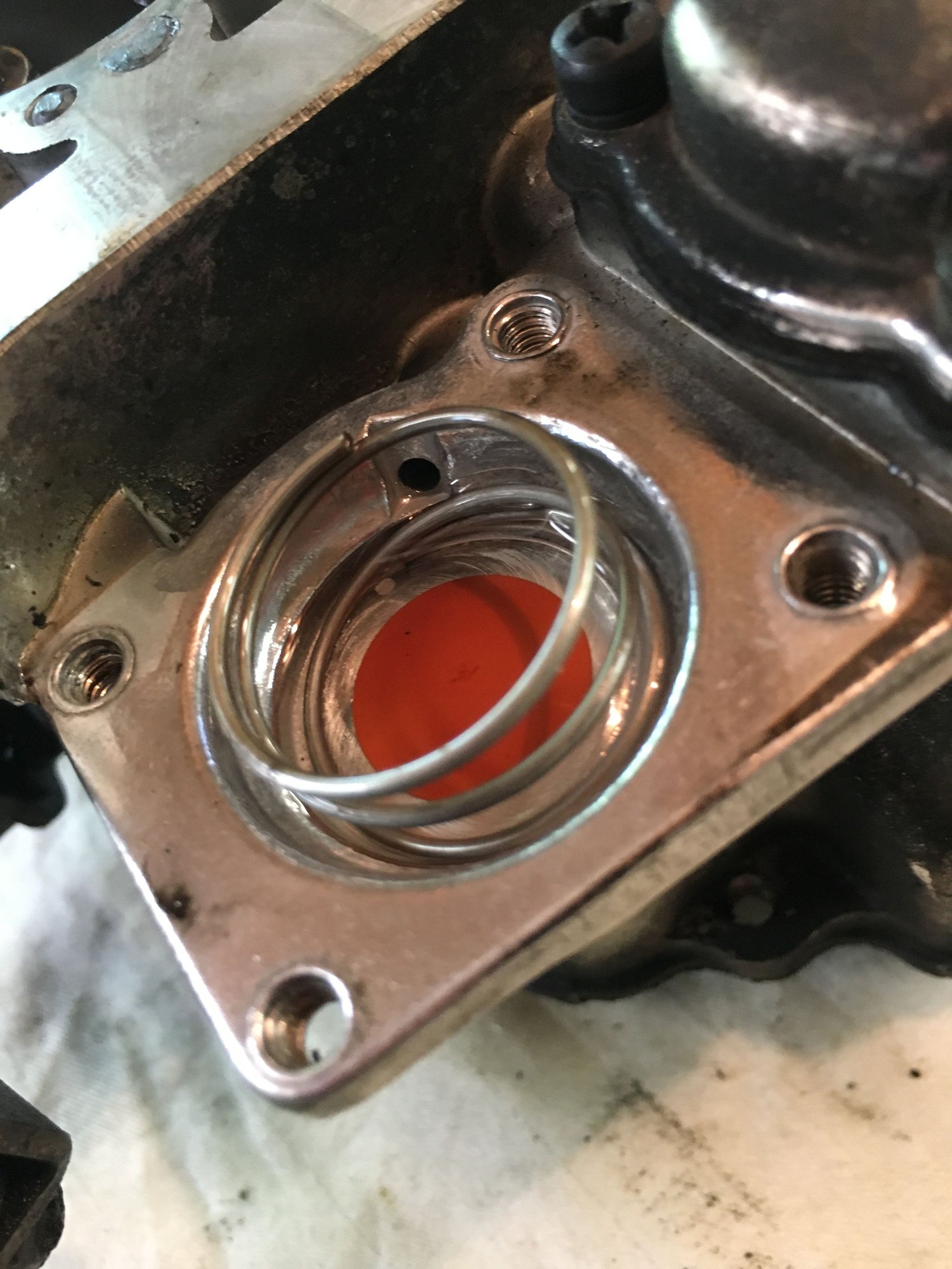

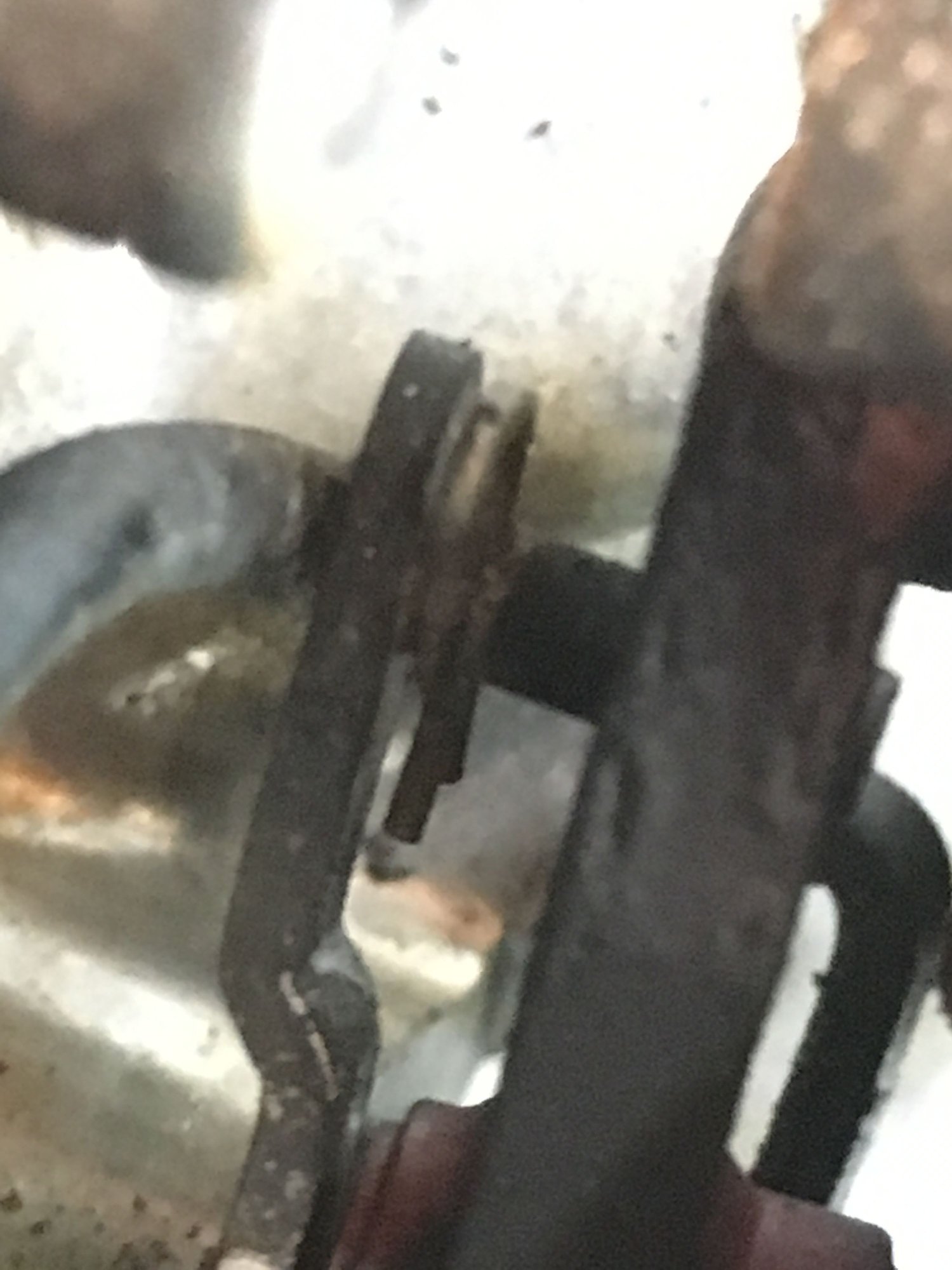

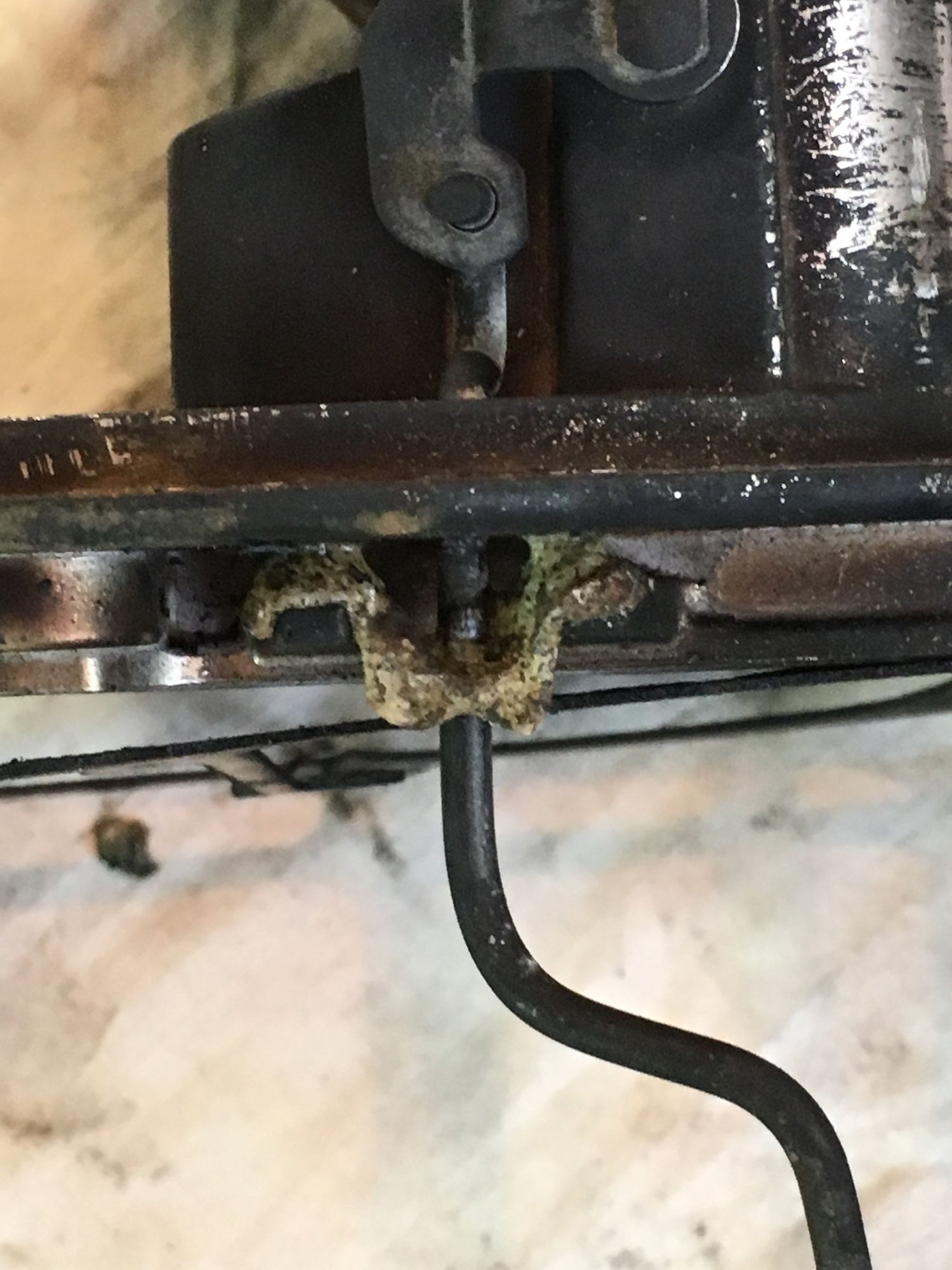

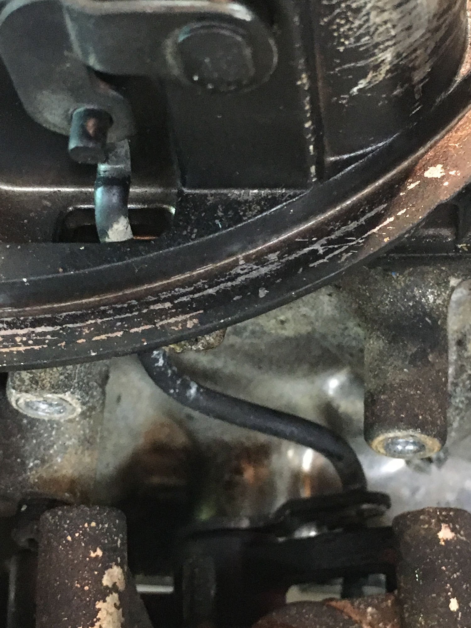

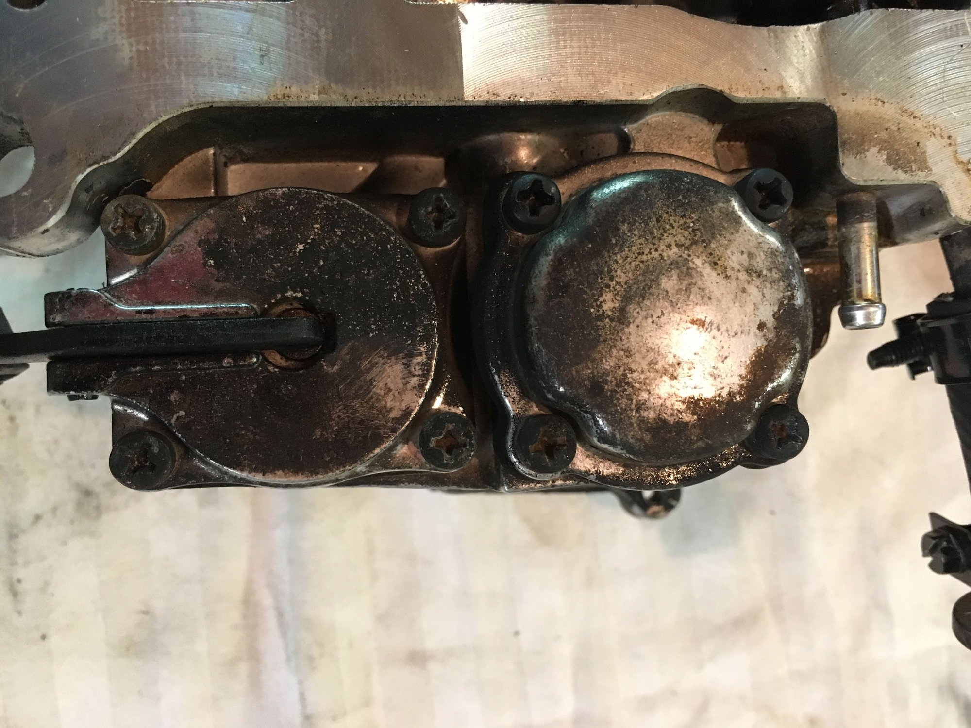

I ended up setting the timing at 8. I'm posting a video right now and will put the link up. I'm about to just buy a new carb. Feeling frustrated with this right now. I'm going to post a ton of pictures from the rebuild project since I couldn't find ANY of this carb on the internet.
Old Apr 23, 2017 | 07:34 PM
  #64
treadstone00's Avatar
treadstone00
Joined: Apr 2017
Posts: 101

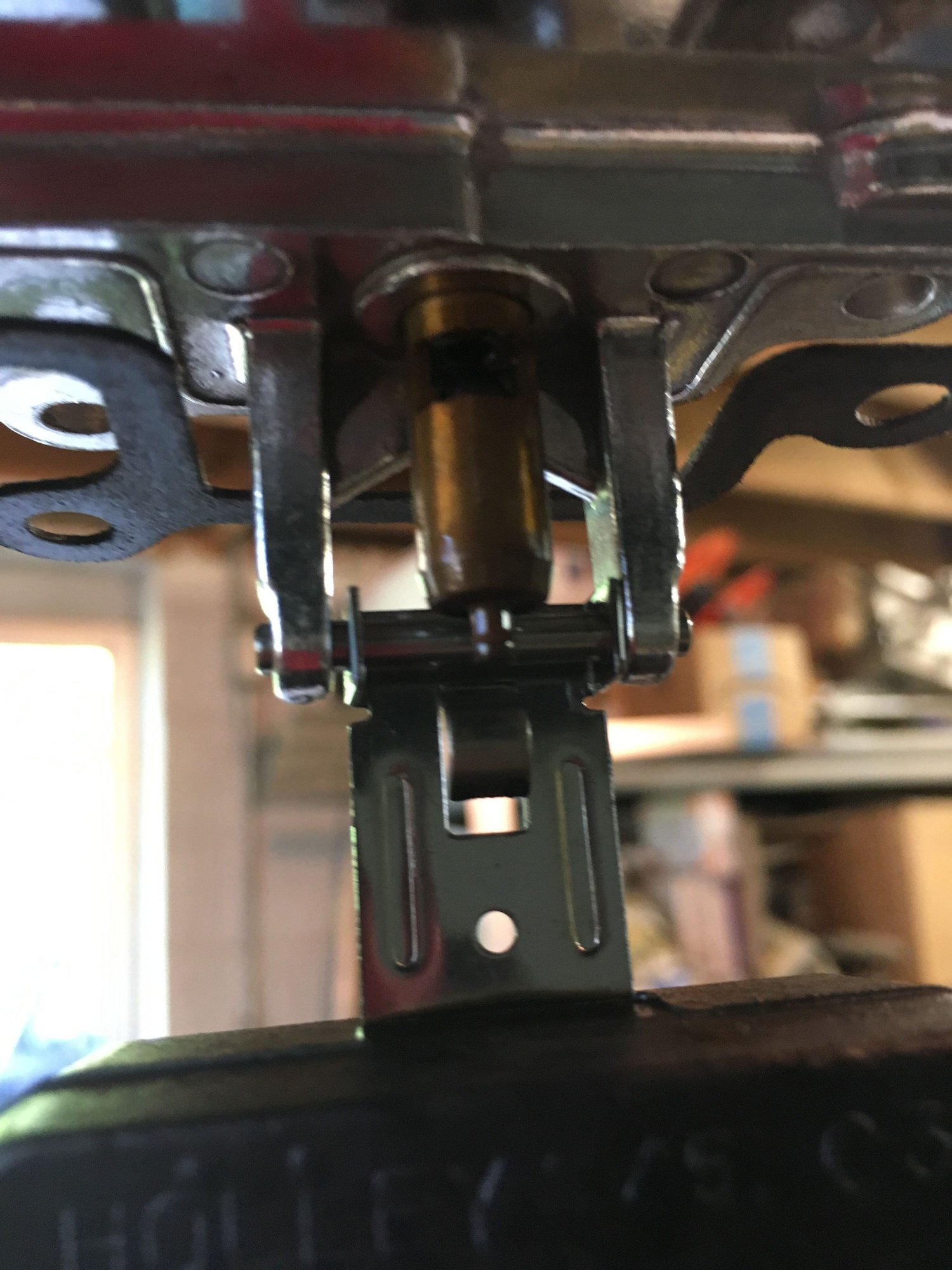

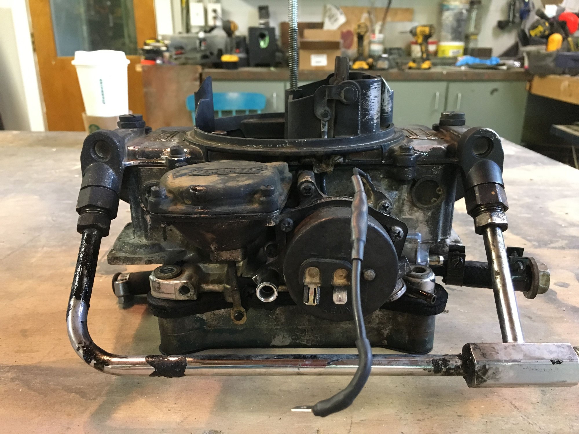

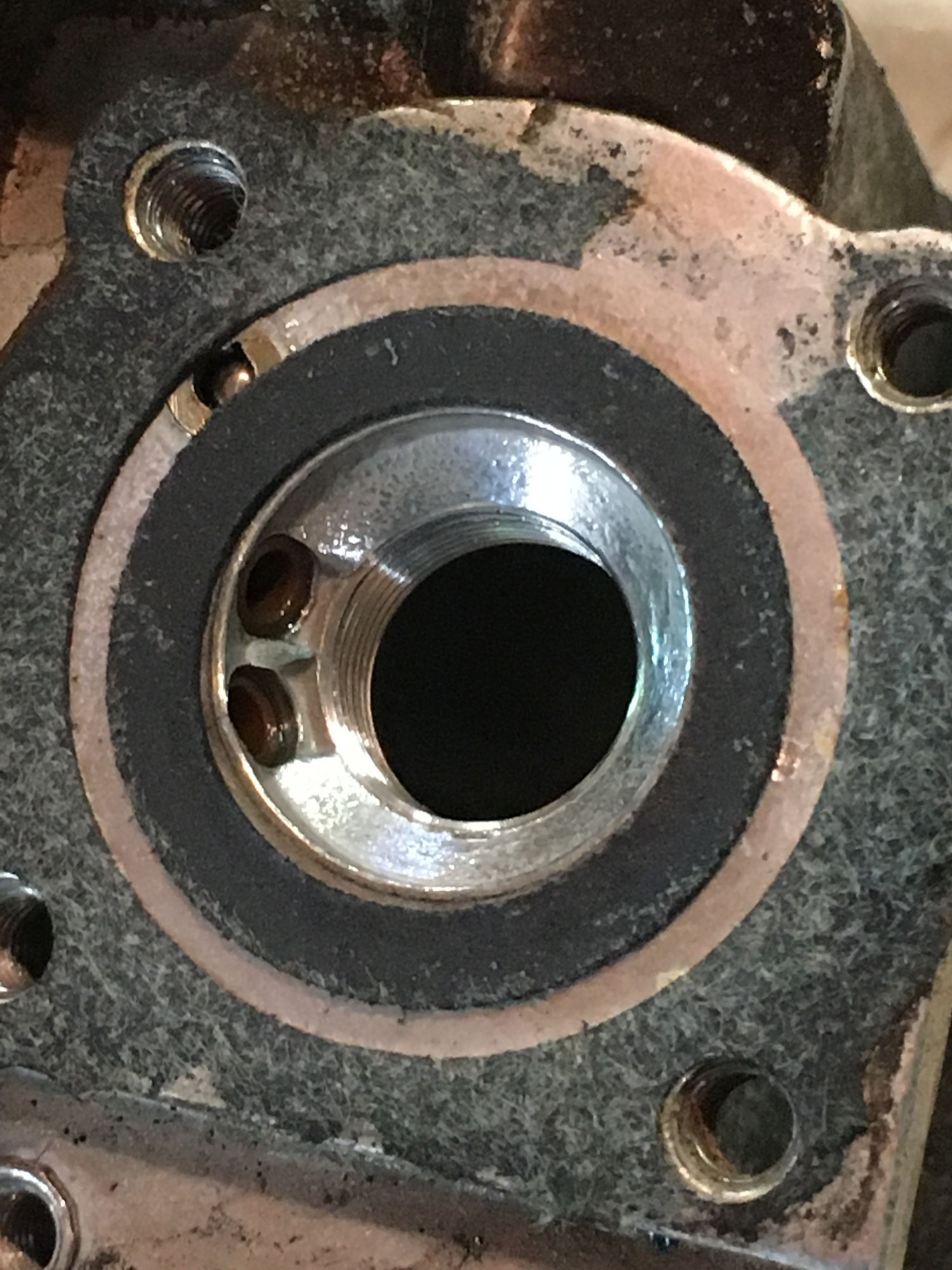

Front-Summit 08600V
Driver's Side
Rear
Passenger Side
Old Apr 23, 2017 | 07:38 PM
  #65
treadstone00
Joined: Apr 2017
Posts: 101

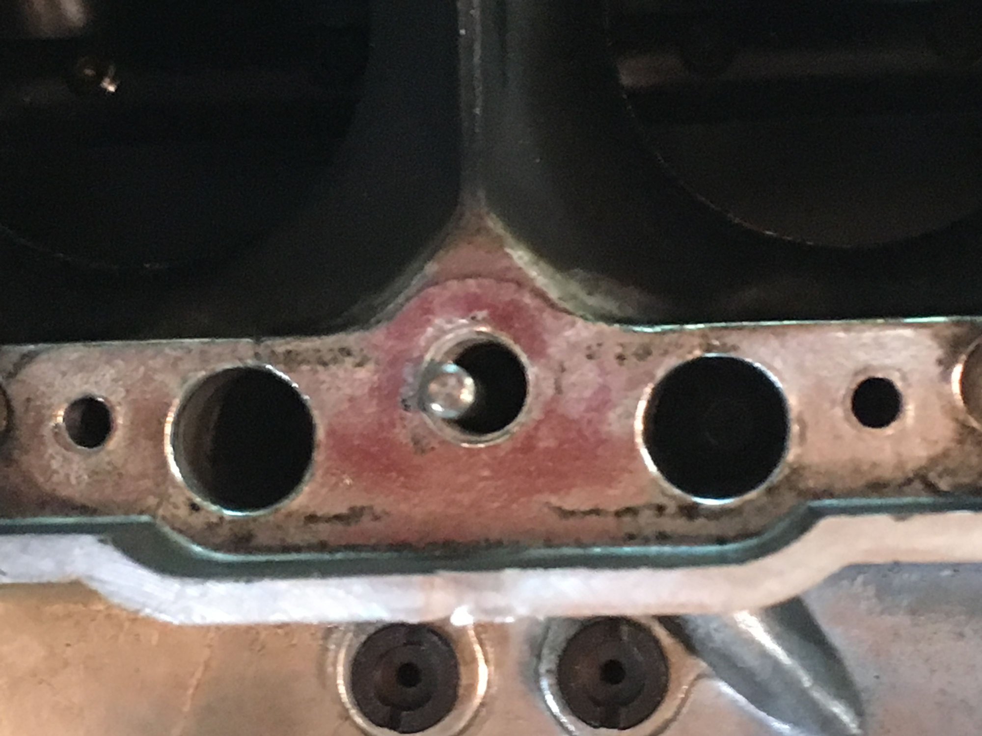

Found Venturi loose in top of carb
Old Apr 23, 2017 | 07:40 PM
  #66
treadstone00
Joined: Apr 2017

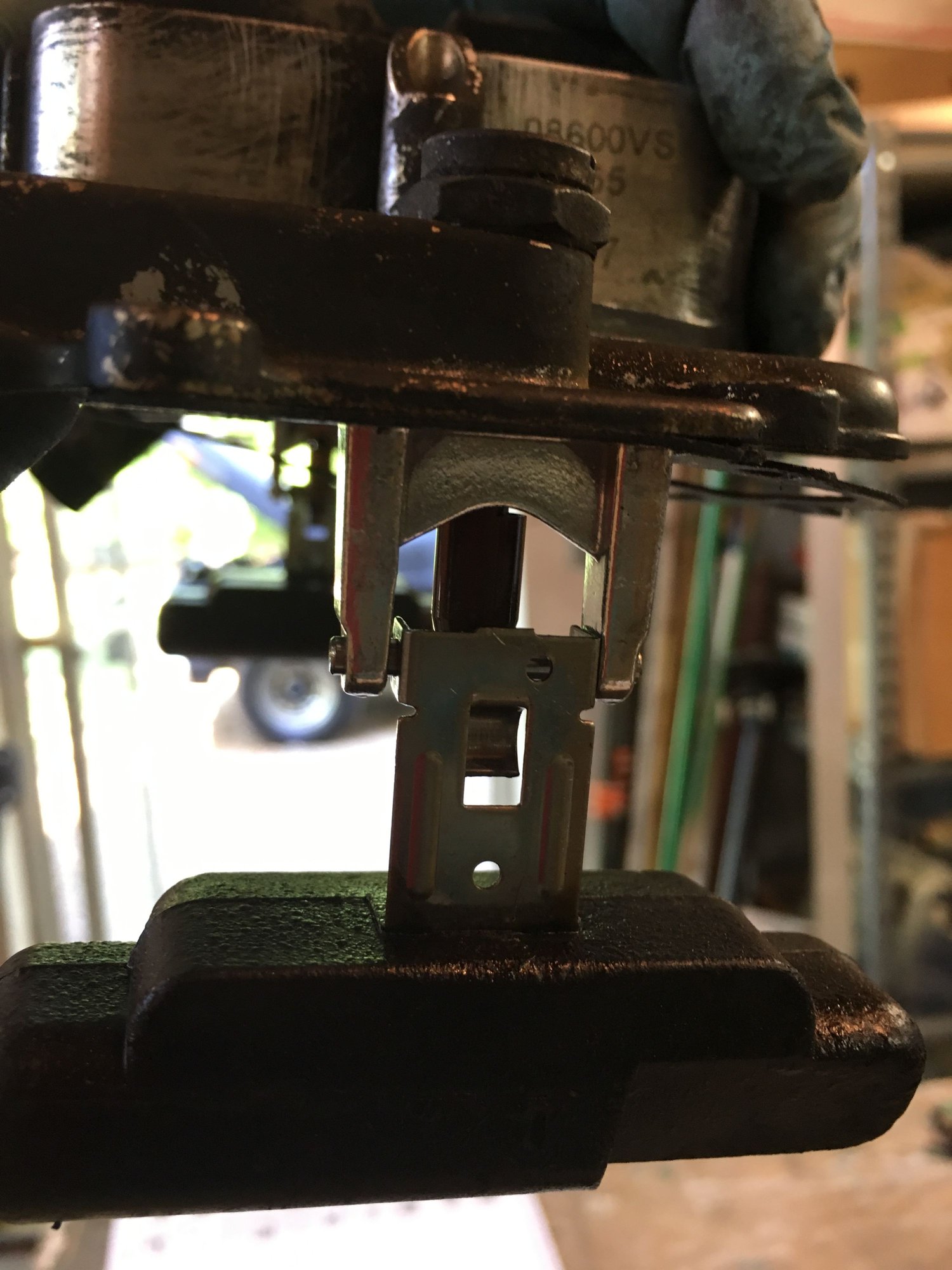

Posts: 101

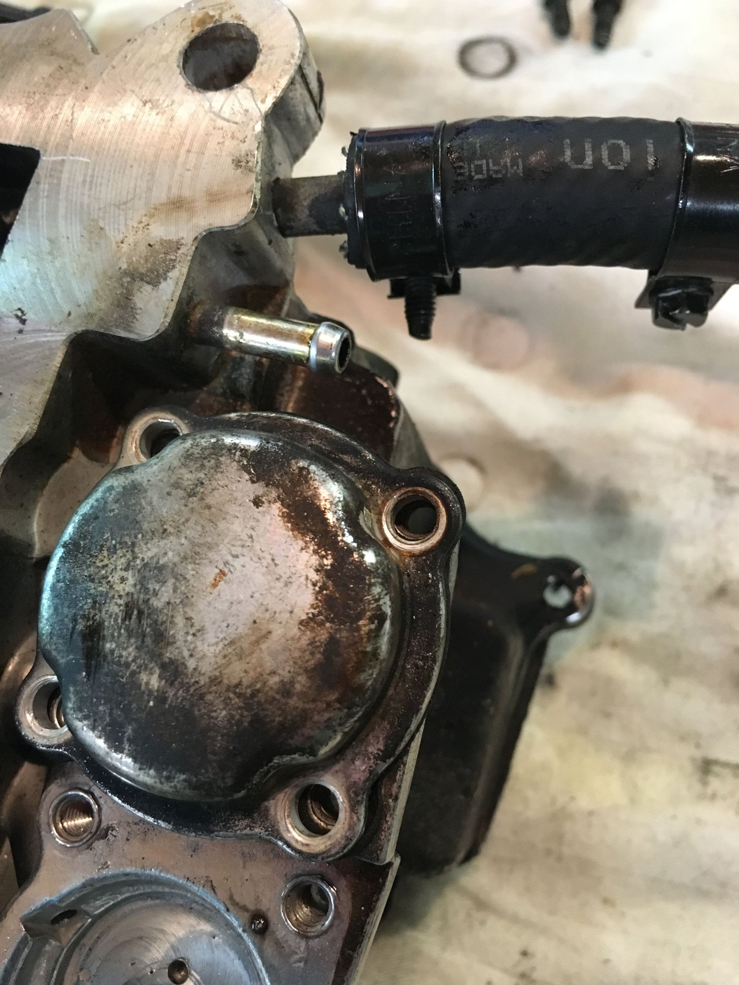

Old Apr 23, 2017 | 07:41 PM
  #67
treadstone00
Joined: Apr 2017
Posts: 101
Old Apr 23, 2017 | 07:42 PM
  #68
treadstone00
Joined: Apr 2017
Posts: 101
Old Apr 23, 2017 | 07:44 PM
  #69
treadstone00
Joined: Apr 2017
Posts: 101

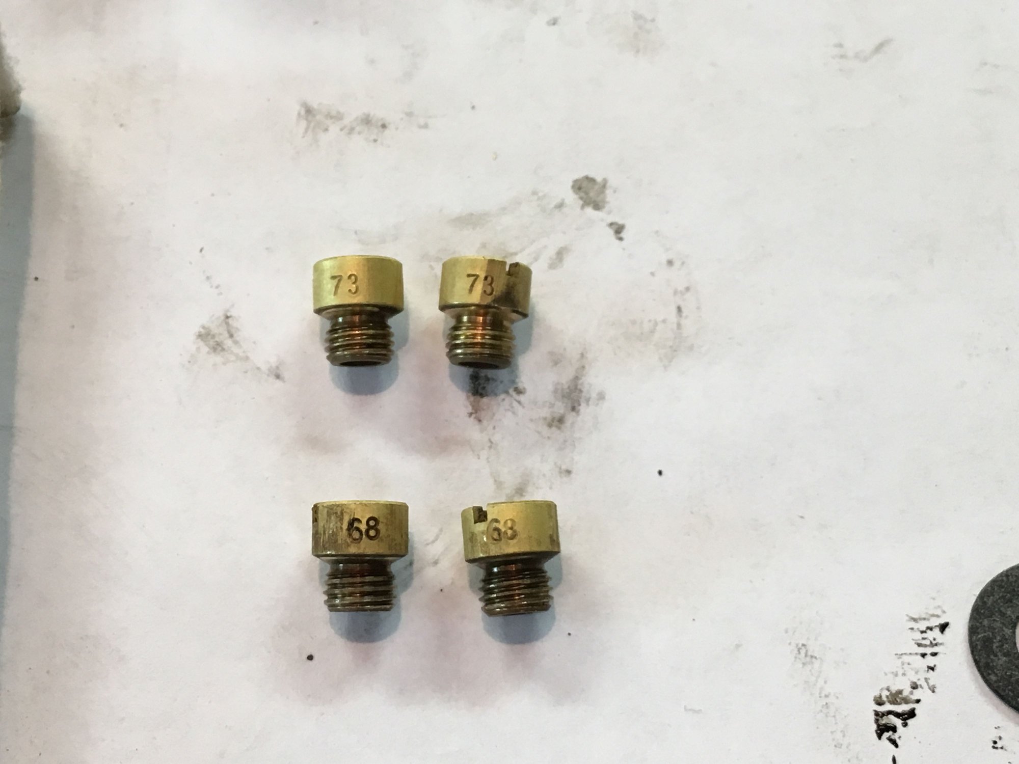

68's are the Primary and the 73's go in the other bowl.

Now that you have your base timing set, try to advance her a little bit more. Use you ear. Too much advance and she'll drag when you go to start her again. There's more to tell you using a vacuum gauge, but you're on the right track. She still falls on her face and first throttle. A far cry from the beginning of the burn out. I don't know that carb. I can tell you to adjust the rear float by the nut and screw on the back bowl. Loosen the nut and adjust the screw (while it's running) to get the fuel in the sight glass, BUT that is not why she falls on her face at a bump of the throttle. Again, great job on getting her this far in a short amount of time.

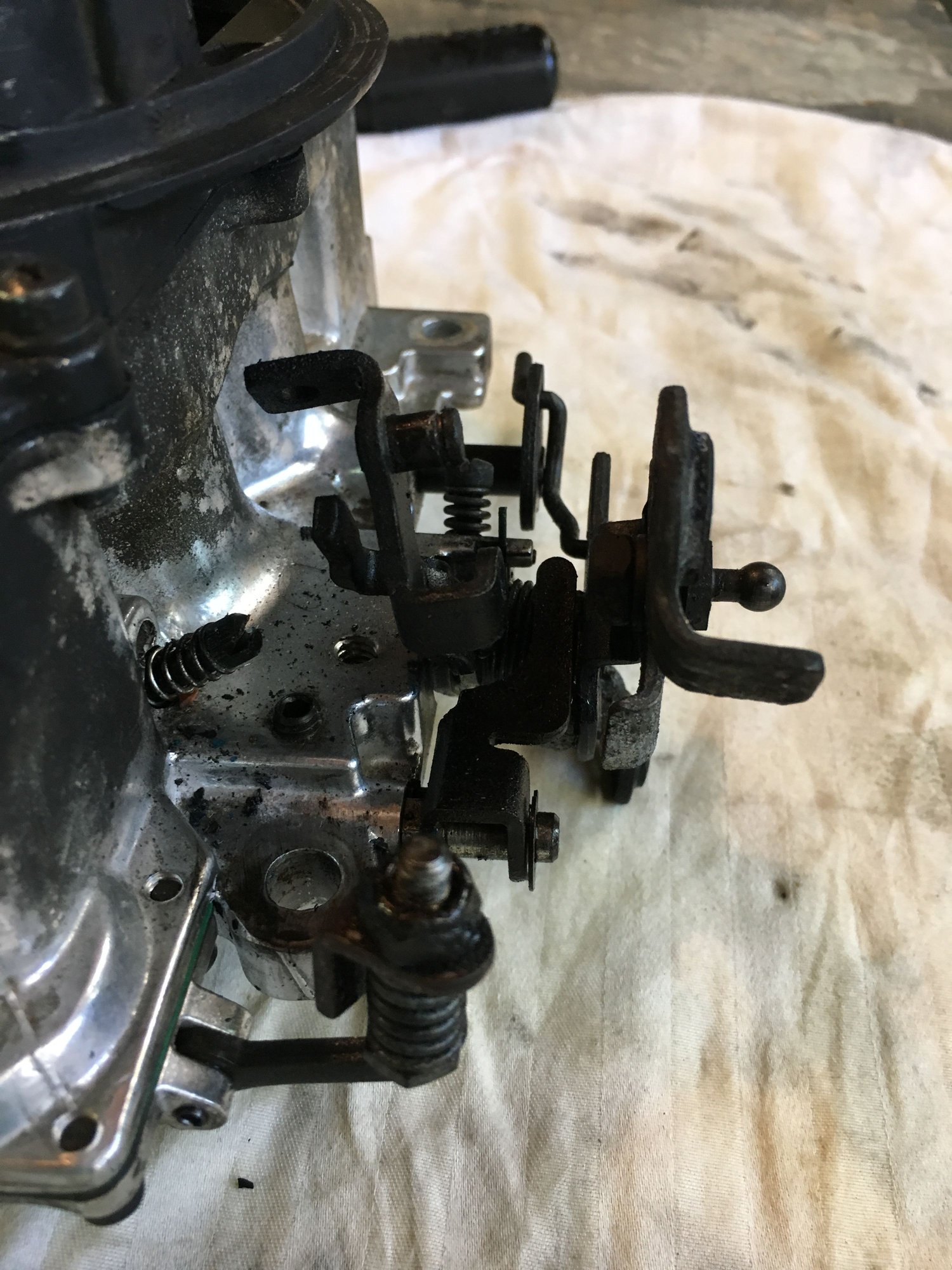

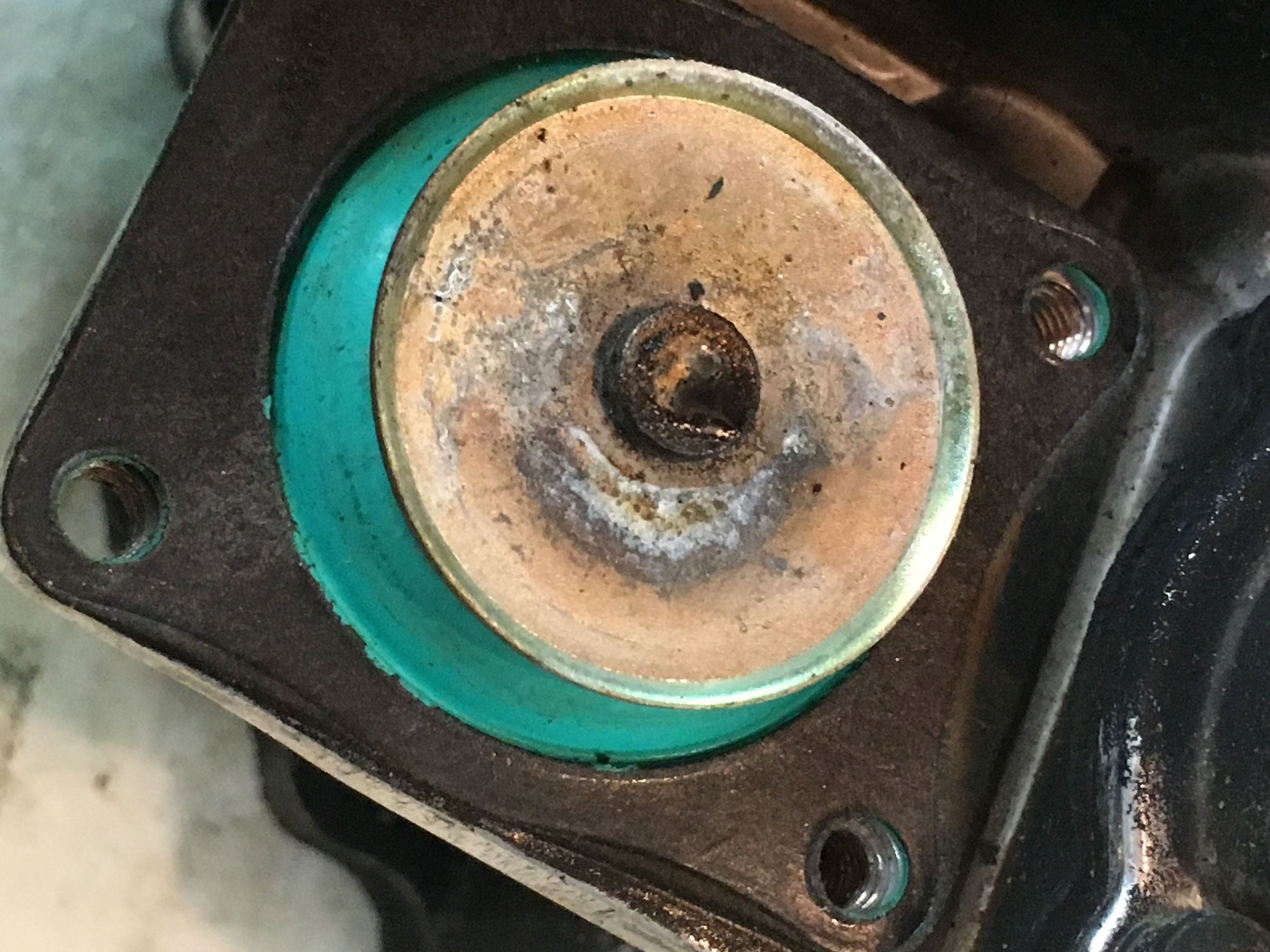

It falls on it's face when you rap it because of the accelerator pump shot is not there for one reason or another. Not sure if you replaced the pump cam on the throttle shaft but the original in the pics above was melted, but I can see the arm moving in the video. Which means you should be able to look down into the carb and see gas shooting out of two holes when you throttle it up fast like that. If not, there's an issue with getting gas to flow through the accelerator pump circuit. Did you put a new gasket kit in it? Also just my opinion, but I would leave the timing at 8 for now. Especially until you can get the carb issues sorted out.
