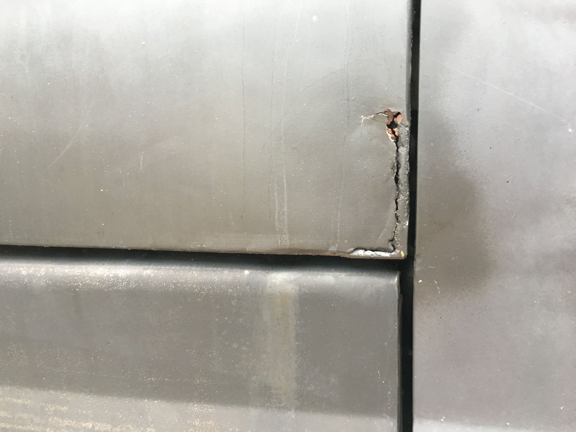

right at the back of the hood, going down to the driver's side fender.

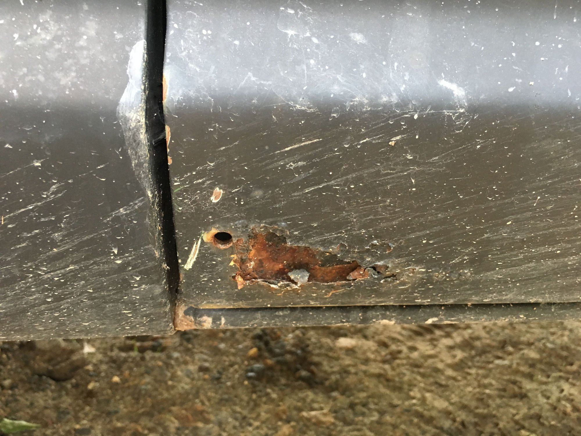

bottom of driver's side door (front of truck is on your left)

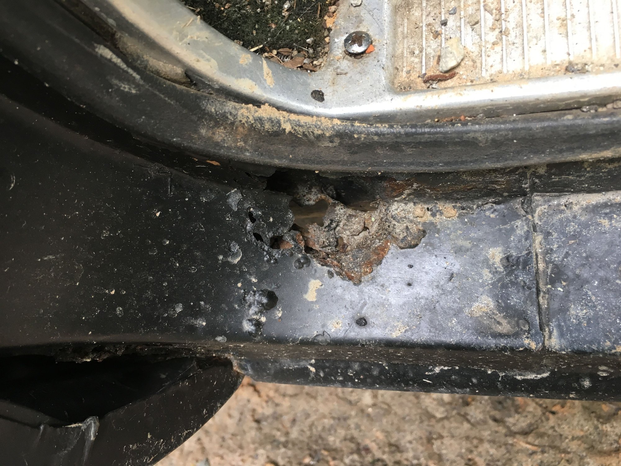

inside driver's side door jamb. rusted all the way through.

When I was asking about "body work" I meant like how to fix the bumpside "trim" holes on the side and a couple other spots.....see photos.
You have a labor of love going right now. I don't have that much time or inclination! Great job man. I think you're a genius!
