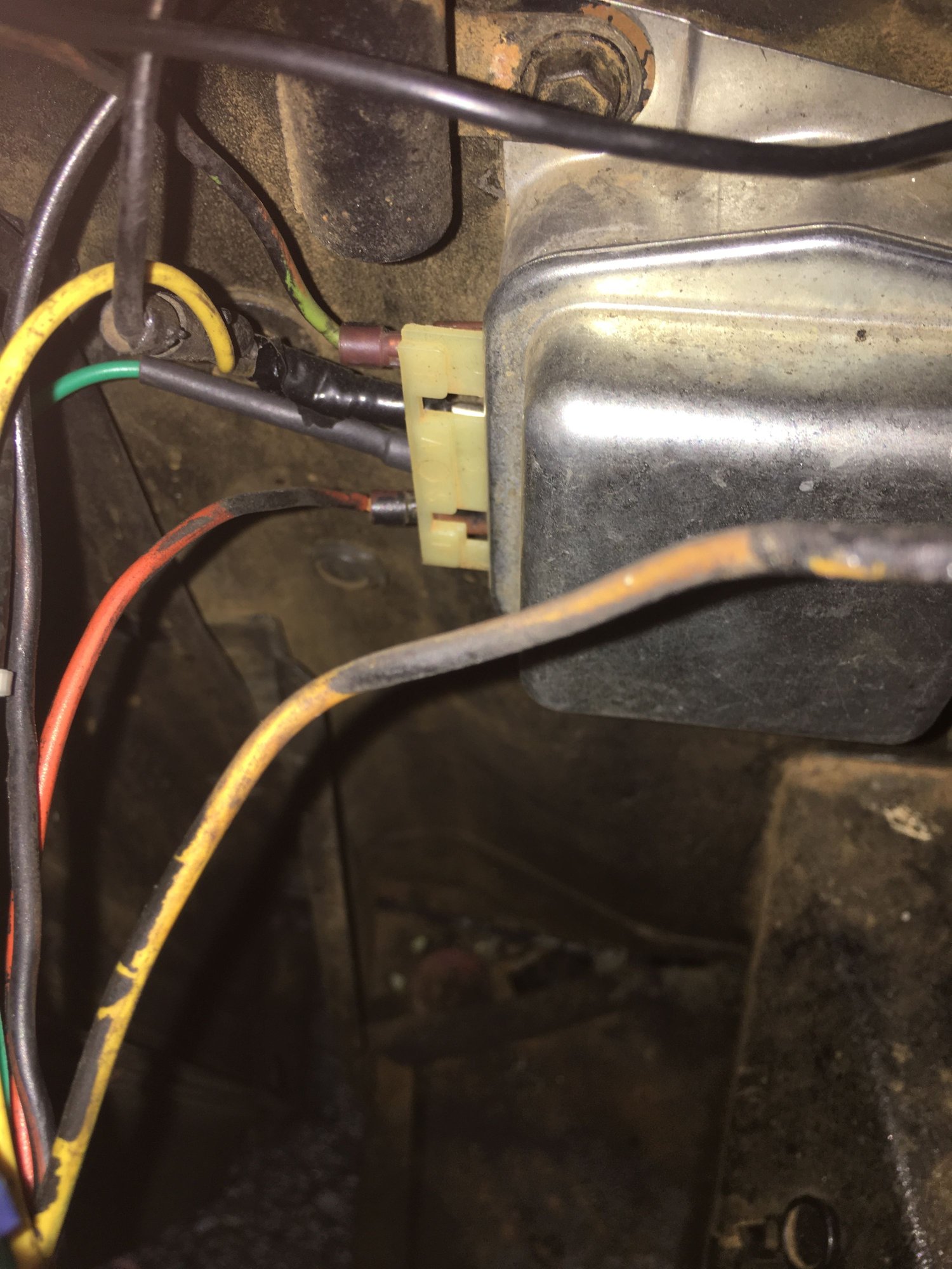

life sure could have been easier if I had that plug connector.!!!! LOL! Someone took it out at some point. I'll post a pic of what I have later on. I'm out digging post holes! I'll check those grounds and lean them up. Re-test and post results!

Going back to JeffFAFA and the regulator plug.....someone cut it out of the truck at some point and all I have is a bunch of wires.....LOL! While replacing the Alternator I was able to figure out which wires went to the correct location and so that side of things is alright.

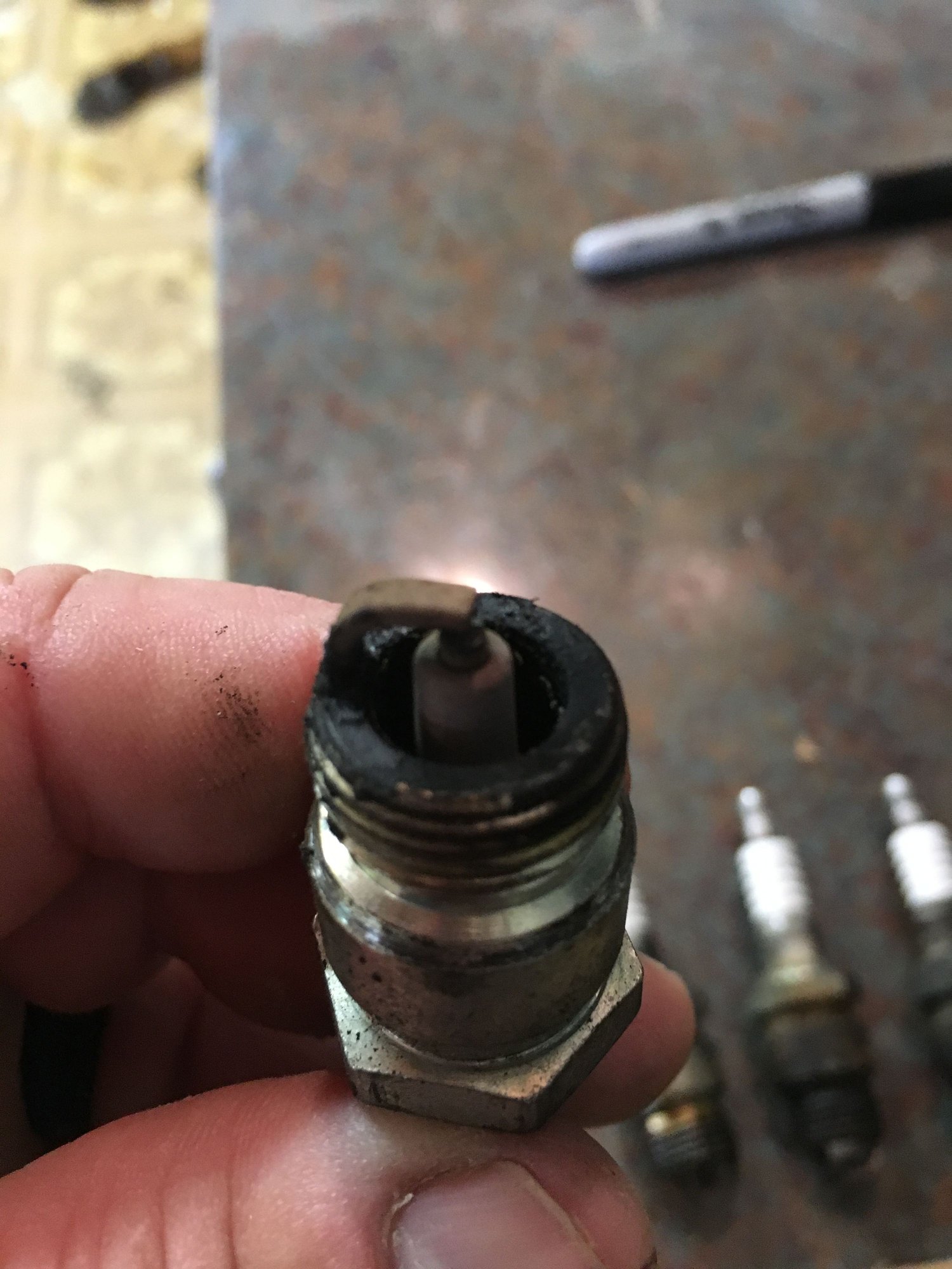

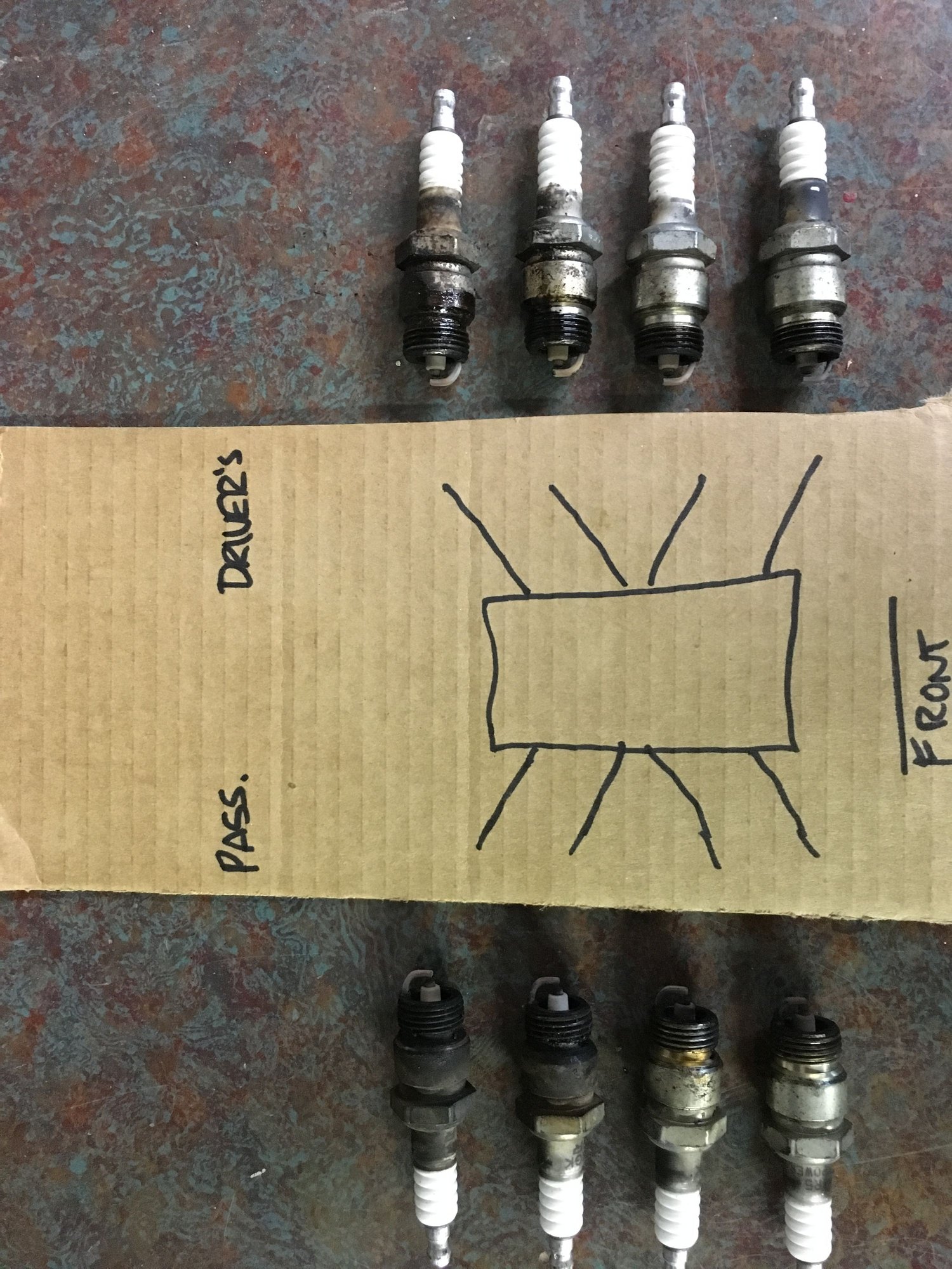

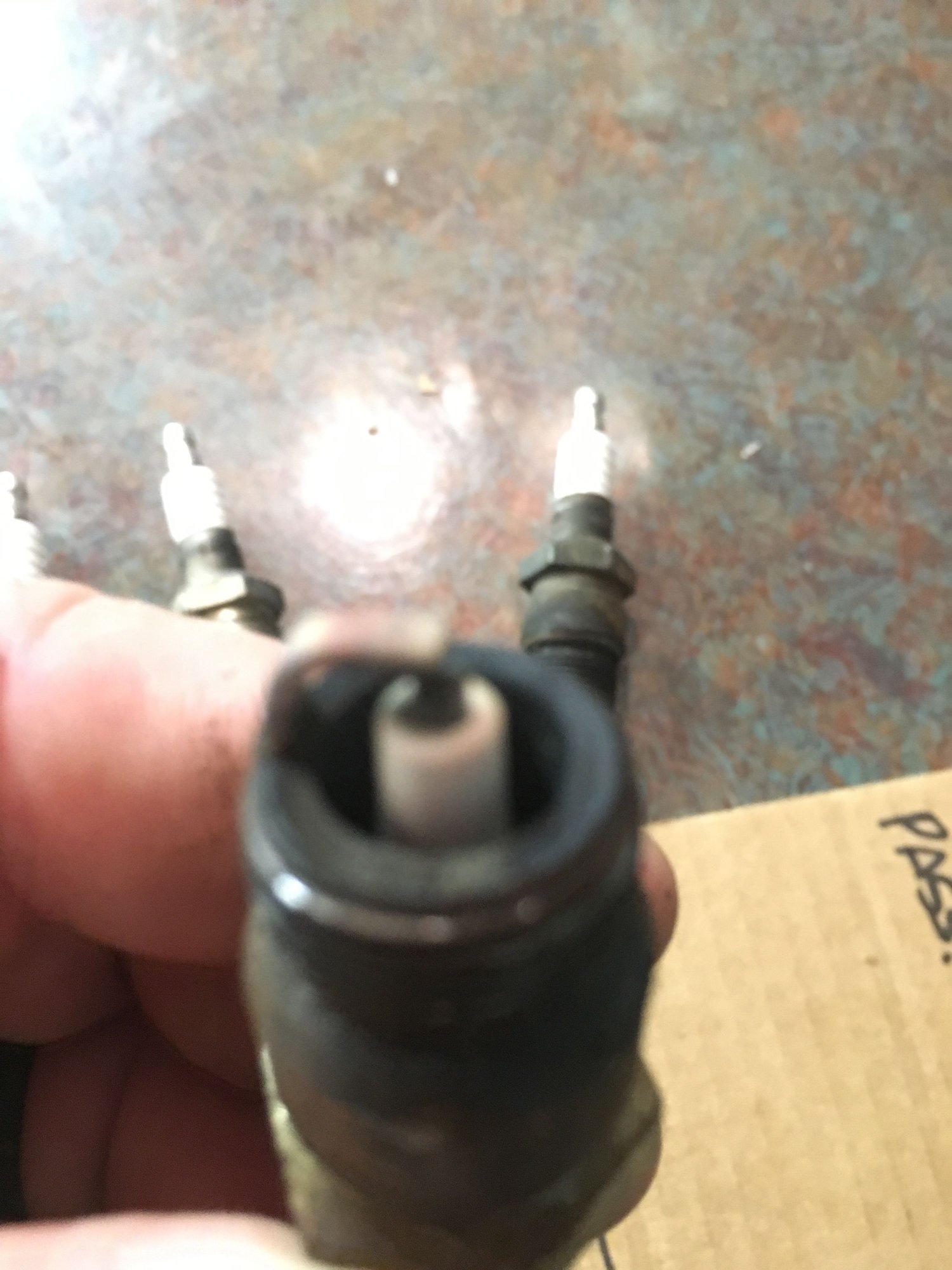

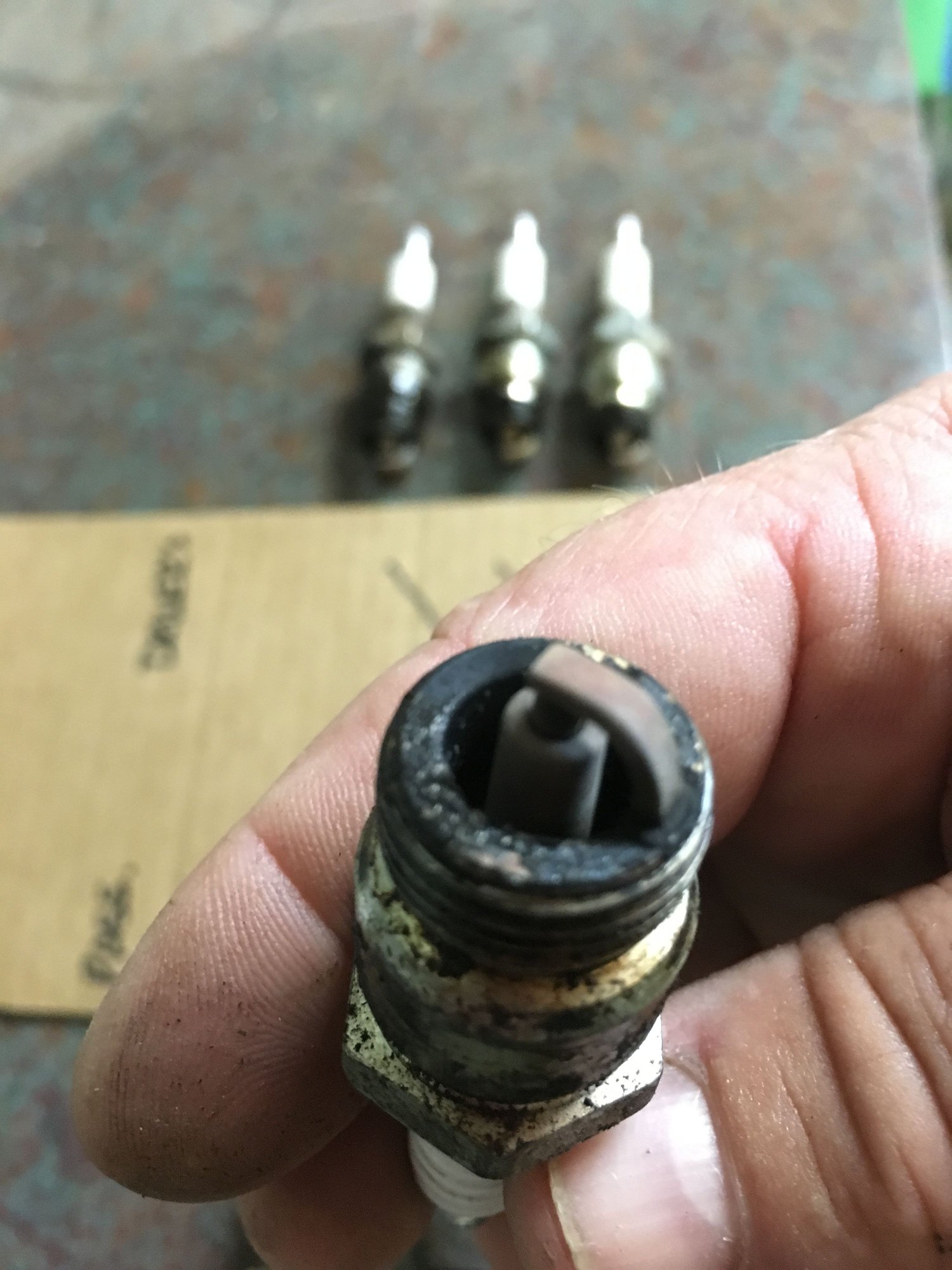

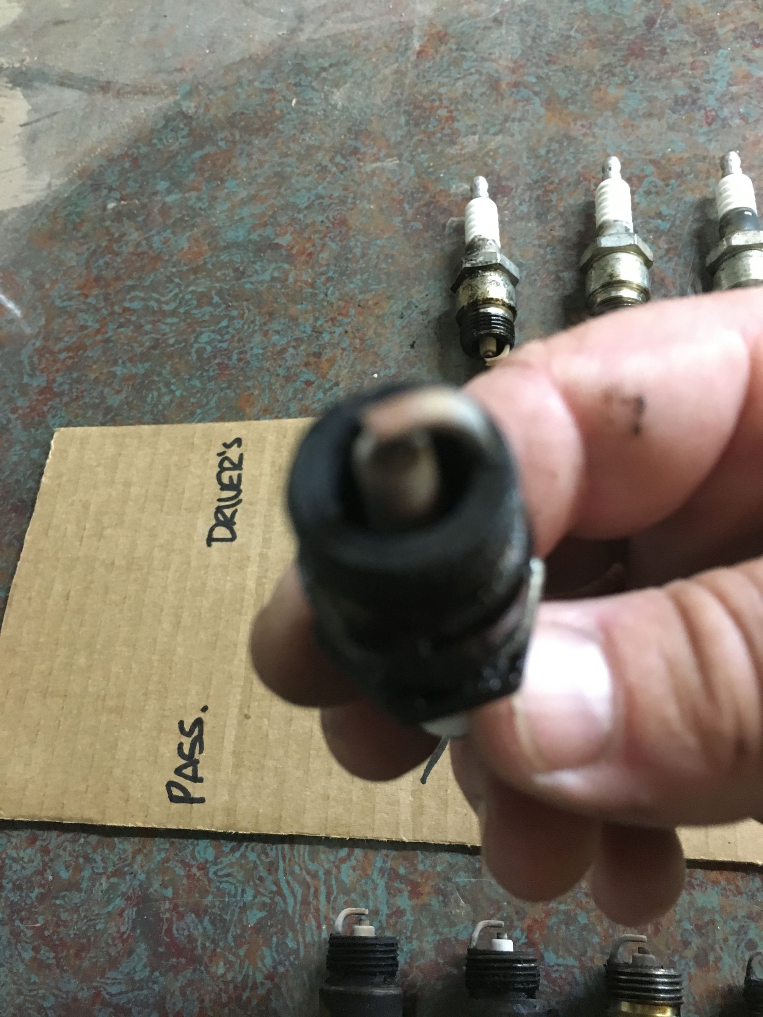

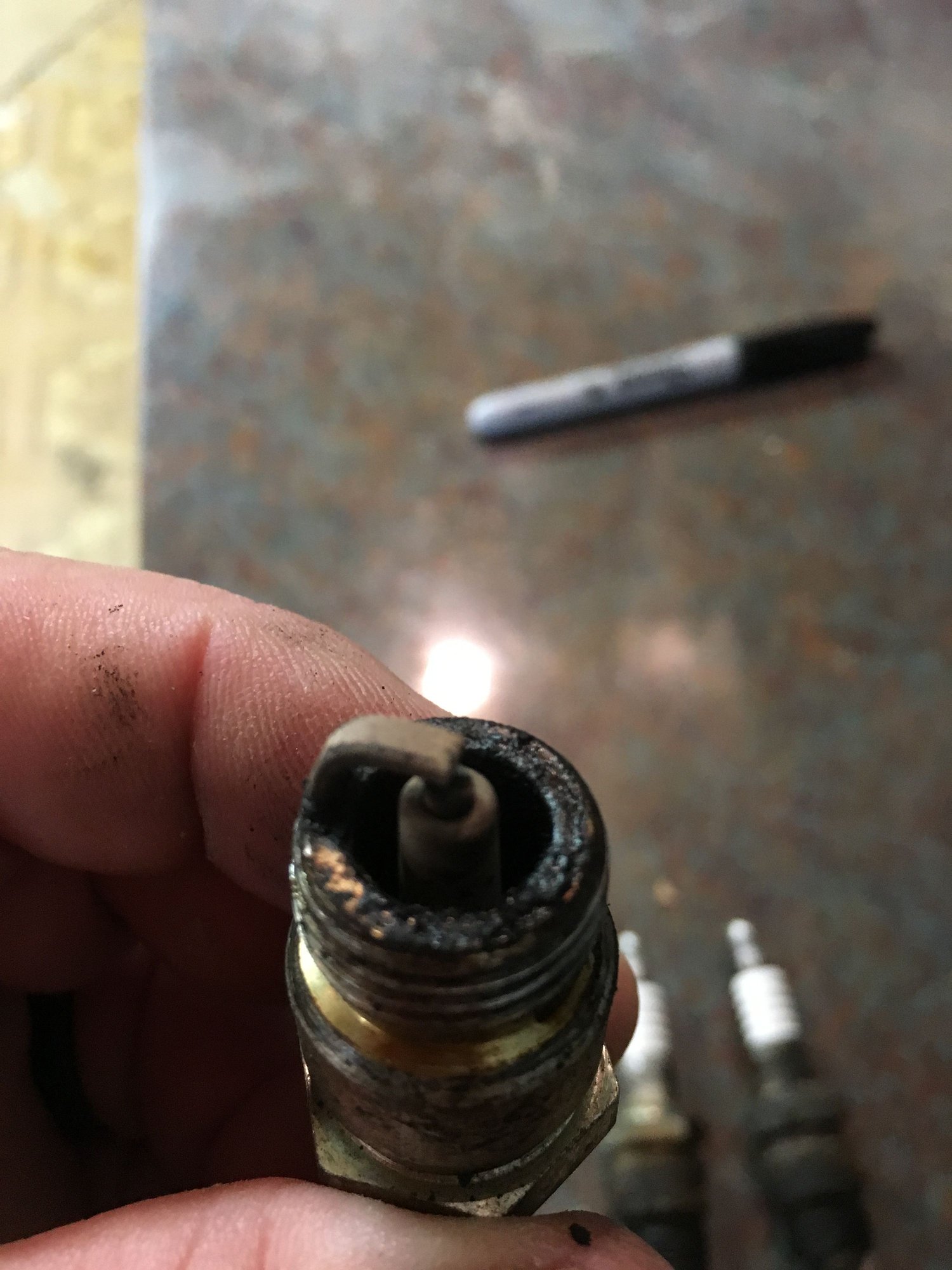

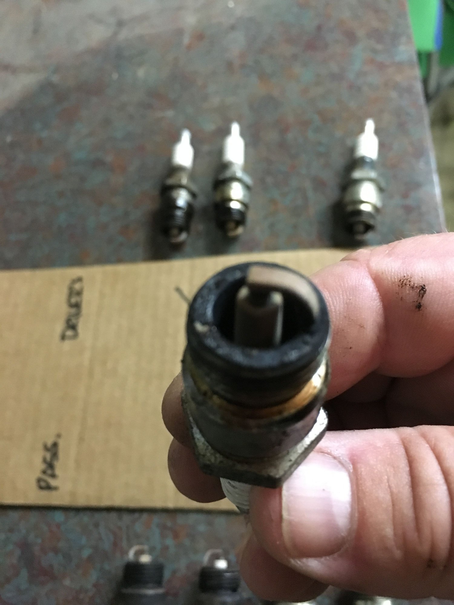

Fore reference, I laid these out on the cardboard. This way you can see which plug is which and from which location.
So after a great morning on Black Thunder (that's what my son calls her....) I did the Points/Condenser and Plugs. The truck runs way better than is has since the fire. Found a few things that were contributing factors and also wanted to see about how the plugs looked when I took them out. Here they are from the drivers side, starting at the front of the motor heading back to the firewall and then passenger side, same thing.

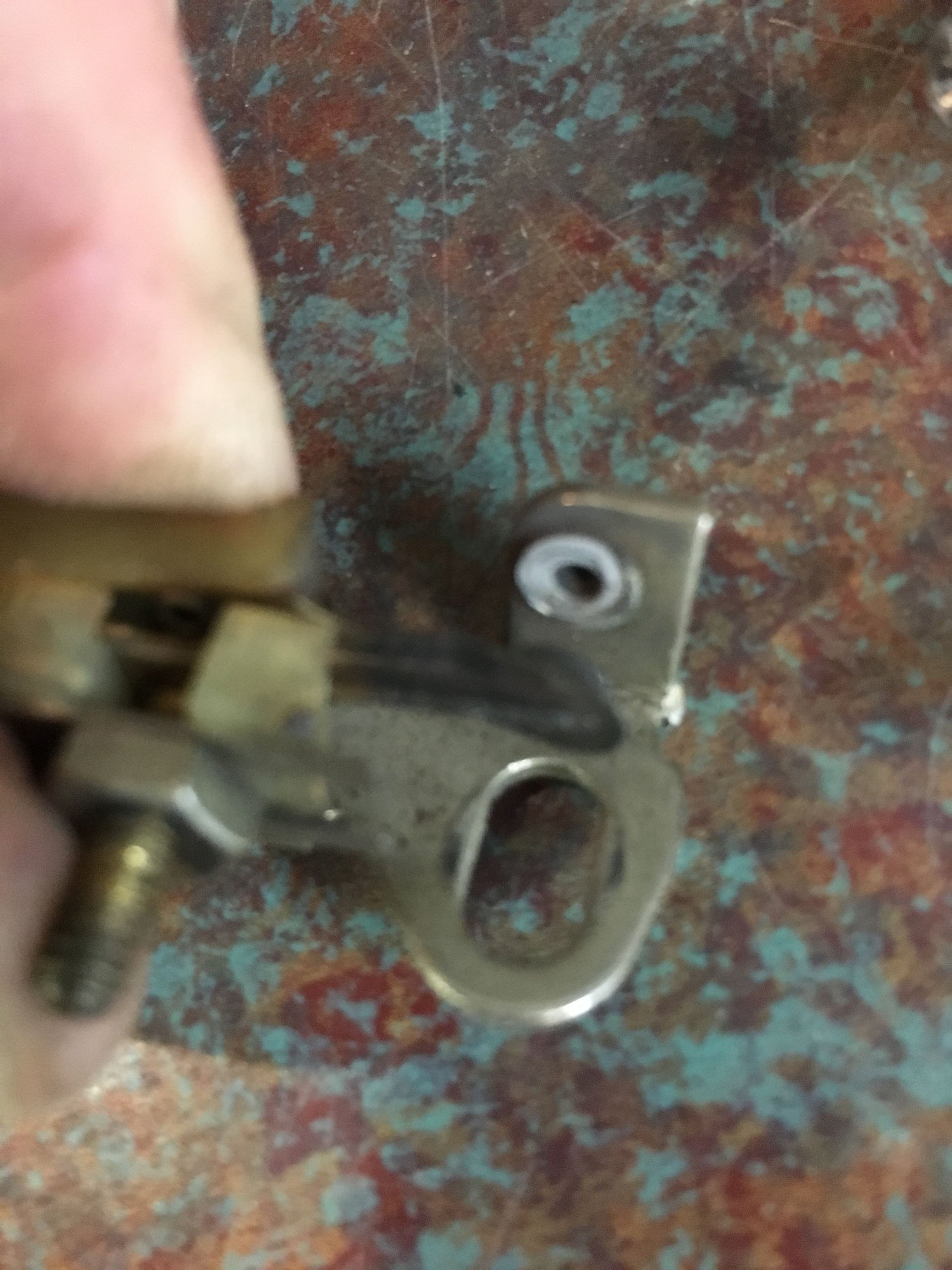

Gonna go out on a limb and say you shouldn't be able to see light through the points....
Also, when I did the points I found this.....
