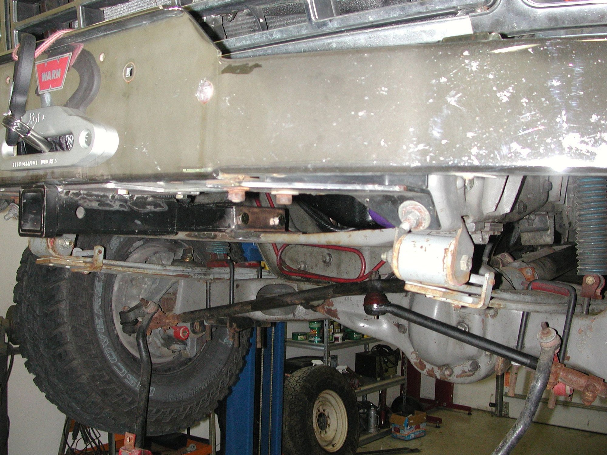

Anyway, I got the spacers made today and put in place. I didn't have enough 1/2" material so I used two pieces of 1/4" on each side in the back, as shown below. But, tomorrow I'll tack them together so they can't move from each other. As for the front, I did have enough 1/2" material to make them. And everything fits nicely and there's as much support for the crossmember as there was before.
And this pic shows the spacing 'tween the crossmember and the receiver: ~ .1" But the crossmember is just touching the receiver at the rear, so 1/2" spacers are just right as nothing is being pushed out of its natural place by the other.
Tomorrow I hope to weld the angle to the crossmember, now that I know exactly where everything will go. And, before that I'll drill the holes in the angle and then pull the receiver and drill the holes in it. Once all of that is done it is time to clean, blast, and powder-coat everything - including those red sway bar brackets seen in the first pic. (Sorry, Vernon. Our tastes differ.)

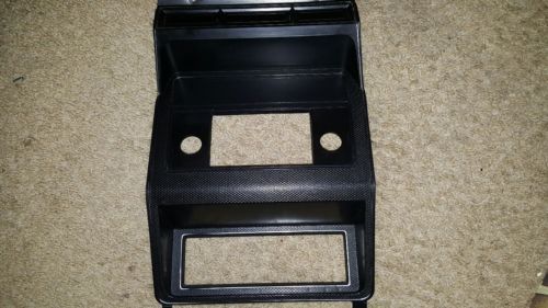

So, why tomorrow? What did I do today? Beside helping my brother find the right transfer pump for his toy hauler and working an issue at church, I ordered a radio bezel that both David and Jonathan found for me. Thanks, guys!
And then I worked on the front receiver, getting both it and the angle drilled to match, and the angle welded to the crossmember. Here's the receiver fitted to the crossmember:
And here they are mounted:

you didn't need the bezel i sent you
