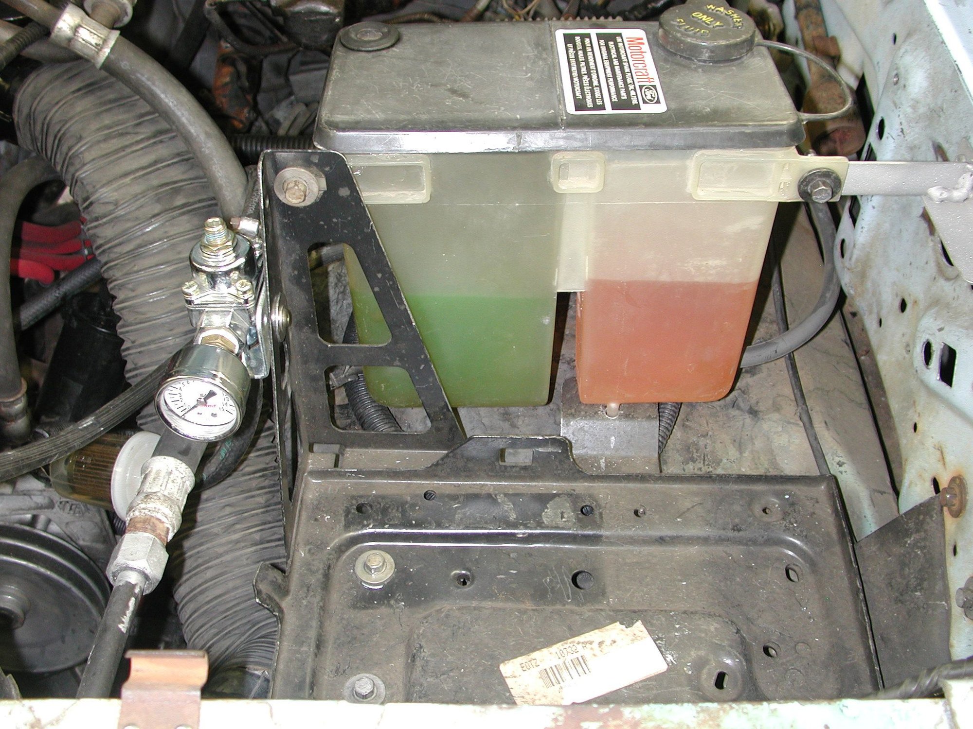

Another update and then it is time to mow. Got the fuel pressure regulator relocated temporarily - until I redo the whole fuel system and put in the return-style regulator. It had to be moved to allow for the aux battery tray.
And, for the record no holes were drilled in the new auxiliary battery tray.
And, I relocated the 2nd ignition module, which also had to move to make room, in this case for the coolant recovery module.
And, here's how I did it.

That is genius Gary! I am going going to steal that idea It is so much nicer than cluttering up the inner fender, or even worse, having your spare module floating around under the seat somewhere...
Old Jul 7, 2017 | 05:27 PM
  #1105
Gary Lewis's Avatar
Gary Lewis
Joined: Jul 2010
Posts: 32,875
Likes: 48
From: Northeast, OK
Steal shamelessly. That's why I put it out there. And, by the way, the modules are tapped 1/4-20.

Gary, the modules stacked does look nice but I have to ask how are you dealing with the heat?
The top one I can see getting air flow all the way around it but that bottom one I don't think gets all the air flow it needs to stay cool.
Dave -----
Old Jul 7, 2017 | 09:59 PM
  #1108
Gary Lewis's Avatar
Gary Lewis
Joined: Jul 2010
Posts: 32,875
Likes: 48
From: Northeast, OK
Dave - From the factory they were bolted to exactly that spot with a plastic cover over them. Apparently Ford wasn't worried. And the top module was bolted in a similar position but just a bit forward and seems to be doing fine. So, the two together should be slightly cooler as there's twice the surface area with the same heat.
I have never seen them covered and why I said what I did.
Carry on
Dave ----
Old Jul 8, 2017 | 07:08 AM
  #1110
Gary Lewis's Avatar
Gary Lewis
Joined: Jul 2010
Posts: 32,875
Likes: 48
From: Northeast, OK
Nor had I seen them covered. But Bill's son Matt Vose/Archion gave me one of the covers and showed how it was used, and later I saw it in a publication. Perhaps there was a TSB that said pull them and throw them away?
