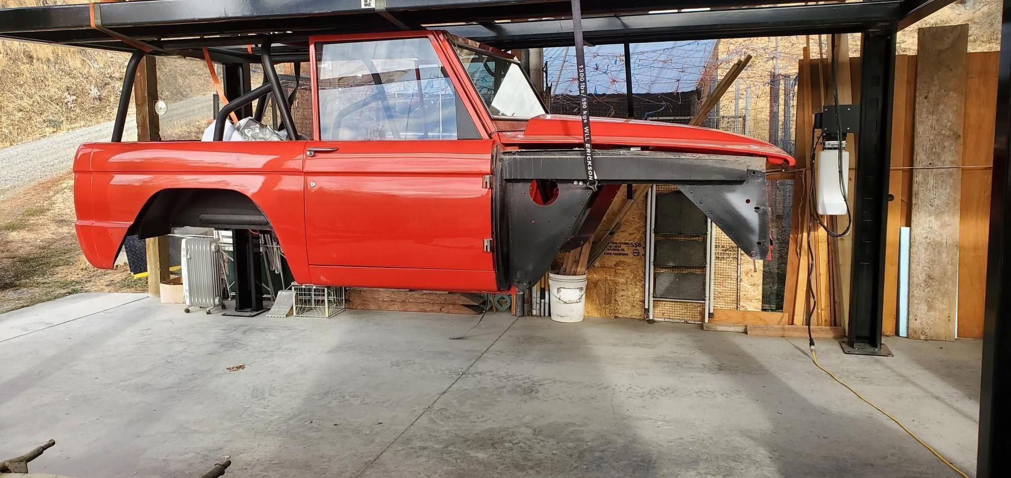

Benn working on the Project some, just lacking in taking photo and doing up dates. But here are a couple from the last couple days.
This is just a test run on some scrap 1/4" to get my fixtures correct and make sure I have all my measurements correct. I have some 1/2" on order.

For some reason I can't seem to find some of the photos I know I have taken. I'll take some more later tonight and post some more photos.

Some clearance issues, they have all been resolved at this point. More photo's later.

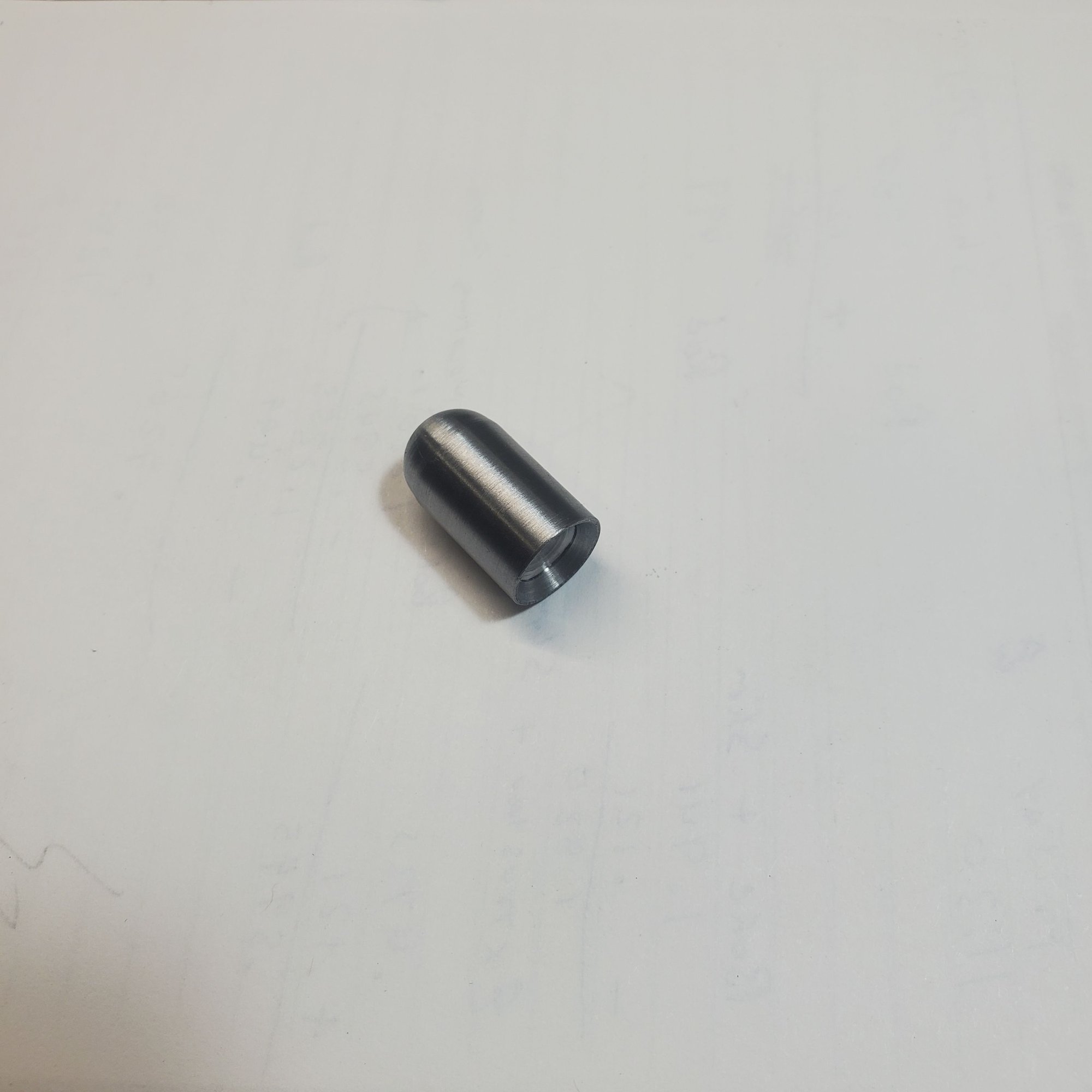

I got the spacer made for the Hydroboost out of the correct stuff, I also made a little bullet to go inside the Master Cylinder. The little bullet was needed to make the contact between the Hydroboost the Master Cylinder. It's pretty hard to measure but the best I can tell I have between 5 and 10 thousands clearance between the push rod and the piston in the Master Cylinder. I'm going to look at the spacer a little closure, I would like to have a between 10 and 20 thousands.
