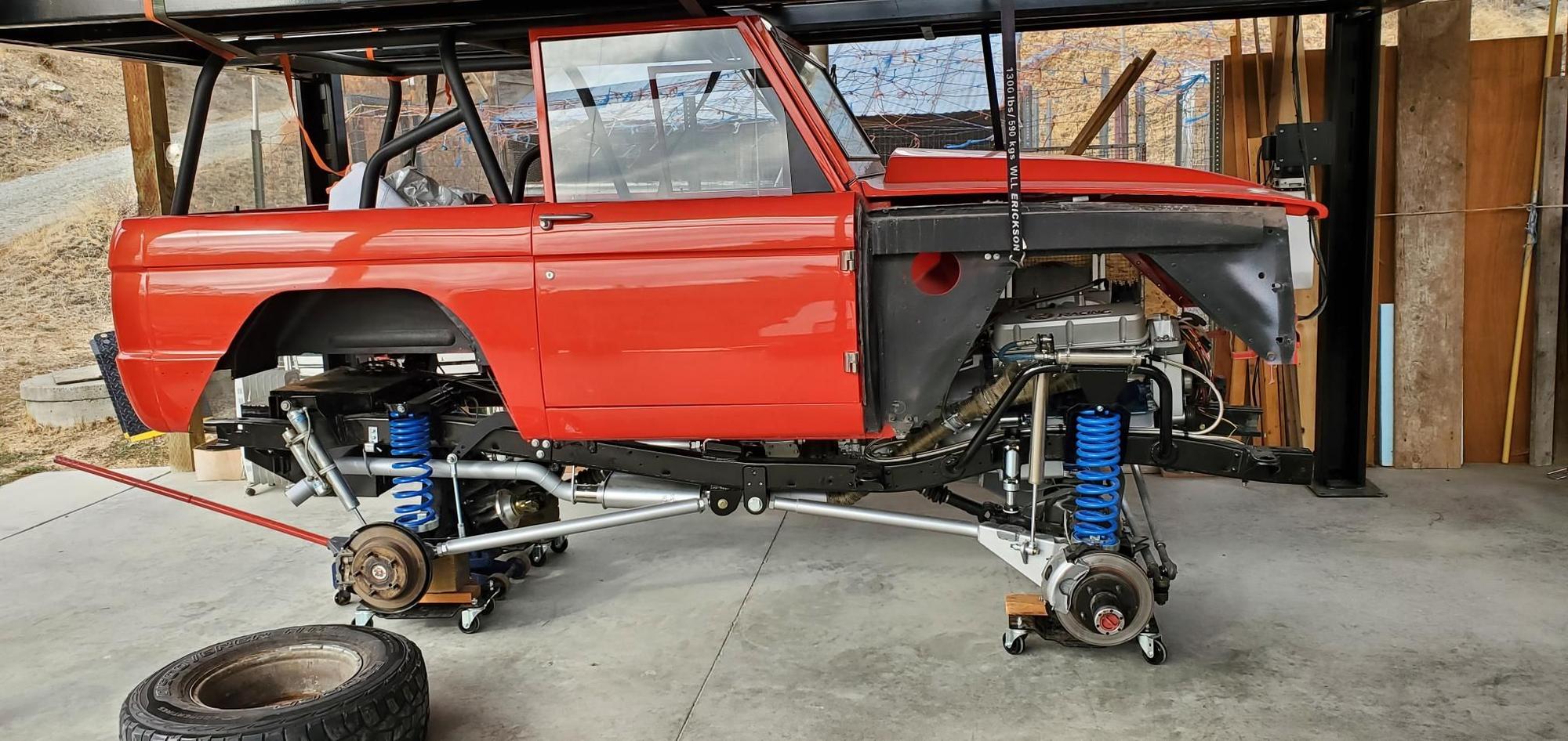

Well, it looks like my plan will work. As far as the thing folding in the middle, I don't think I need to worry about that. With the roll bar in there and bolted down it's not going to move. Anyway I have it ready for the switch, I did a test lift and it looks like I will have just enough room to slid the new frame and running gear under it. I already have the springs removed from the new frame, once I get the frame up to the pole barn I well have to remove the tires and wheels and set it on my little dollies so I can slide it sideways. Stay tuned for more exciting news!

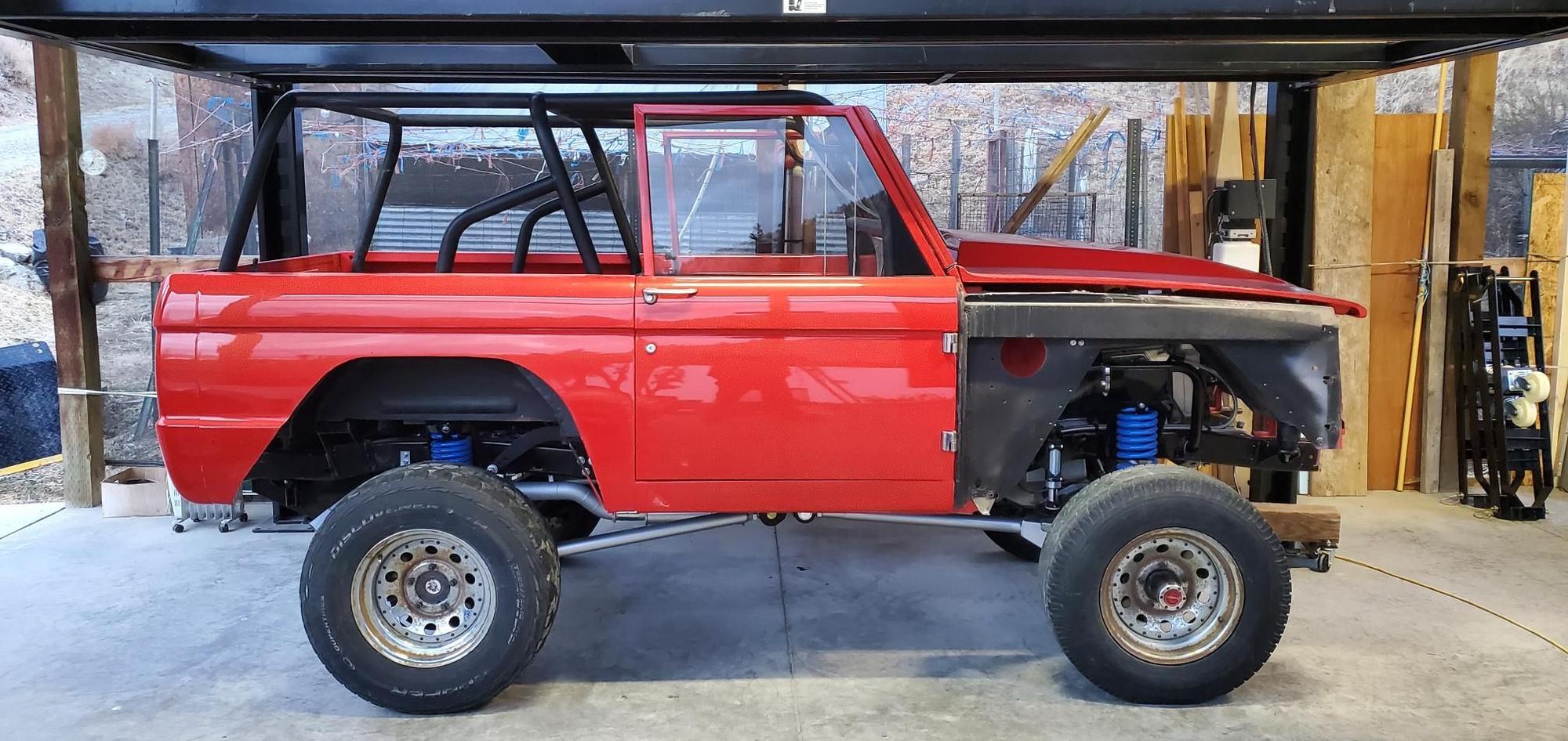

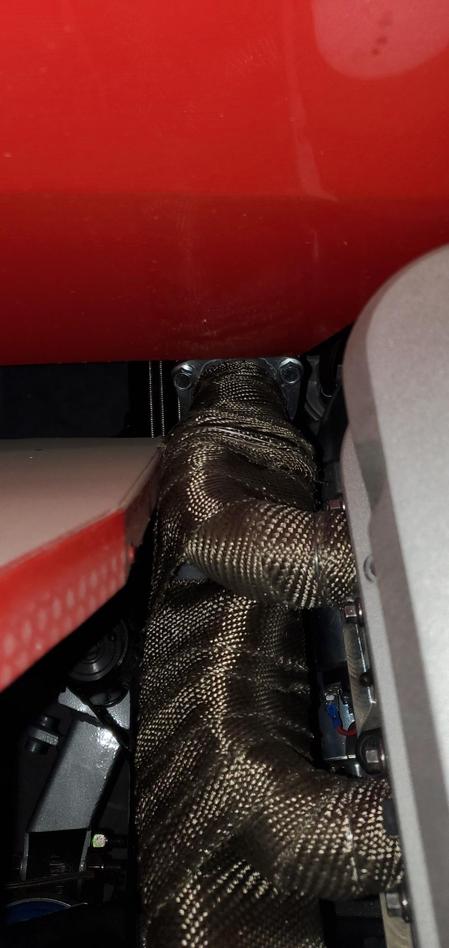

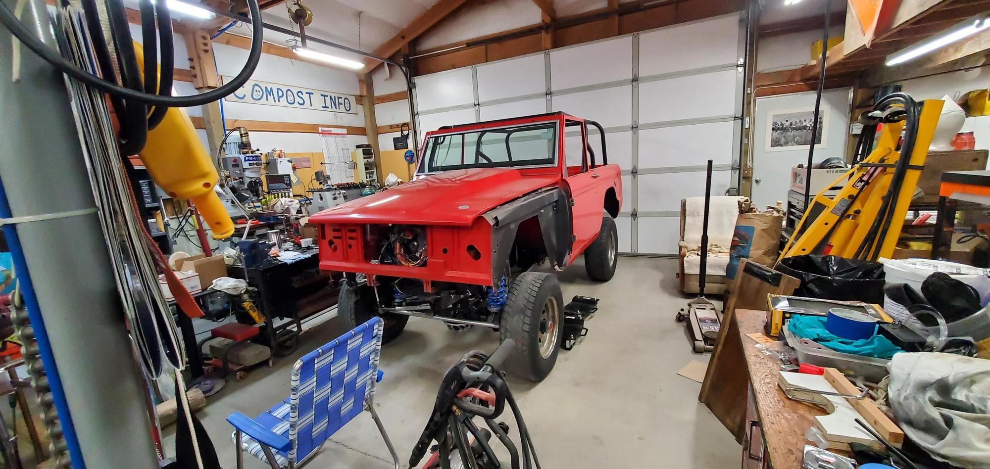

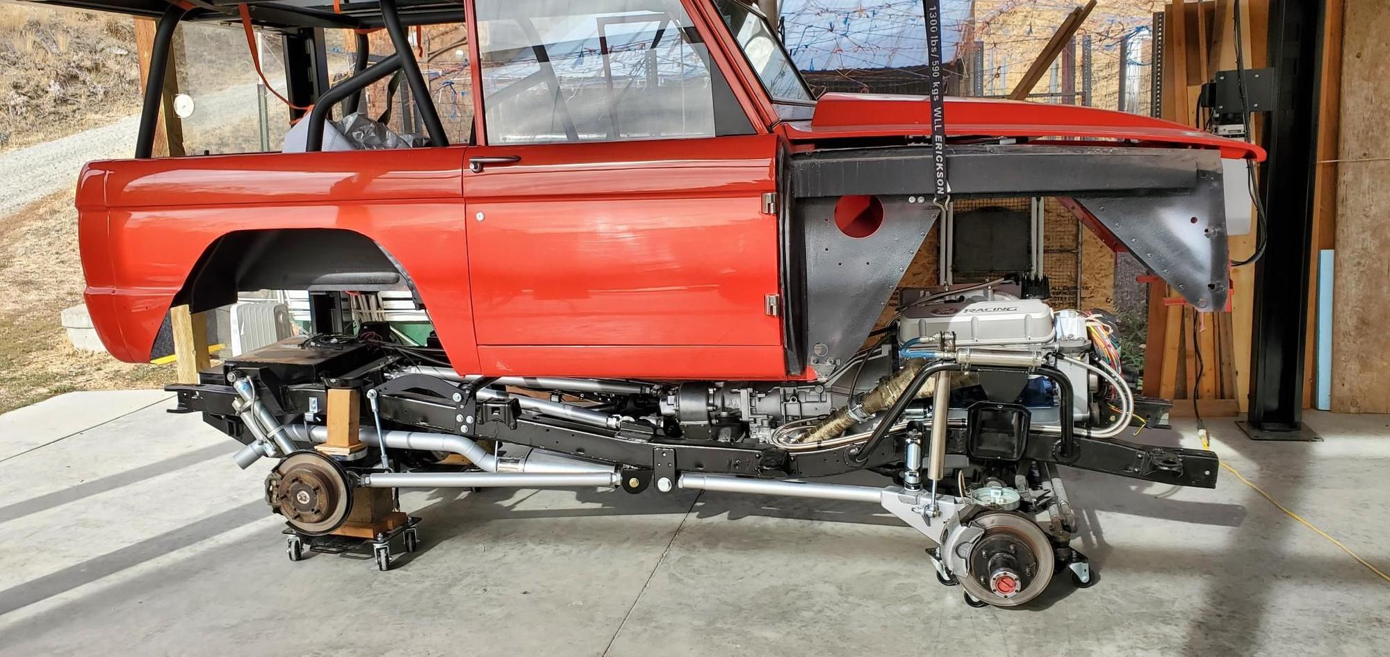

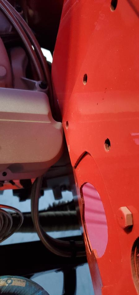

Here are a few photos from today!
Getting ready to slide it under the body.
I have a couple of issues to deal with, one of the issues is the valve cover is hitting the firewall. I think I have the engine tilted to far back, I'm hoping a shim under the transmission mount will do it.
The header is hitting the inner finder, I haven't checked it out yet but I suspect it is pretty light hit probably just the insulation I have wrapped around the header.
And now it is in the shop!
