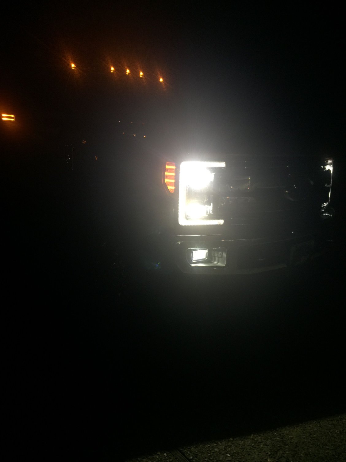

Originally Posted by Rutcutter
Pure brightness!
Is the daytime running lights on full bright with your headlamps?? I'm hoping to turn off the parking lamp dimming while using parking lights AND headlights ....
