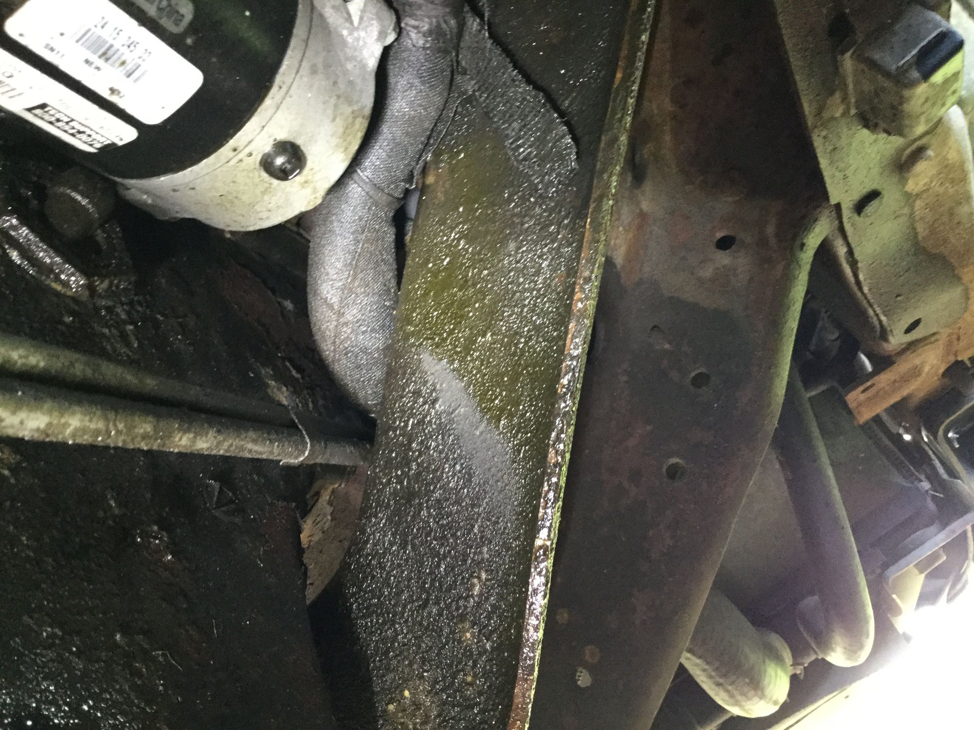

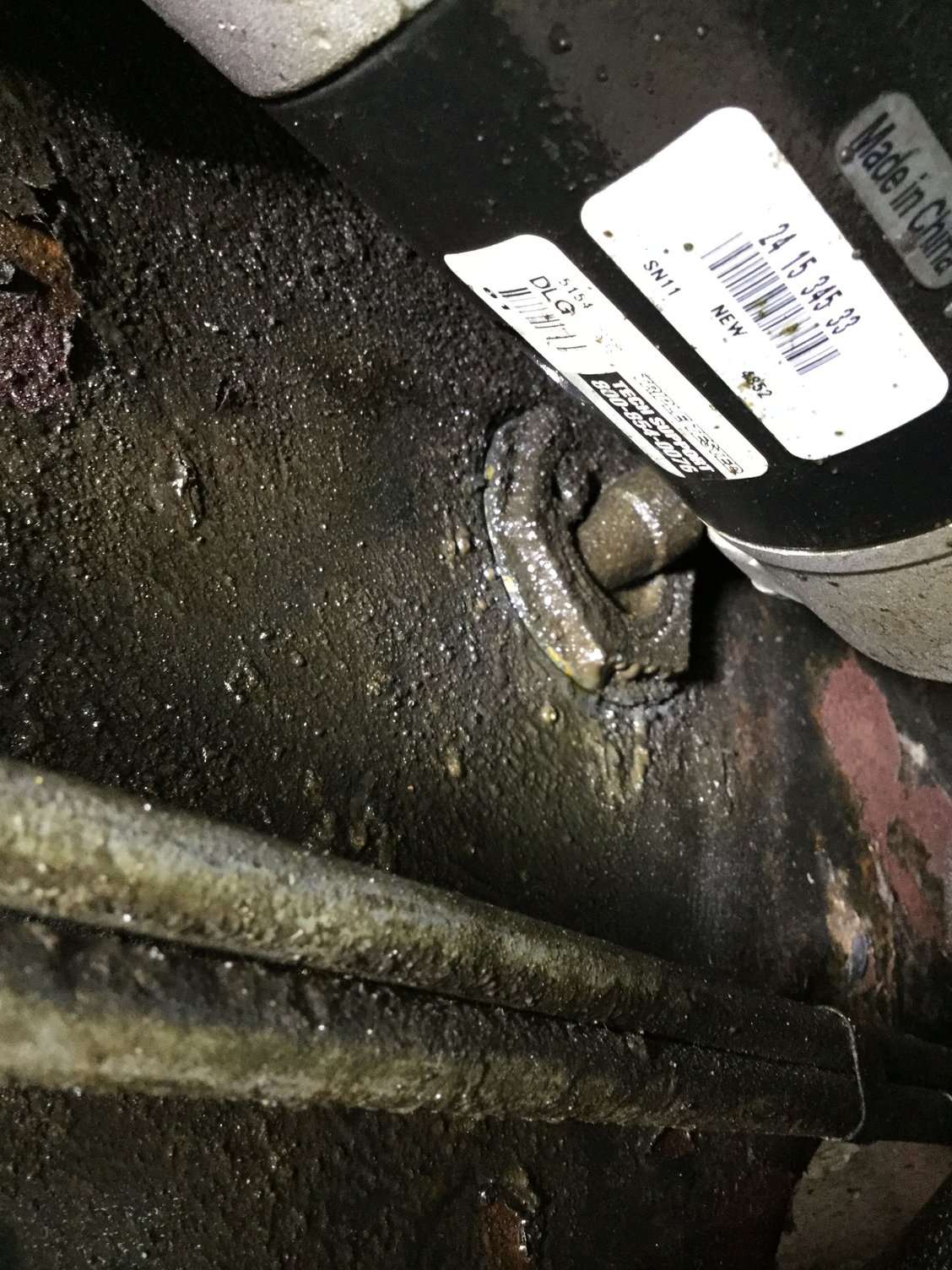

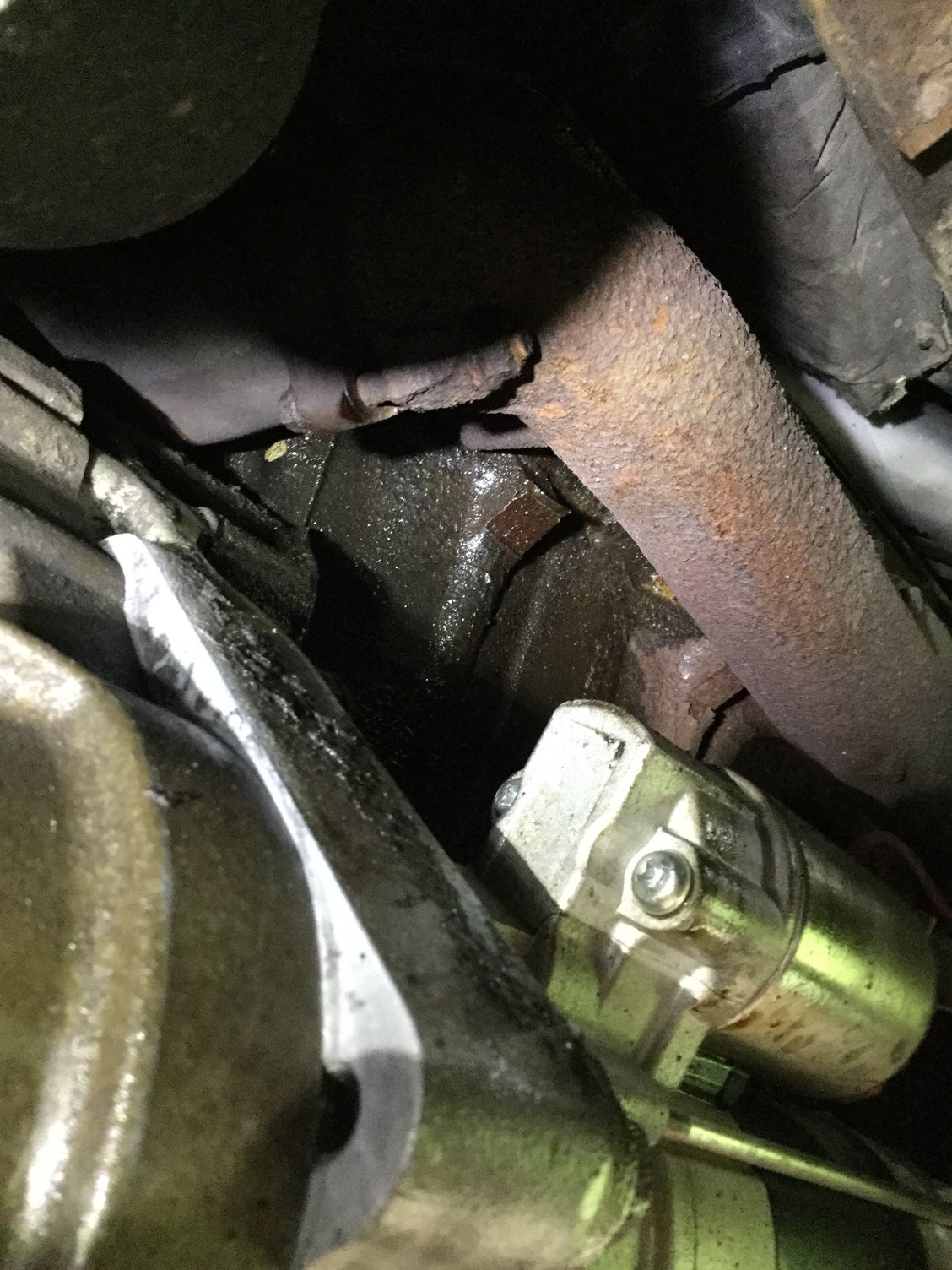

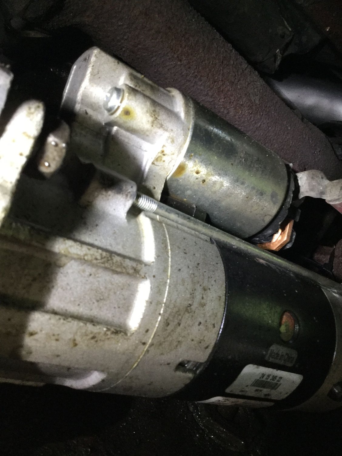

OK. Drove my truck about 10 minutes into town. On the way back, I could kinda feel it going in and out. RPMs stayed constant but I could feel it slow down, then jerk forward just a little.
Got some pics of the leak. Appears to just be the passenger side of the oil pan, tried to get some good angles. Oil level was at halfway between add/full before I started it today. Gonna go check it in a minute.
Just tried to get pictures of any oil I saw.
To make everything better I noticed the fuel hose I put in the other day started leaking. . . Guess I gotta crank the hose clamps down.

Got the leaked tracked down, yay. I guess.
It is the dipstick flange. Started it up and got under there, sure enough oil started flowing out.
So I just replace the O ring right? Part # F4TZ-6753-A ?
Sounds a little tricky but I think I can handle it, Im just happy to finally know whats going on.
