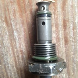

Here's a pic of an IPR. That piece that has a split in it is that little black spacer down at the end. I see no yellow O ring, just the two, which are green. If you blow it up you can see that the large O ring has some meat chaffed off of it into the threads right there, that O ring cannot be used again. They do not look like abnormally thick O rings and can probably be obtained at ACE or your auto parts store or local hydraulic shop, just make sure that they're Vitron.

@Walleye, Ive got the O rings sorted out. I put a new IPR in. I do believe Im missing the little seal that goes on the solenoid plug though.
