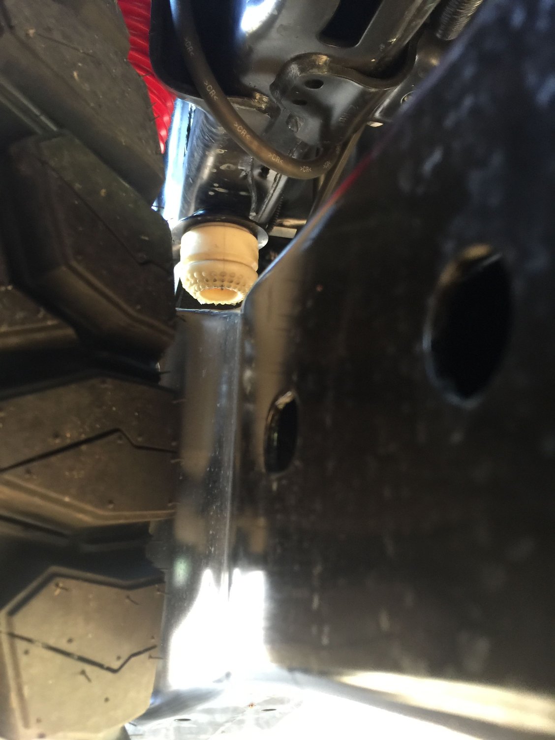

Hey Cutter, you might want to have them mount just one of the 37s and put it on the front before they do all the tires. Then check for clearance against the control arms. I think that is going to be the place they will rub before anywhere else. A super light rub is ok but if the tire is binding when turned at full lock that's no bueno.

Good advice Epic,just went out and took a pic of the 35's at full max lock.. The 37's are only 1.6" taller and no wider so they should be ok..

That's good news. My Toyo MT 315/60/20 (which are 34.9 inches) rub on the control arms when they are brand new but don't after a couple thousand miles. Amazing that you can now fit 37s in there. Ford must have changed something. Either the wheels don't turn as far or they've changed the offset on the wheels.
