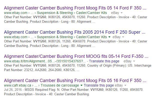

That's the same part that has been used on 05-14 or 16 F250s and F350s. I searched and found these available on Ebay:
The proof is in your statement that says it did the job. How did the truck feel before and after the bushing? Was it loosy before the bushing?

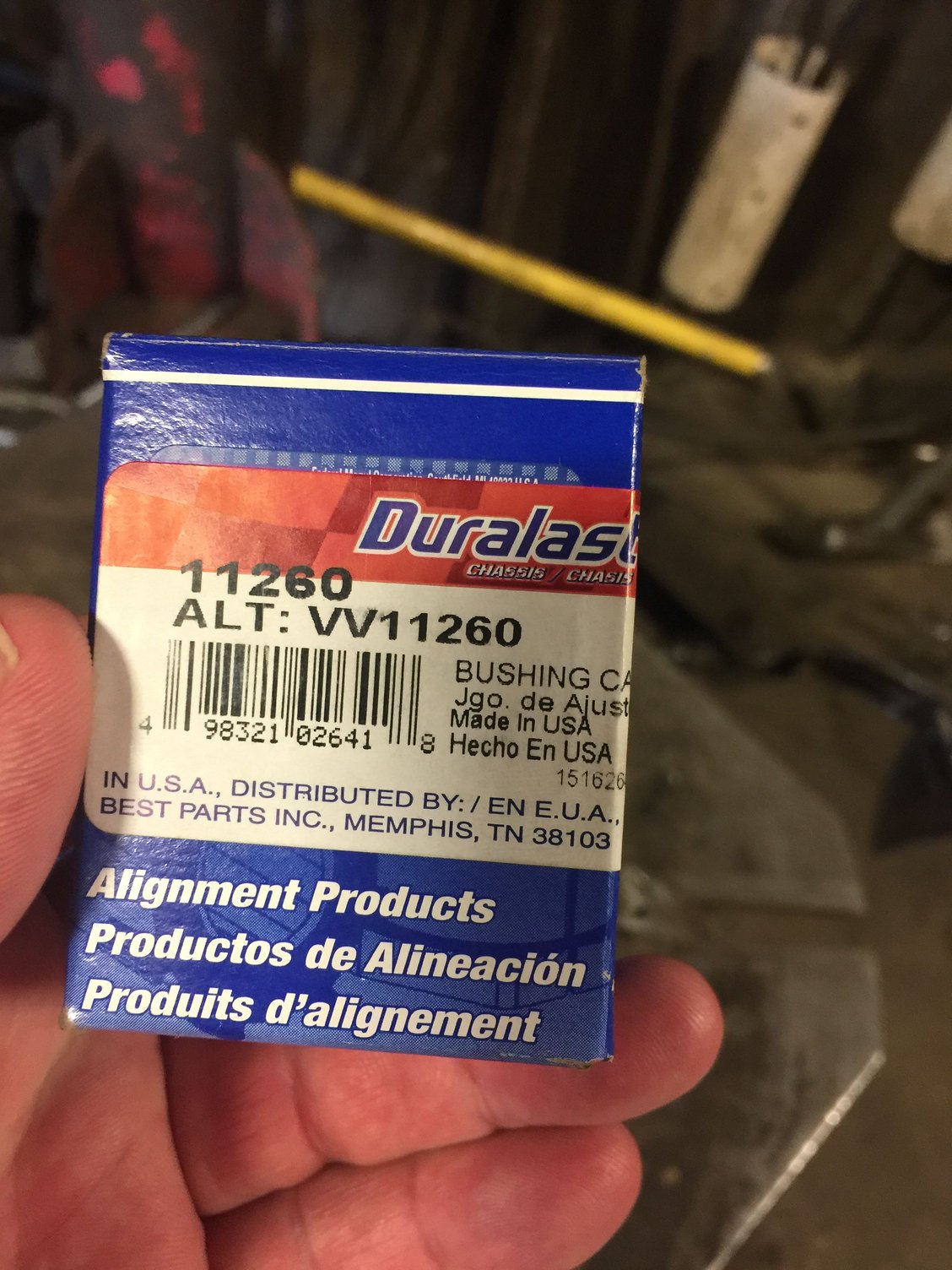

Epic oh yea im glad I done it,im sure it would've been ok without doing it but now the specs are exactly the way it came from the factory now.
The steering feels better and returns to center easy like before.

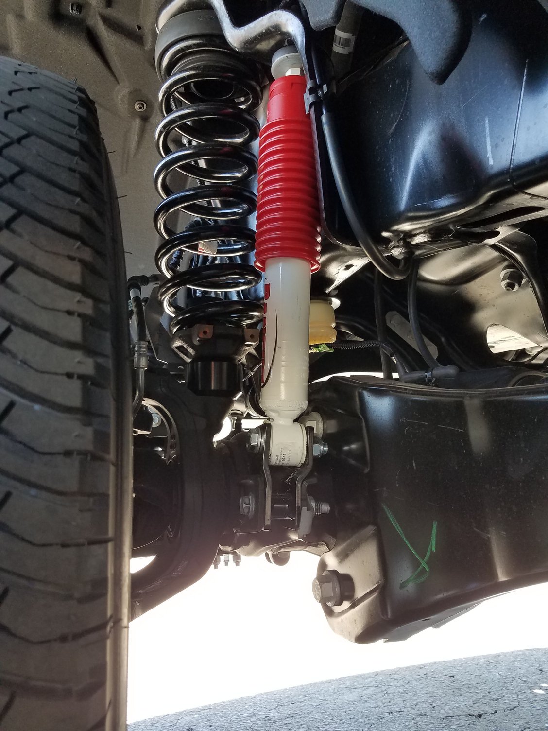

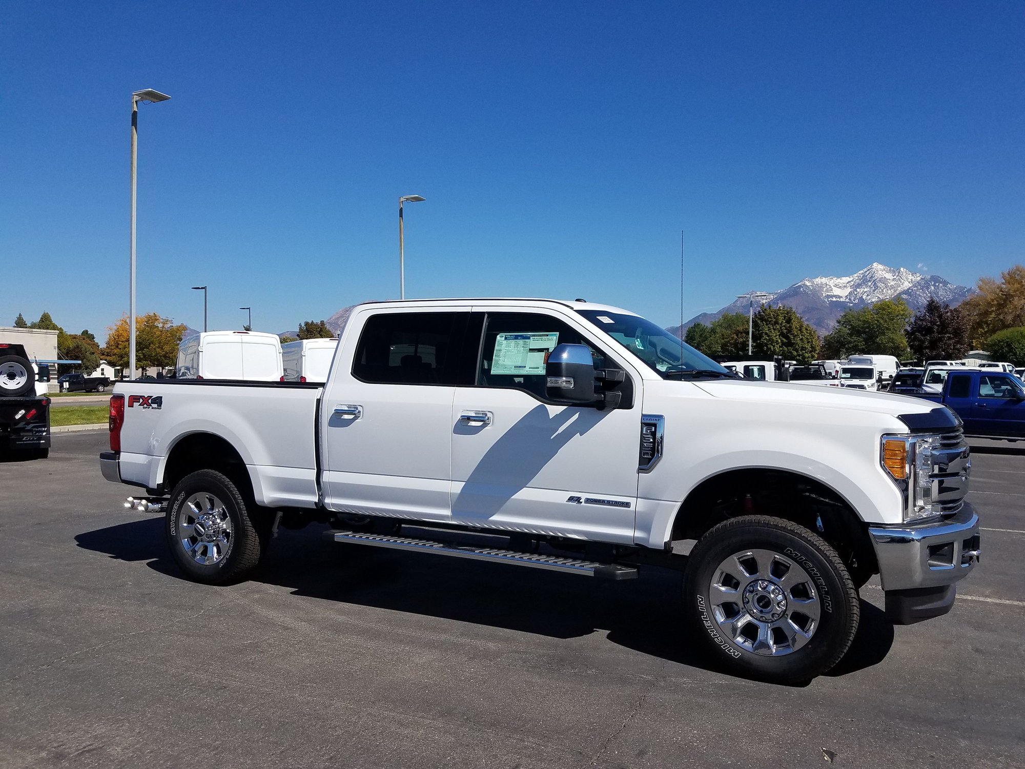

Leveled F-350
Found this at Larry H. Miller, in UT. Has a 2" spacer installed under the front spring bucket. Also has Pro Comp dual stabilizer.

You could pour a slab with that truck...pretty darn level.....Looks great!!
That doesn't look like it would clear the 37s. It looks like 35s might not fit. Hmmmm. Why would they go to the trouble and leave the tires stock? Which LHM is it? I live in UT also.
In Sandy. Still around back, so they may have bigger plans for it. It will definitely fit 35s! Has 275/65x20s on it now, basically 34s.

LEDman it will clear 37 12.50's like mine does.

Originally Posted by Rutcutter
Ok guys,got the castor bushings installed and alignment checked again and everything is spot on... Drives a lot better. Here are the part #'s to use with the 2" level.
Thanks! This is consistent with what PMF Suspension is saying also, that it is the same caster shim as prior MY. FWIW, they also have Icon replacement springs available now for those that don't want to use a spacer.
