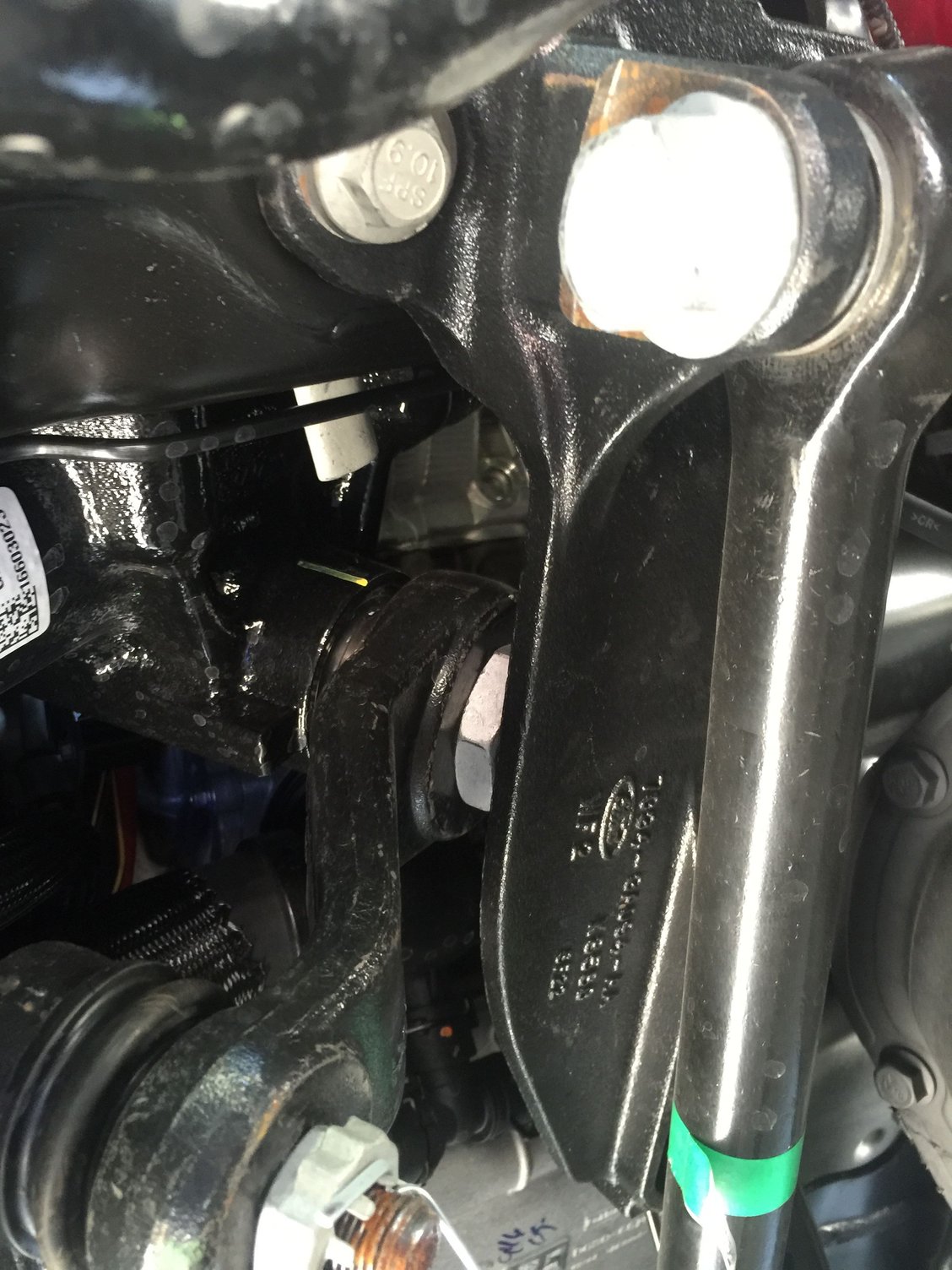

Epic when I get home this afternoon I'll crawl under the truck and snap a picture of this one.

Here is a pic of the track bar bracket,not sure if we can make anything out of it or not.

You could always install the spacers and wait for a track bar bracket to come out.
