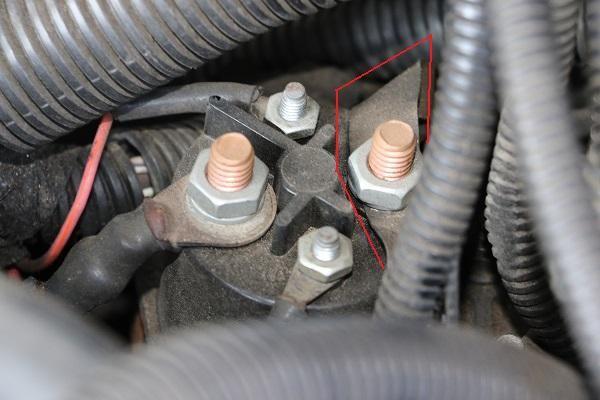

Originally Posted by Gidg
I made an assumption that my Ex had a Glow Plug Control Module without checking under the hood!
I just noticed this. In the above quote is the picture of your GPR.
Look at it now, with this outline I added.
It looks like that's the shunt outlined in red.
Can you confirm this, please?
Stewart

It is but I don't have the car. It's been in the shop for more than two weeks now!

Stewart, good catch. That is the shunt. If the wiring is still connected correctly and functioning, there has to be a problem with either the after-market chip or the PCM. Or I suppose there could be loose connections between the glow plugs and the shunt. Or are the glow plugs not all working?

Give that man a prize- yes we got the Excursion back last night. There is no shunt issue. Our mechanic is really phenomenal! He was 10 steps ahead of us the whole time. He had removed the chip from the old PCM and it didn't help so they replaced the PCM and all is well. They drove it enough miles and took it to the smog place and got it smogged for me. It passed. Hallelujah! The place where he got the PCM said they are going to start stocking them because the demand for PCMs is enormous! After two weeks and numerous hours spent by them diagnosing, testing, retesting, tweaking etc. they only charged us $300 for labor!!! God love 'em! He said he wouldn't have felt good about charging us for all the time they spent on it. They have a customer for life, no kidding. Highly recommended in Orange, California. Auto & Diesel Service, owner Fernando. (714) 538-5731
