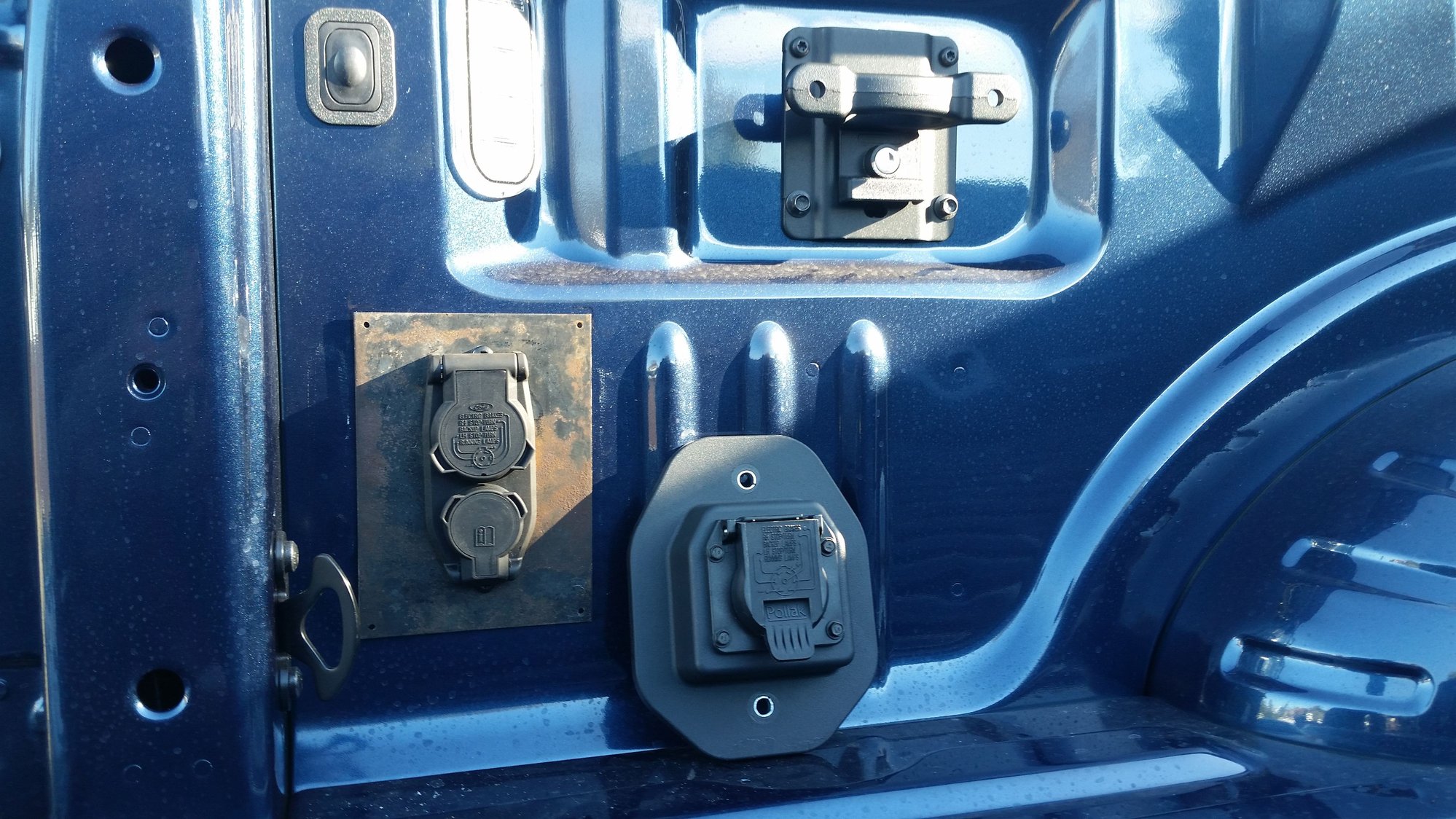

Boy, they sure are proud of their in-bed box and 12 pin extension harness.. $113 for a metal box? Plus the harness extension, for way too much and a 18 dollar piece of rubber.. GTFOOH!! $204 for nothing? Plus, I bet they're super proud of their proprietary shipping too, I didn't even look that up.. Somebody's smoking something down there in Arizona.. I'm thinking a little shade tree ingenuity will save that dough.. I took mine apart and checked it out. The 7/12 will fit in the hole in the aluminum bed side (under the plastic Ford box) mounted horizontally. Or I may take metal out if I really want it mounted vertically, doubtful though, keep it simple. I'm gonna make a plate out of sheet anything metal and rattle can it black. Done. Probably got some grey gasket material laying around too if want to get real special. It'll sit "flusher" too, don't really like the Ford box anyway. As for the wiring, any monkey can extend a simple harness like that. I'll look to post pictures when I'm done.. I can't believe products like these get any traction at all.. I guess the plug and play, easy peasy crowd will eat it up.

There's always that one guy... I'm all for free markets and such and this guy's market will determine if he keeps making them or just goes back to making walkway railings for the city. I don't know what my times worth at home, sitting around or chasing the dog around with an RC car but I'll be damned if I'm gonna spend half a day's pay on some dude's metal box.
Mine is done btw.. Pictures inbound

Call me the Geico Gecko
I just saved 100% in 100 minutes. Zero dollars spent so far.. I have plenty of wire, most all sizes, I'll extend the harness tomorrow. I'm gonna cut the corners off also and maybe round them off a little, make it look a little softer like the factory styling. It'll be LineXed in Tuesday and it'll almost disappear.
Trimmed some aluminum with tin snips.
Factory bolt holes and j-nuts are behind the hinges, hidden, which is nice but there's clearance issue. So, I took the Torx head bolts from the Box-Link plate and swapped them. After LineX, this thing is gonna look sweet.
