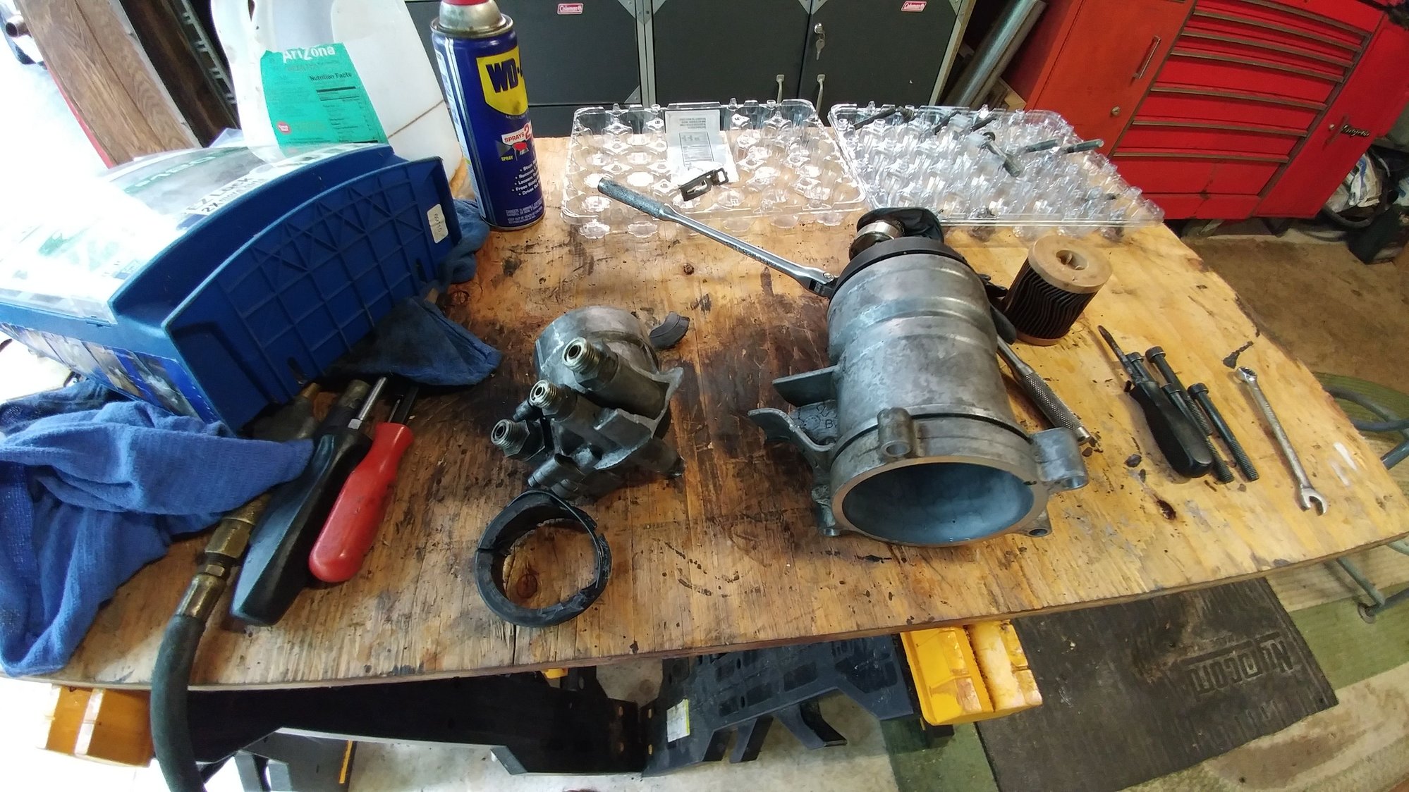

This is what happens when you don't torque the secondary fuel filter cap to 14 nm
Now you know why I got this truck cheap
