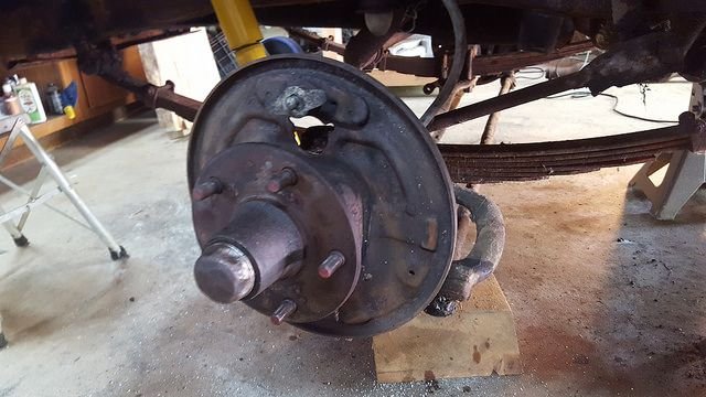

Another short day:
  • Old master cylinder removed
  • All four brakes completely disassembled / housings cleaned
I think I got the E-brake working, we'll see when I get new rotors and shoes installed in the back.
The lines were absolutely rusted through...
I can't wait to get this brake system rebuilt!

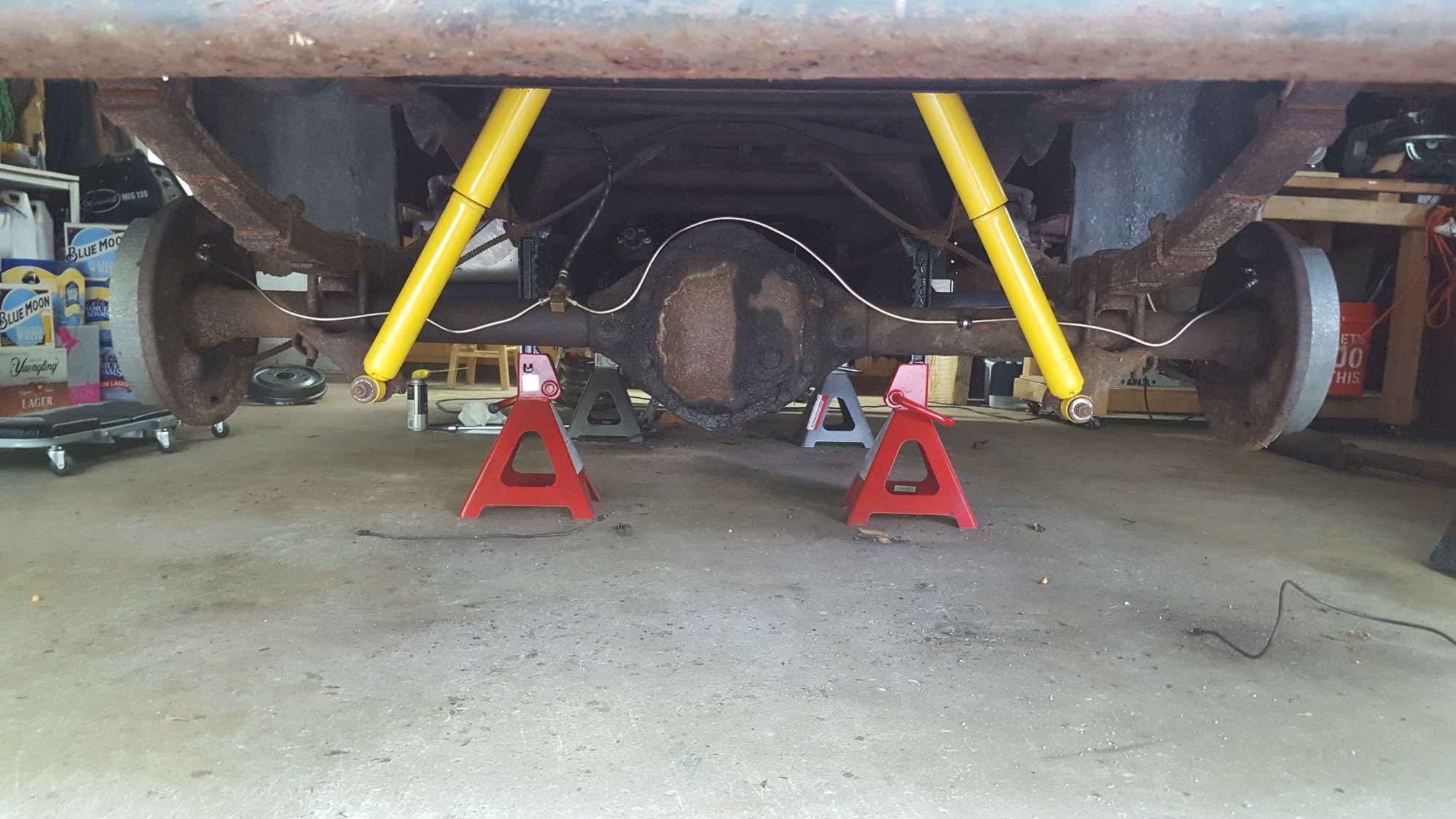

Got some things done this weekend:
  • rebuild of front and rear brakes with all new parts
  • master cylinder bracket installed
  • new brake hoses and brass fittings installed
  • found some junkyard seat belts
  • tires ordered
I was also able to strip one of the two buckets seats (which tuned out to be from a '64 GTO). I ordered new foam, and hope to stitch my own covers to save some $$$.
I need to spend some time researching how I'm going to mount the shoulder belts - any advice would be welcome.
I should be able to spend the next two weekends bending brake lines, then with the new tires installed, maybe a quick drive around the block!

Rear brake lines installed. Will hopefully get to the front lines tomorrow.
