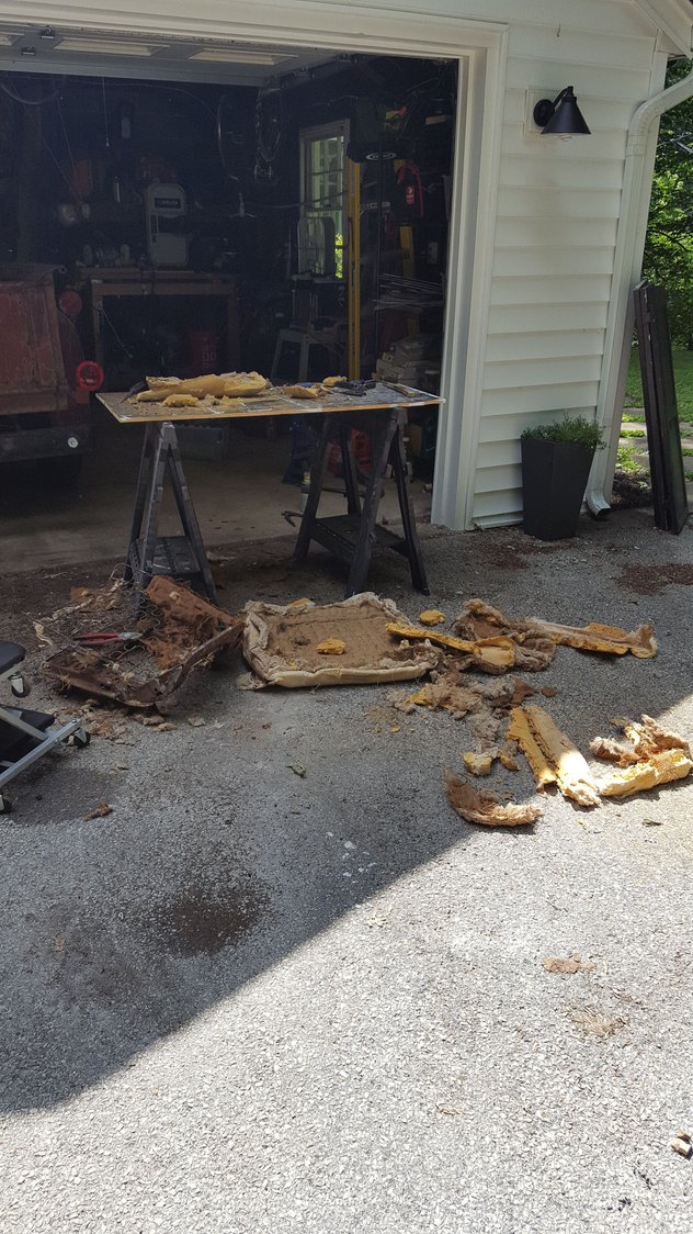

No wonder seat refinishing costs so much, just stripping the hog rings off is a PItA.

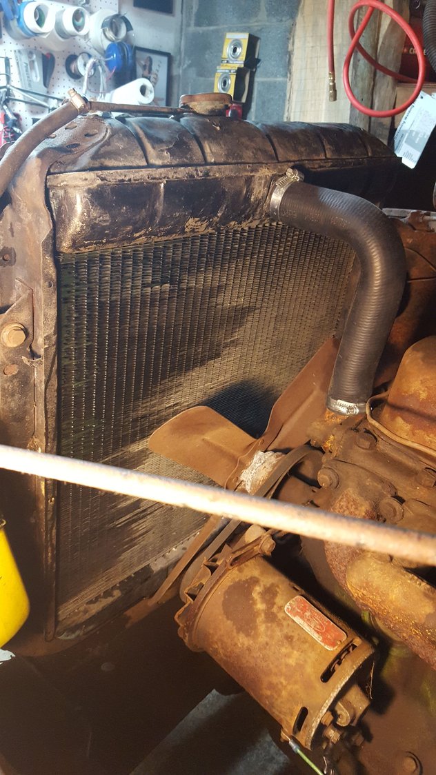

Before I could celebrate too much back in the garage, I realized I was leaking coolant. The leak seemed to stop when the truck cooled down, but not after I had a little puddle on the floor.
I was only able to look for a few mins, but didn't find any obvious source for the leak. (And it seems leak-free when the truck's not hot.)
I'll investigate further later this week....
Any advice on what to check would certainly be appreciated.

probably at the top seam, or out of your overflow if you do not have a reservoir for your overflow. You can rent a radiator pressure test kit from most auto parts stores, which may help you spot the leak

It is cheap insurance to take your radiator to a radiator shop and have them check it out. If it is a seam they usually repair them for not much more. You might find out that you're radiator is junk and it's better to find it out now then on a cruise or in a parade.

The more I thought about it though, the more I started to think that I likely wouldn't be able to repair the link even once I found it - so I look I'm going to pull out the RAD and let a pro give it a once over. (thanks BJ)

  • Drained and uninstalled radiator
    (so I can take it to a radiator shop to see if it's worth saving)

After the last test drive, I found the radiator leaked under pressure. I found a radiator repair shop not more than 10 miles away who was able to seal the leak at the seam, add a new overflow outlet, new drain, etc. and paint for just $130.
  • add stainless overflow reservoir, attach with rivets
  • reinstall and refill radiator
