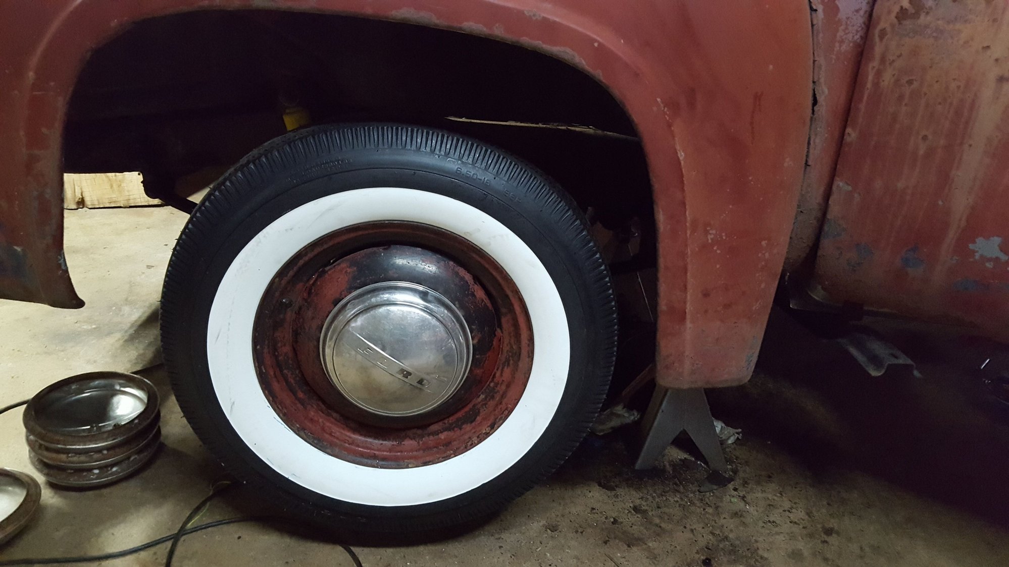

Woohoo!
Whitewalls

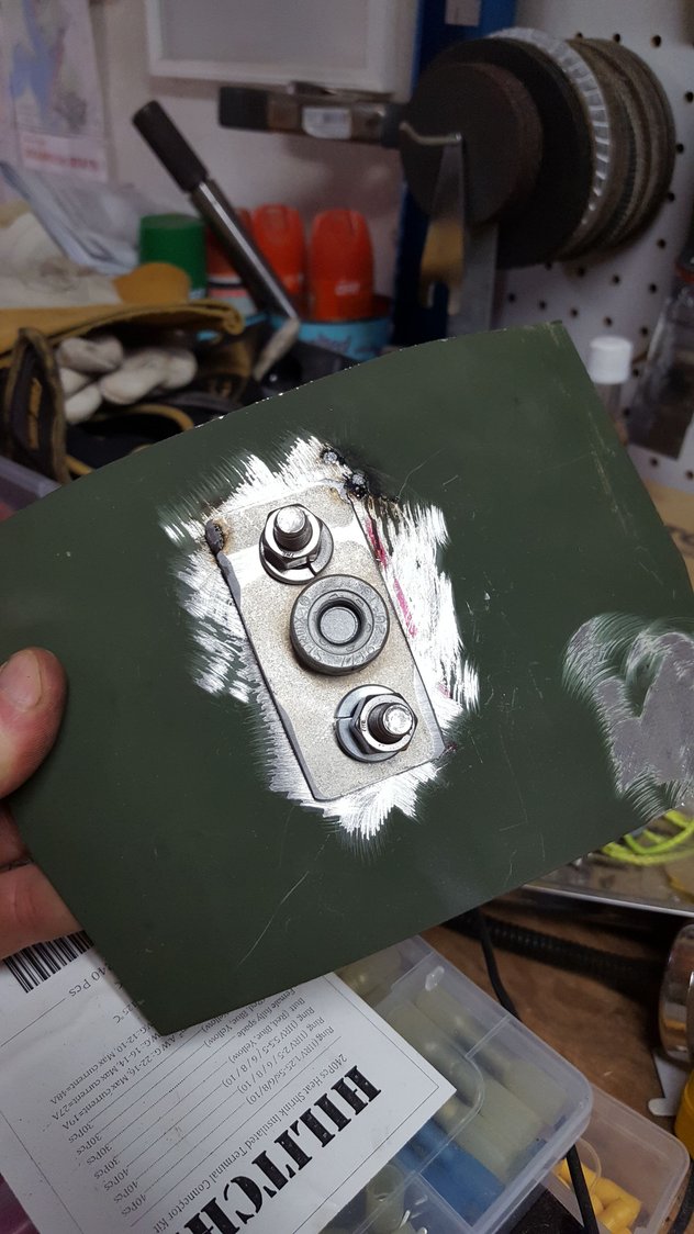

I started thinking about how I was going to do mounts for my shoulder belts. After messing with some options (see pictures) I don't think I'm using thick enough stock. I'm just going to order the mounts from MidFifty.
Also tried out the brakes. Still seem a little soft, so I have to make sure I'm not still somehow sucking any air into the lines.

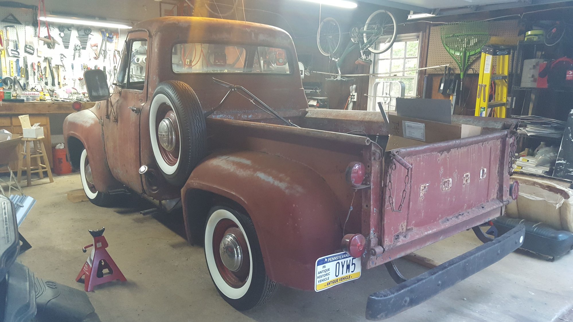

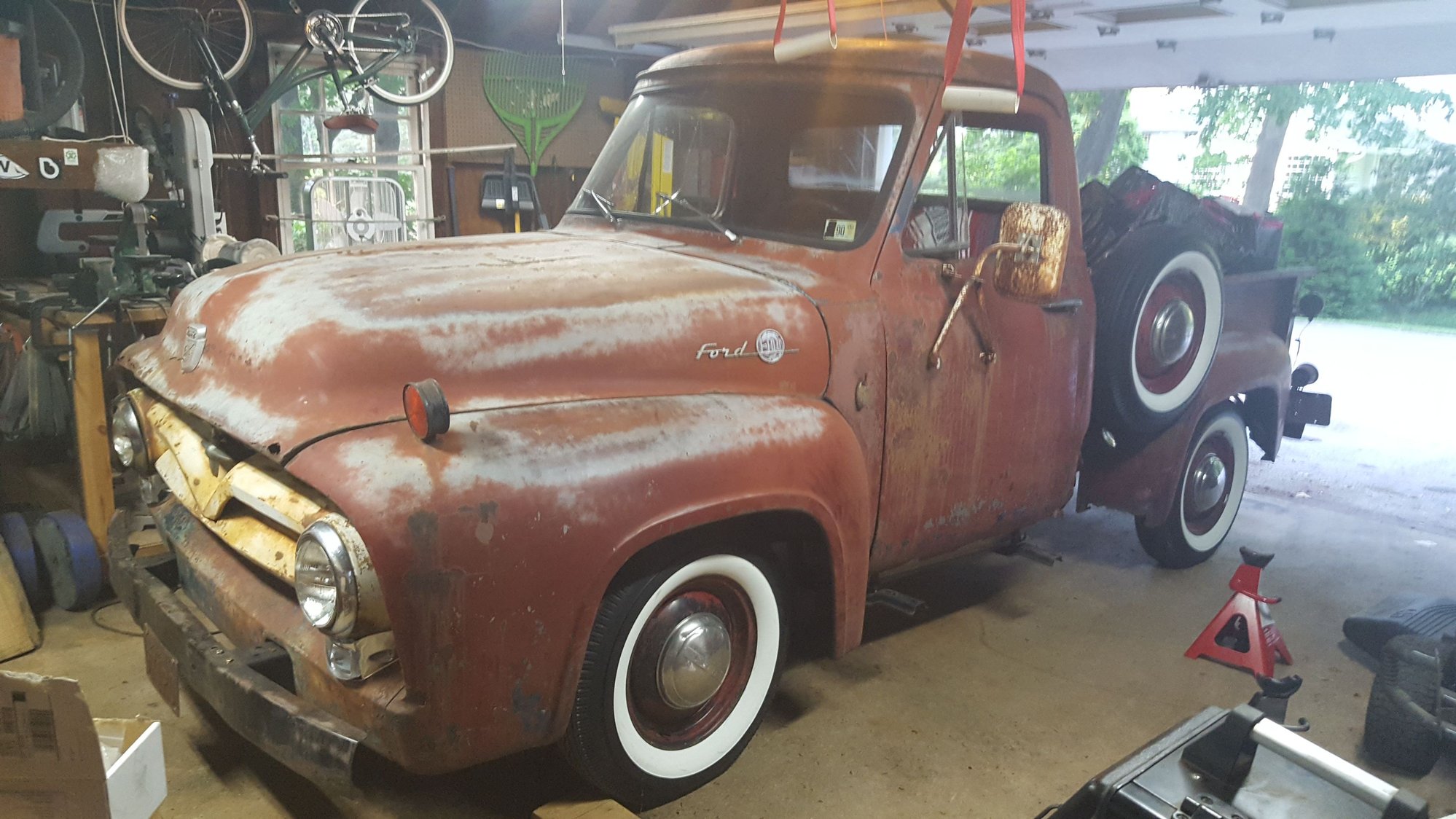

Woohoo! Driveway test driving!
Stopping with all new brake setup, going with fuel from its own tank / line!
