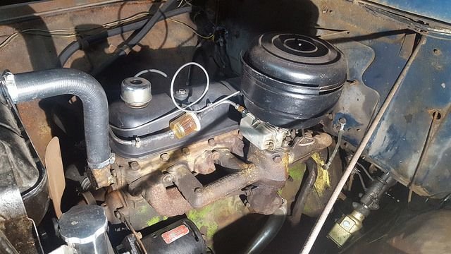

Today I installed the new starter solenoid as well as the new fuel pump. The new fuel pump seemed to take forever to get the carb bowl filled, but seems to be working well now... I can't believe how much sediment was in the bowl! Glad I had an additional inline filter installed (as well as the new tank and line). Got some new heater hoses installed as well.
Some of this wiring from the PO is just junk, but that's a project for another day.

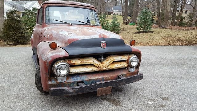

WARNING - lots of pictures coming...
  • new vacuum line installed
  • re-routed fuel line from pump to carb
  • hung Ford Trucks street sign! (present from a friend)
  • patched hood
I was really happy to get the hood patch welded in. Seeing those rust holes in the hood every time I opened the garage was getting tiresome.
I'm happy with how it turned out, and it was nice to add the new emblem.

Bill, you do good metal work. Maybe I'll drive my 55 F350 to Philly so you can fix the nose of my hood! Just kidding!
My hood isn't too bad. It is starting to bubble in some spots. I don't think it needs a total replacement.

Hey Bill,
I bet there aren't 2 guys on here who would have used that hood!
No problem you just reskin it like this.... That's a pretty amazing transformation!
You are the man...
Ben in Austin

Where did you get the nose piece? Mid Fifty?
MidFifty was back-ordered, so ordered the piece from LMC. They both carry the same part from what I assume is the same manufacturer.
I had a bit of trouble installing it. Once I had the original hood measured and cut, I started tacking the new piece in place only to realize it was sticking out almost 3/4" beyond the front fenders. That looked terrible, so I had to cut it back out and do it again.
The second time around, I was still having a hard time making it fit perfectly, so I finally cut the patch in half, welded in the driver side, and then the passenger. With that method, I needed to fab up and add in one more 1/2" piece right in the middle. Luckily it all came together nicely after about 20 mins burning my fingers at my little belt grinder getting that last piece just right.
