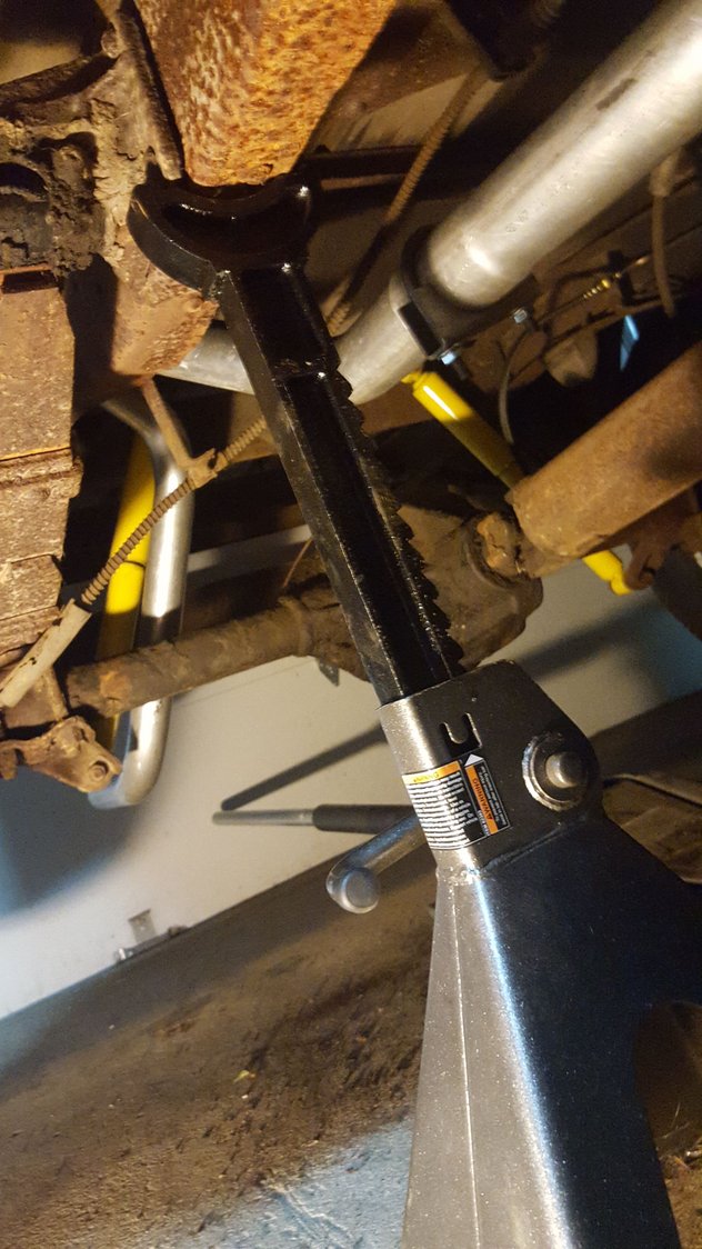

Also, I've been trying to figure out why the driver's side of the truck sits 1 1/2" lower than the passenger. On level ground, and jacks of equal height, the difference was within 1/8" - so I'm starting to think maybe the leaf springs on the driver's side are broken / worn out.

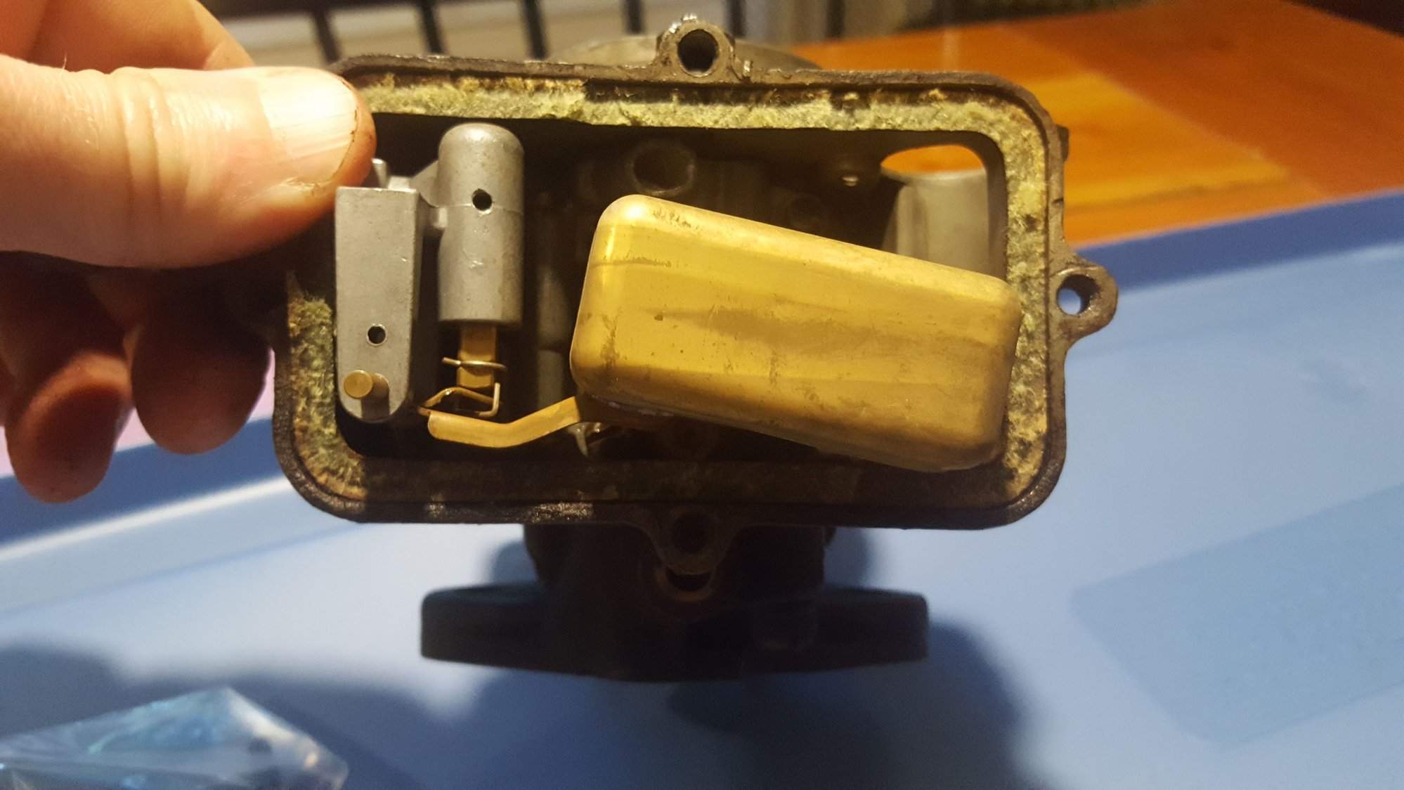

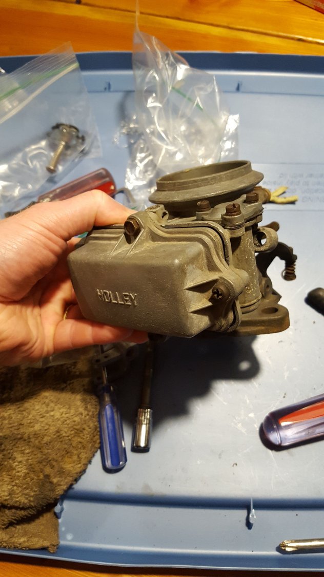

And the carb rebuild is complete!

Had to mess with the carb a little more to get it to stop leaking all the way. I think it's all good now.

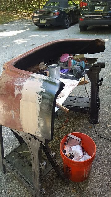

First patch panel in
Alright, got my first patch panel in place.
Up next is the driver's side fender, then door bottoms, then hood lip...
