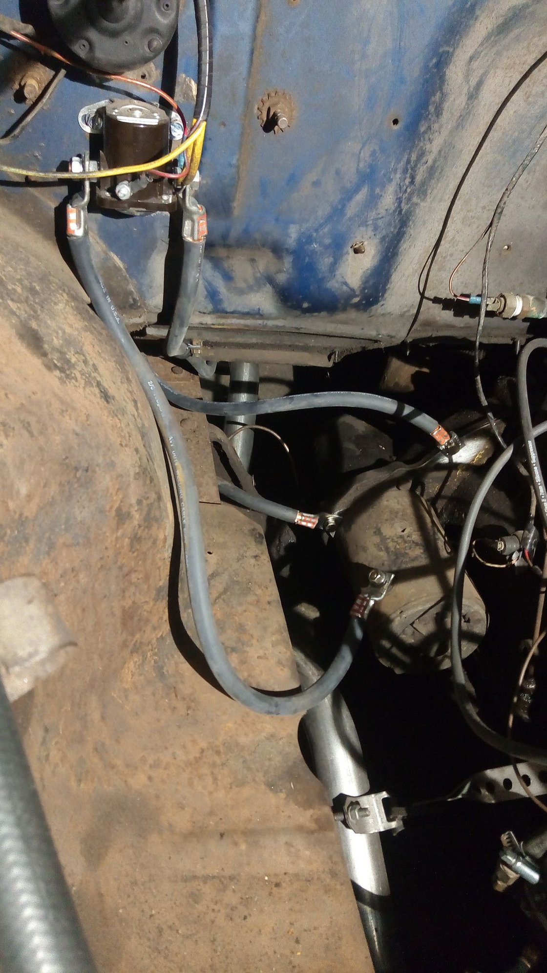

Quick update
  • Took out the distribuor and replaced the wires under the plate
  • Set the timing on the engine
  • Adjusted the carb float to eliminate flooding
  • Replaced all the cables with new 000 welding wire
What a difference. Two seconds on the starter button, and it starts up perfect every time. Awesome!
