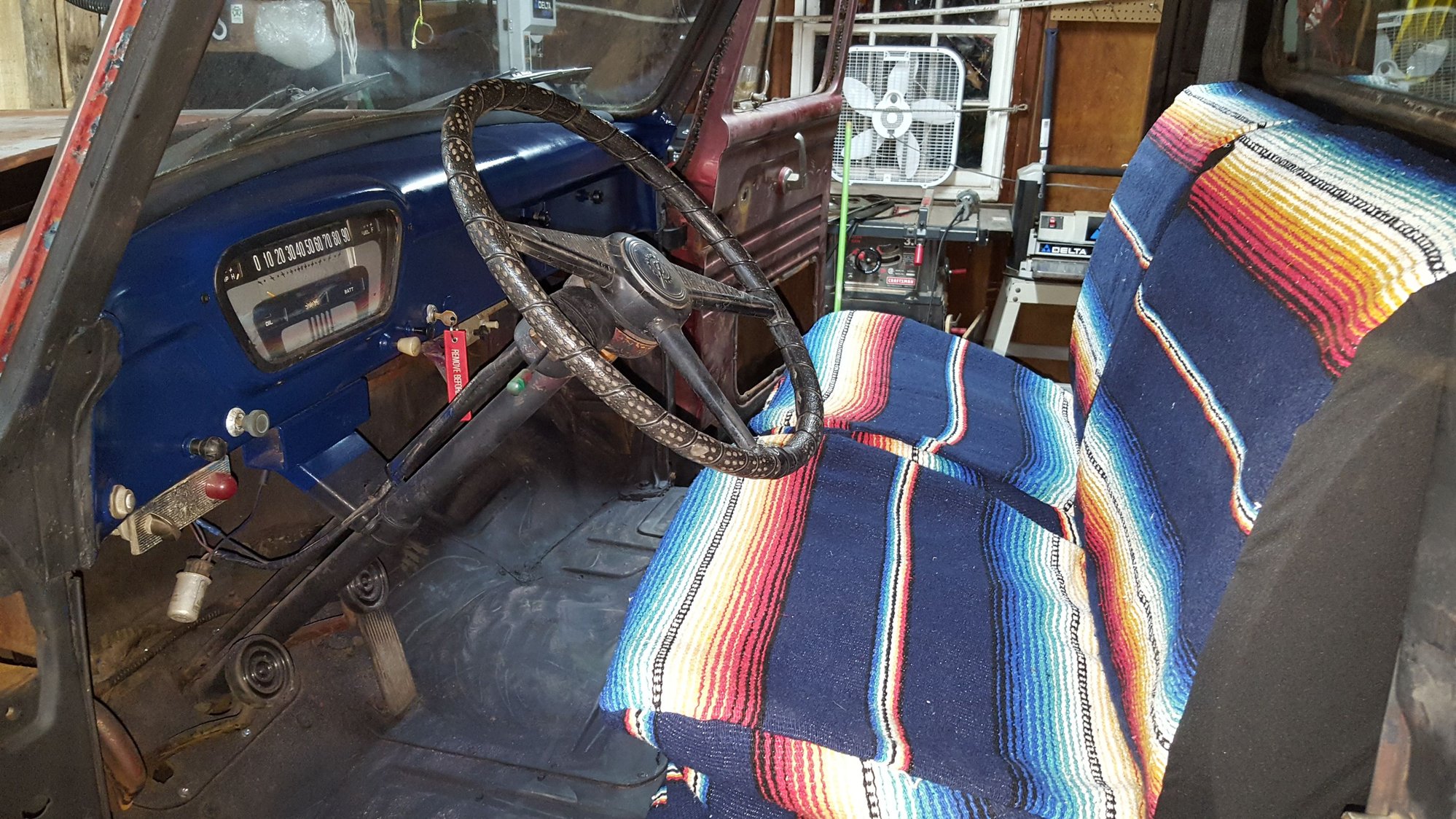

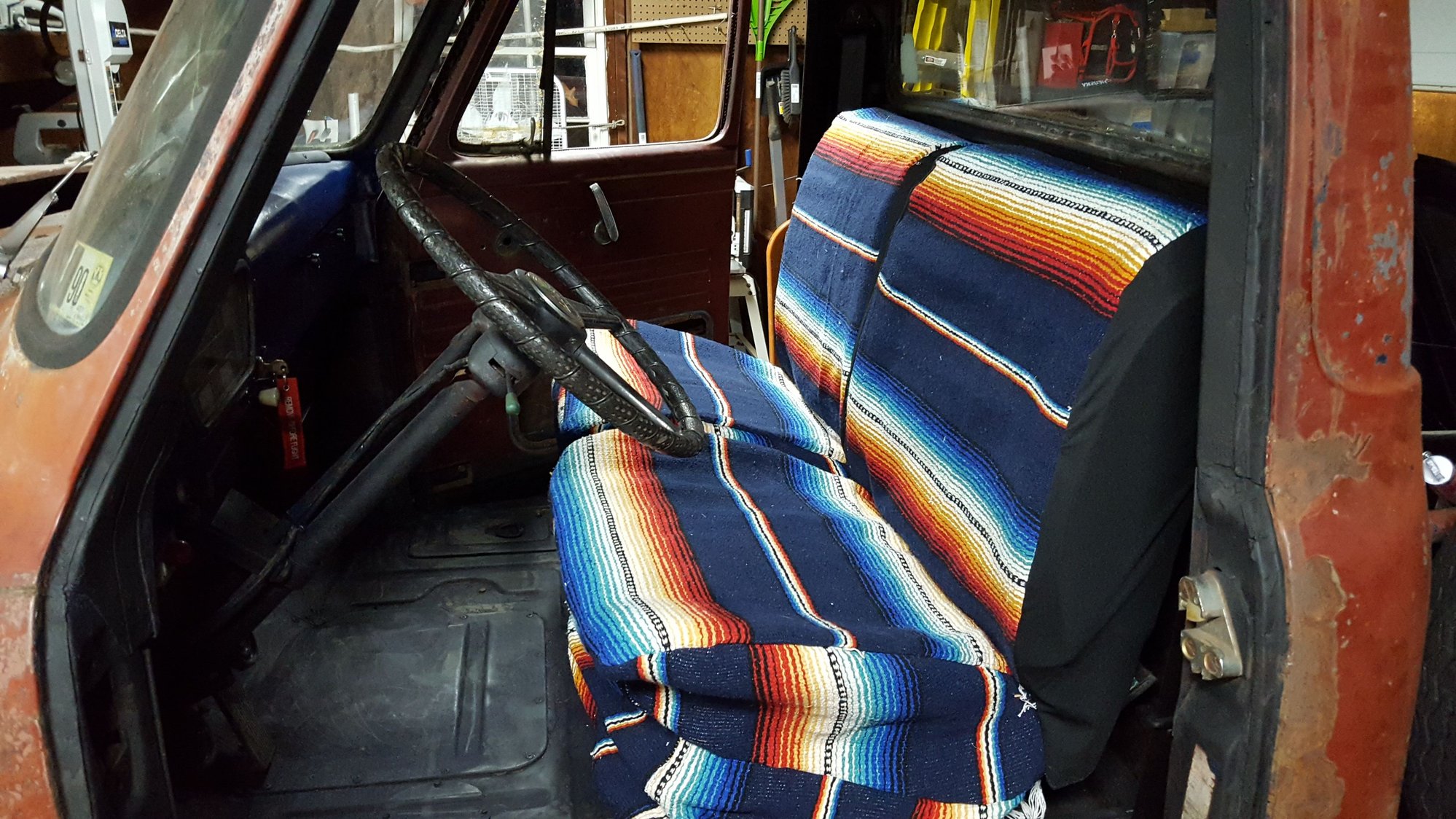

Got the new seats back in the cab today to see how they'd look. I'm pretty happy with them!

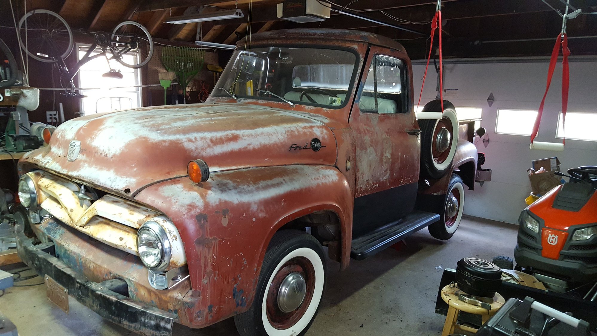

Tail lights, shift ****, and passenger door

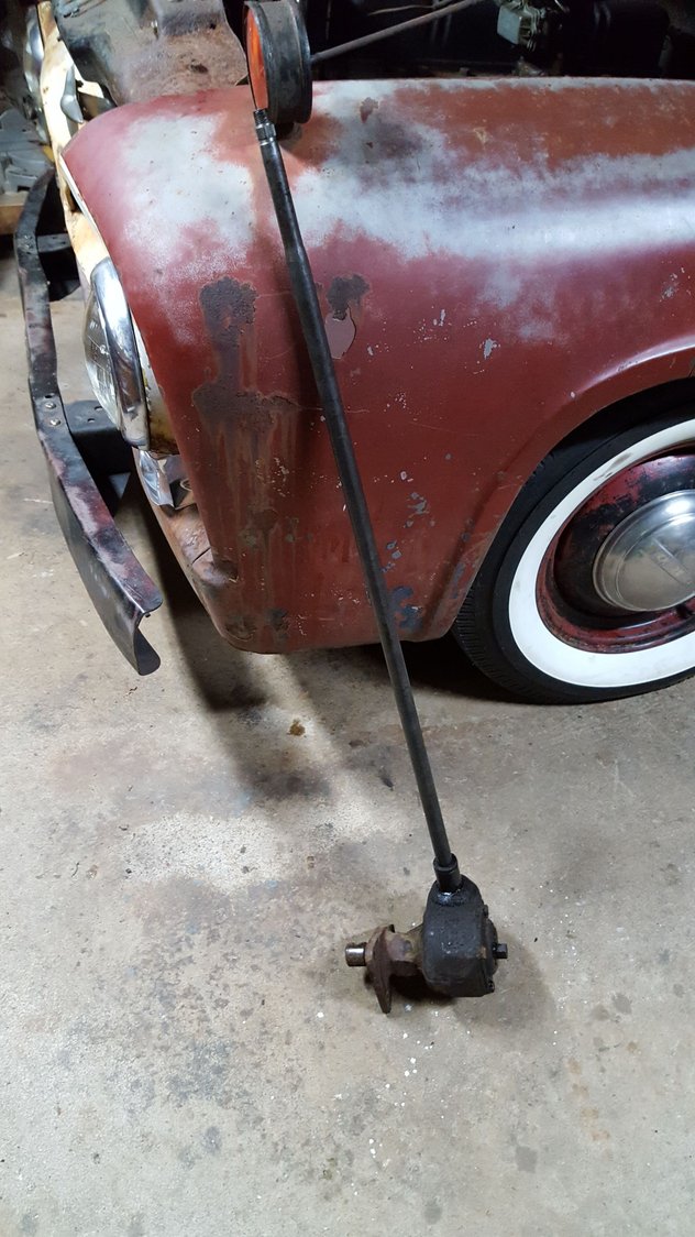

I'm not sure yet what to do with my worn-out steering box, so I tackled some minor bits in the meantime.
  • dome light new switch and re-wire

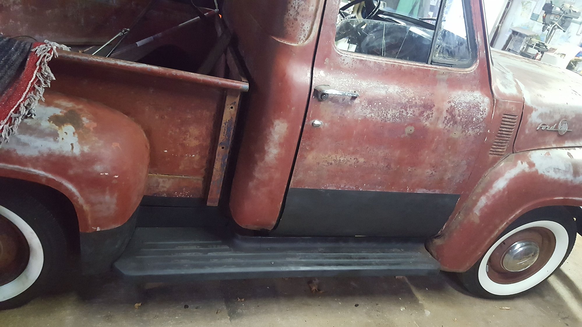

  • passenger door bondo'd, painted, and rehung (still need to finish inner)
  • tail lights installed and wired
  • shift **** made and installed
I even made a new rack for my all my pliers to further procrastinate the steering box.

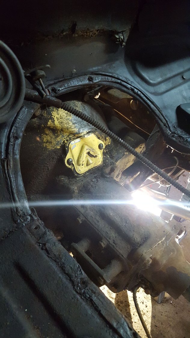

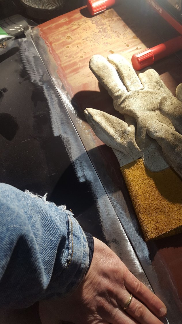

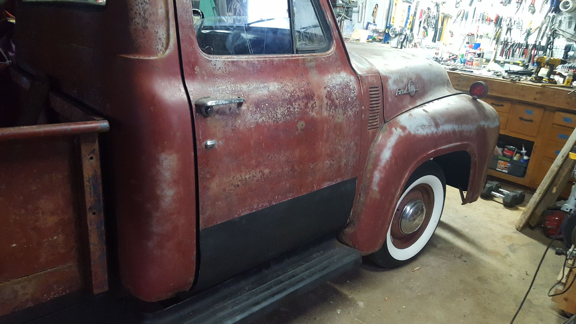

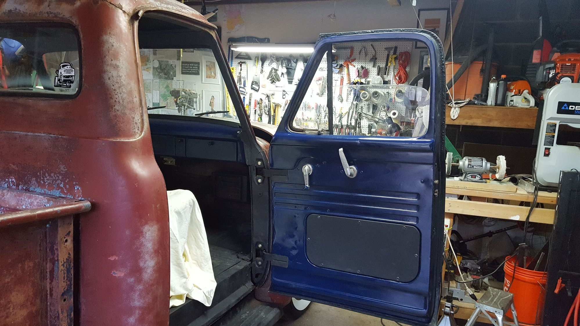

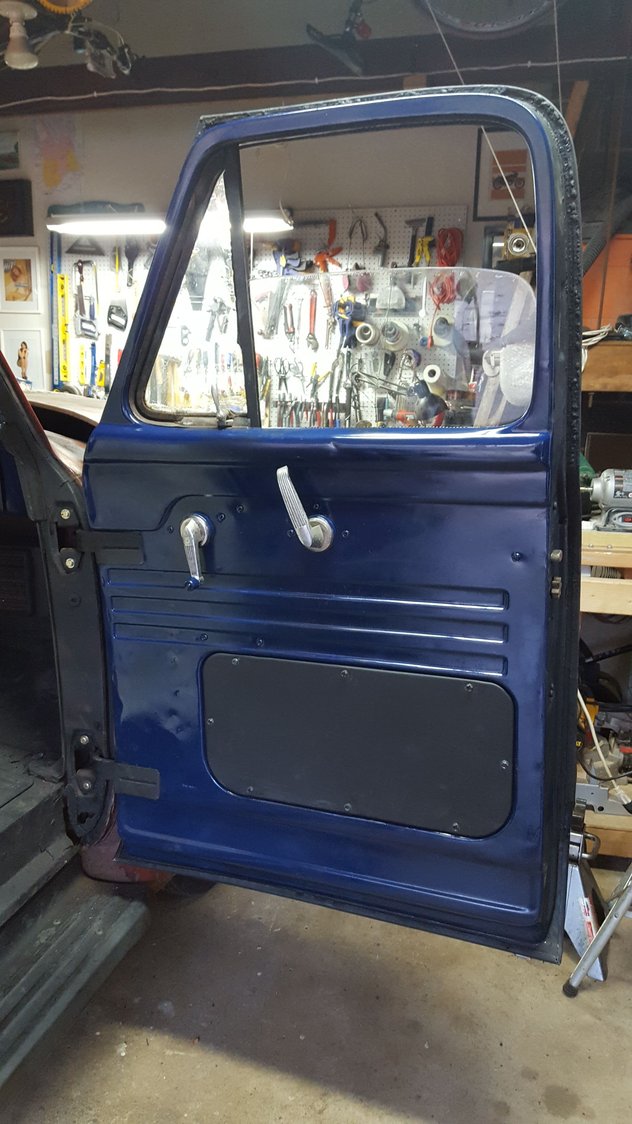

  • passenger door inner patch
  • passenger door painted
  • window crank modified so that spring can be removed quickly with tool
  • driver door inner patch welded and grinded

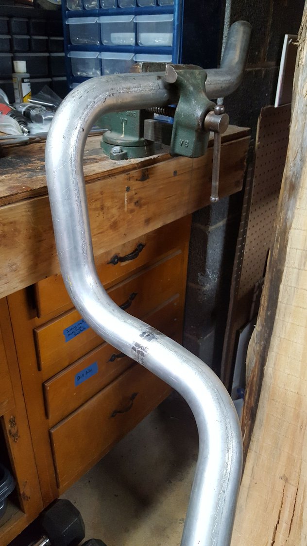

  • sweet new rearview mirror hung!

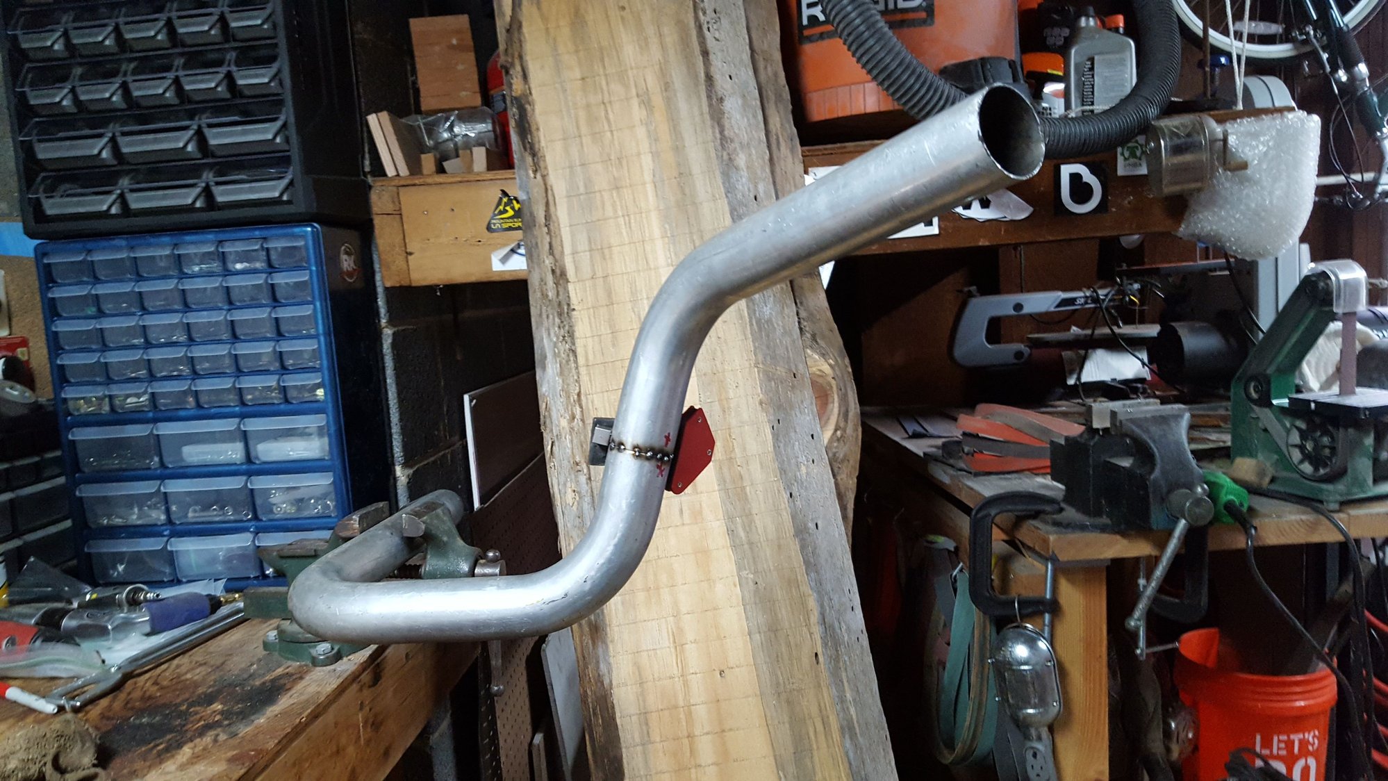

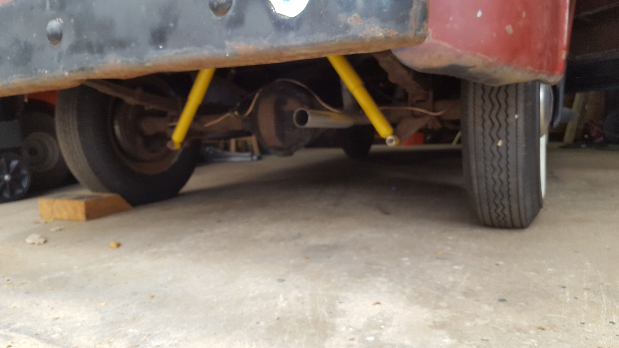

  • exhaust shortened and re-welded

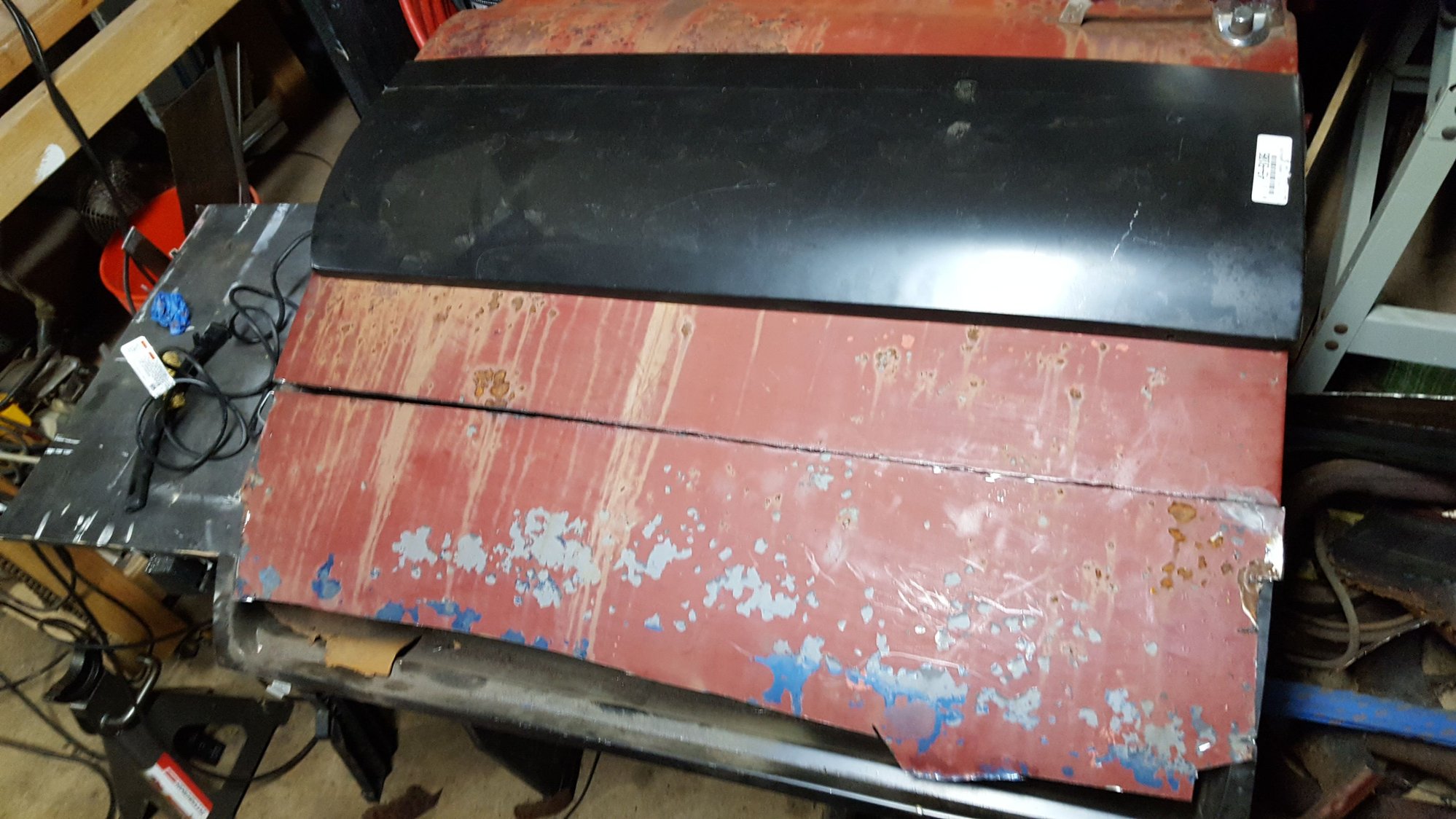

I need to cut and weld the outer patch on the driver's door, then Bondo, then paint, then new regulator parts, then new glass for both doors.
THEN removal of the old steering box and installation of the rebuilt unit.

After more research, I decided the best option was a new steering box from CPP. Got that installed this weekend as well as started going after the driver's door.
The steering still has more play than I'd expect with a brand new box, so I want to take a closer look at the pitman arm, etc.

I got the driver's door totally rebuilt including new glass, rollers, etc. in addition to the patch panels.

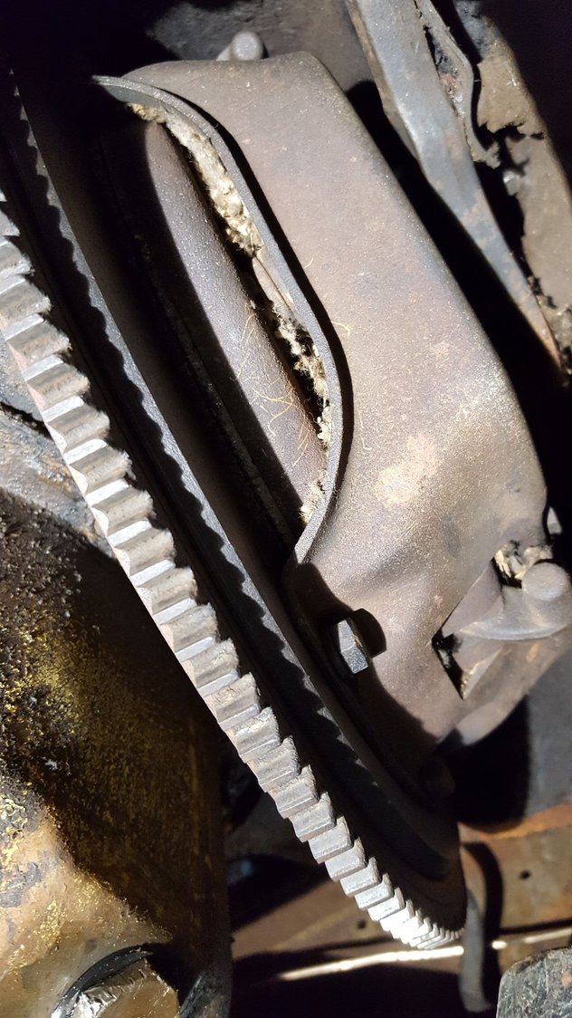

After removing the inspection cover and the dust cover to look into my clutch issue, I found a very compact and very full mouse nest in my bell housing. (So that's where my old seat cushion went!) I cleaned that all out, and was pulling my hair out trying to figure out what happened to my clutch - and then it finally hit me. I lost the bolt that goes into the end of the clutch pedal (the one that creates a firm attachment to the shaft it's on and therefore the rest of the linkage). When the bolt came out, the clutch pedal rotated on the shaft, and the clutch fell to the floor - but the release bearing was still 1/2" away from the fingers. What a dumb fix.

The hood lip patch panel I ordered is still on backorder, so the holes in the hood remain!
