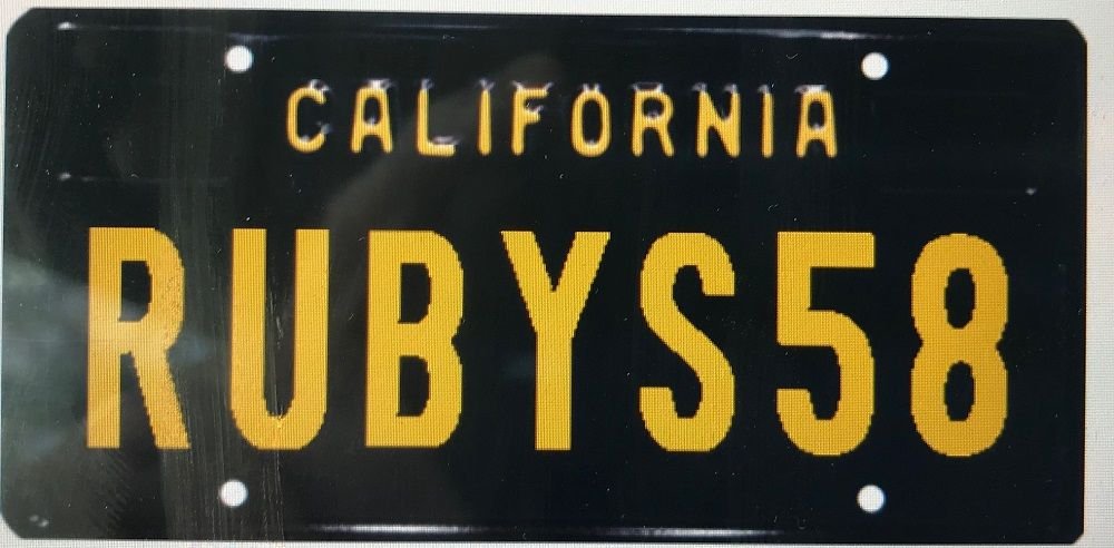

Oh best part, I was able to order a great plate for Ruby’s 58….
They won't let me have the original plates as I have no supporting documents to show they go with the VIN. Next best thing...

I like the personalized license plate. Toyota steering boxes (1979-1984 4X4) are getting hard to find. CPP makes a kit using their own aftermarket power box. It is not free, but in the long run may be a better way to go.
