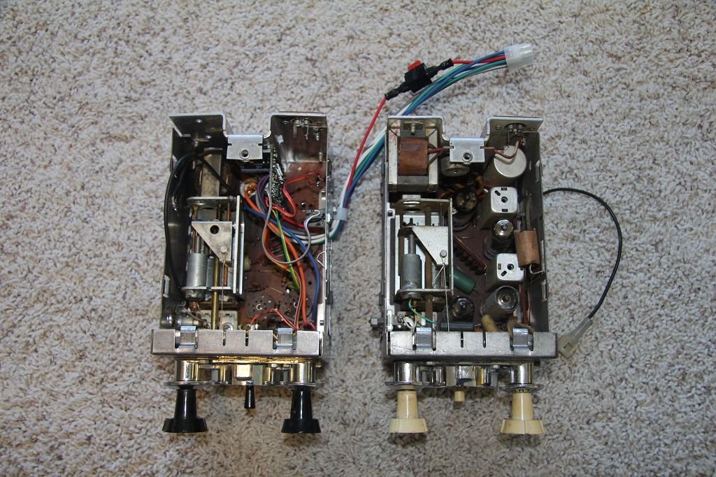

I took a stock 4 tube radio and had it modified with a solid state AM/FM module. The original radios do not have push button channel selection, but if you are looking for a totally stock appearance this might work for you. I also removed the old speaker and installed a pair of little "Kicker" speakers in the dash. It works very well. I did a thread on it a while back.

Is that an inset around the speaker hole? No hole in the new cab. I'm relocating the gas tank so I am thinking behind the seat and under dash speakers.
I might be better off just installing a hidden stereo at this time and readdressing installing the stock for another day down the road.

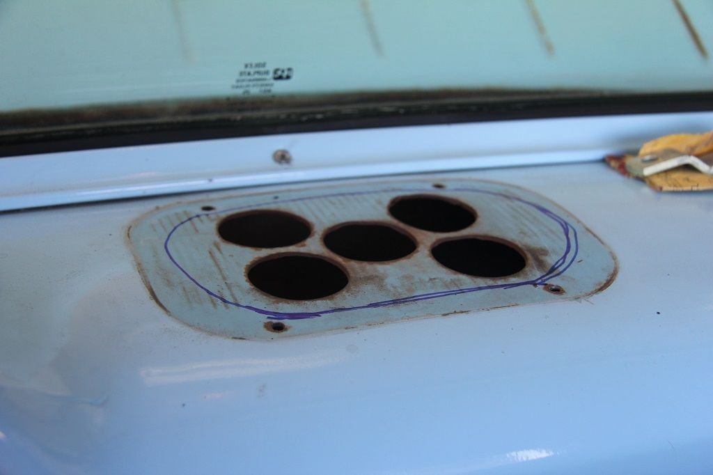

There is nothing around the speaker hole. It looks like there is something going on but that is just old paint. The speaker hole is actually 5 holes as it comes Ford (see picture). I hogged the hole out to accommodate the twin speakers needed for "FM stereo". The stock AM radio only needed a single speaker. My modified stock radio can now run 5 speakers.

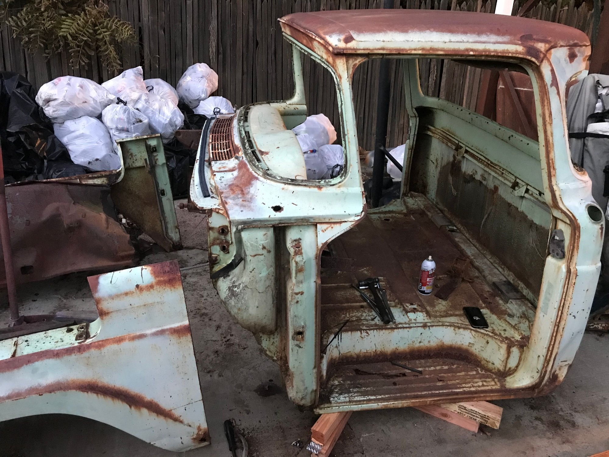

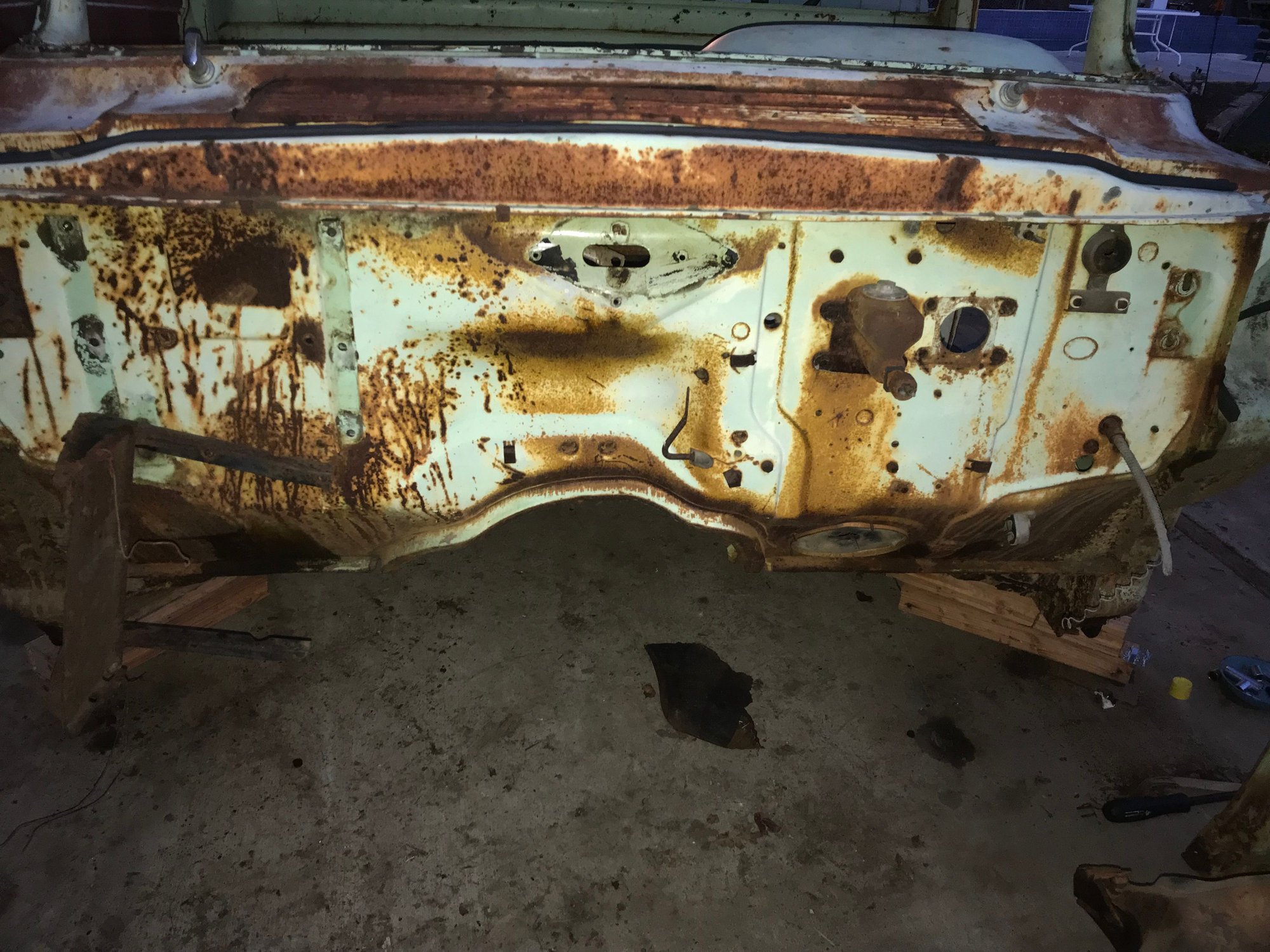

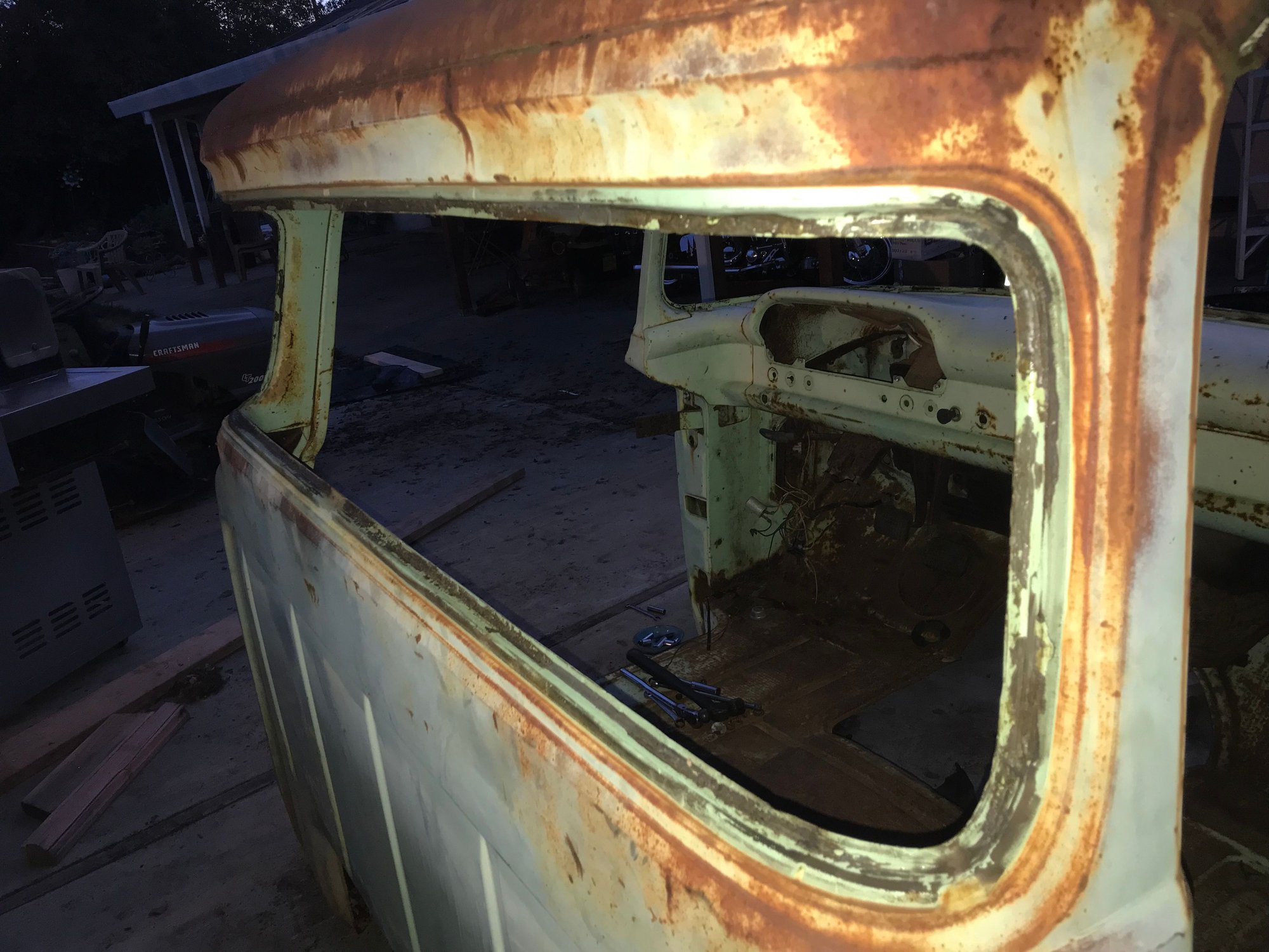

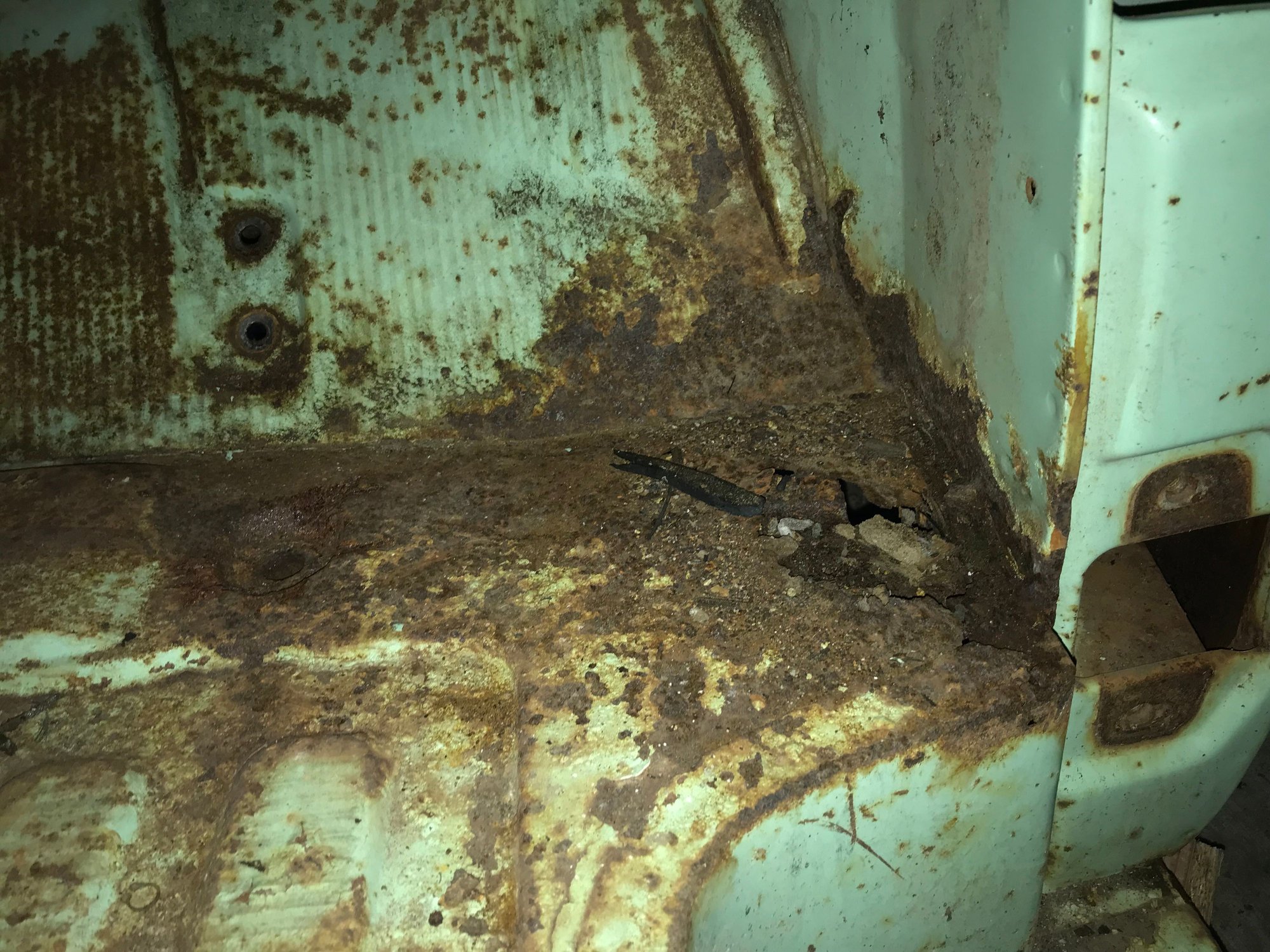

Band practice was cancelled so I was able to separate the front clip from the cab I was given last week and get a good look. I am very pleased.
I soaked all the mounting bolts with PB blaster and almost everything came apart as it was supposed to. There is much lass rust repair on this cab and I wont have to buy any panels except one step. Bonus is I can use the whole driver's side fender with very little work. All the mounting bolts are solid and usable. I can also use the back half of the passenger fender. Very repairable rust and the mounting bolts are there and solid.
It will need new front cab mounts and some sheet metal replaced around the mounts. Very happy with this find. It was worth the price of FREE. Here are some pictures.
Cab and front clip separated pretty easily. Only bolts that broke were the two on the L bracket between the firewall and top of fender.
Front window frame is in great shape. Looks like there were no leaks.

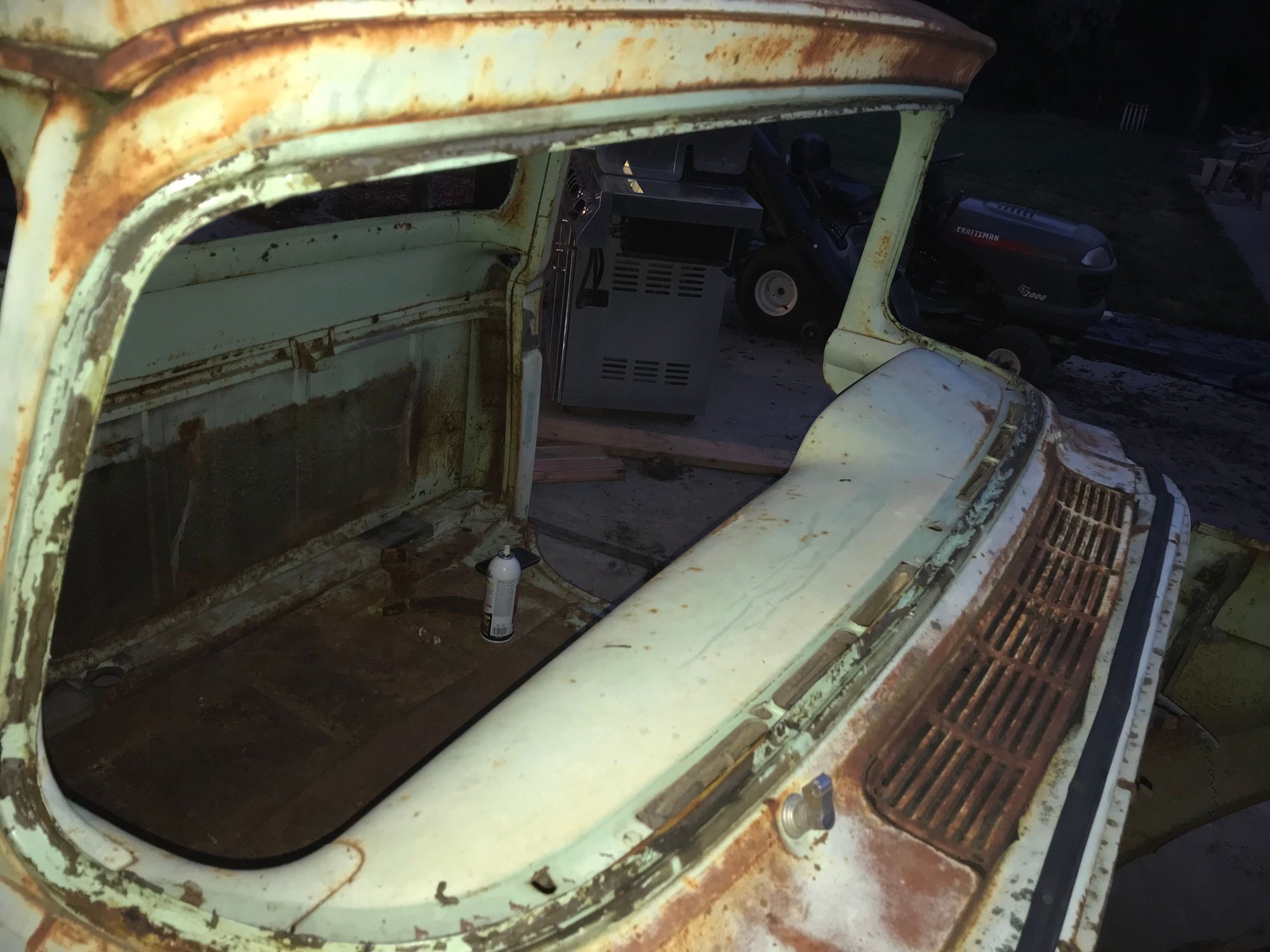

Back window frame in great shape too.
Firewall is really straight and unmolested. I think I might cherry out the engine compartment now. Maybe even repaint with Seafoam Green.

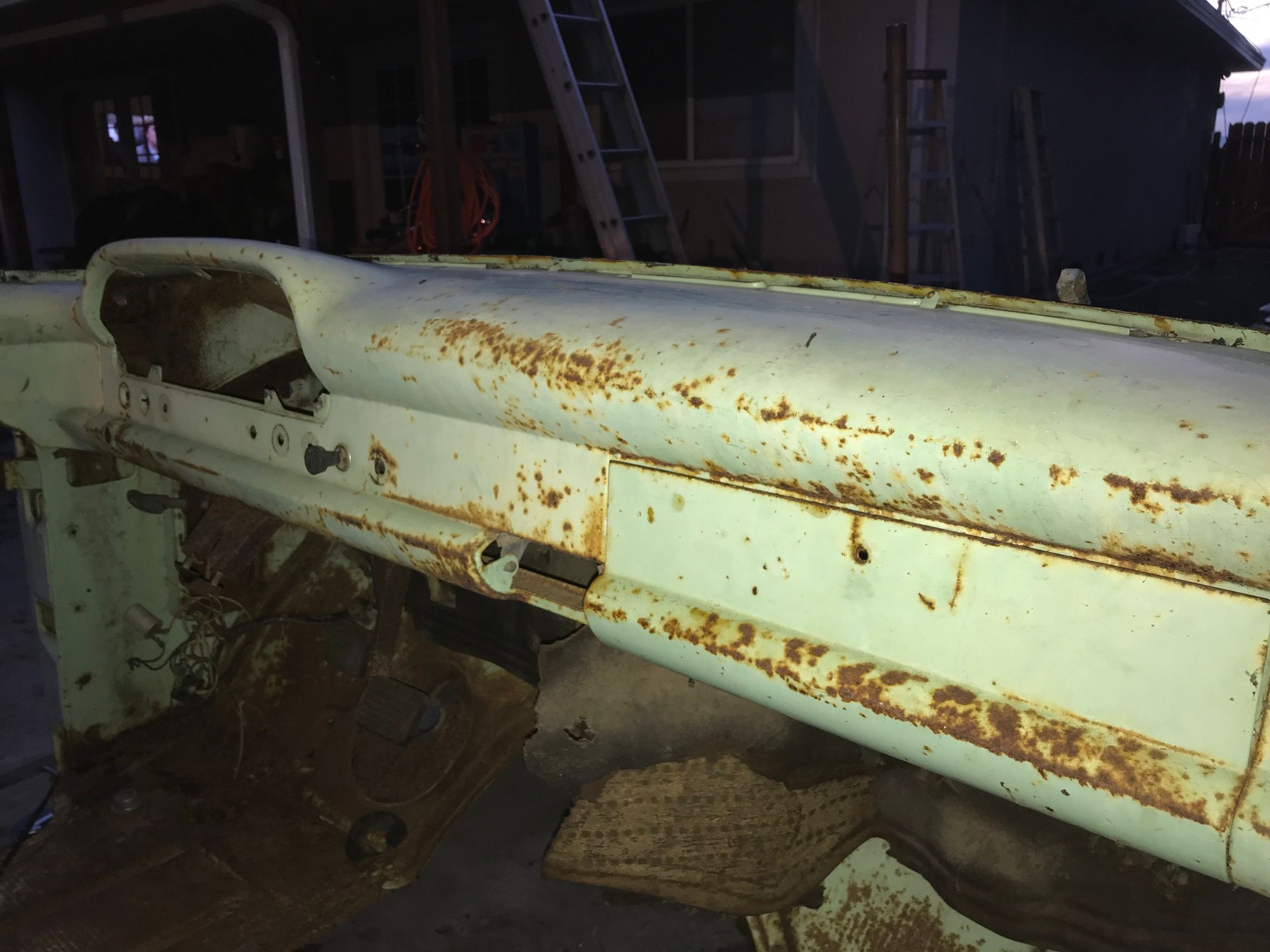

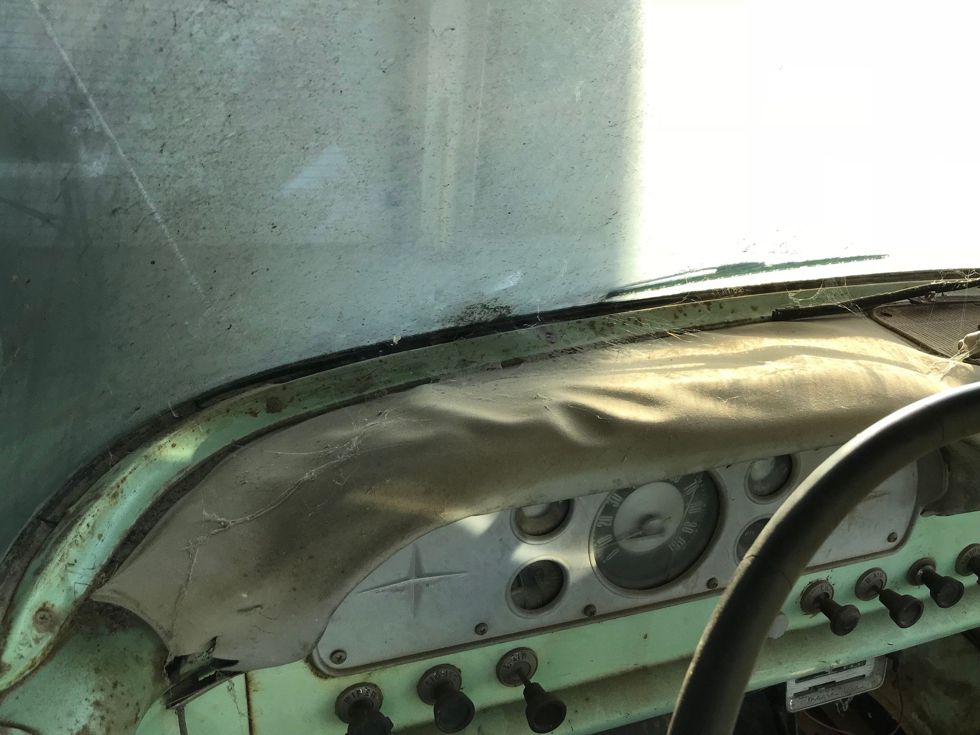

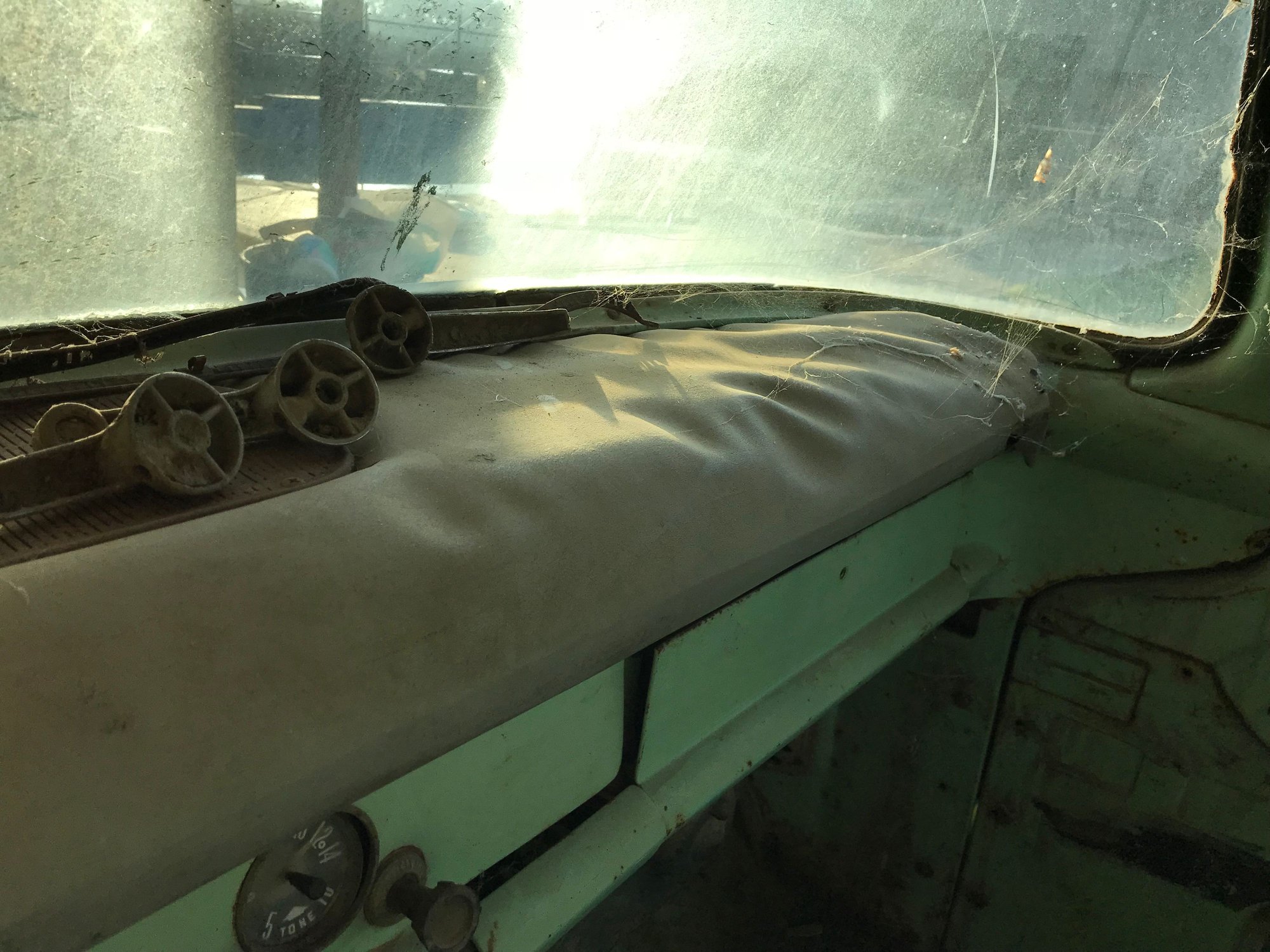

Dash is not padded like the original cab and there is no radio but both of these are actually a plus now. I can clean this up and cherry it out pretty easy. I'll hide a stereo and speaker and use a remote and bluetooth.

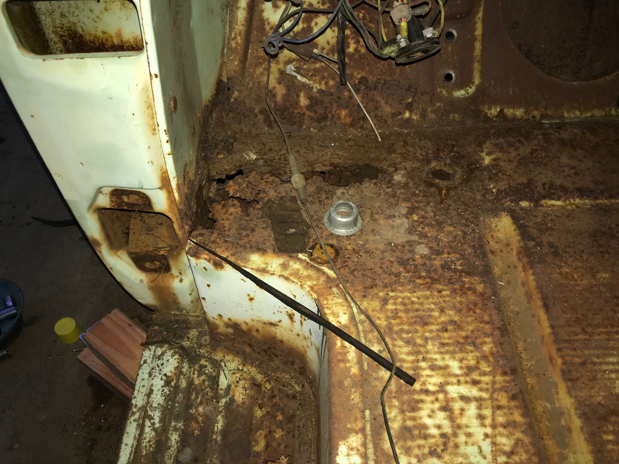

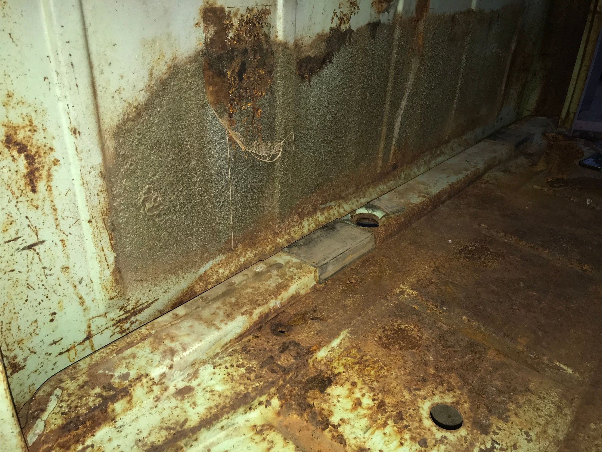

Needs front cab supports and a little sheet metal but not floorboards like the other cab. Dimmer switch is there also and it checks out good with a multimeter.

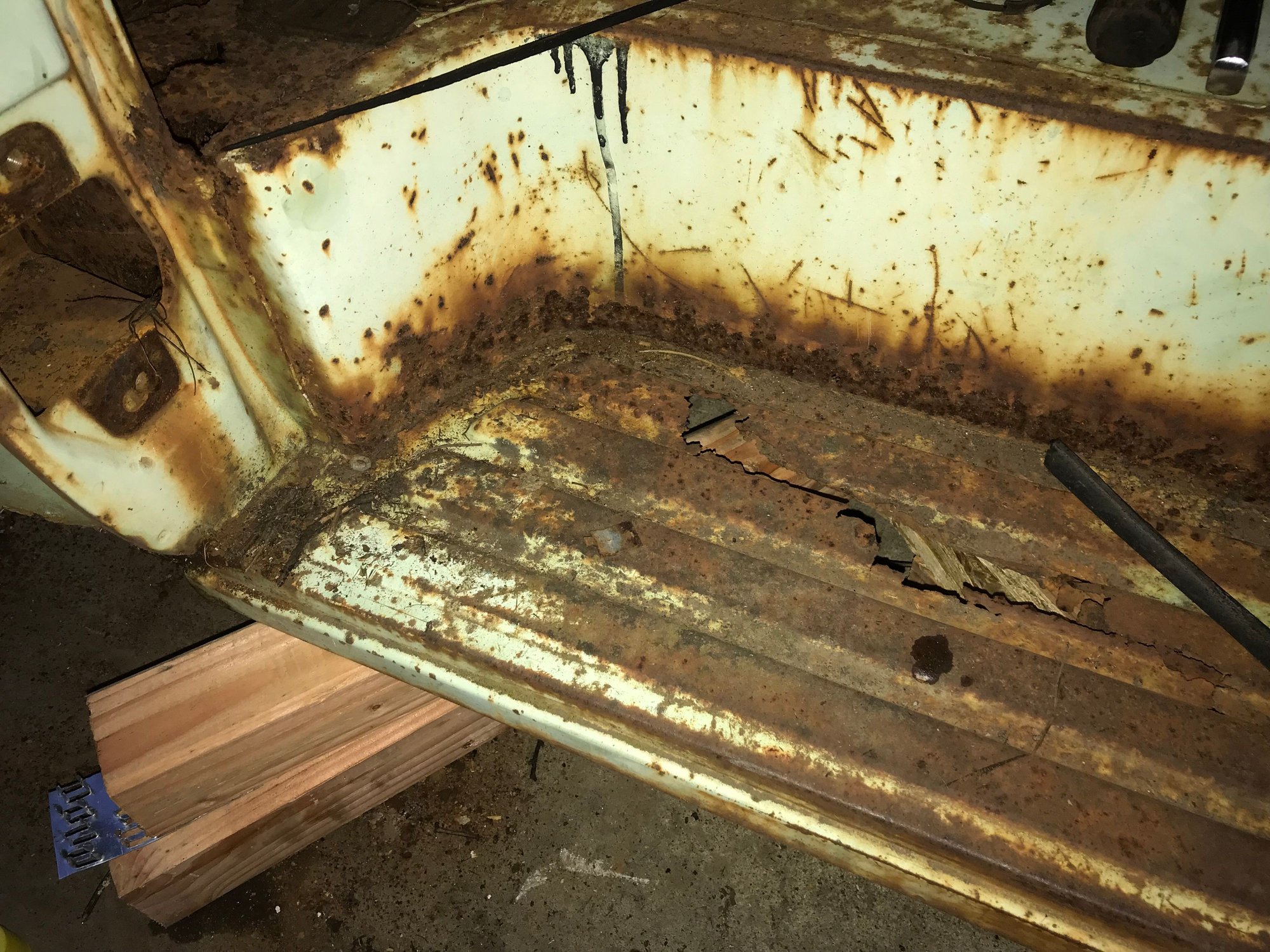

Passenger side cab support needs to be replaced as well as a little sheet metal.

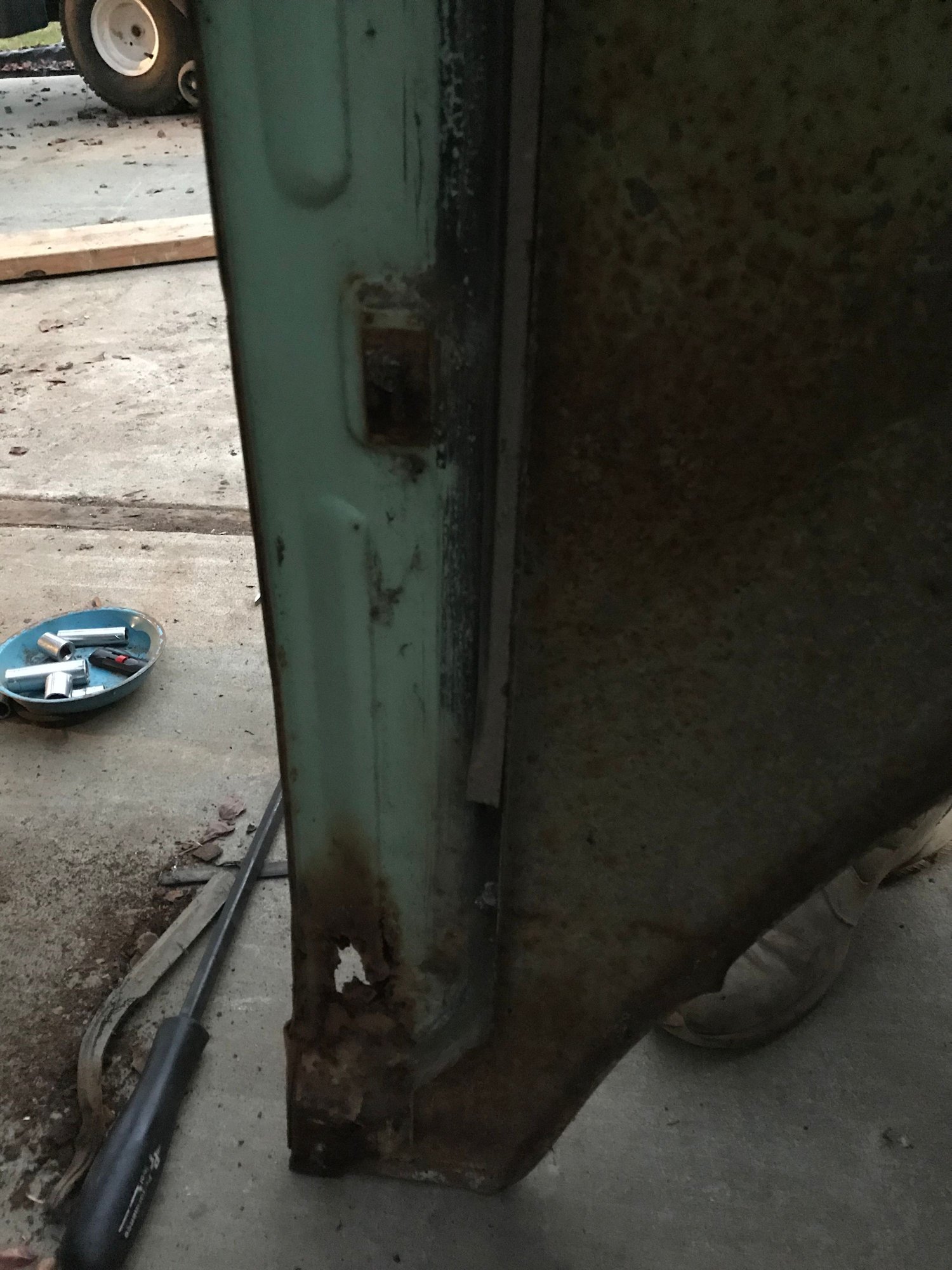

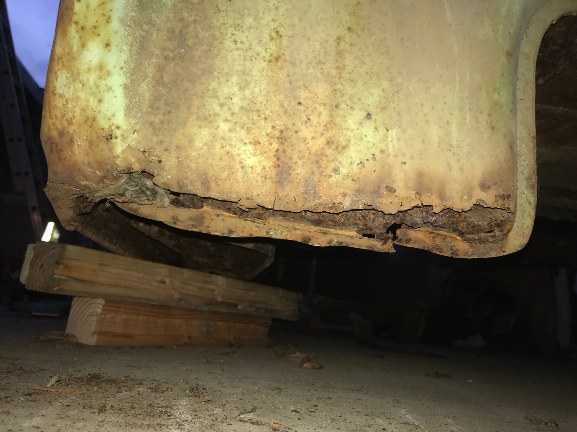

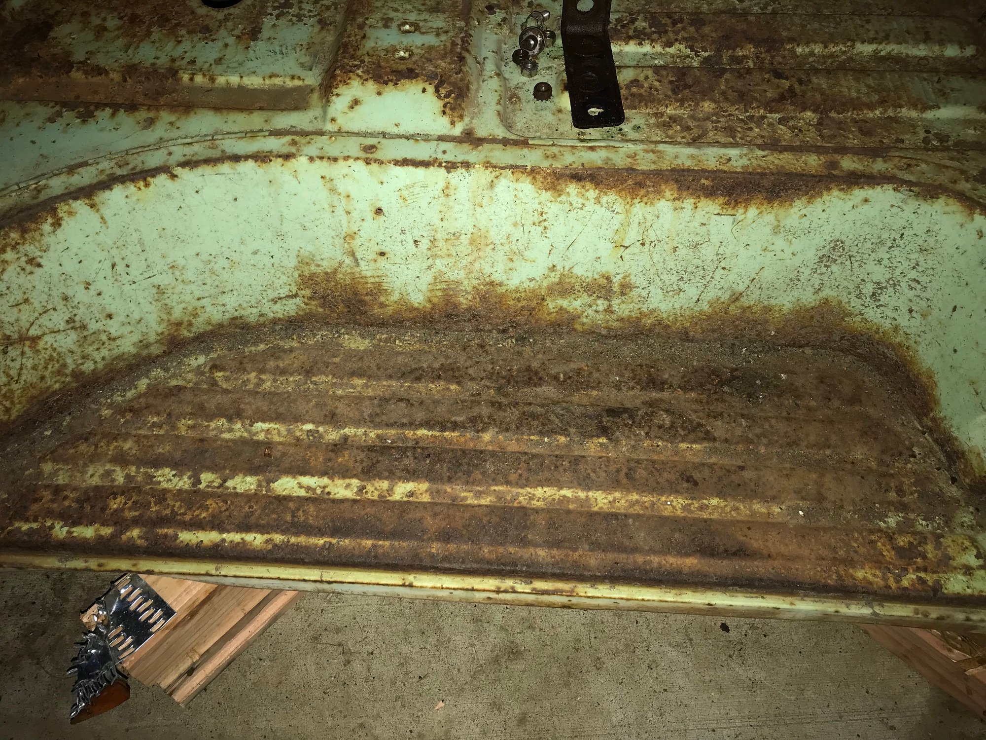

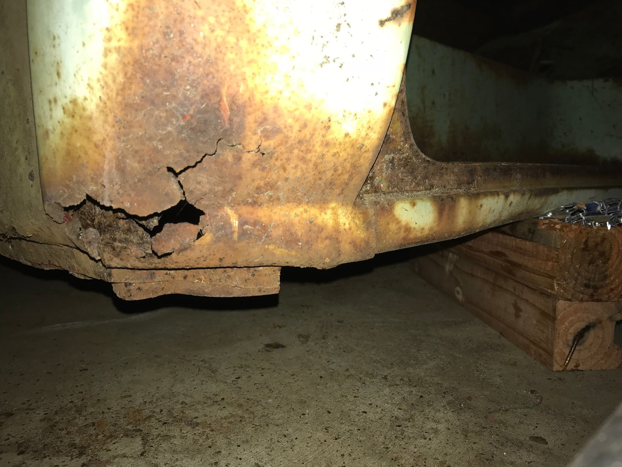

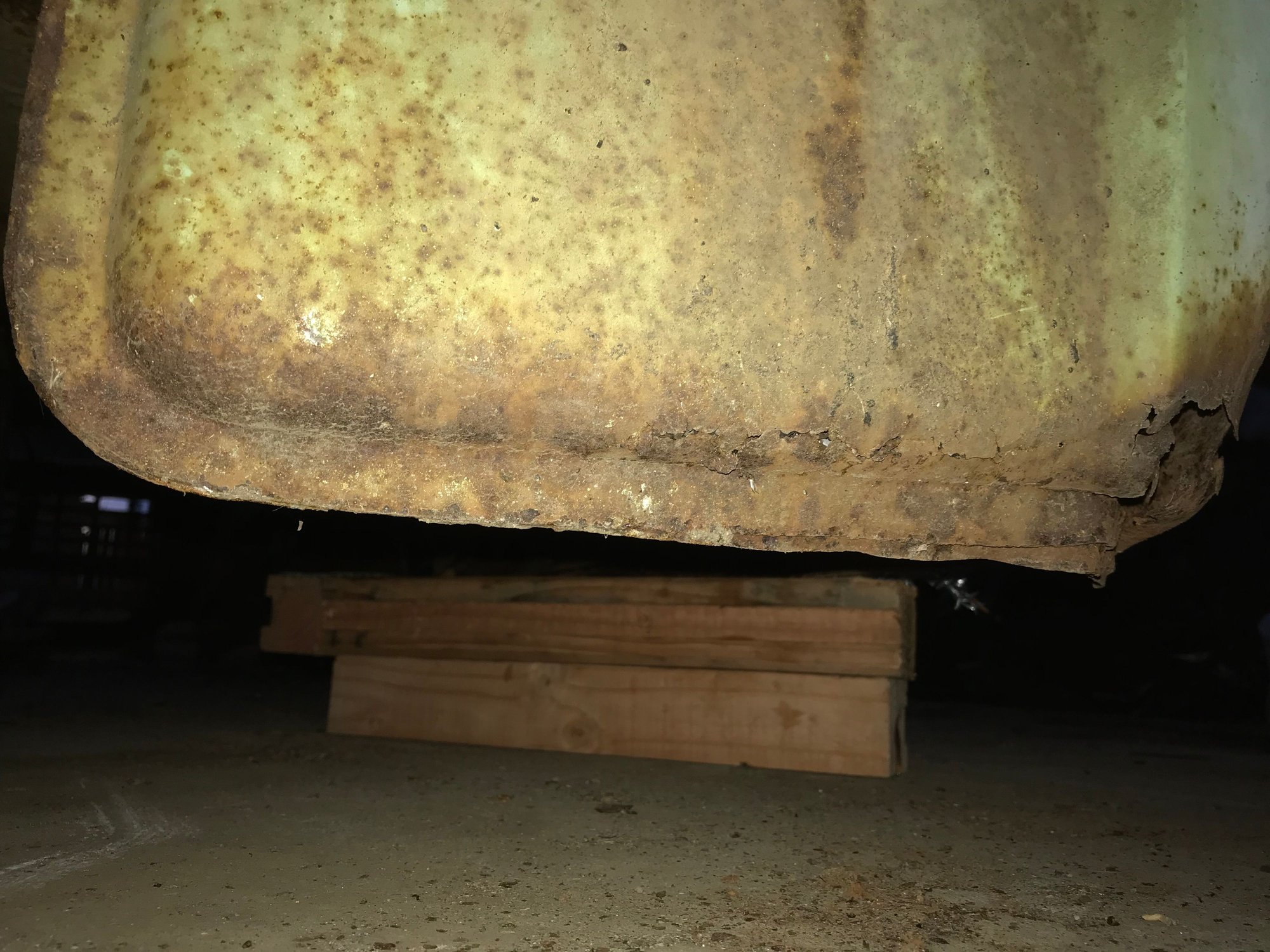

Need to replace this step but I think I can save the riser. I have the old cab to scavenge from if I need some prebent metal. Passenger side is good so I'll have to find a replacement that looks the same vs fabricating a flat step like my plan on the original cab. Rocker panel is good.
Passenger step, rocker and riser are usable with some cleaning up.
This looks a lot less intimidating than trying to fabricate a whole corner like the other cab.
Passenger side is a lot better though the corner has a hole.
Passenger side corner.

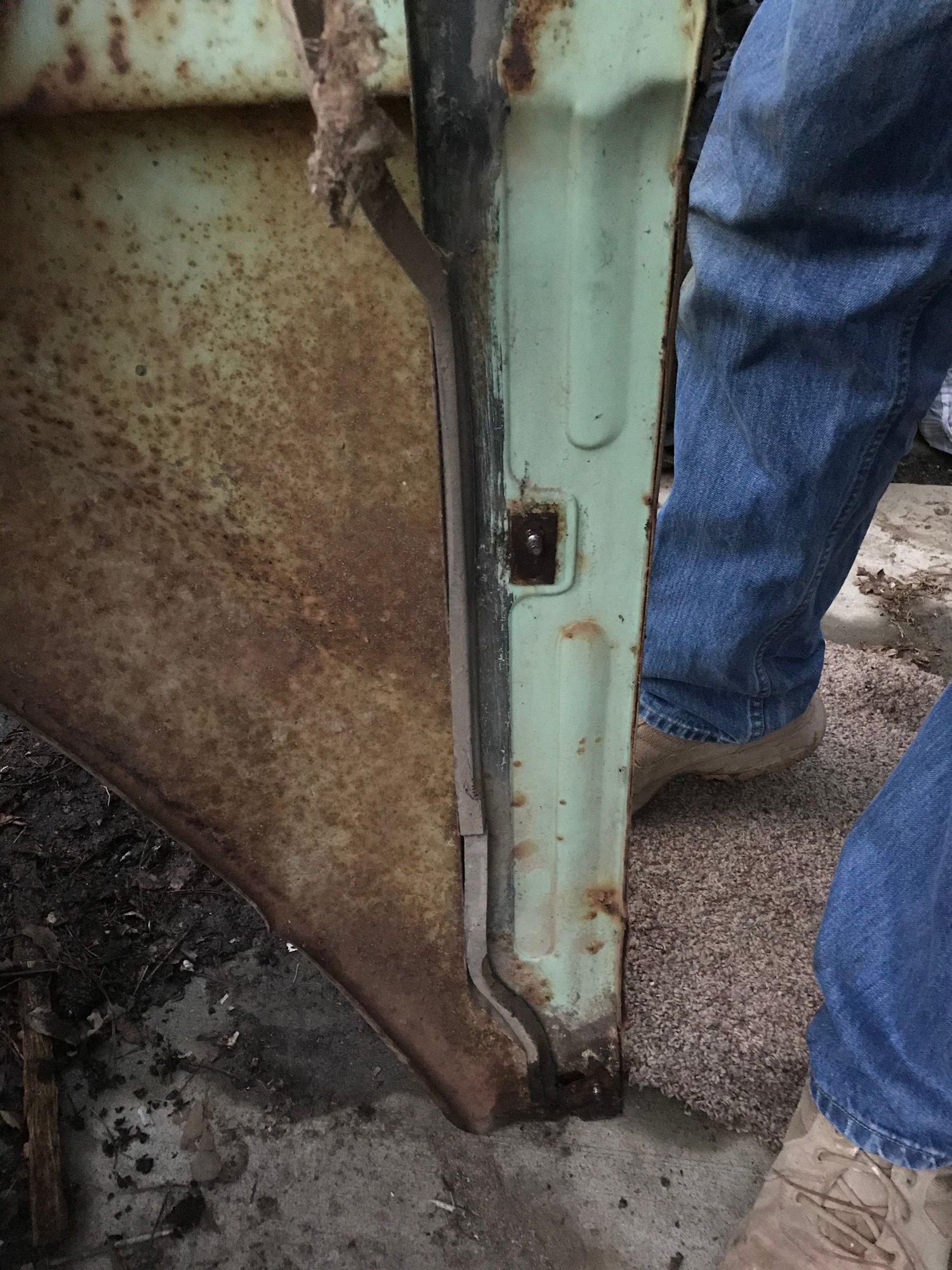

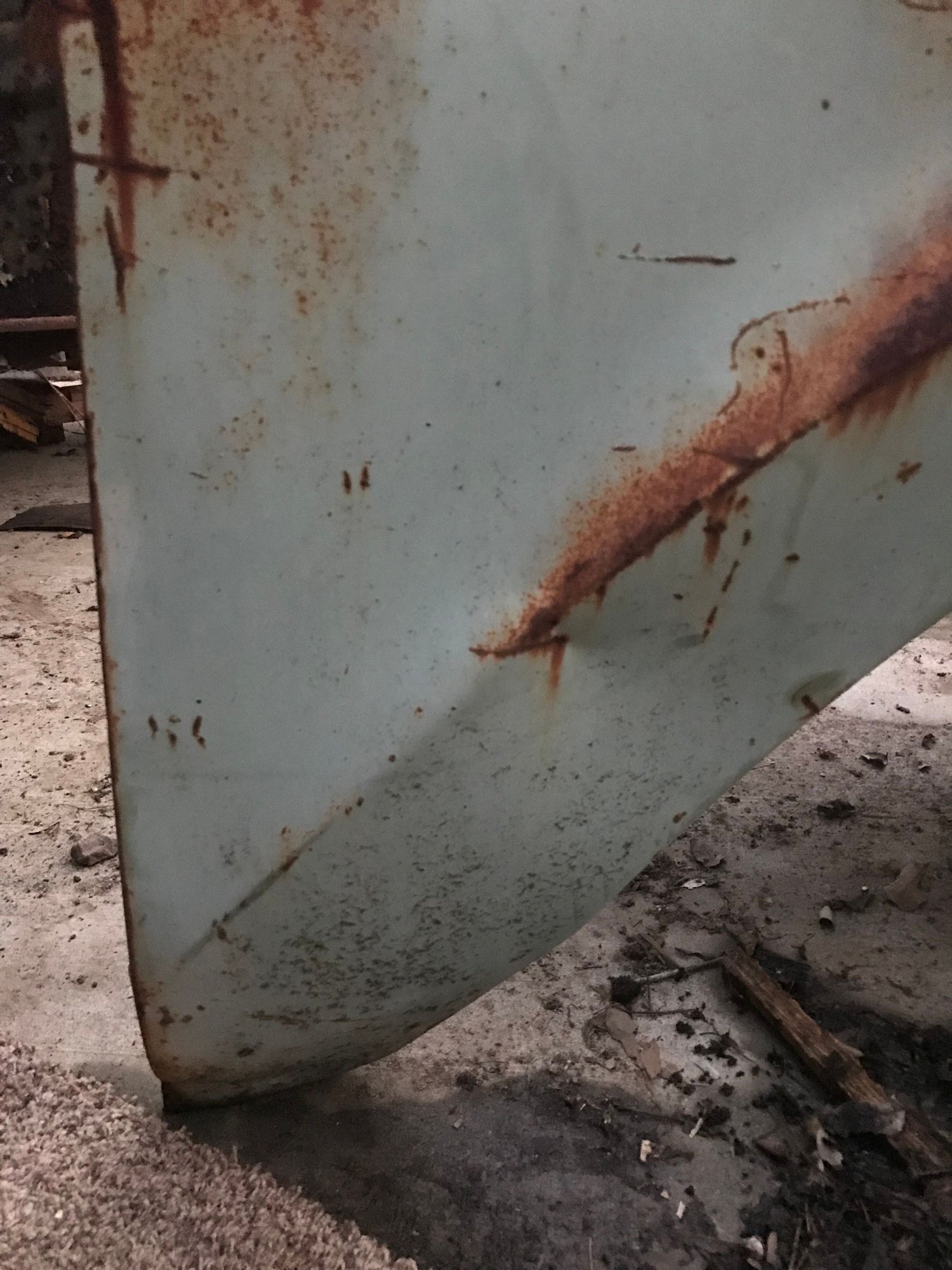

I can use the whole fender so no cutting and welding.
It has one rust hole but I can fix that pretty easily. All the mounting bolts are there and solid.

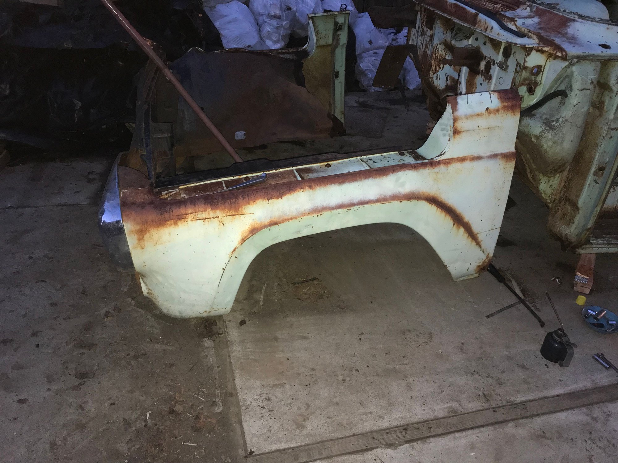

I can use the back half of the passenger fender but it will need a little metal massaging....
Inside of the passenger fender looks great. Both of my fender were rusted so bad the inner support as well as the bottom mounting bolts were rusted and gone. Glad there are in good shape.
Here is the padded dash on the original cab. Think I am gonna part with it. Not necessarily for sale but I do like to trade.
Rest of the padded dash.

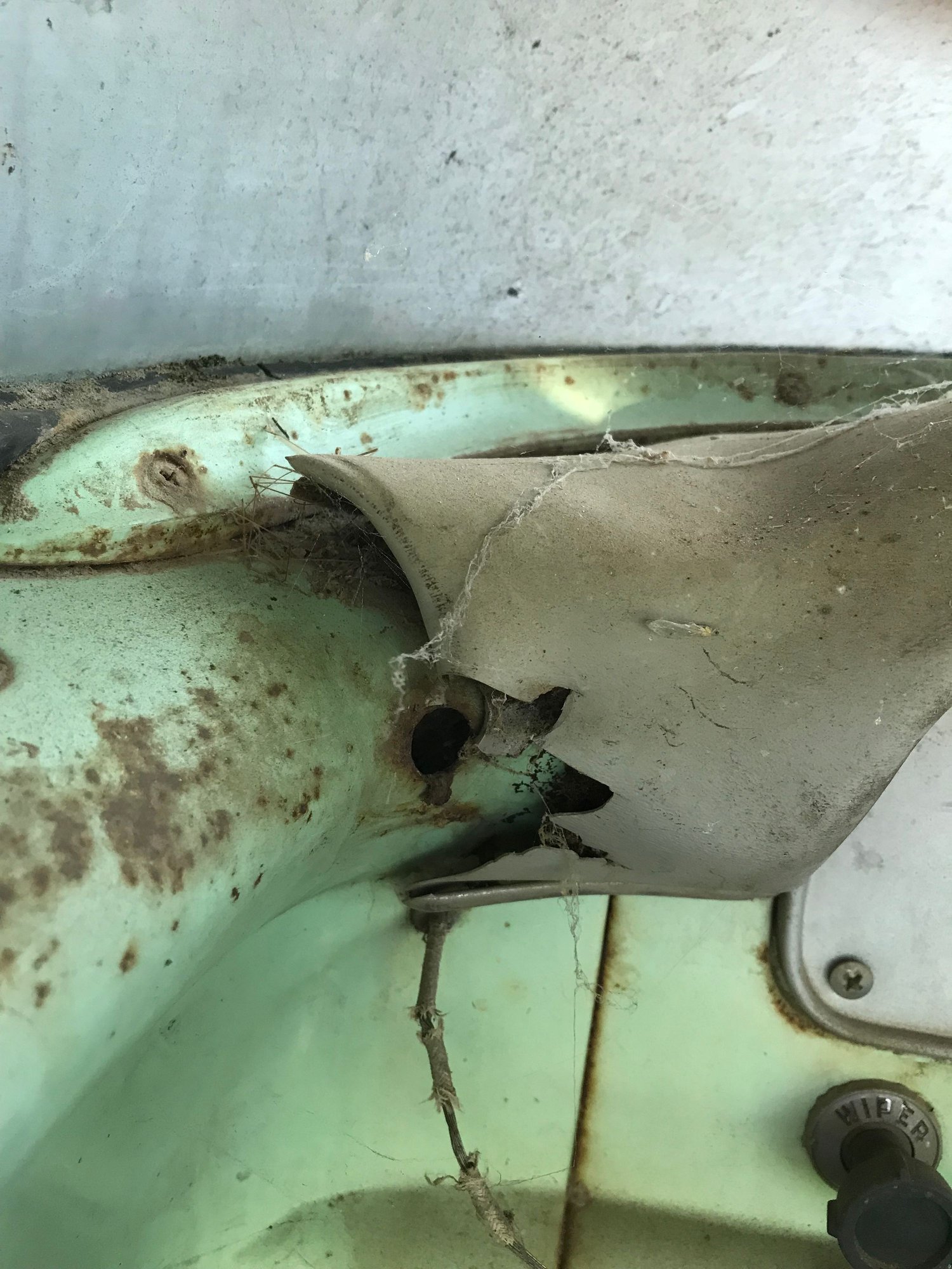

They did maim the dash to put in spot lights. This was an old farm truck and before drip tape, All the row crops were flooded and the workers had to watch the fields 24/7. All the trucks had spot lights.
