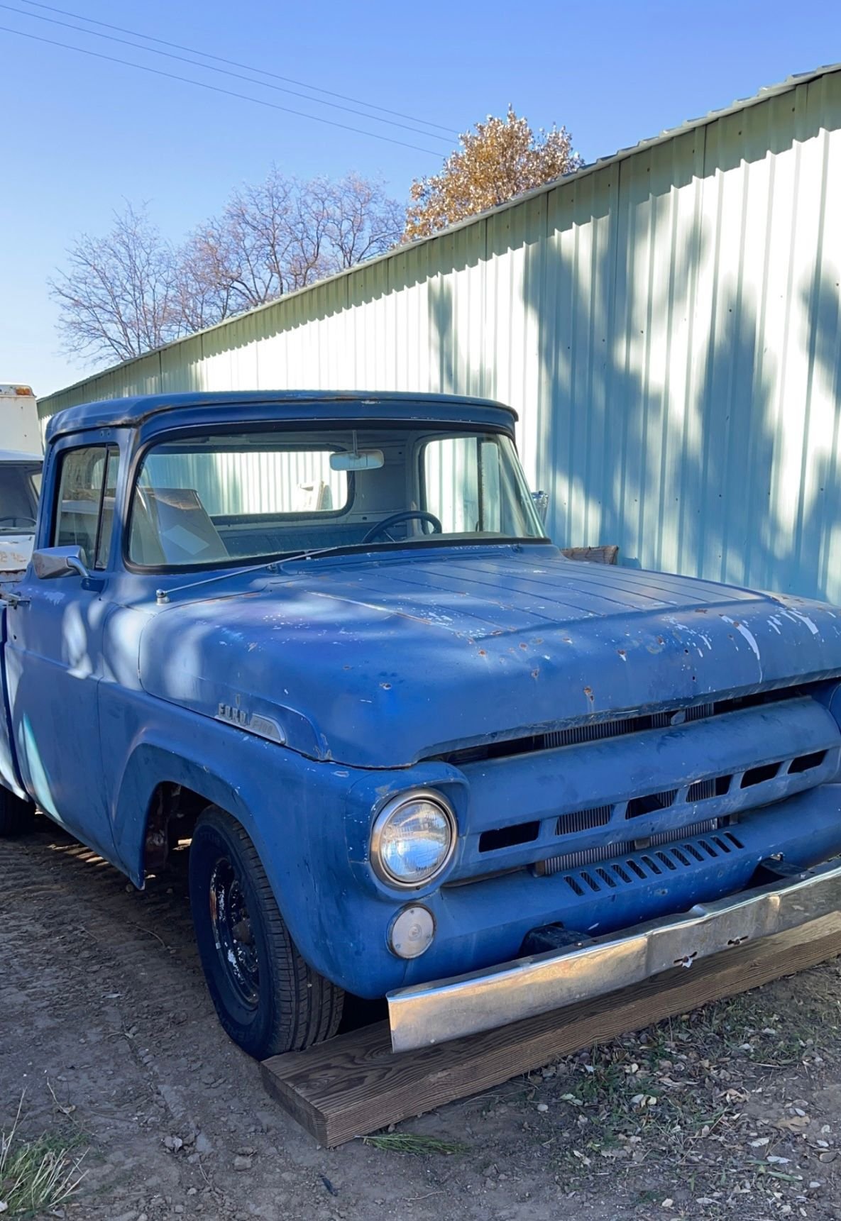

Hello I am in the process of getting my 1957 f100 to my new house and I found your thread last night. I wanted to let you know i plan on copying your suspension setup to get that ride height. I have a solid base idea now thanks to your thorough explanation and pictures of your beautiful truck.
I’ll start a new thread and make sure to reference your work
My dad’s 1957 f100 I bought from him to complete his project. He bought it from my Tio in Baja on a trip when I was a kid and it sat pretty much for the last 20 years.
