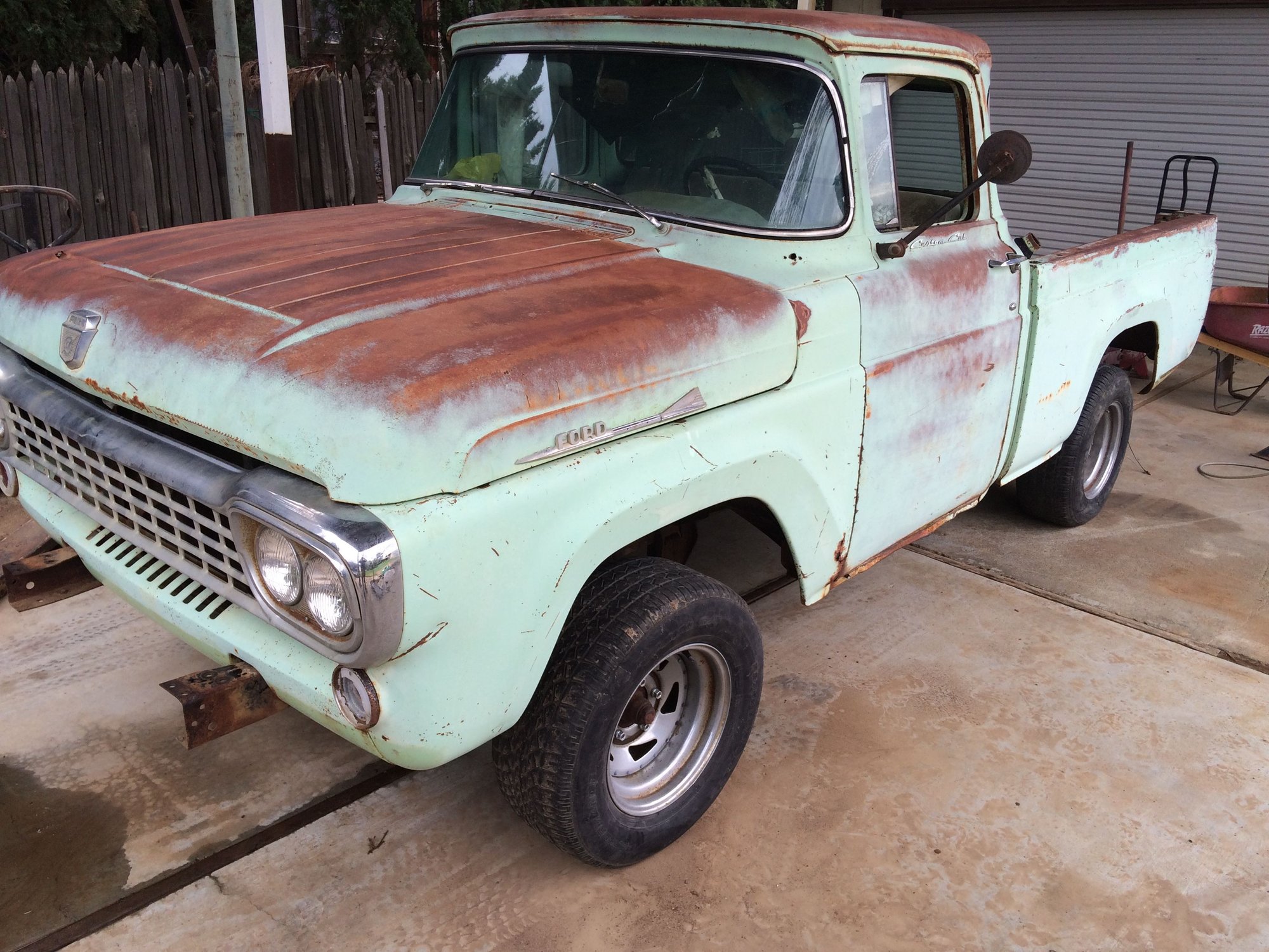

Finally had some time to pressure wash the underneath and exterior. Here are some pictures.
It came out pretty good and I am very happy with the patina. Took the farm bumpers off and I think I will get about 5 mpg more but now I need to add another inch to the drop calculations.
Ok, time to get serious and pick some brains.
1: I am going to rebuild the 292 and use the T98A with different gears in the rear end to give me more top end with less rpm. Better 1st gear for normal driving also. The goal will be to have the engine and engine compartment to look like it rolled out of the factory but in the meantime, I may want to drop another motor in so I can meet my august show deadline and drive it. I don’t want to cut anything and a chevy motor is out of the question. My question is, what Ford motors, if any, can I mate to the stock frame engine mounts? I heard a 352 would fit with front mounts. Is the bellhousing compatible with any other engines?
2: Before I pull the engine/tranny, I want to get an idea of how I am going to get the proper stance on the suspension while the weight of the motor is there. I know I am going to move the front and rear axles to the top of the springs. I can make my own hardware to do this and it looks like I might get around 5” or a little more of drop. I am going to have to notch the rear frame but that is not a problem. I can cut and bend all the metal myself. Question is, what are your opinion on how I can get me about 2 or 3 inches more up front and rear? I think that will get me the stance I am looking for. I want to use as many of the original pieces of hardware as possible as I plan to attend and maybe show it at the local rat rod gatherings and want to have the hood open. (1965 or older parts viewable from the engine compartment means keep the hood closed. Using old parts and mating them is ok though.). I have seen the posts about removing leafs, flipping leafs, and flipping the main leaf ends. I haven’t dug into the last one much yet and was wondering if that meant flipping the main leaf only or taking the spring in and having them re-arch it the opposite. What would happen if I only flipped the main leaf? For the rear, I figure I can just block it or try removing leafs.
3: The farmer I acquired the truck from said it is all original. My question is about the shock mounts. This truck has the mounts on the frame but not the axles. Did they roll out trucks without shocks? This was a farm truck so my thinking is maybe they didn’t have any to begin with. Are a set of original mounts (not repro) something you think I can find?
4: The 292 has a Holley 2 barrel sitting on it but there is an old (bottom is rusted out so I can’t use it) oil bath air cleaner sitting on the battery box. It obviously didn’t mount to this carb unless I am missing a piece between the carb and air cleaner. Does anyone have a photo of the stock air cleaner?
5: I want to move the gas tank to free up room behind the seat and get a bigger tank. Did Ford make a secondary tank for the 57-60 F100s? A tank I can rob from another Ford? I can use I want to keep it factory looking, especially if I have to cut in a fill pipe on the bed. I am going to try and find a way around that. I may even keep the original filler neck and cap for looks. Maybe a fill pipe straight up in the front left corner of the bed behind the spare time mount. Has anyone toyed with this?
6: What internal mods have you done to a 292 to get more grunt? It will be a daily driver but I want some go when I need it. Is it worth my while to find a stock 4 bbl intake and carb vs the 2 barrel I have? I’m not gonna race it and it has to be original looking. With some other cars I have built and worked on, I found swapping them out didn’t really give me what I was looking for unless I bought an aftermarket 4 bbl. If that’s the case, I’ll just open up the 2 bbl as much as I can and keep it.
7: The exhaust manifolds are gone. I would like to run some sort of header. I either need to make my own (pain in the butt) or find an older setup. Ideas?
8: I am going to pull the cab and do some sheetmetal work on the floor and corners. I see there are a lot of vendors out there with what I need. Any vendors to stay away from?
9: I would love to see what you guys have done via pictures.

Thanks for the info. I'm looking to do 2 things motor wise. Pull the 292 and take my time to find all the original parts to rebuild it right the first time. Secondly, drop a temporary motor in it to get it on the road. There is a huge rat rod show here in August and my band is one of the acts. I want to haul my gear in on my truck.
There are running 352's around and I know this was a factory option. Just need to know if the 292 frame mounts and bell housing would need to be changed. If so, I'll find a small block Ford and bell housing and fabricate my own mounts that sit on the stock frame mounts.
For suspension, I'm gonna need to measure from the axle to oil pan and rear pumpkin to bed and see how much clearance I have. There are several posts where others have done the axle over with a 292 which only mentioned the c notch in the back and altering the pitman arm, shocks, etc. what motor do you have? IFS and not using the stick front axle is not an option. I think I can use aftermarket drop spindles without being disqualified but I'd like to stick with old school techniques and parts.
Thanks for the shock diagram. Am definitely missing parts. Anyone have input on whether some trucks came without shocks?
For the gas tank, if there is no room under, I'll stick with stock.
Thanks for the info on the Tbird setup. I can use anything '64 or older and still show the engine compartment. As this only on the Tbird? OEM numbers anyone?
As for the ram horns, would you know the specs on outlet size?
Thanks again.

I jumped under the truck with a tape measure when I got home. The way it sits right now, I have 7” between the front axle and frame rails on both sides and 8” between the axle and the oil pan. Moving the axle to the top of the springs is going to give me just a hair over 5”. That will give me an inch clearance to the pan bottomed out. I’ll start there and see what it looks like. I will have to move the bump stops so it stops just short of hitting the frame. If I want more, I will use drop spindles. By rules, I am referring to the restrictions for showing at the rat rod shows here. It has to be 1964 or older, no billet anything or led gauges and if you have aftermarket parts visible in the engine compartment, the hood has to stay shut. Basically whatever you see, has to be old school. Repro stuff is cool if it looks correct.
In the rear I have 10” from the top of the pumpkin to the bed. Flipping the springs get me the same as the front (a little over 5”). Again, I will start there and c notch the frame and then play with the springs to get the max I can without hitting the bed. I’ll make sure I have some good bump stops. I know the ride will not be optimal but the rougher it rides, the less my daughter will want to drive it…..
I am very puzzled about the shocks. The lower mounting plates are not there. Maybe someone robbed them from the truck for something else though the ubolts are too short to fit a plate. I must be missing something but it won’t matter as I will replace what is missing and replace the ubolts to whatever length I need.
I’ll have to address the gas tank options once I get the stance where I want it but I do like the filler behind the license plate idea.
I do like the look of the ramhorns. That looks like the way to go.

So I think I have some more answers and a few more photos.
Today was a perfect day for fiddling with the truck. I decided to put the axles on top of the springs and see what I need to fabricate and to get a good idea of clearances and what the stance will look like.
I think I know why I don't have shock mounts. When I took off the first ubolt nut there was only about 1/2 inch of threads showing. That got me looking closer at the springs and I noticed it had 9 leafs front and rear. The rear has 4 that look like they were stock and 5 that seemed to have been added to the bottom. The 5 additional are about 1/2" wider than the other 4 and were placed under the metal clamps that are bent around the leafs to hold them together. In the front, I can’t tell what leafs are extra and what may have been stock. Can someone tell me how many leafs would have been on the front and how many on the rear? This would explain why there is so much arc in the springs. It was a farm truck and all I can think is they added leafs to allow more payload and eliminated the shocks to avoid buying new ubolts.
Sooo., I flipped the axle/springs and lowered the truck until I had the stance I like and still have clearance between the front axle and the oil pan and the frame, and the rear axle and the bed. I will have to keep the front springs pretty stiff as there won’t be a lot of flex room. I will have to c notch the rear as I expected but otherwise everything fits.
So currently the axles are not connected to the springs and are sitting on the ground. The truck is sitting on blocks at the height I want. The springs have so much arc that I didn’t need jack stands. The springs are sitting on 4x4 blocks (3.5”) in the front and a 4x4 and 2x4 (5”) in the rear. There is now about 2.5 to 3 inches of gap between the springs and axles. I am hoping eliminating the extra leafs will get me close to where I want to be. I can then fabricate new spring hangers and/or shackles to fine tune it. In the rear, I’m gonna have to use air shocks or hide some helper airbags as I intend to haul my music equipment in the back.
The front frame under the front cowling is about 11” off the ground, the bed and cab on the sides sits at 10”, and the bed height is about 20.5”. This is what I am shooting for once the springs are attached to the axles. I am posting a picture with me standing next to it for reference. I am 6’3” and the picture makes me look like I am 7’ tall.
I’ll post more as soon as I get the suspension buttoned up. I will need shock plates first though.
