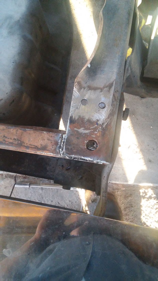

Today I cut the rear brace heres some pics
Any suggestions on how to reinforce the rear? because there is no way the rear brace will fit. If I weld my hitch will it be enough?
Im just trying to figure out what or how to do it. Maybe a 2x6 C channel welded connecting both ends?

I think the C-channel idea will work.

Well I spoke to soon . I put the rear brace upside down and notch it and worked heres some pics of the progress
Front brace notched
Welded and re drill new holes for bed bolts to go thru
My welder decided to die a slow death, lost one cylinder putting a hole on the block. My weld was done with only one cylinder so it was not good
The front brace is getting grade 8 bolts I have to buy some tomorrow
