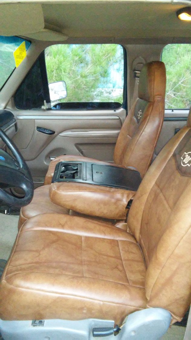

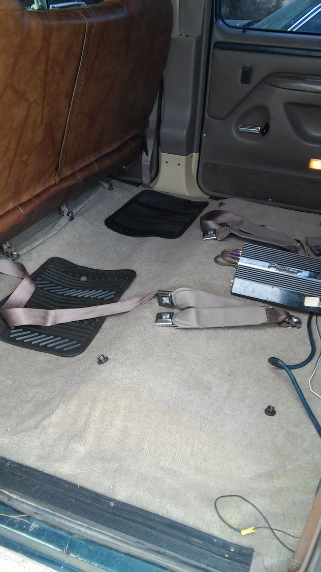

Update on The Mule. Just went to pick up my truck and seats
The carpet ( it darker in person mocha color)
The head liner
Seats installed
Border patrol really liked the seats, stoped at ace for some bolts and washers and a guy on a king ranch sd thought they were legit kr seats , then i got stoped by a cop just to get complamented on my seats, than a mile away from home some guy offer to buy my seats but of course I said nah. One of a kind amigo, so far im a happy with how fast the process is going with the whole truck. Tomorrow im going camping to Elephant Butte in Truth Or Consequences New Mexico. I will post pics on the towing forum bumper pull section, its going to be pic heavy

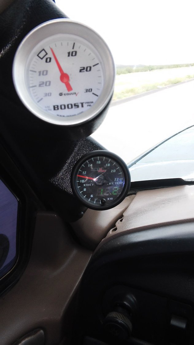

This was my first time towing with all my new upgrades mentioned obove and my god felt like a new truck, before all my mods i was running AB injectors with canned tunes no intercooler or the t500, towing the same setup, my egt went all the way to 1500 ° on the canned 50hp tune and my truck downshifted all the time, now i can hold it on OD on the same hill going 75mph how can i not love the new mods
My egts were at 1180 and stayed there on a steep grade maybe 6% grade maybe half a mile on my 60hp towing tune. Custome tunes, stage 1 rosewood injectors, t500 from joey, (maybe not a mod but) rebuild turbo, and last but not least 6.0 intercooler and 6.0 fan.
Also forgot to mention that i went from 4.10lsd to 3.55lsd (way before any mods were planned and still was a company fleet veichle)The 3.55 and these mods i have, are real happy working together i dont think im changing anything i love how it feels towing with the combo. Tire size are 285/75 r16 e Toyo open country MT love the grip they have.
