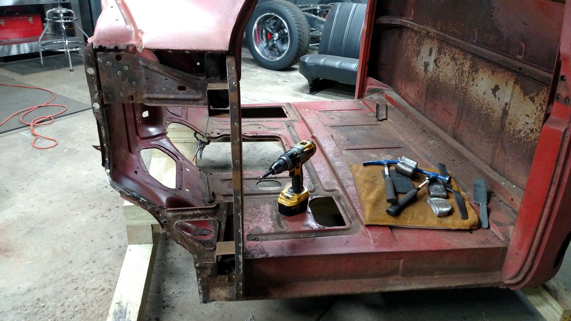

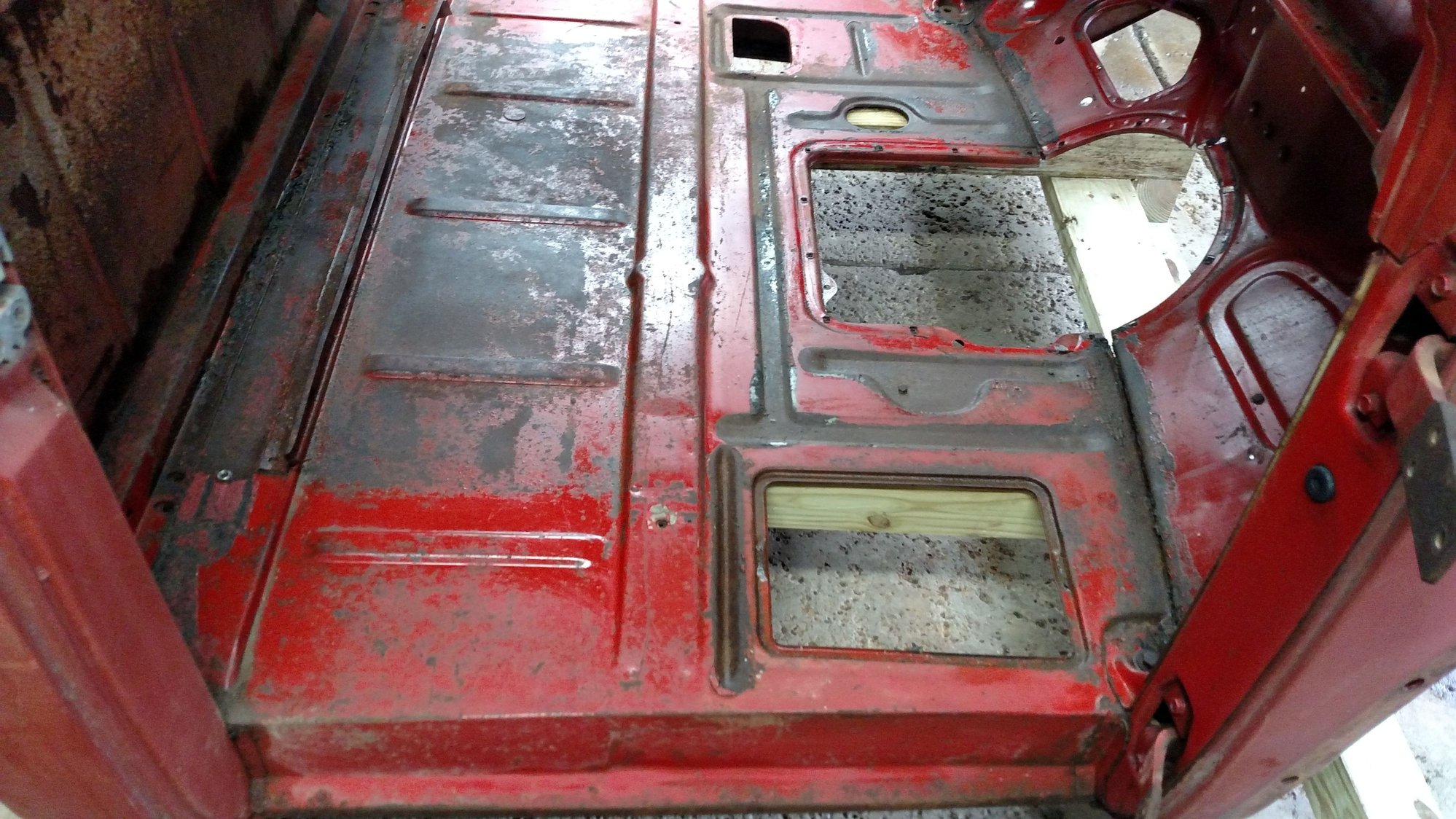

So today I stripped out the "new" cab to get it ready for blasting. My last cab got worse as I dug deeper. This one got better. Very happy with the overall condition. This is going to save so much time. I'm guessing it left the factory red. What do you think.
The only bad spot is the roof as it has some dents and oil canning. But it isn't as bad I I initially though now that I have it home and had a chance to look at it well. I really happy with the condition.

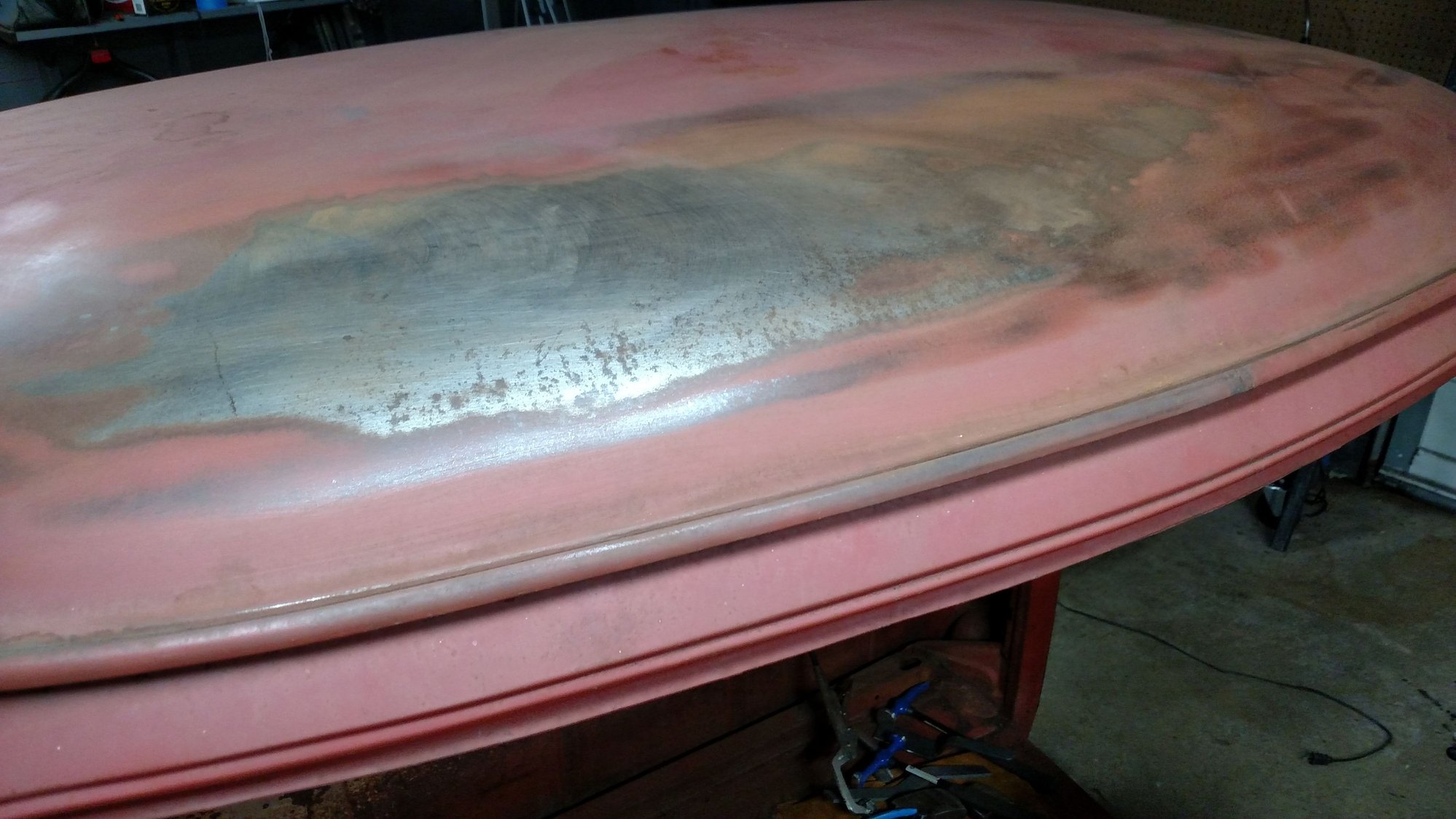

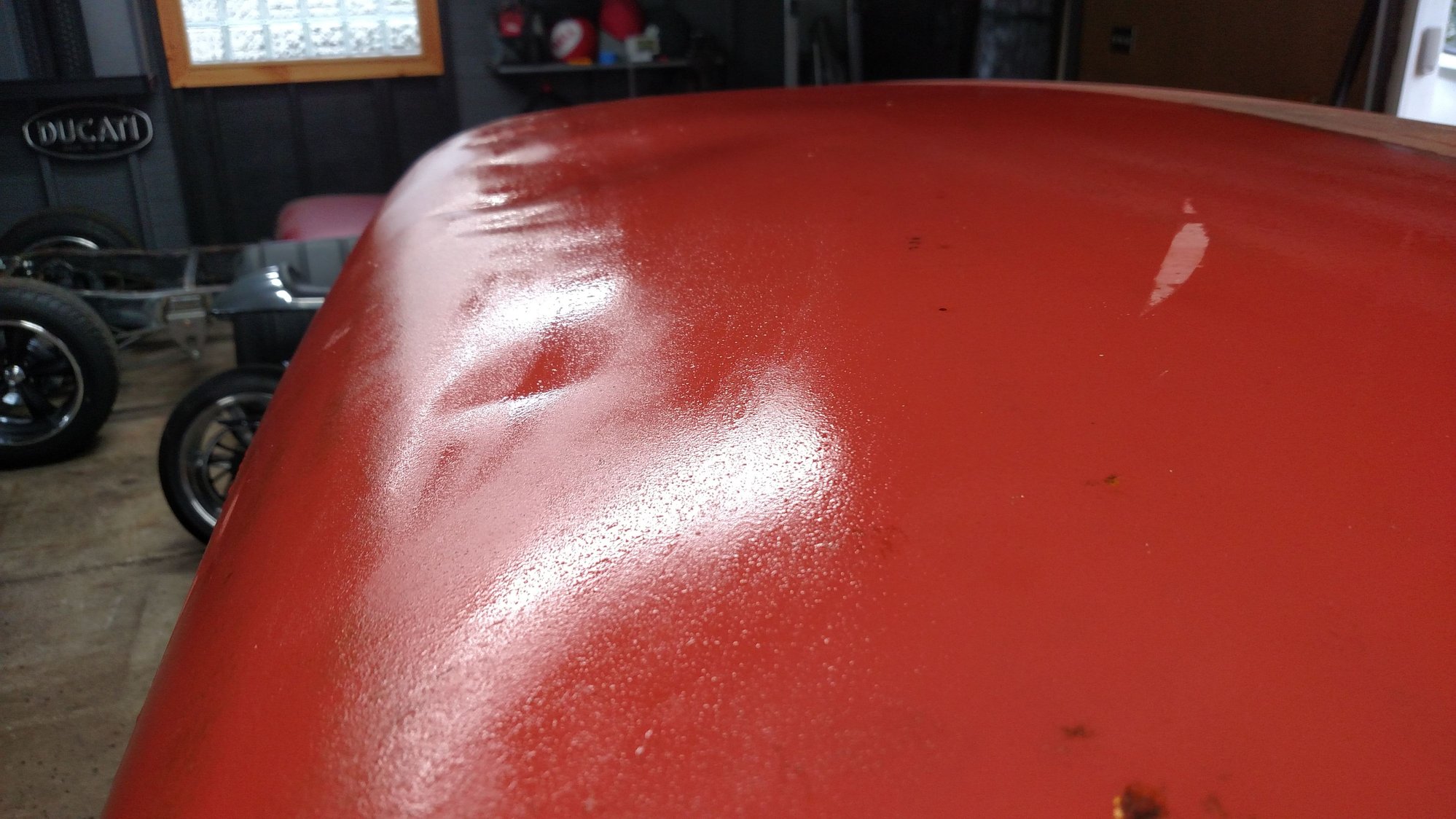

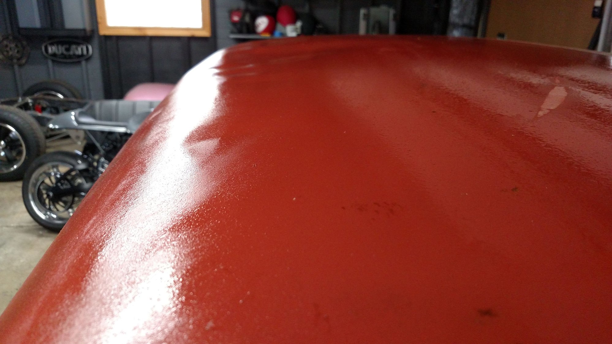

Little progress. Getting ready for winter round these parts takes some time away from hobbies :-). I mentioned the roof on my better cab was dented up badly. I think what happened is a gorilla was hopping on it with clogs. Maybe a silverback. In any event it was caved in. Creased. Dented . Little bit of everything. I tried to take some pictures but it was hard to show the extent of it. I put some water on it to see it better. It was the entire roof. Back front and sides.
At some point something in the bed ( possibly the gorilla ) crashed into the cab. The bottom and top of the window frame was creased in. I'm sure the window shattered when this happened. I cut an access area in the bottom and removed the roof support brace so I could straighten the back panel. I pushed the window frame back straight. Then removed the dents and creases.
I pounded out all the dents and dings and got the roof reasonably straight first. It was hard to decide where to start. I mentally divided into 6 areas and just worked out each area. I feel its at the point where it could be skim coated, but I'll keep working on it till its as perfect as possible. I'm happy with it so far though. But Ive got nothing but time.
There were large creased dents above the drivers door in two major areas. Middle of window opening and top rear corner. They came out well.
The damage above the top passenger side area was pretty bad and more difficult as it was dented and oil canned badly.it was a wavy river. It took some shrinking to get this repaired. I will work in this area some more. But its miles better.
This was the worst part as shown in the first pic. Lots of hammer and dolly work. Lots of shrinking with a hammer, slap file, and a torch, disc. Pretty much a little bit of everything.

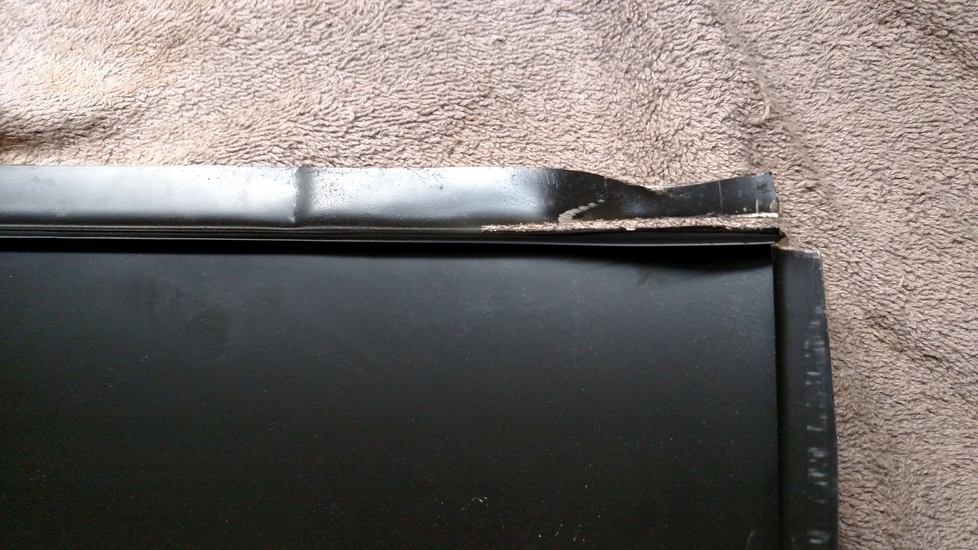

My cowl repair panel is marked 53-56. I didn't think much about it but it definitely needed a bit of trimming. Maybe its made for the 56 and can be adjusted for a 53? Not sure. The mod wasn't enough to think about returning it. Here is the issue. Upper area where is meets the cowl and door frame.
I cut a slot...
And bent it straight and removed the radius that was creating the problems.
Fits better now. I'll do a little more fitment then weld the slit I cut. I'm going to leave off any panels I remove so the media blaster can get in those areas better.
